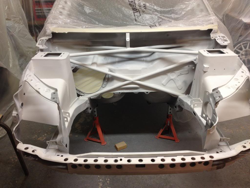

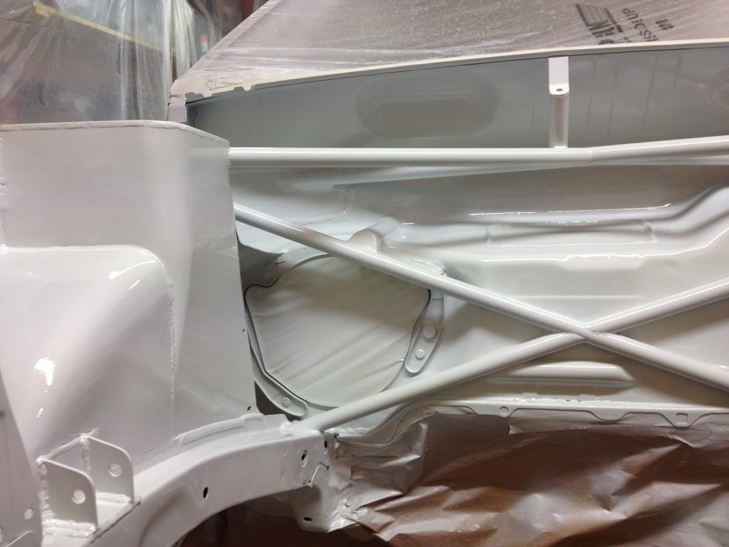

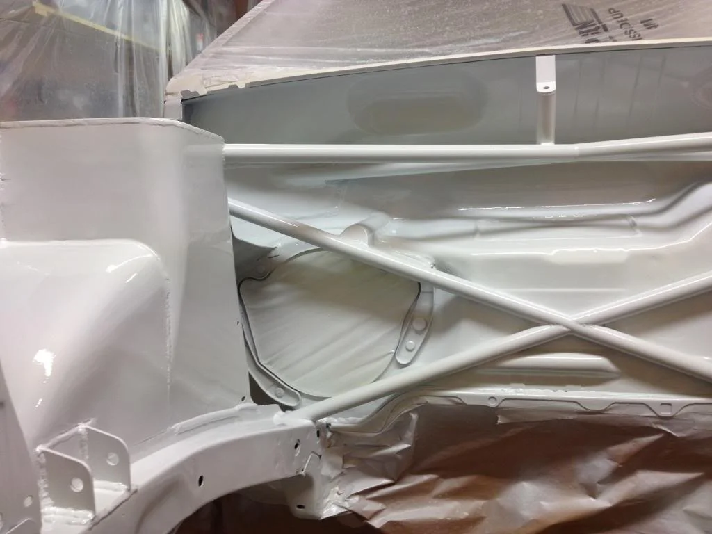

Looks like some painting is on the cards for this weekend so I need to pull the finger out and get it ready!

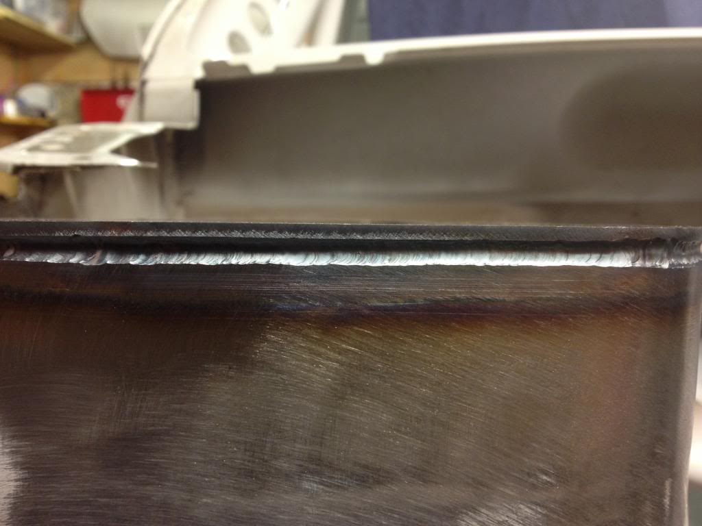

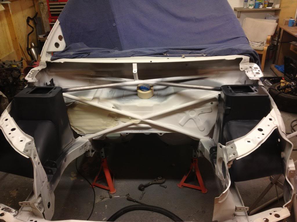

Tops of the strut towers, V prepped and first pass, then did a 2nd pass/cap. Still not as good as my mate but i'm happy enough they're not going to come off

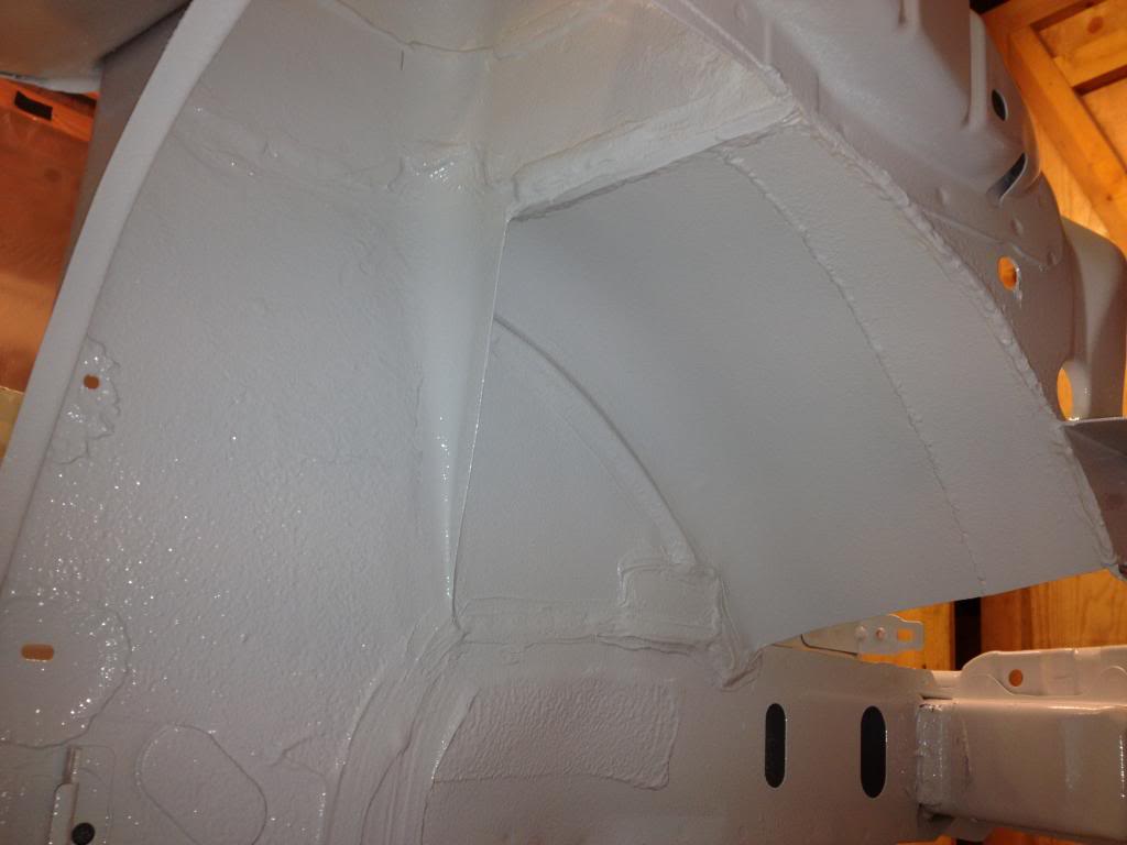

I spent a little time smoothing out the joins and the sides of the towers then gave it a quick coat of etch primer, still need to go round them with seam sealer then I'm going to have a go at using the proper paint gun to put some decent primer on it all.
hahahaha those turret tops look collosal compared to standard!! the X`s should really help keep the chassis in place and allow the suspension to work properly.. love it as always

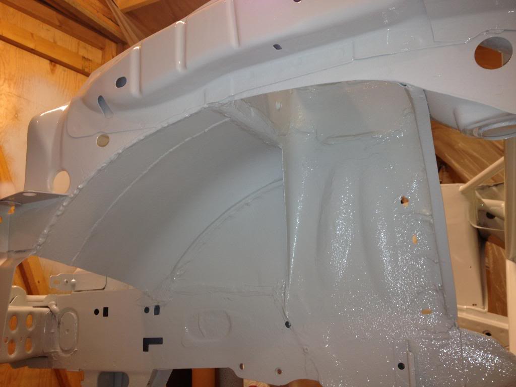

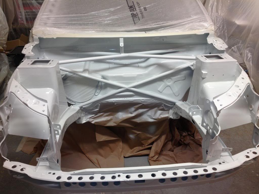

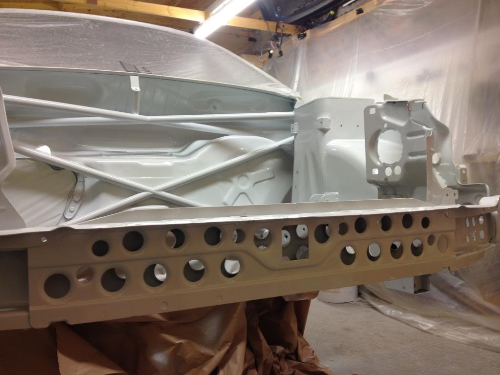

Minor update, decided to have a go at priming with a proper paint gun, didnt want to drag my mate up to do this wee bit, he just gave me a few pointers via text message lol
I was using a small cheapo paint gun so probably not ideal for high build but I was getting the hang of it a wee bit by time I'd finished, only put on run in it, will flatten it all down tomorrow and get it ready for the top coat on Saturday.

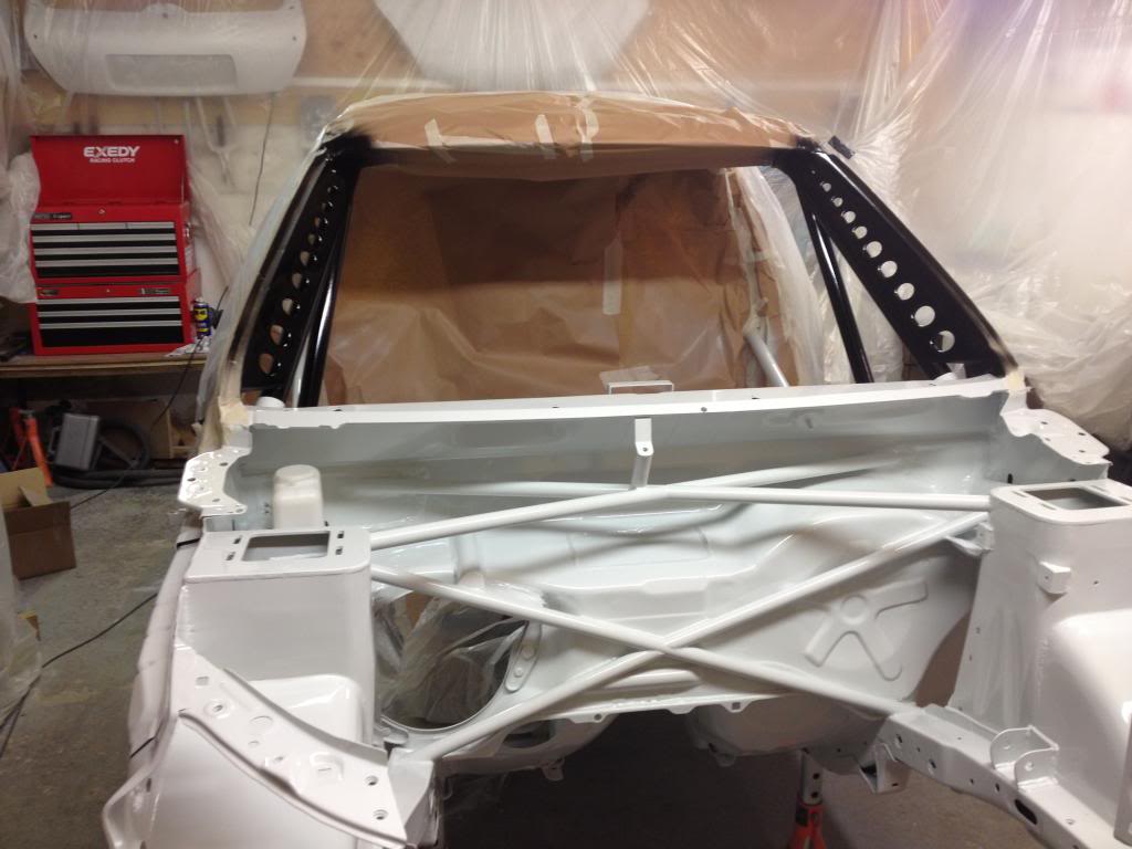

finish looks good mate, good to know you are at the end of the shell prep i expect?

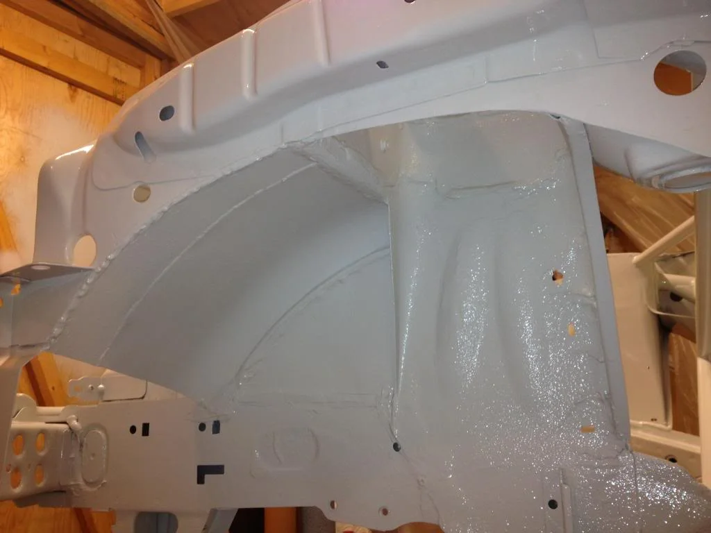

Yeah, thats the shell done (I hope!) if there's anything else that needs doing to it I'll just need to drill and bolt or rivet it in place.
Engine bay now painted, few wee bits we couldnt get to with the gun, so I'll need to touch those in with a small art brush

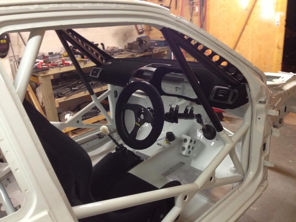

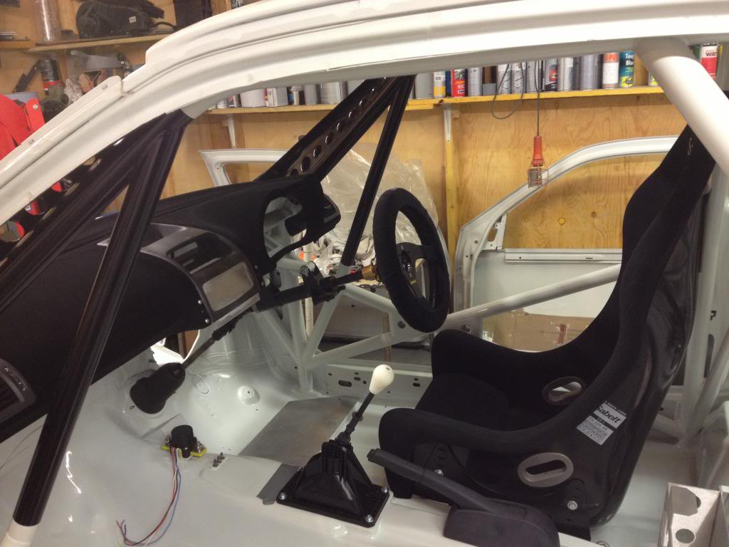

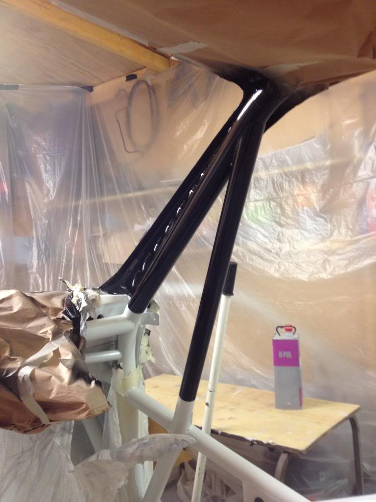

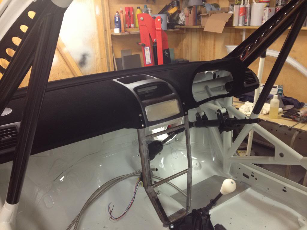

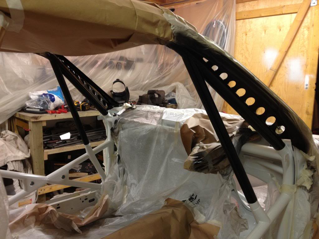

Also decided to do the A-pillars & triangulation bars in satin black, once the dash is flocked black think it'll look pretty good, it was still drying when these where taken so it's not quite as shiny looking now

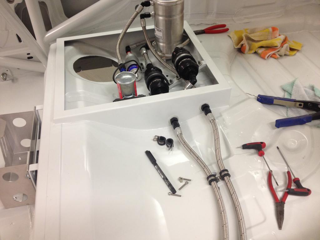

Just realised I had a few pictures on my phone of what I did before I came offshore.

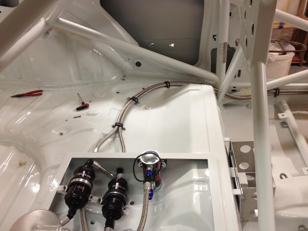

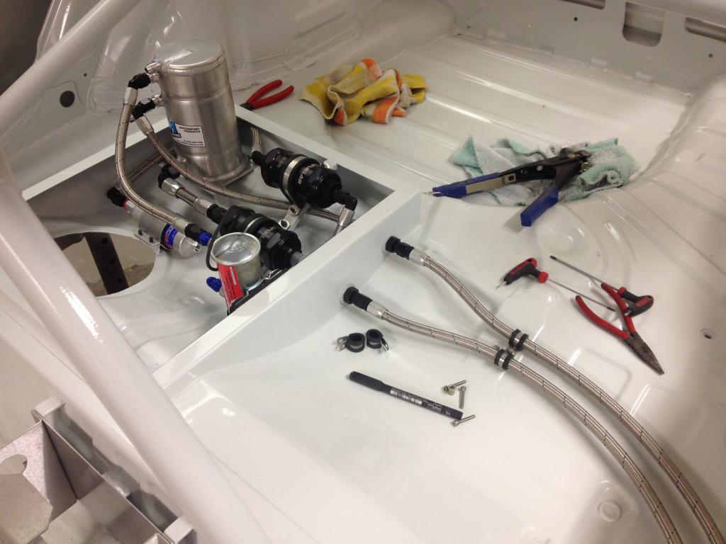

Started fitting up the fuel lines but I only managed to get 1 rivnut fitted then the gun packed in :dapprove: ordered a new one while I've been out here so will be able to crack on with that once I get home.
If you have anymore issues with your rivnut tool have a look at memfast rivnut tool I bought one and its a great bit of kit! Uses normal caphead bolts as the mandrel so readily available incase you get a breakage.
Looking great as always can't wait to get mine back painted so I can rebuild. What are you doing for the chassis loom making it yourself?
  Audi A6 & 172 Cup
I ordered one of the Masterfix ones which look pretty substantial but the memfast ones look good too, ill see how I get on with this one. The one that broke was a cheapo thing I've had for years. I try to avoid using rivnuts if I can help it but there are some instances where there's not really any alternative.

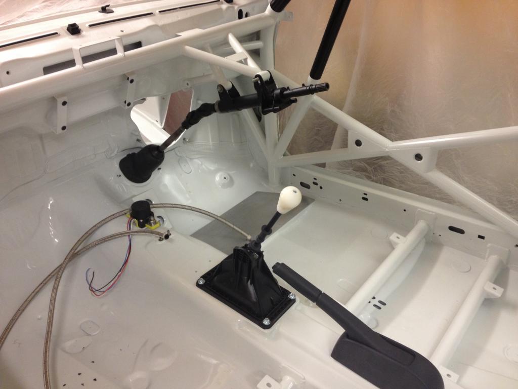

Wee bits of progress today, although some of it will need to come out again before the final assembly, just wanted to test fit a few things.
I sent the dashboard down to Banbury Flocking Services before I went away to work, they turned it round in less than a week and it was sitting at the house when I got home, very pleased with it

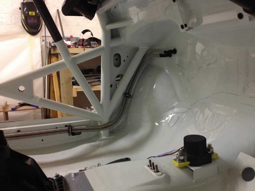

Decided to revise the way the fuel lines where mounted, just opened out the P-clips and cut a small piece of rubber to go between the lines and the body, still using the crappy rivnut gun though as the new one hasn't arrived yet.
Going to collect the front subframe and a few other bits from the powder coaters tomorrow so I'll be able to make a start on assembling that.

Liking the the black fittings, classier than the tarty stuff I have used. Is that ptfe braided hose your using? never seen it with the spiral on it. What washers did you use for the bulkhead fittings, I ended up buying ford cvh sump plug washers as I couldn't find anything to suit on eBay (im assuming that your using -6 fittings)
  Audi A6 & 172 Cup
Yeah its ptfe stuff, Goodridge 811 series, really nice to work with and assemble but it's fookin sore on the wallet! I managed to get a reasonable discount on it but still £££. Granted you can buy cheap stuff on ebay but when it comes to fuel, especially in the car, i'd sooner spend the money. As I mentioned before, bruises and broken bones I can deal with but getting burnt isn't something I want to take chances with.
There's still two blue fittings on the lift pump, but I've got blck to replace them, the pump came with those.
The main lines front to back are -6. I got these for the bulkhead fittings,
