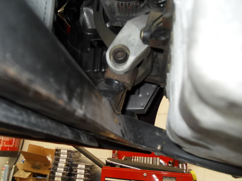

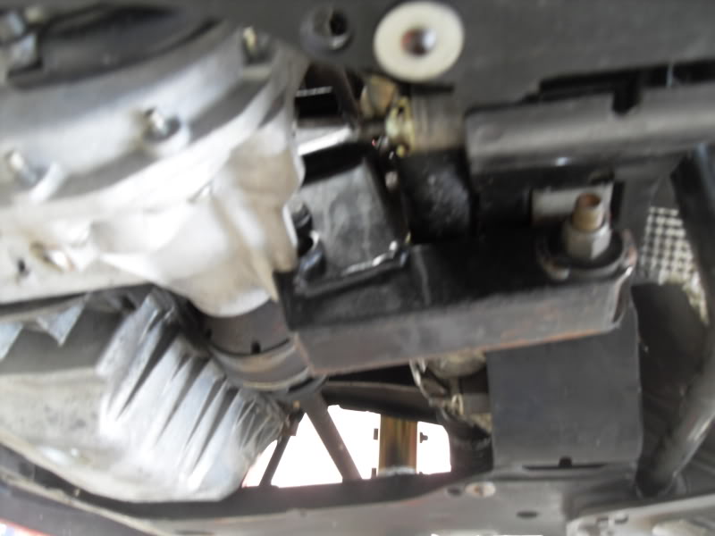

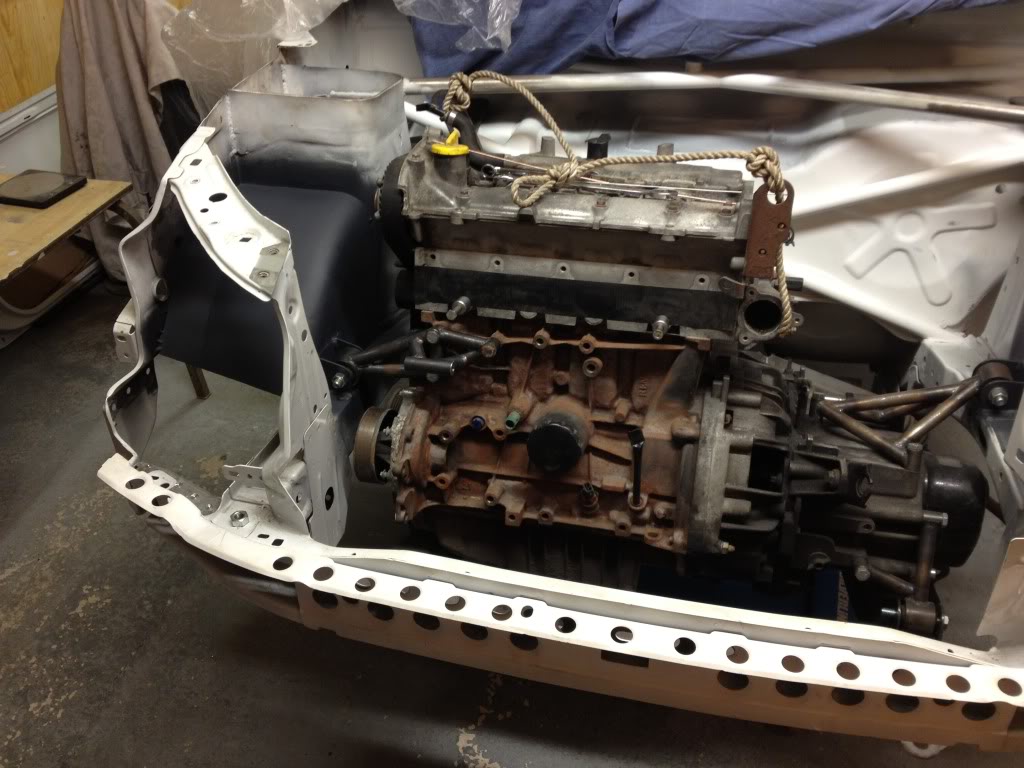

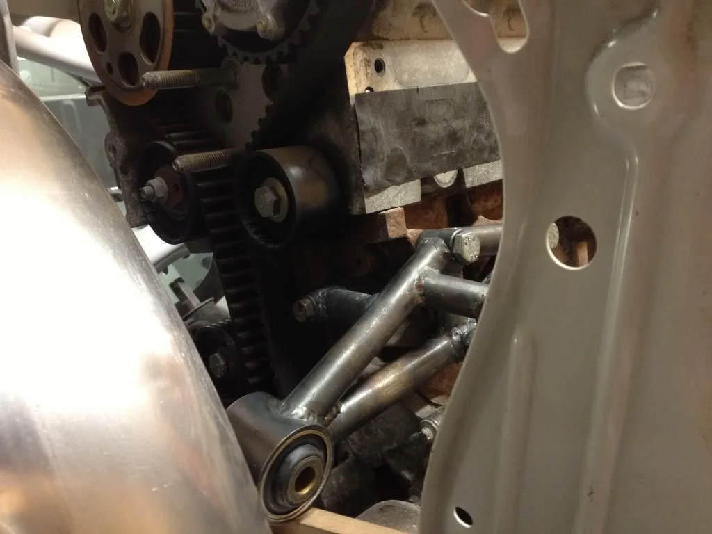

Liking the mounts!

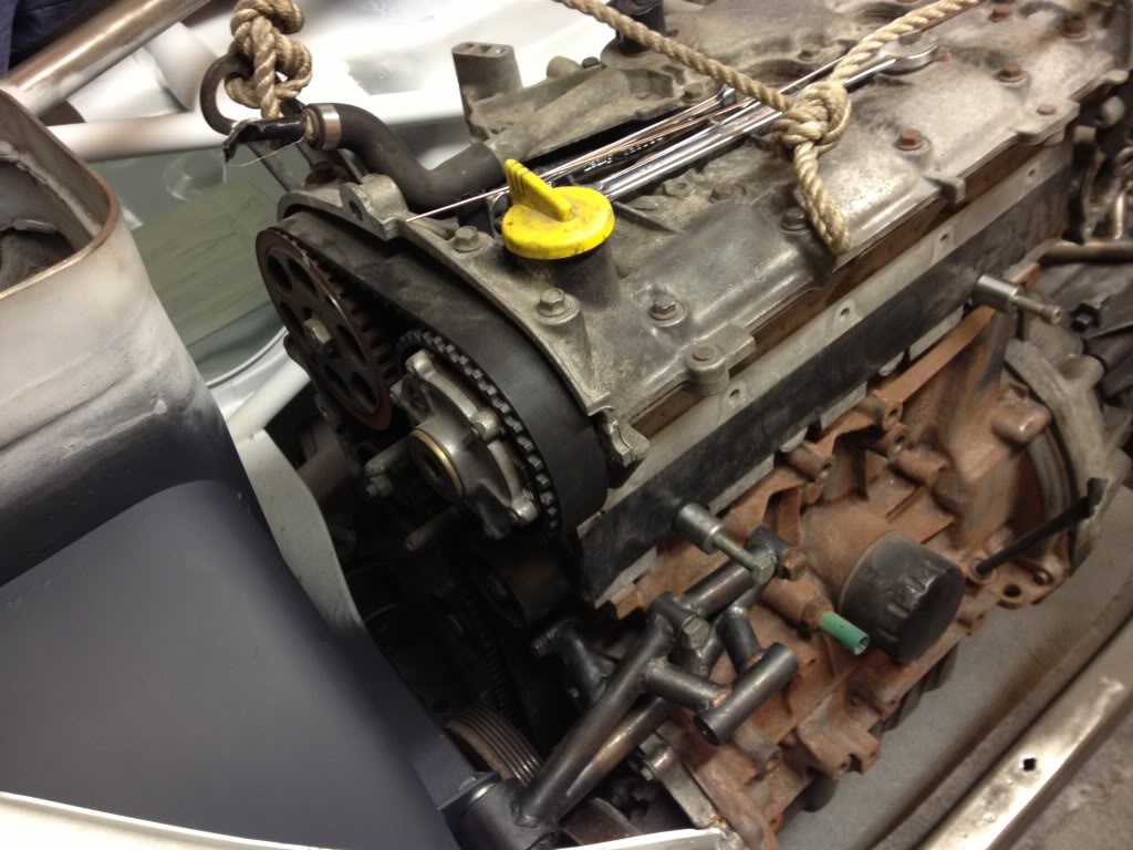

Are you going to add a 5th mount at the cam belt side?
Should be good, no biggie if they break with your skills lol.

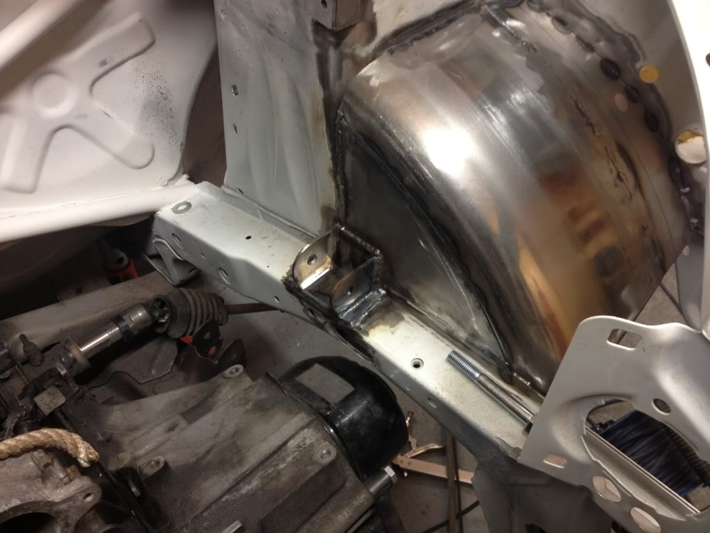

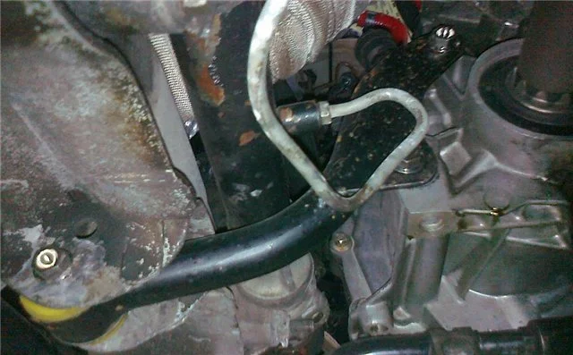

All the torque is dealt with on the g-box mounts, the engine one is there more or less to hold the engines weight.
Did you get pics of the other g-box racer mounts?

Looks good, what have you done with the others? .
You think the ARP head studs are very important? Didn't realise you can get uprated cam beltsOthers are by Vibra Technology (you can see them at K-Tec Racing), while I have some ideas how to make my own too...

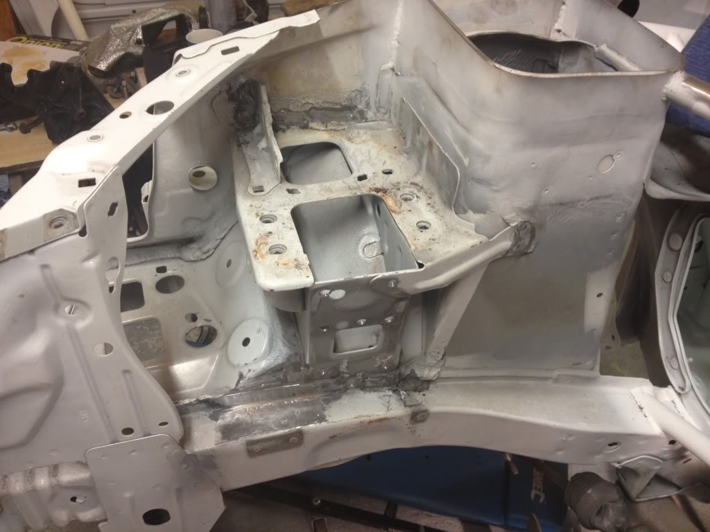

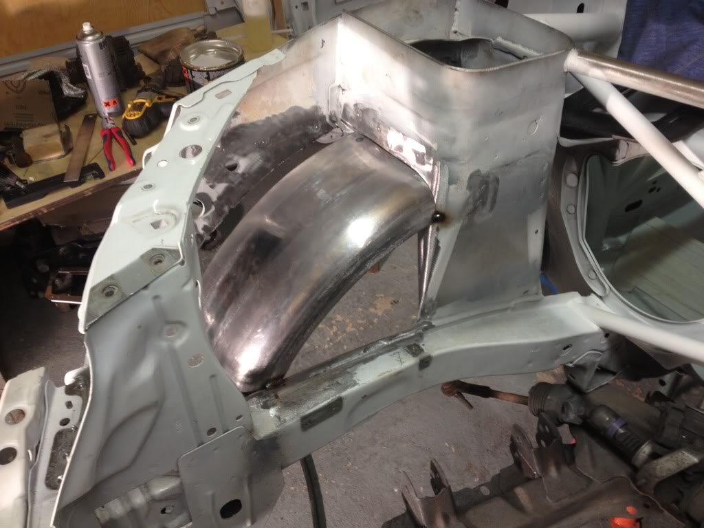

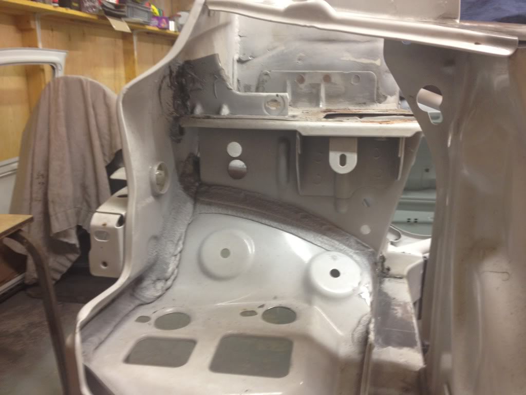

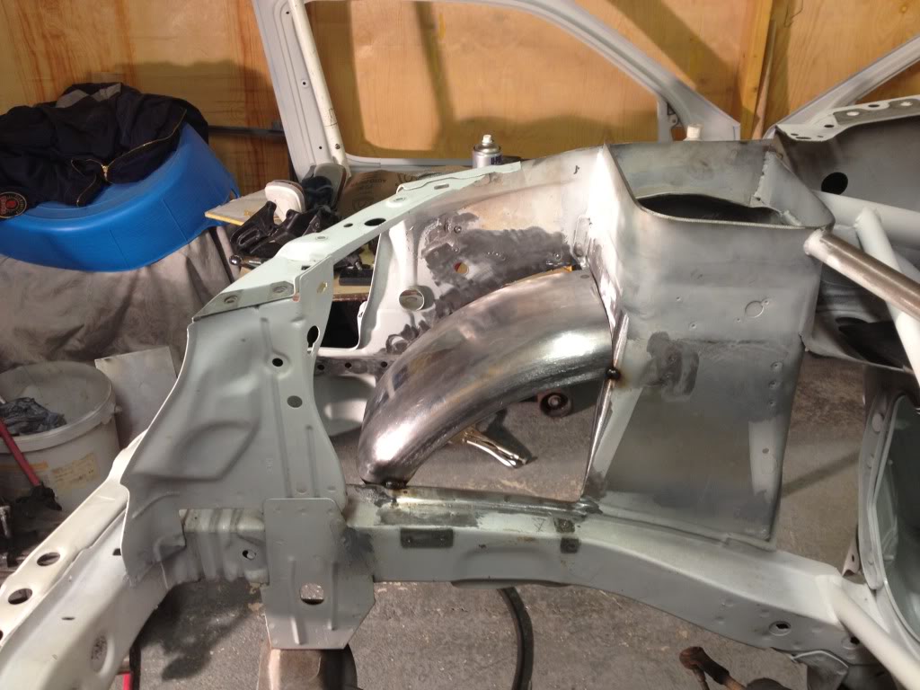

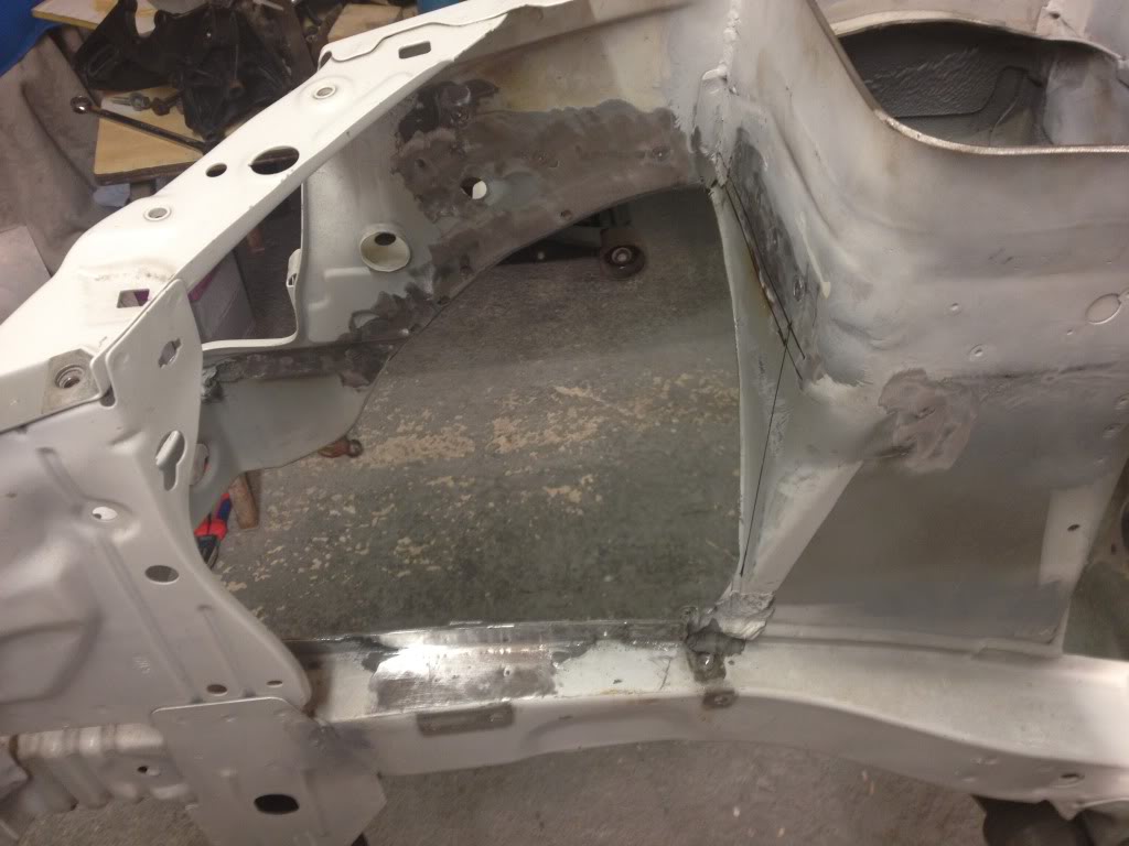

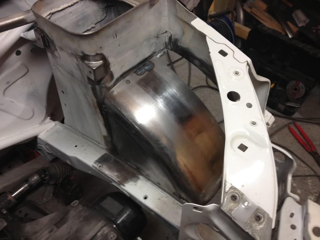

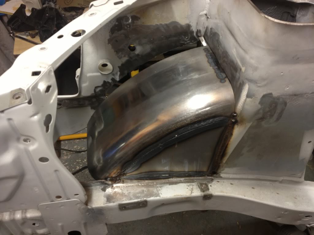

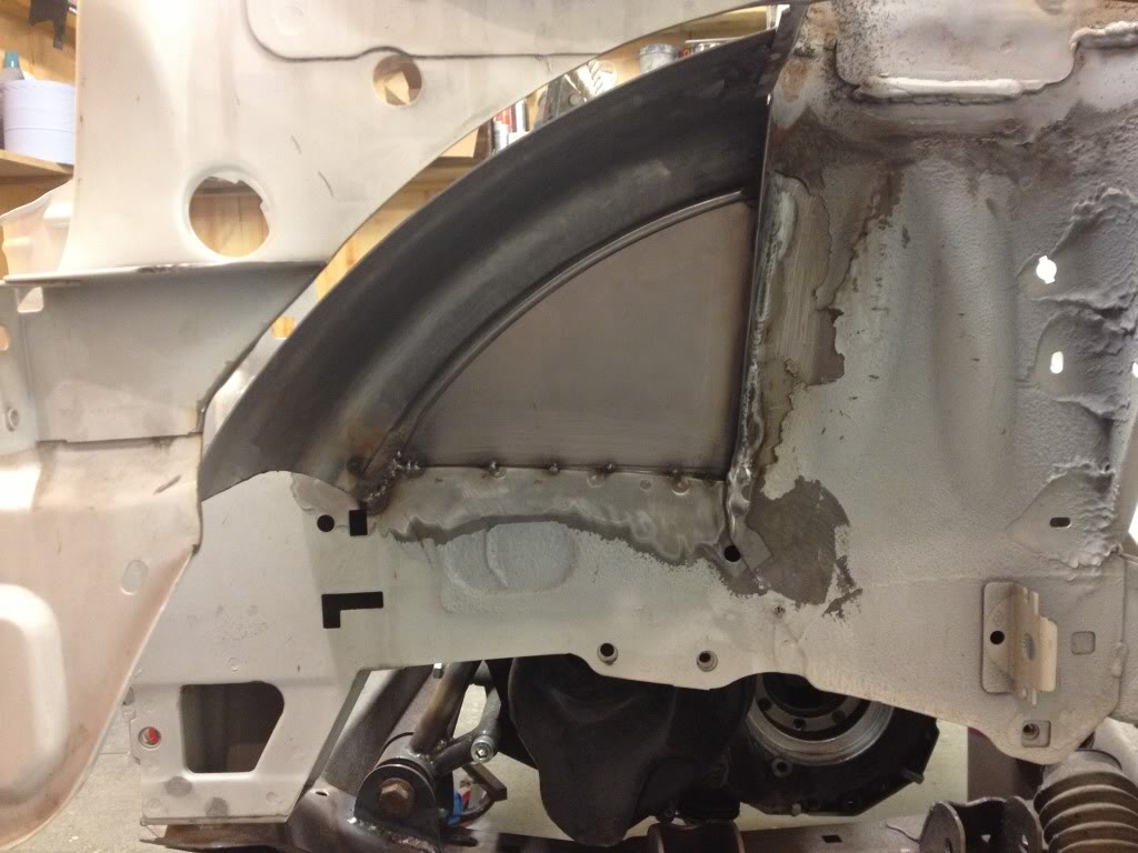

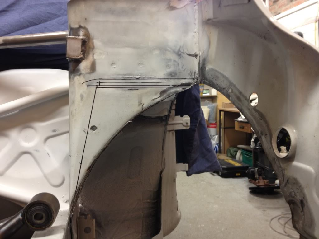

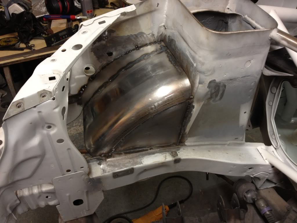

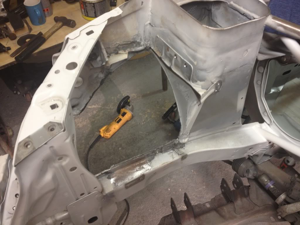

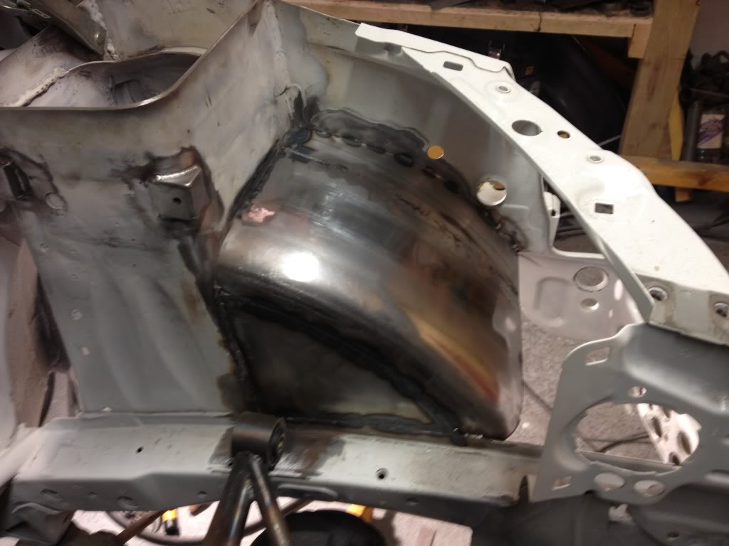

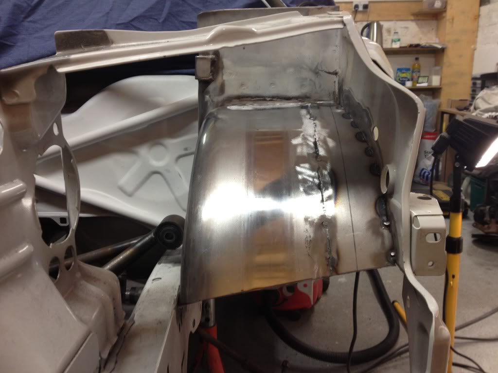

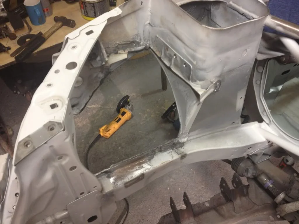

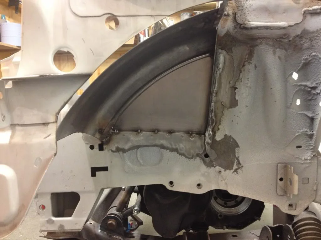

Assume your meaning the back of it, or the bit on the right as you look at it in that picture?

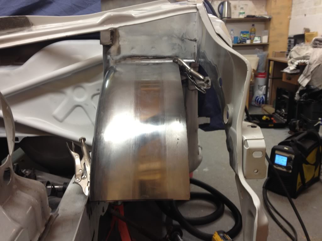

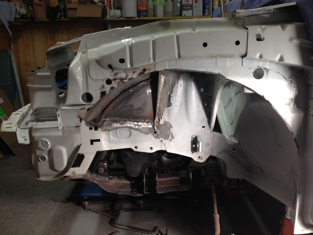

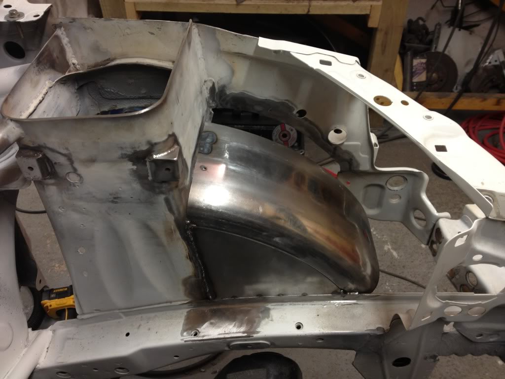

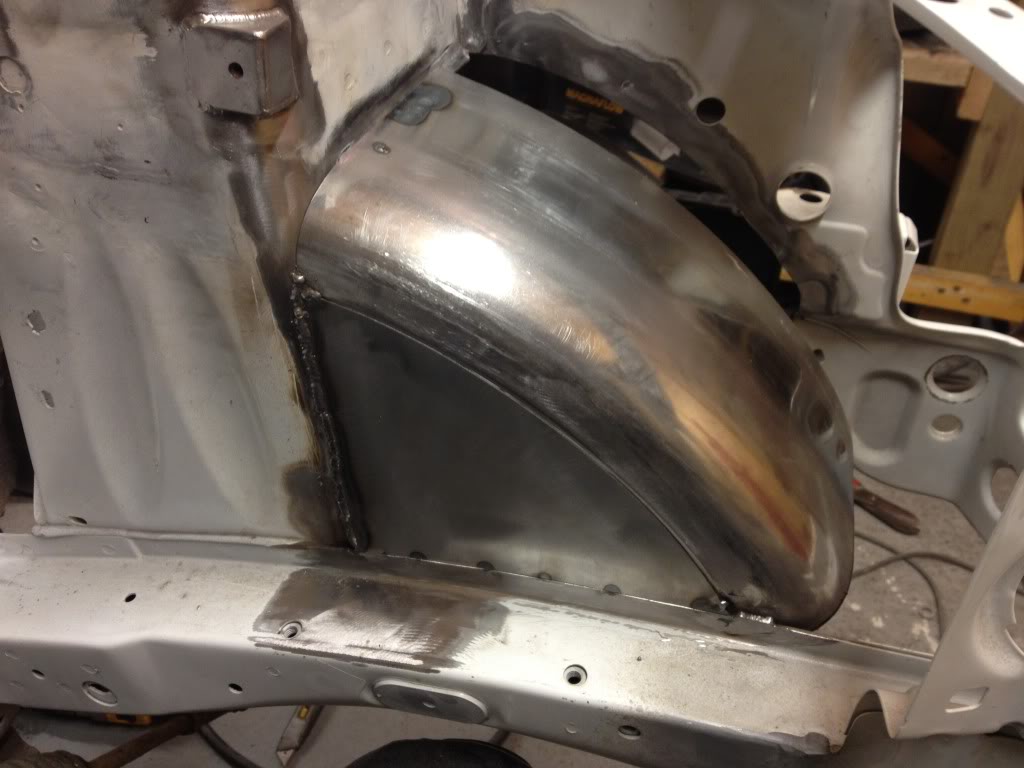

Most of the load on that part of the tower is in a vertical plane so removing those bits probably isnt going to hurt them too much, having said that I wasnt going to touch the back one unless I need to, already chopped most of the front one out as you can see from the earlier pictures but then i've added quite a lot of metal back in. I was quite surprised just how solid the new inner wing is, the rolled edge of the mudguard makes for a pretty solid structure once it's welded in.
Also the X bracing and the cage tie ins are going to greatly increase the strength of the towers.
