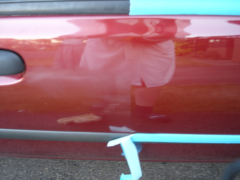

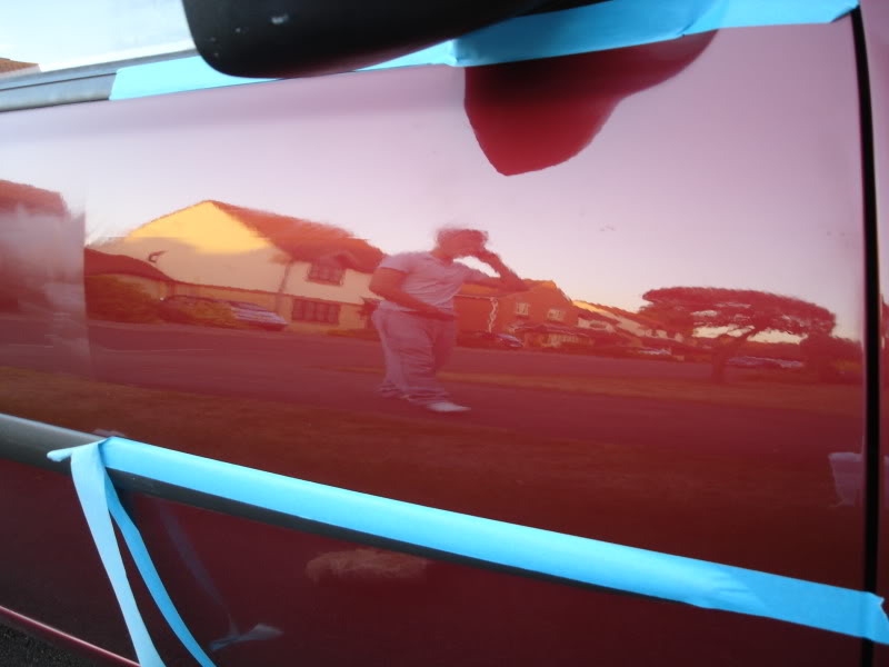

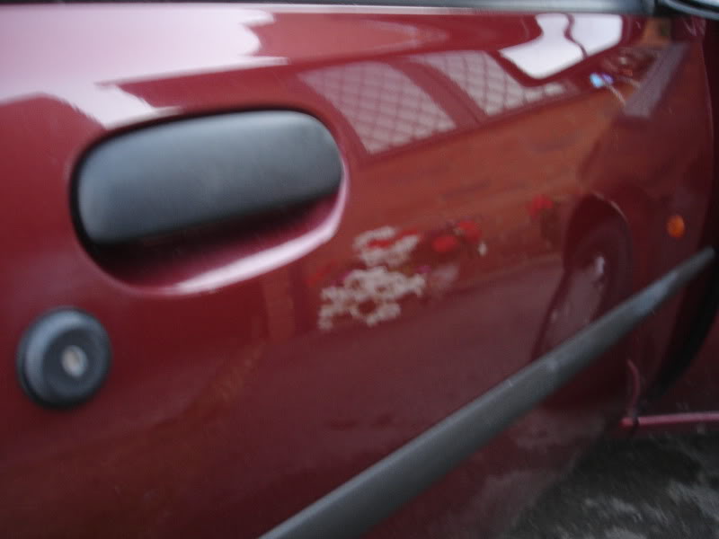

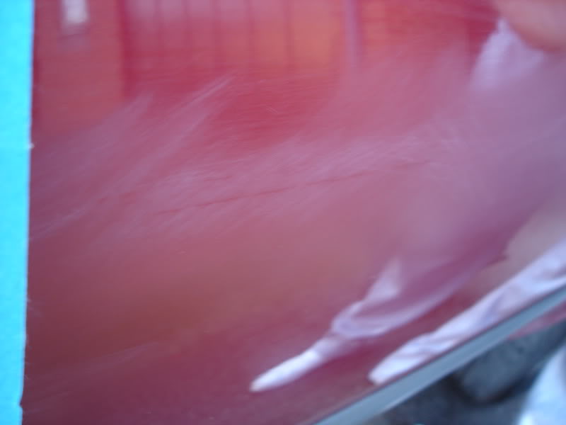

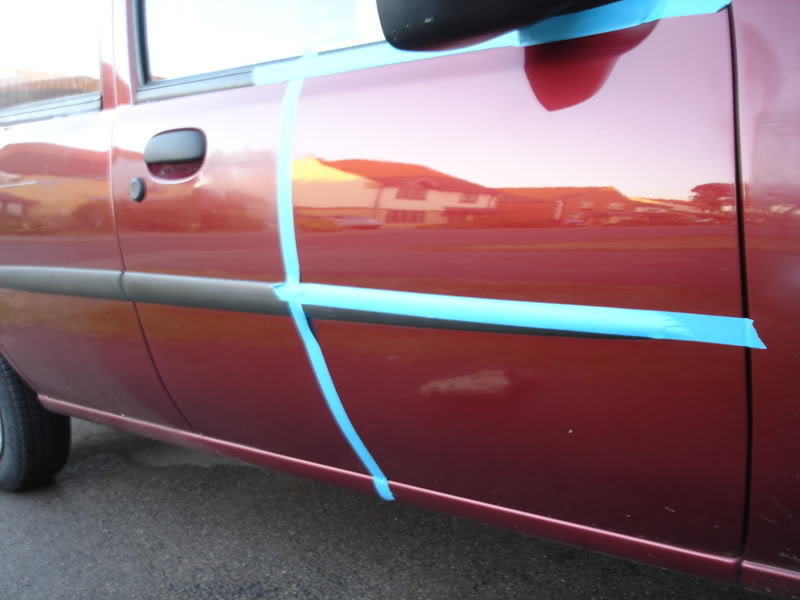

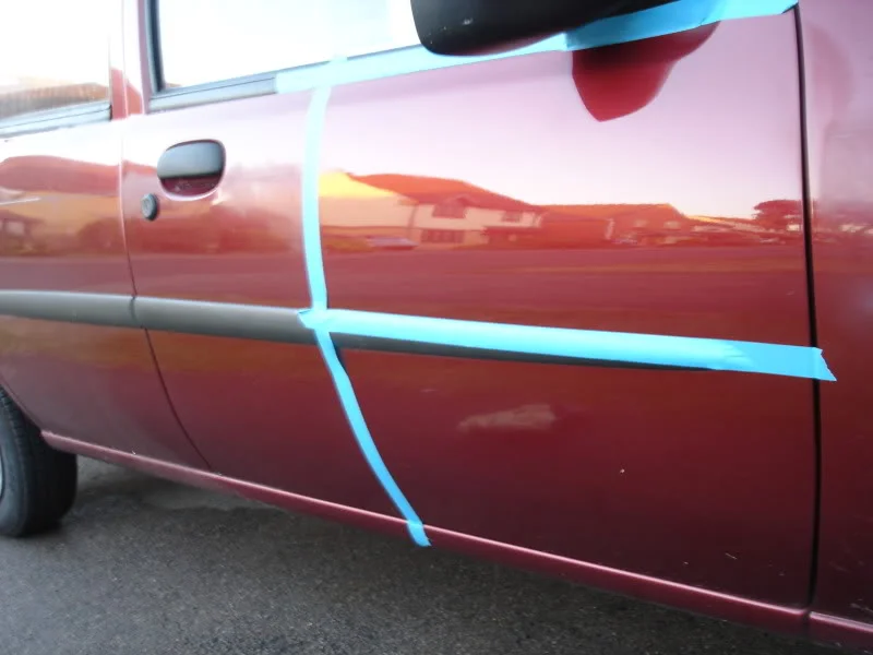

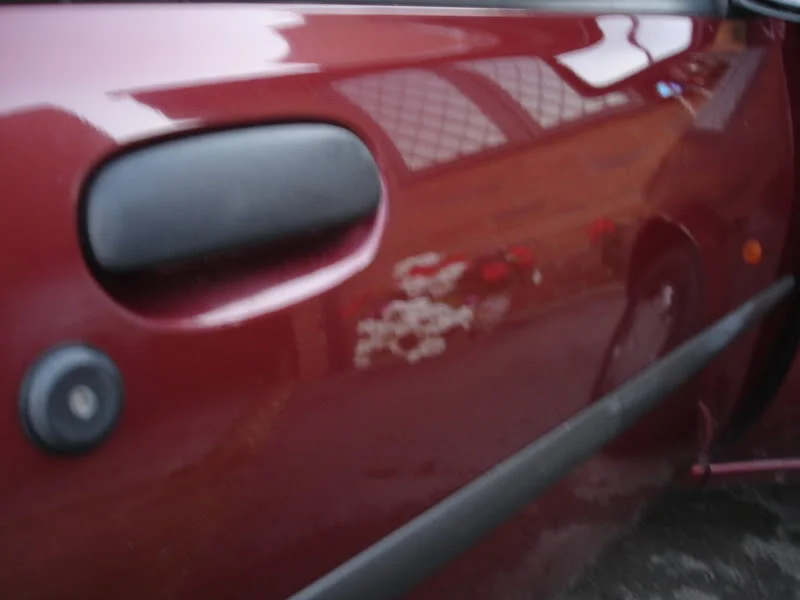

Had a very quick blast on a mates banger.
He took a scouring pad to it to get rid of some glue residue...idiot, he knows lol.
So I cleaned the panel and took a white pad and some power finish to it.
Went over it very briefly and I need some smaller pads which are on order.
Here we go:
