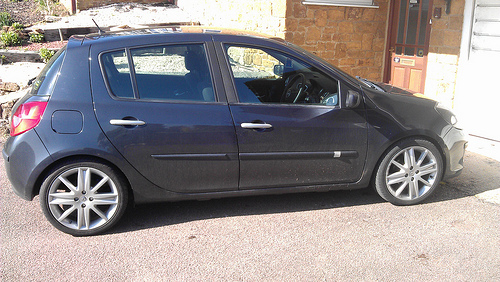

I've seen various threads about the MK2's, but my MK3 now with AP coilovers, is knocking at low speeds.
Noise is coming from the rear. I noticed the springs for the rears are very short. The adjuster is set at halfway at present, so my ride height isn't drastically low.
Untitled by johnpape83, on Flickr
Does it just need dropping, so there's more load over the back of the car at low speeds?
