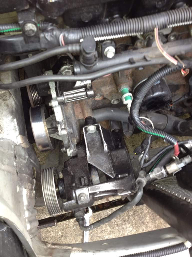

Also fitted the cup alternator setup, what a ballache! however I did notice a change in throttle response.
Going to have to get a custom power steering line made up as bending mine to fit the new set up is not ideal.

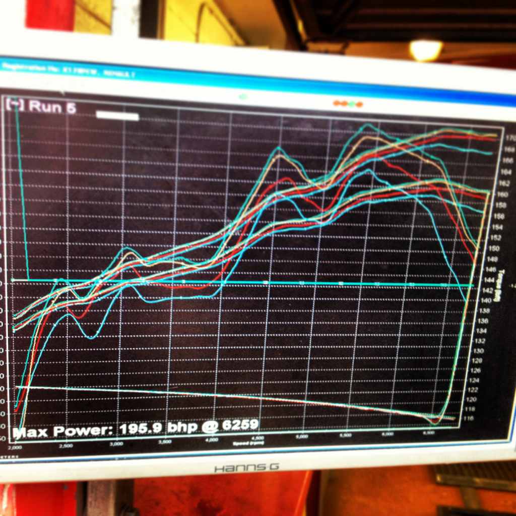

Despite electrical problems I made it to the rolling road today which turned out to be a real good laugh!
The ph1 made 195.9 bhp and 169lb/ft torque, the rollers were reading hi I believe as a friend ran at rs tuning few weeks previous and made 12bhp less, even with this correction it's around 180bhp which i'm over the moon with (no doubt people will argue with this)

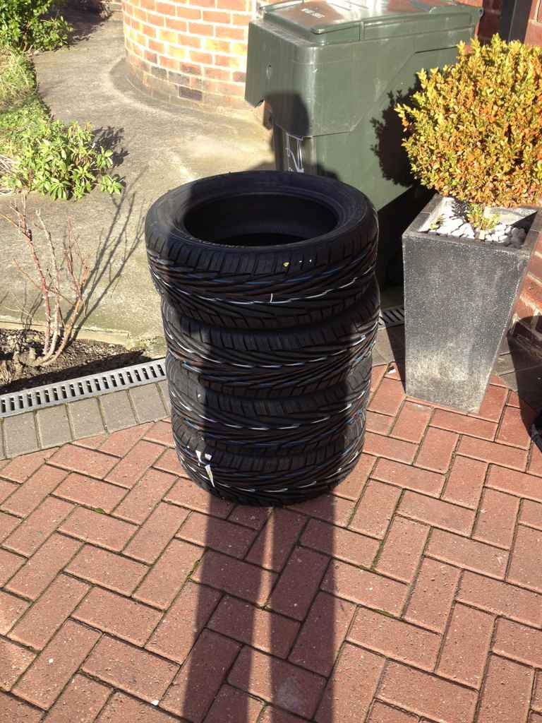

4 new uni royal rainsport 2's full alignment setup running 1 degree camber

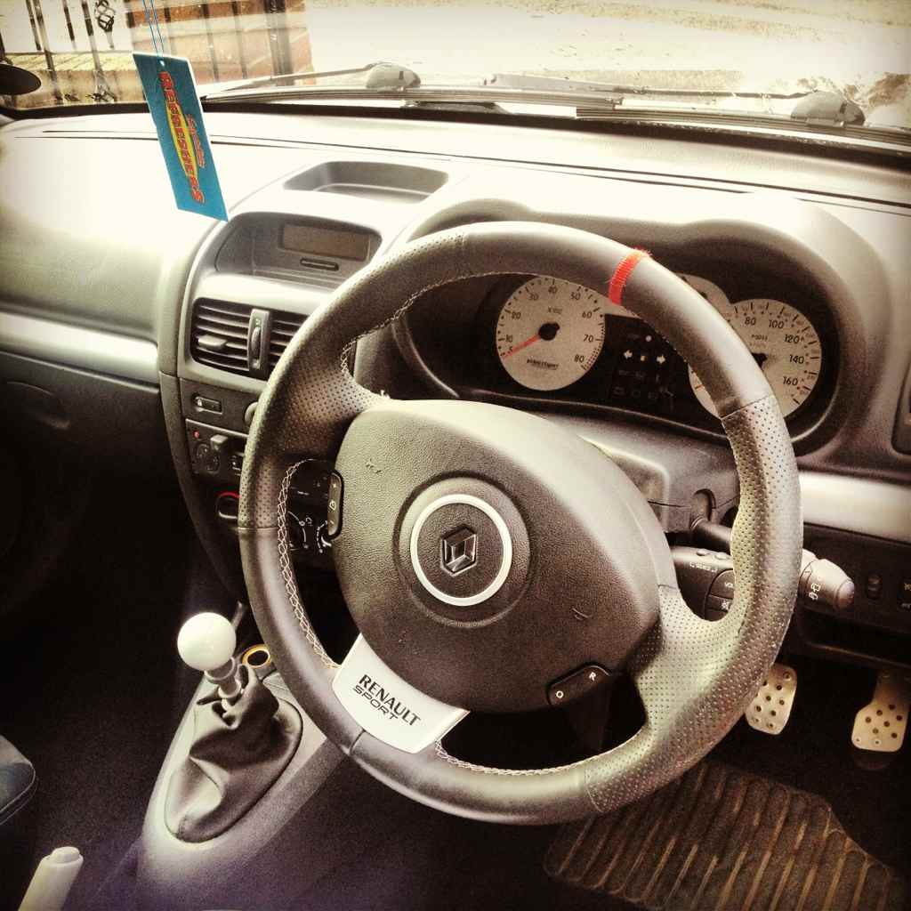

197 steering wheel

Looking good mate, Like the wheel. Thinking of a ph1 myself so will keep an eye on this.

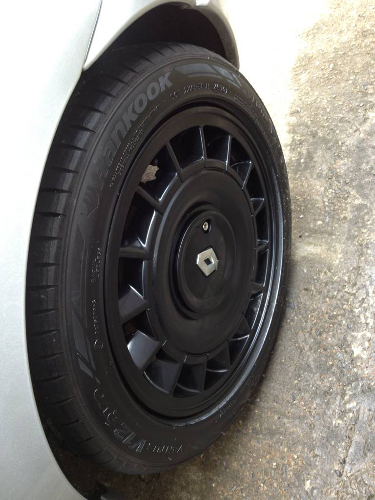

So, it's been a while since I've updated this, I'm not running satin black turbines with ph2 dynamic centre caps.

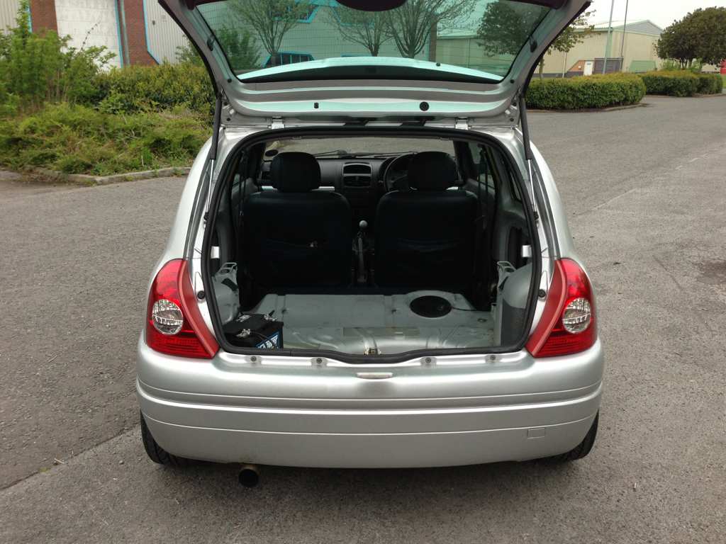

The rear interior is out and the inside will be painted titanium soon.

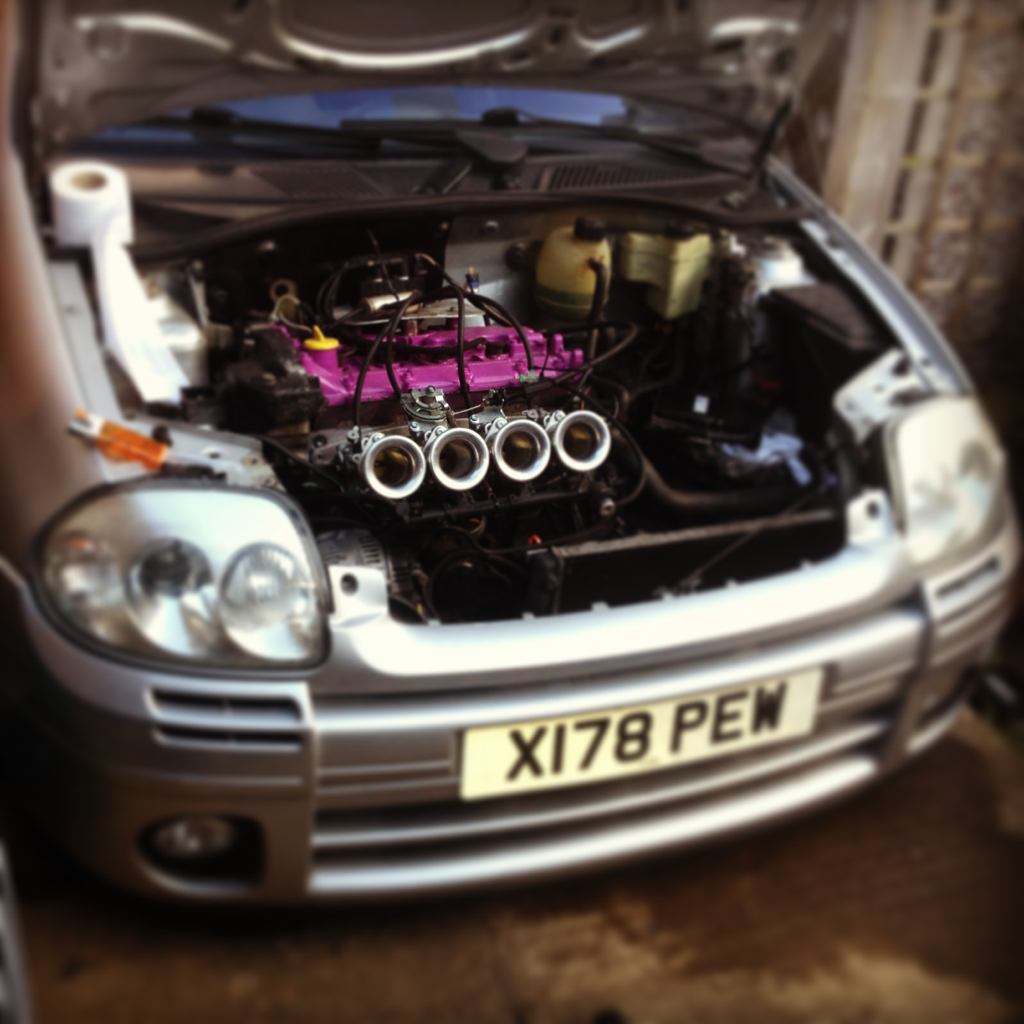

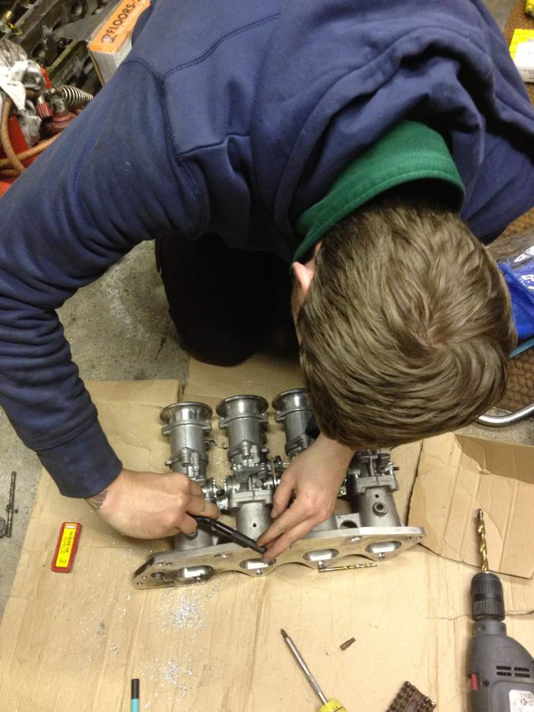

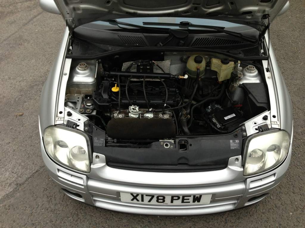

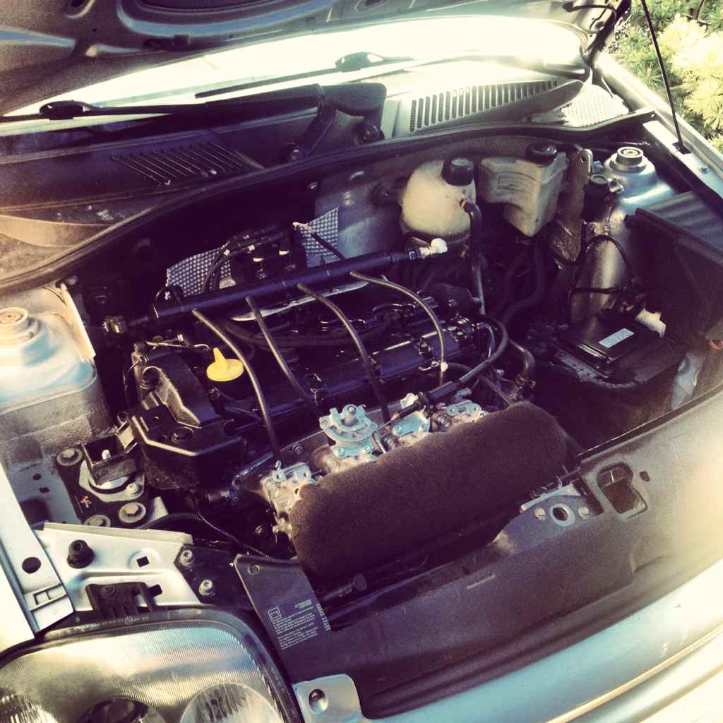

I also bought a set of boddies to run using a ph1 ecu set up, I have had them running but they need balancing, they are up for sale but I'm taking them to be balanced Saturday morning.

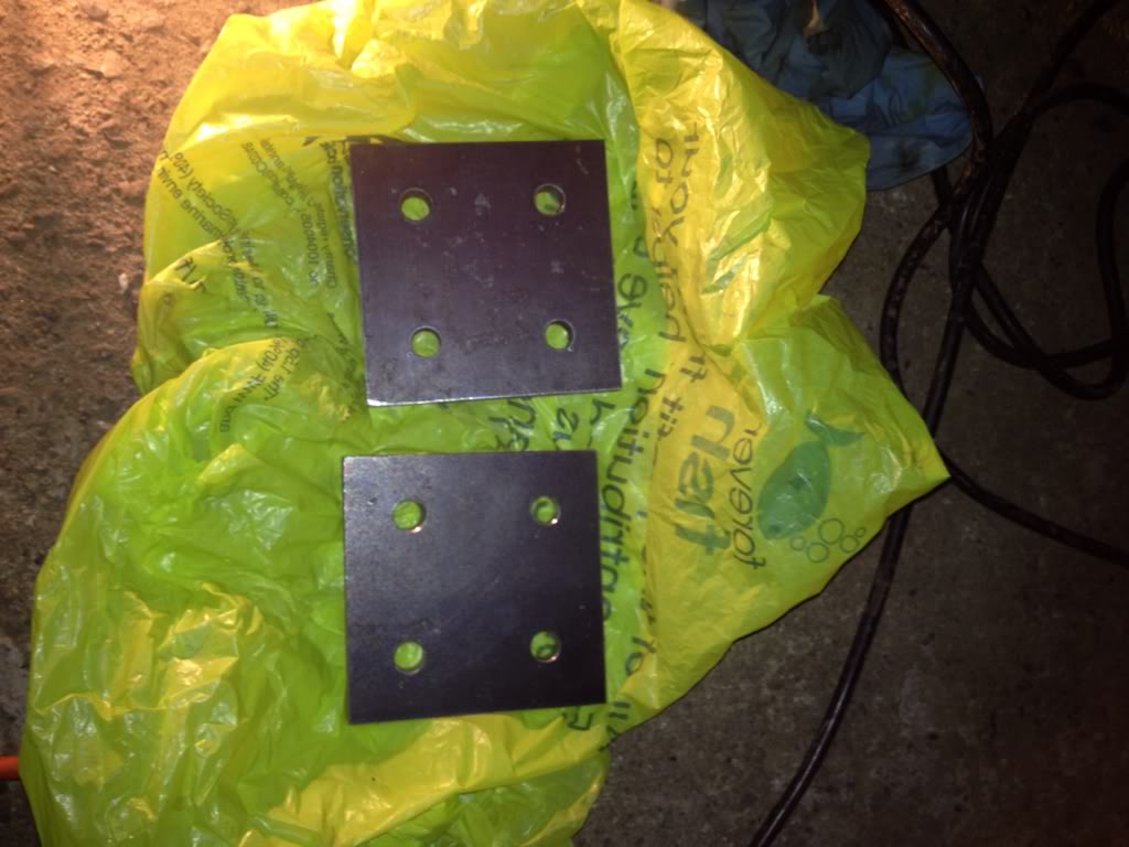

Big thanks to Craig for having a late night with me during the week to get them ready for the weekend, drilling and tapping them for take offs for the map tank, and trying to come up with idea's for the fuel rail. We made and adapter for the tps too!
A friend of mine is making the adapters for the filter In the machine shop from the cad drawing I give him too!

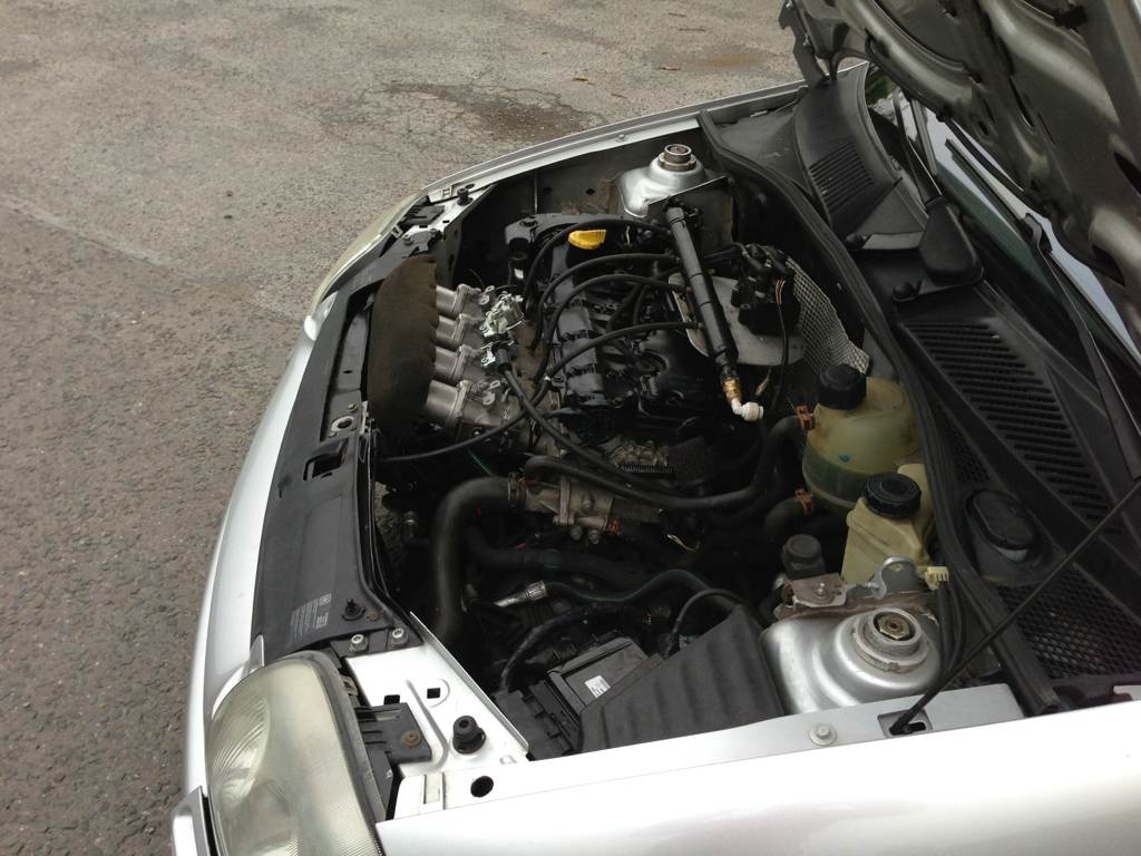

So the boddies are on and running, had a few little moments but with a few calls to Fred (btm), bit off topic but such a good guy, they were busy in the workshop and I didn't leave a answer phone message but he took it open himself to ring me back and help out and Paul from RsTuning who still helped even though they were meant to be shut when I rang! There pretty much sorted! I'll put a few miles on them and then go get the map tweaked. all I can say is 'that noise!'
Big learning curve on the throttle body frontier with balancing etc this weekend, my hands are cut to bits and my neighbours now hate me even more but had a laugh setting them up.
I now owe several beers out to everyone who's helped too!
And as a few of you might want to know, this full setup so far has cost me around £600 all in, it's by far not the best setup and driving under 2k is abit of a pig but compared to the 2k I could spend on jemvey's, I'm quite happy! I'll update with pictures and so on soon. And details of how mapping goes to!

Thats a whole bag of awesomeness.
What are the arse dyno figures?

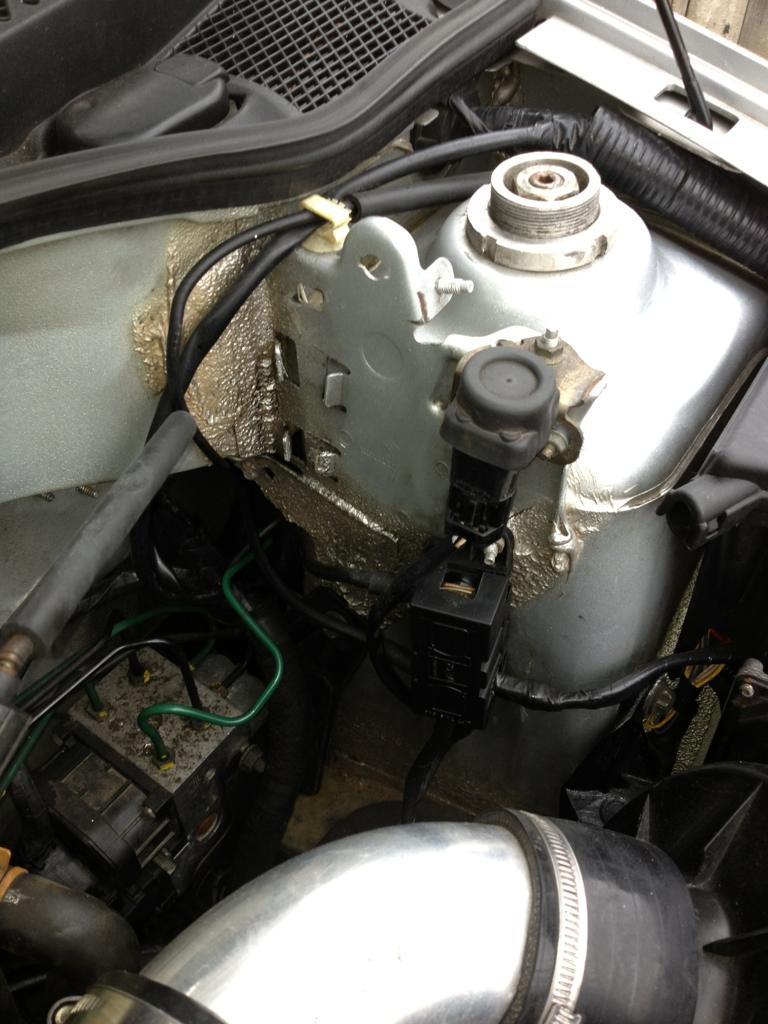

Went for a blast with Craig tonight an he instead we took a few pictures, it's abit dirty and the baffles in my exhaust were rattling. Also my map tank moved and a vacuum line came off so I need to jubilee the map tank down. There's a few little issues I want to sort before mapping to!

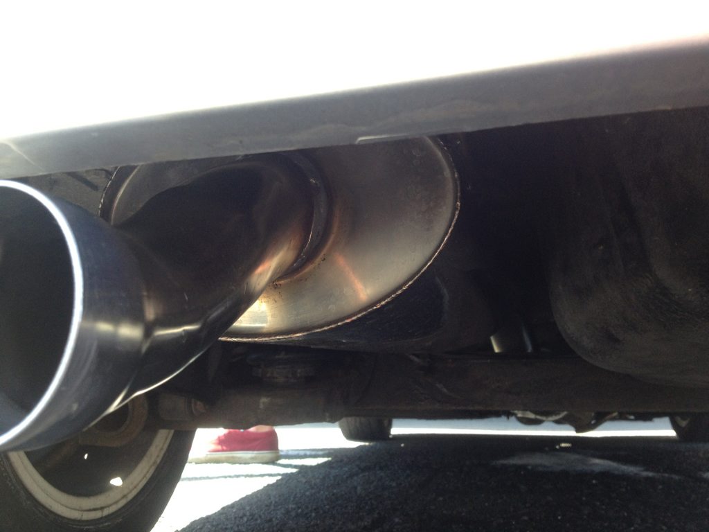

I have gone for a custom rear section from a local-ish company being done today, will upload a few pictures later, hopefully it will sound better with a working back box!
Pictures to follow!
Re: Titanium Ph1 172

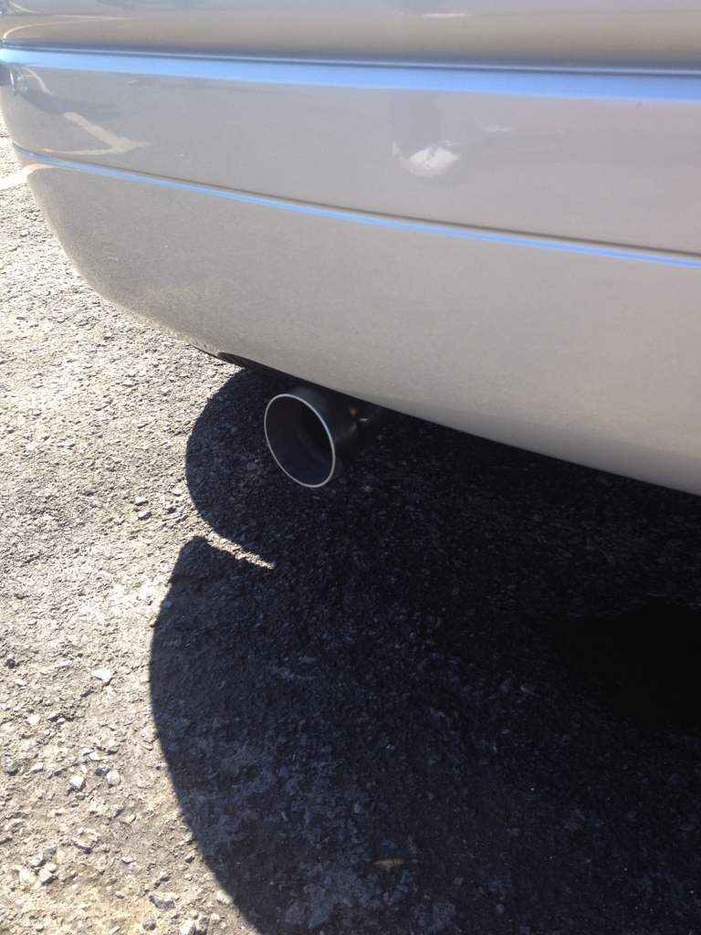

Custom rear section made, sounds so much better and no more rattling!

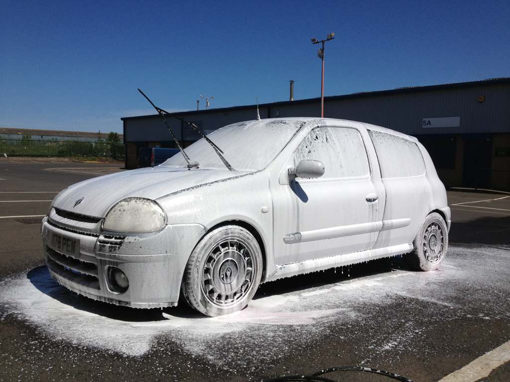

Popped to my mates detailing unit today and couldn't help but try out some new stock he had in.
Love snow foam pictures too!

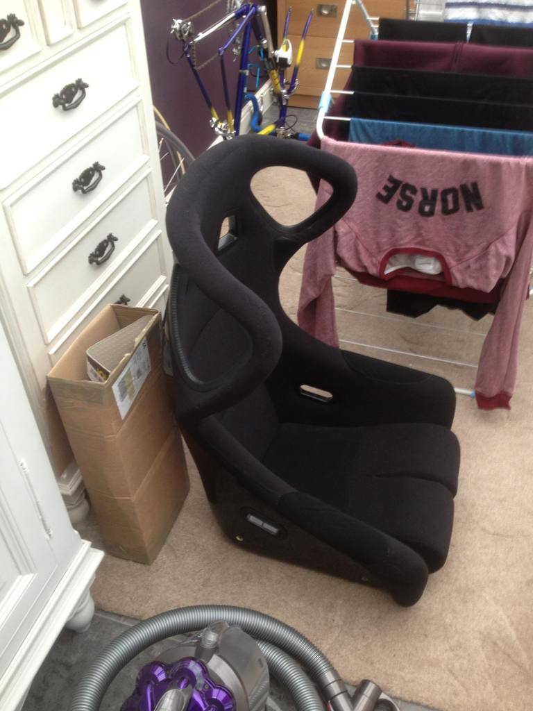

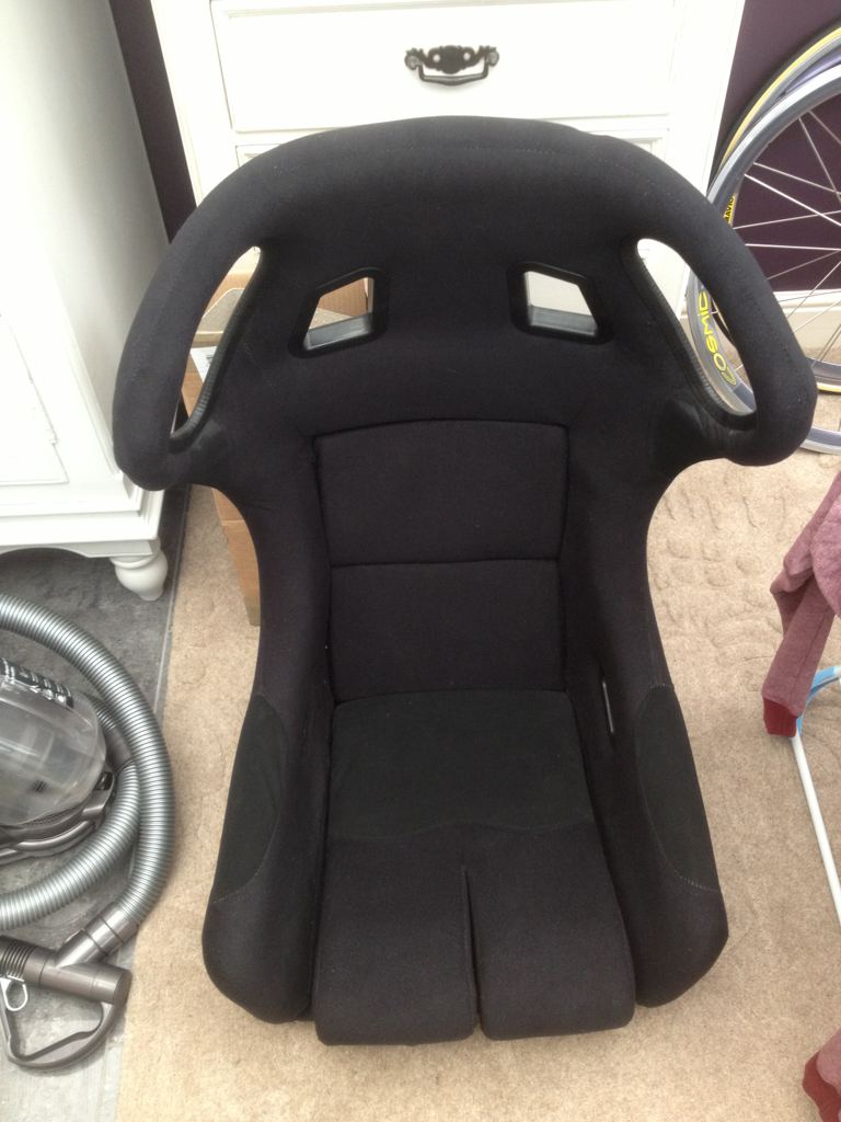

This arrived.
Omp side mounts and sanely harness arrived too but there still wrapped up, I'll be fitting it this weekend and if its comfy I'll order one for the passenger side, if not then something a little conifer will have to be looked at

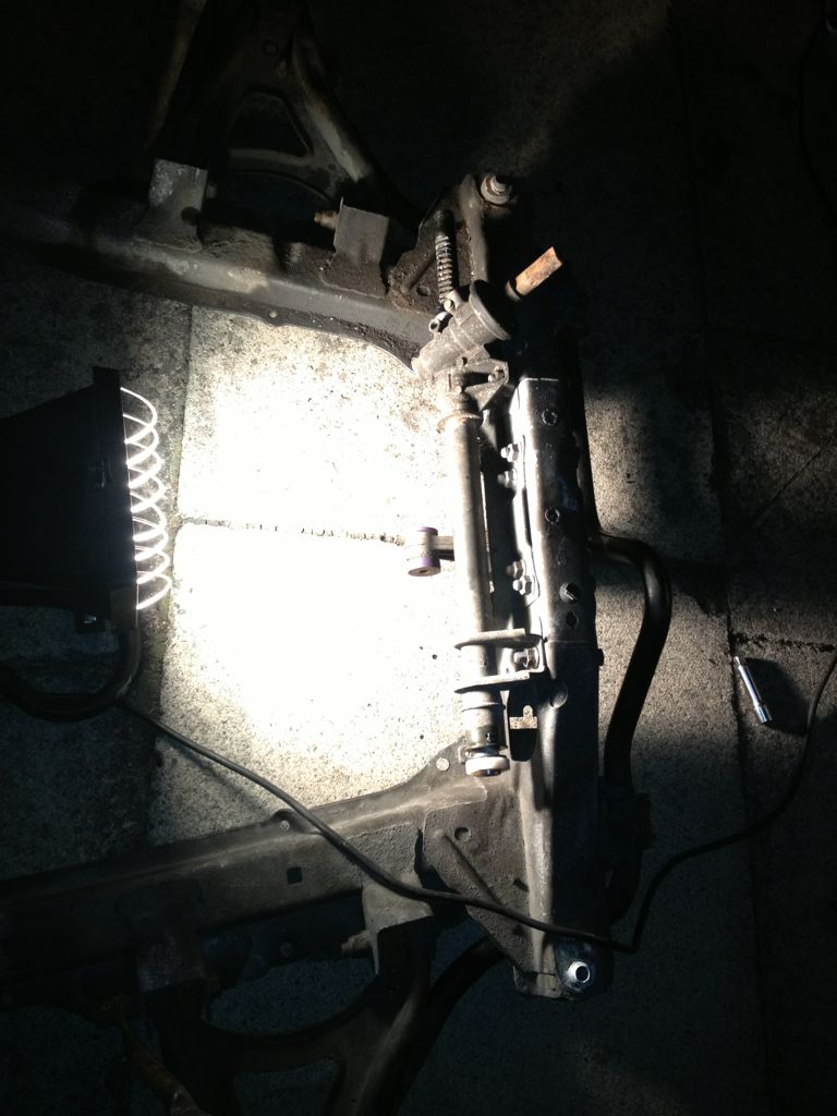

Just done around 21 hrs straight on the car, it's fair to say clio's have the worst subframe! my rear subframe captive bolts managed to snap as I was lowering it so I could change the rack for the epas conversion and then I didn't have enough strength on my own at about 4am to lift it back up. But eventually got there and got it all finished, what a mess about, I just hope it's worth it!
I need to have the tracking done tomorrow and then I can have a good drive out!
Whilst I was messing about I did a oil change and gearbox oil change as I don't think that had ever been done!

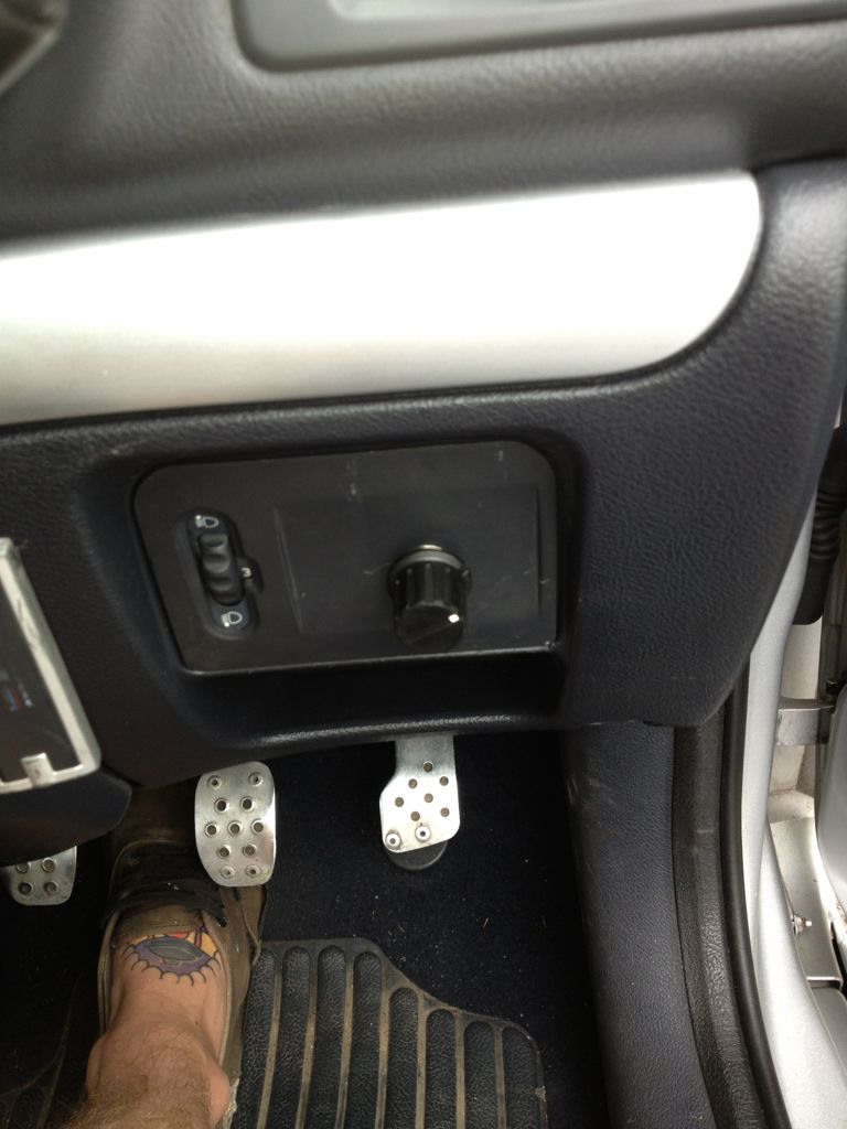

Regrettably the only place open to get the tracking done today was quickfit, but the one near me now actually has a hunter laser alignment system! I'm running 1 degree camber 1.31 degrees caster and 1degree toe in up front, the rear has 1 degree camber shims.
Overall the epas system totally transformed the steering of the car, everything feels so much tighter, if you can be bothered to do it I'd definitely recommend it!

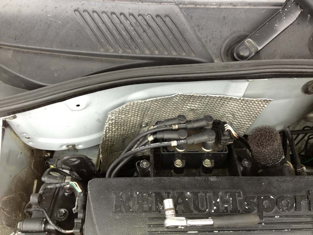

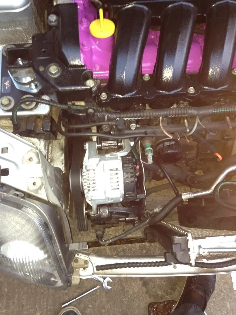

Did a few bits this weekend, big thanks to Craig for the help!

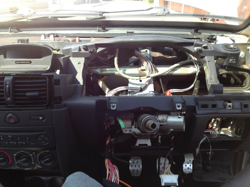

Got a few snaps of some of my epas adjuster and my wiring in the engine bay showing how clear the bay is now

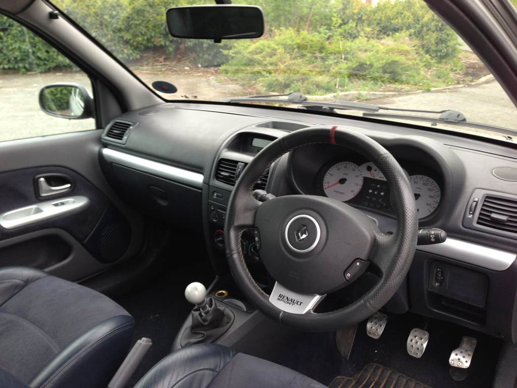

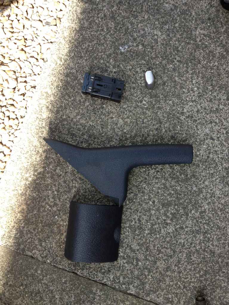

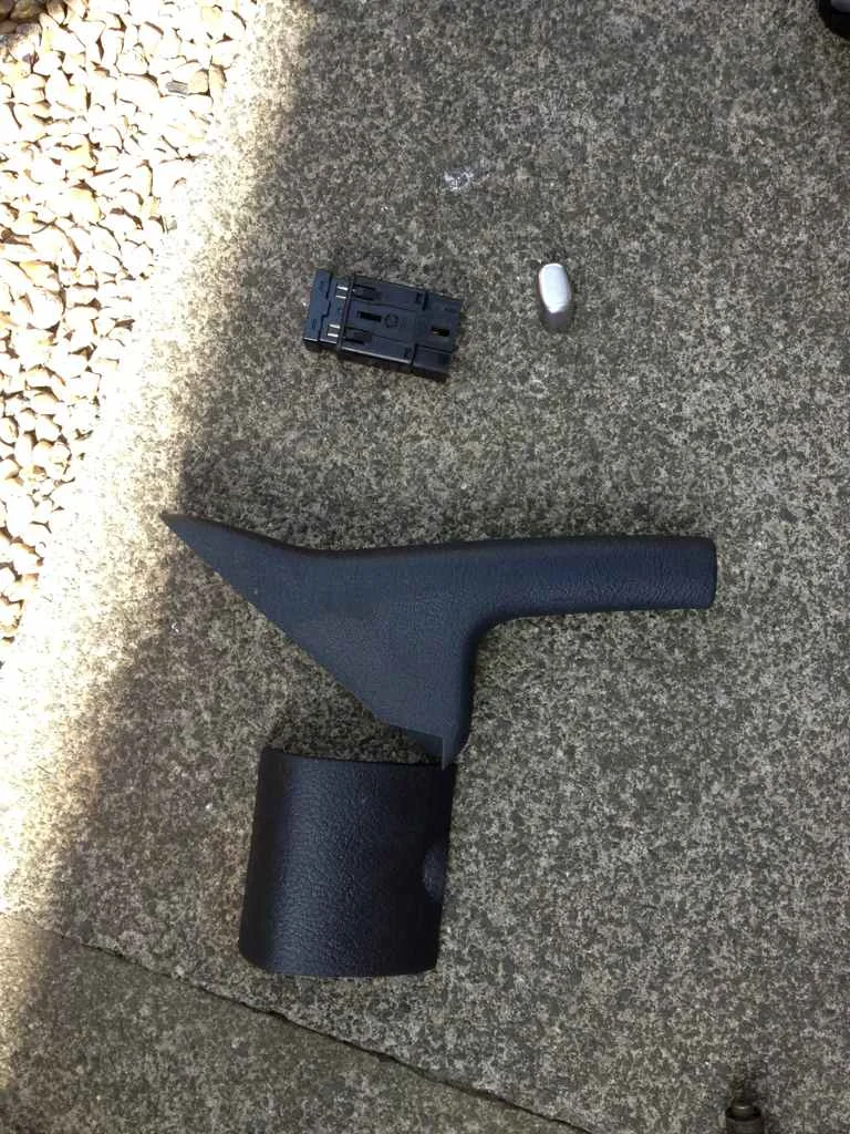

Managed to get hold if the ph2 172 handbrake cover and button and a few plastic bits of trim that I didnt manage to get when I converted the dash too!
Got a bulk head plate off a ph2 without air con too as mine was removed, give it a quick spray if silver as that was better than black! it nicely covers where my old air con pipes were too!

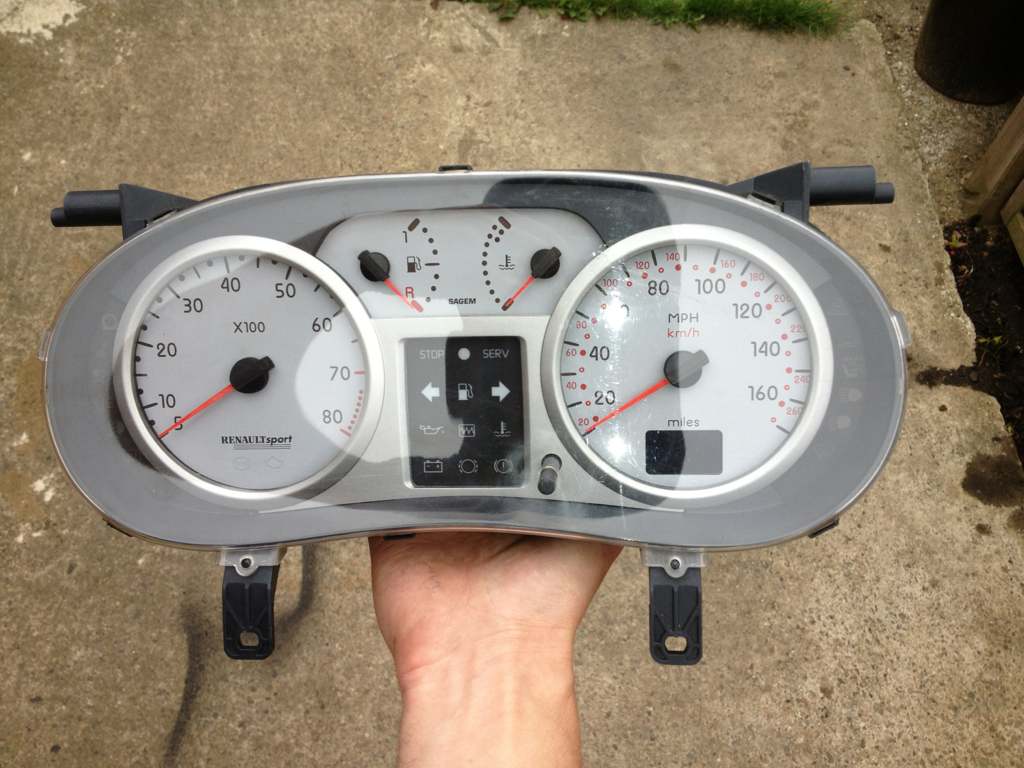

Split some ph2 clocks I had got aswell with the ph1 ones so I could have the silver surround, they now sit properly in the ph2 dash aswell

What was involved in swapping the dial surrounds?
Cheers mate!
Erm there's around 8 t10 torx screws in the back of the clocks, just take them out on both sets, unclip the front plastic cover and swap them over, it's simple when you have them both apart mate
