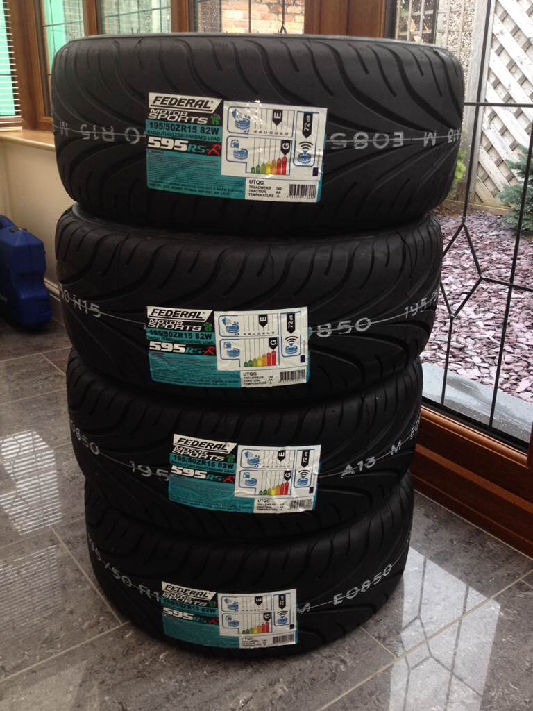

I attended a rolling road day but the car kept spinning on the rollers as the hancook v12 tread blocks have gone super hard. A set of federal rs-r's have been ordered which us just what it needs!

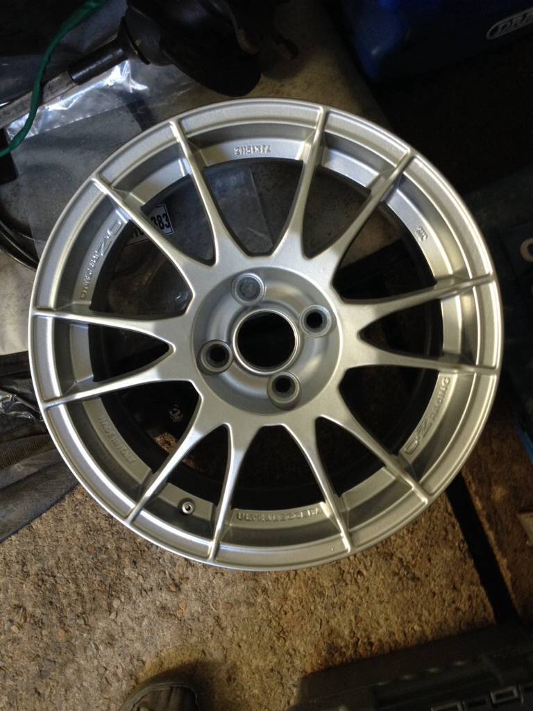

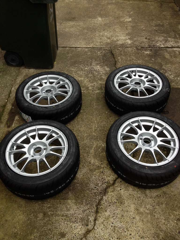

So had a little trip to Milton Keynes this week whilst I was off to pick some oz ultralagarra's up 15x7 and they weigh around 5kg a wheel which feels like nothing. Just waiting for the rsr's to turn up now!
Ordered a set of carbon centre caps too so hopefully they will arrive shortly
Had a few cans of titanium paint mixed by halfrauds and started to go over them untill I decide to get them done properly or not.

Tyres arrived yesterday so I finished painting the wheels and got them fitted, will get Pics of them on the car once the weather clears up!

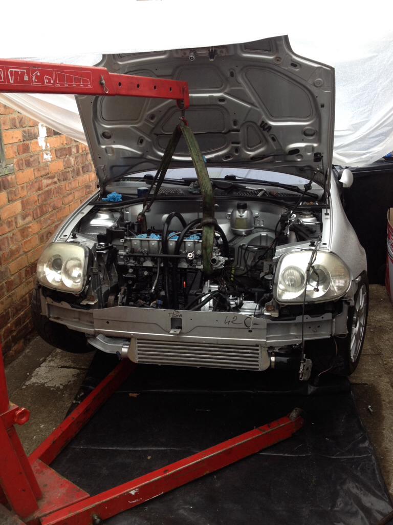

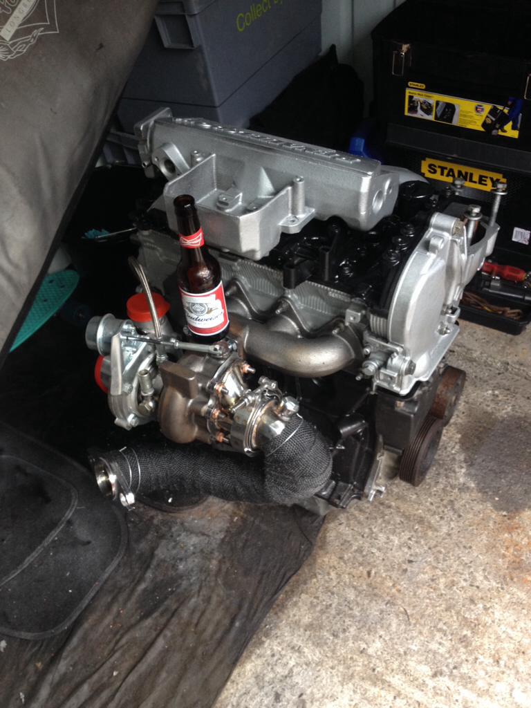

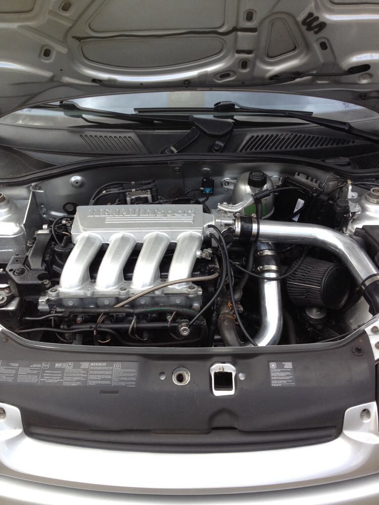

Over the past few months I've been building an engine ready for boost, ph1 172 block and head, megane internals, arp fasters. The intention was to run around 280/300hp which I think is the most power if ever want in a fwd car!
The spec was engine above, engine dynamics log manifold and turbo, custom 2.5" intercooler pipework & intercooler, custom downpipe, 490cc injectors, forge 002 valve, adaptronic standalone management system, helix 4 paddle clutch!

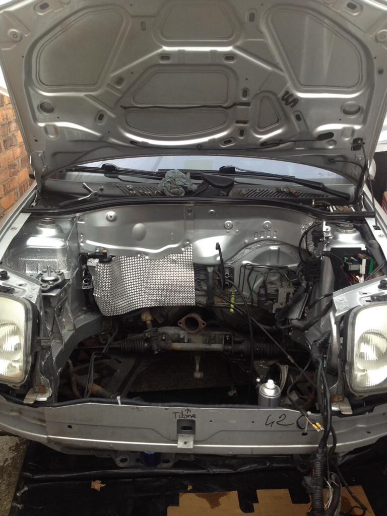

I set about putting the new engine in and it pretty much went ok, however after warming up for the first time the engine stopped dead almost asif there was a electrical fault! as you can imagine I was pretty pissed off at this point and couldn't fathom what was wrong! after a couple of hours trying sensors/checking timing etc we decided to try turn it over manually by hand, 2ft breaker bar and 2 15 stone guys putting pressure on it and it wouldn't budge.
The inevitable happened, that engine came back out! we stripped the sump off and began to check everything over only to find that big end bearing 1 had seized solid! swarf that appears to have come from the oil gallery had caused this.
I have am eating with the machine shop today to discuss why they haven't provided the service I have paid for and why dead was left in the gallery! Pretty furious to be honest!
At this point my head was up my arse and I was about to give up boost all together but with a bit of help from friends I decided to boost the standard ph1 engine untill I had sorted the other engine.
So a new cambelt was put on my engine and the sump pulled off so the block could be drilled and tapped for the oil return from the turbo and we set about putting it all back in!

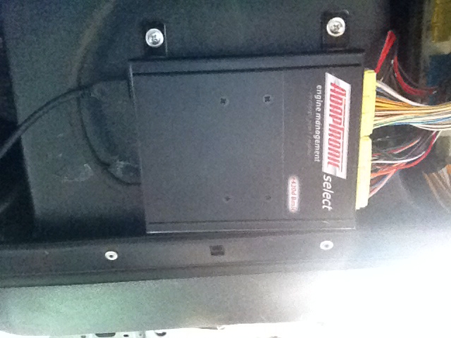

Yesterday I went up to Andy's (ClioTurbo.co.uk) the have the adaptronic installed and base map, currently mapping looks like it will be next week after we cancalled my slot on Thursday due to the other engine seizing!
I'll update this after mapping with numbers. Tap stalk won't let me upload photo's anymore so I'll get some up when I'm on the computer next!
Big thanks to Owen, Andyrg, kris, Craig, Thirkell and James (most are on here) for there efforts this week, I would of been riding the gsxr about instead if not!
I will be building the engine up again and most likely modifying the spec a little!

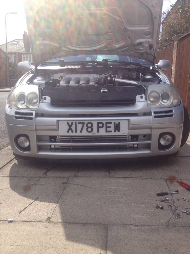

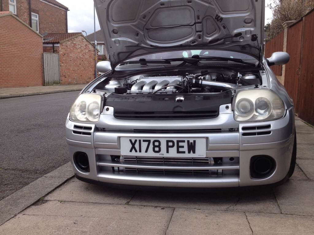

Good work! Was gonna tell you to straighten the intercooler until I saw that last front end shot. Looks tidy.
cheers guys, Has been a love/hate relationship with this car! but feels like its worth it now.
WilkyWay it was mounted over to one side at first for ease of boost pipe routing but after getting grilled about it off a few people i moved it to the centre and modified the pipework to suit.
Does anyone have a problem with a really hot engine bay with turbo'd clio's? Any solutions?
You'd be able to put some sort of vent in the bonnet to pull the air out when driving along. Mine does get hot but nothing to worry about. As long as your intake temps are good and nothing is melting then you should be alright.
Have a look over to Durham if you like, luckily the number 1 Clio turbo specialist in the country is just along the road from you ;) ClioTurbo.co.uk
WilkyWay, inlet temps arnt too bad mate its just the actual heat in the bay when sat still that concerns me, i may remove some of the black front frill and just try get a bit more air in there on the move too!
Tom-173, andy did it for me mate but with the pin out diagram it wouldnt be difficult at all!

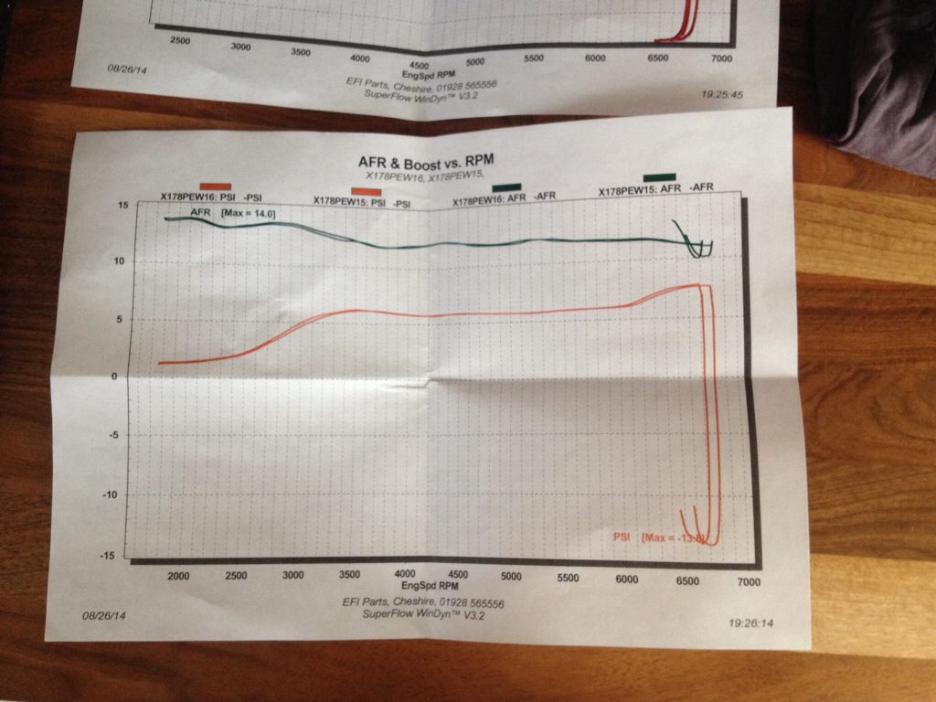

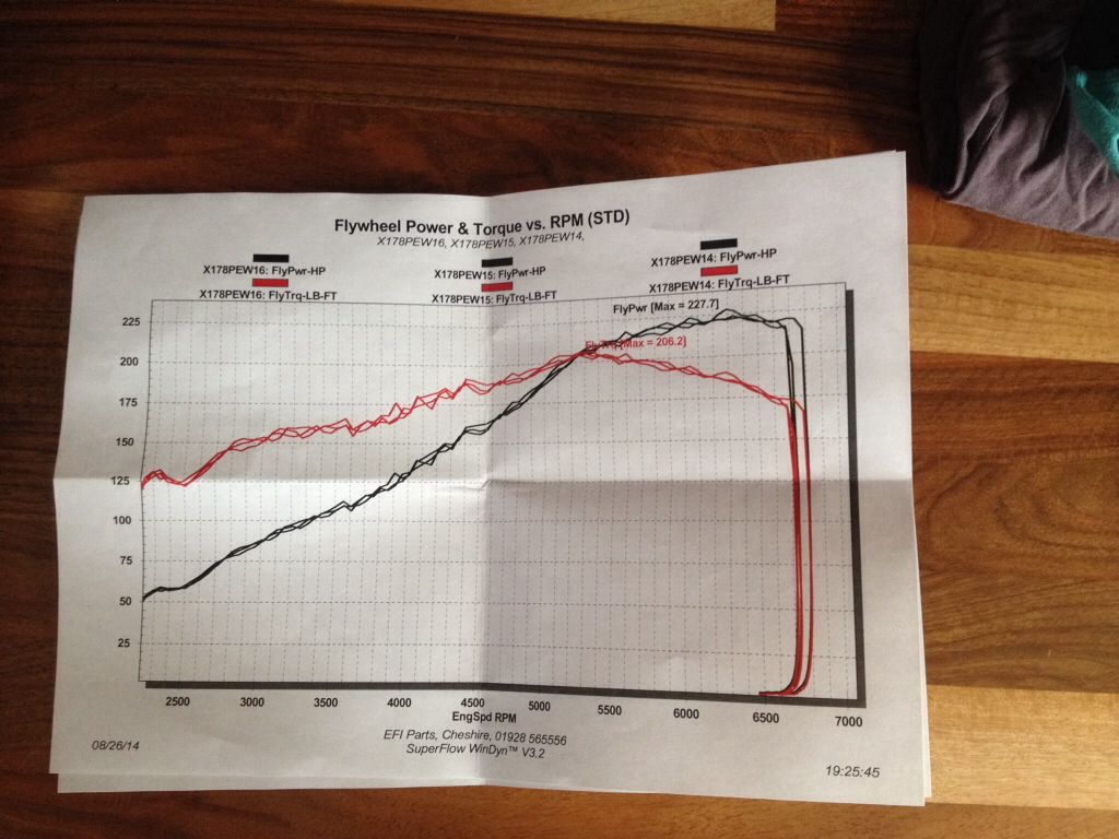

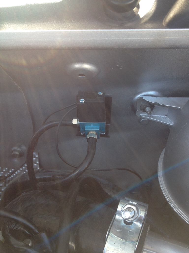

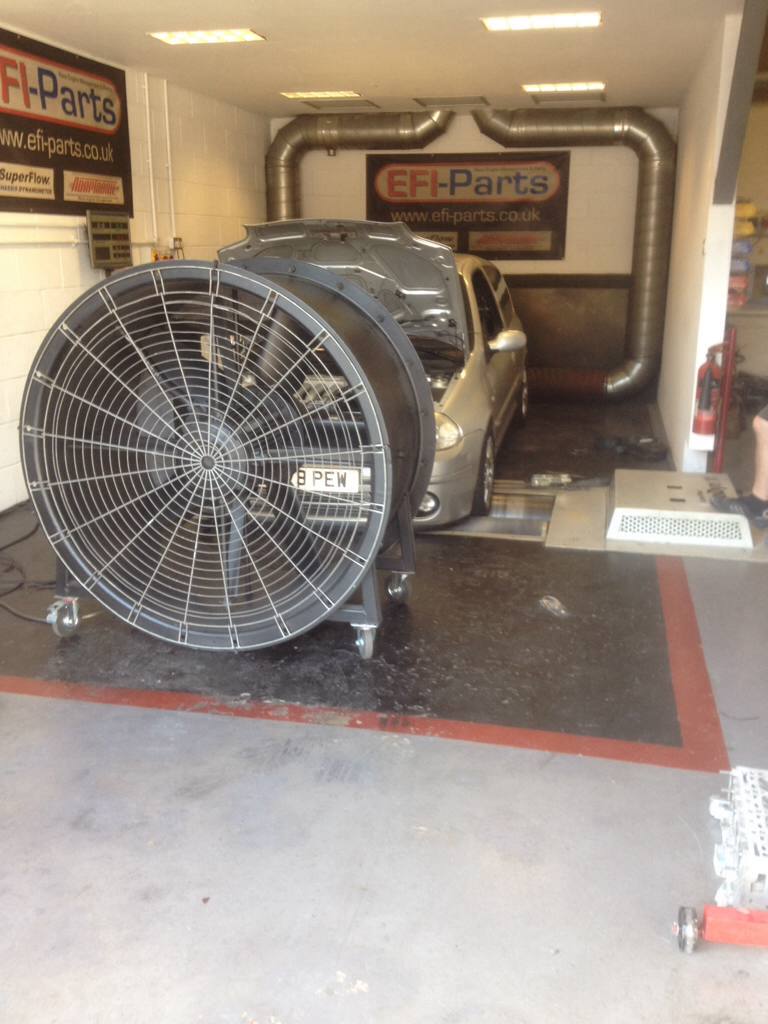

So the car was mapped over at efi parts this week, it made 227bhp and 206ft/lb torque, the power delivery is unbelievable, it almost drives like na the boost is set up that well. Opted for a mac 3 port solenoid valve controlled by the ecu so that it wasn't just actuator controlled.
Anyway, today I had a few issues to sort, an oil leak coming from Vvt solenoid a bracket for the mac valve and brake ducts to fit.
Just waiting for harnesses to arrive now as I'm running both the wrap round seats, will get a few pictures tomorrow but I have a few daft ones for now .
Photo of how the bay currently looks, note the map feed for ecu, fpr and dump valve now all have there own barbed fittings
