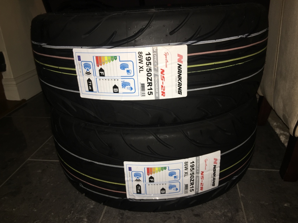

Not updated this for a while, after fitting the new cup shocks and springs the tracking was out and scrubbed the two front rsr's off, fitted some ns2r's yesterday and tracked it up this morning, then I took a trip to clio turbo to pick my pms shifter up, after helping out Owen with the mad 197 turbo and haveing a catchup with the lads Andy kindly let me use the ramp to fit the shifter, with his help, it took about half an hour to fit, the result is crazy, it's soooo much better than the standard setup!

how you finding the nankang compared to the federal, gunna need to replace two of mine ive killed off

Haven't drove hard mate but imagine them to be the same, tracking has made it feel nicer though, just found out r888's are on offer at the moment though, would of bought those if I'd of knew! might buy a set ready for summer!

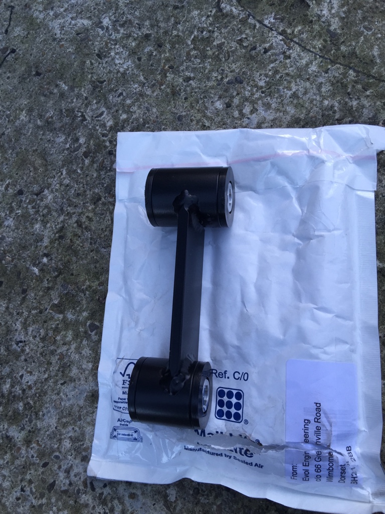

Got round to fitting my solid evol dogbone mount at the weekend and lowered the drivers seat a little for a nicer position, I put carpet back in too!

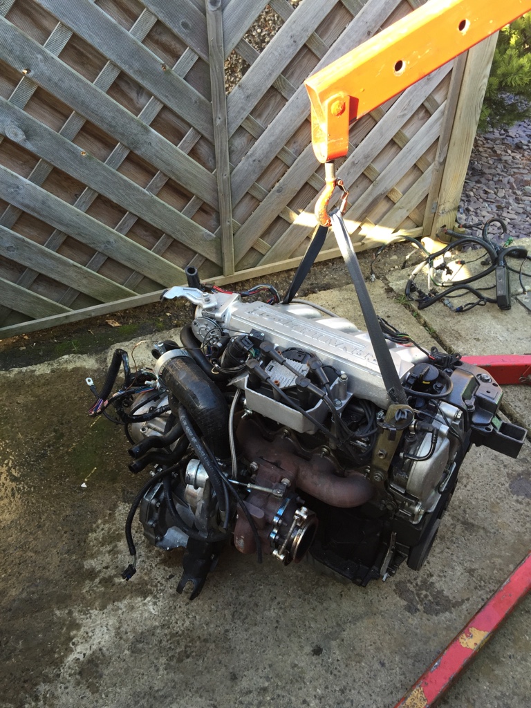

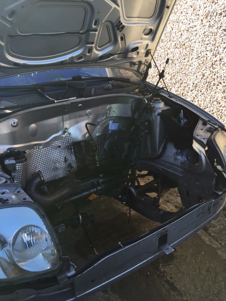

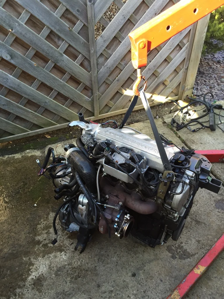

Set a new personal record of getting an turbo'd engine out on my own of 1.5hrs which wasn't bad I though!

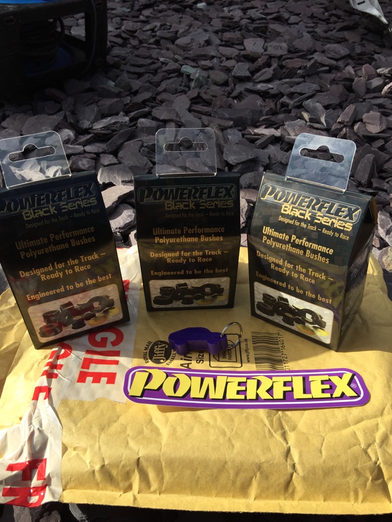

Whilst the engine was out I polybushes all the subframe with power flex black series, they were a nightmare of a job to change, so tight! the engine was given a new valeo clutch a new induction set up, ngk plugs, oil and filter, box oil, coolant and the block and box repainted. I had found play in my dci rack I had before for the epas and built up a looped rack with black series bushes to replace, on inspection of the dci rack the mounting points had bent, I'm not sure if this is down to sticky tyres and an aggressive geo setup as it's never been damaged.

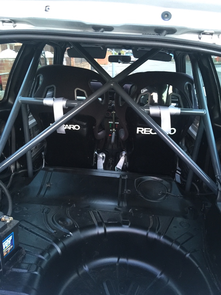

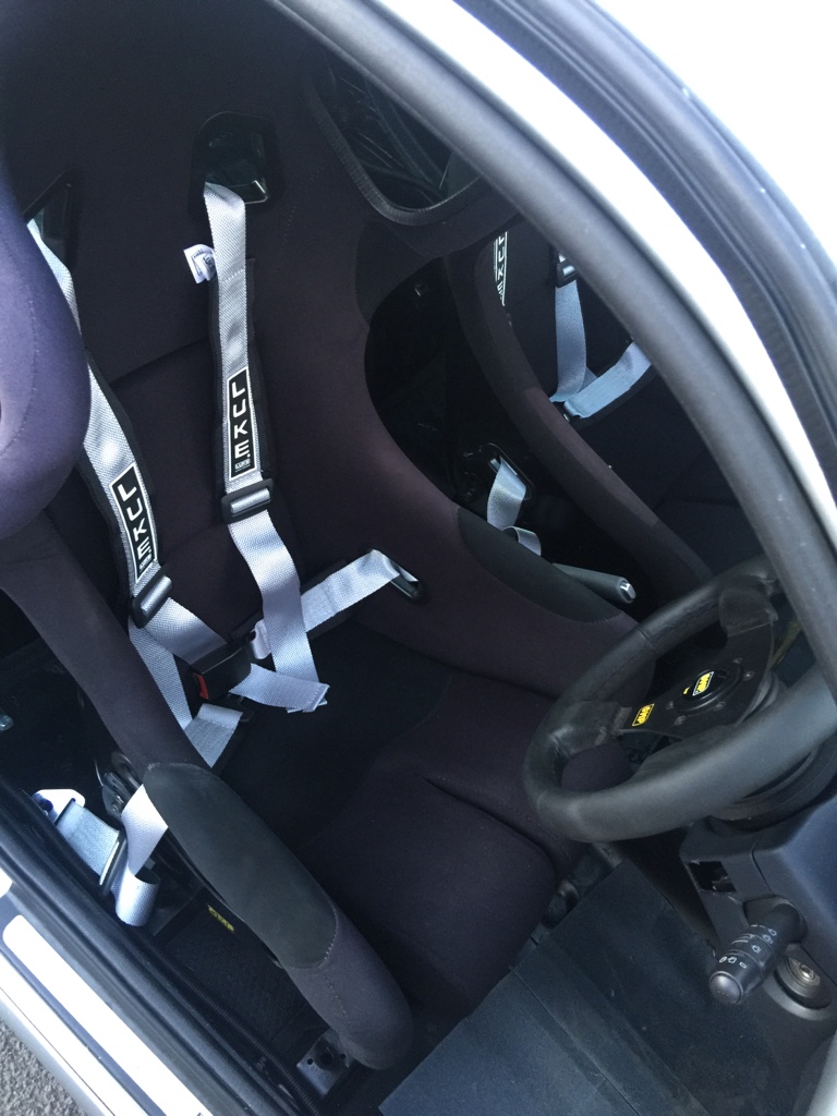

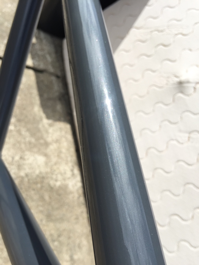

I got bored and stripped all the carpet out as it was tatty and painted the interior satin black. I ordered a cage and had it painted in my favourite colour, Grigio tolesto, a set of grey Luke harnesses to match. A little switch panel so I could begin to tidy up the interior loom when I get chance and when the new race battery arrives.

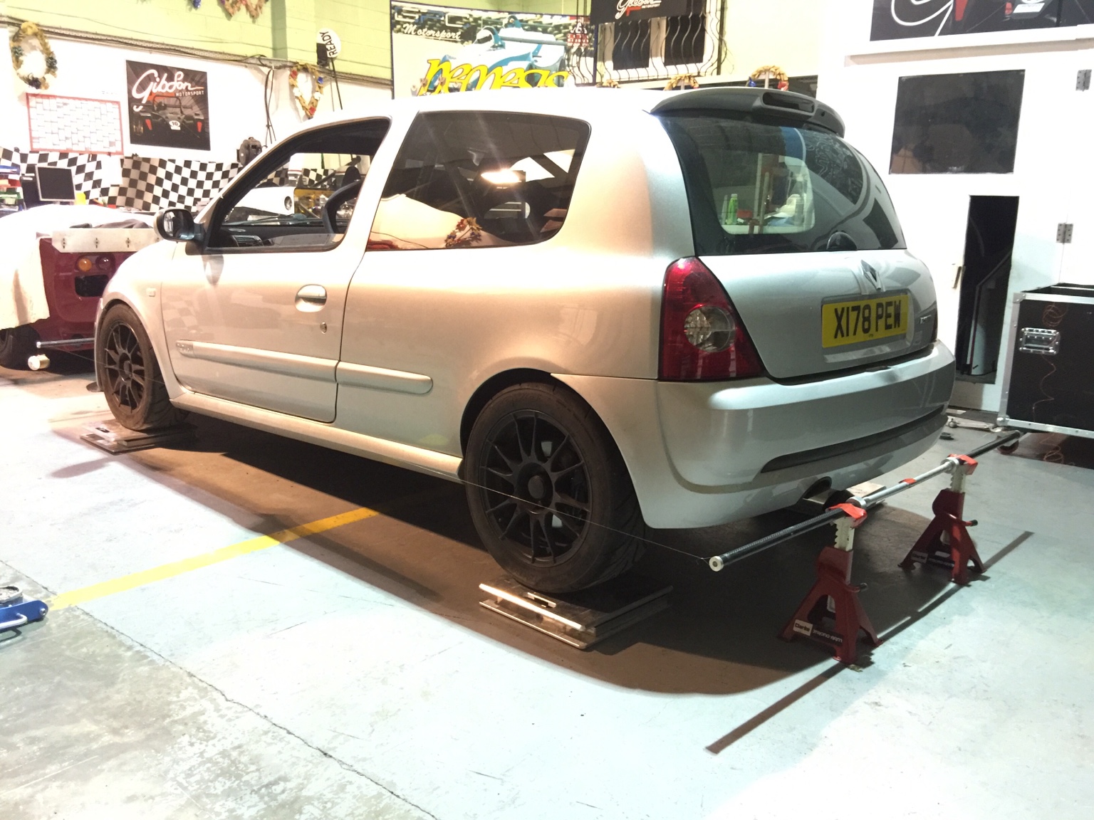

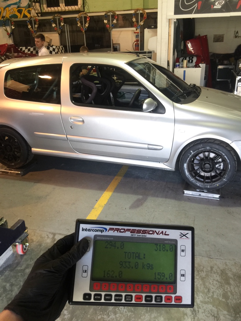

Lastly a friend who works for a Motorsport team kindly let me put my car on the corner weights and considering there is still audio, a lot of excess loom and tar the car with 33l of fuel came in at 933kg which I was very happy about, now I need to start taking excess weight out that's not needed and distributing weight proportionally as the front right was around 24kg heavier than the front left. If anyone has any advice on that, it would be great! If I remember rightly it was under a 1000kg with me in it and fuel, without having fuel I think it works out about 910kg [emoji16]

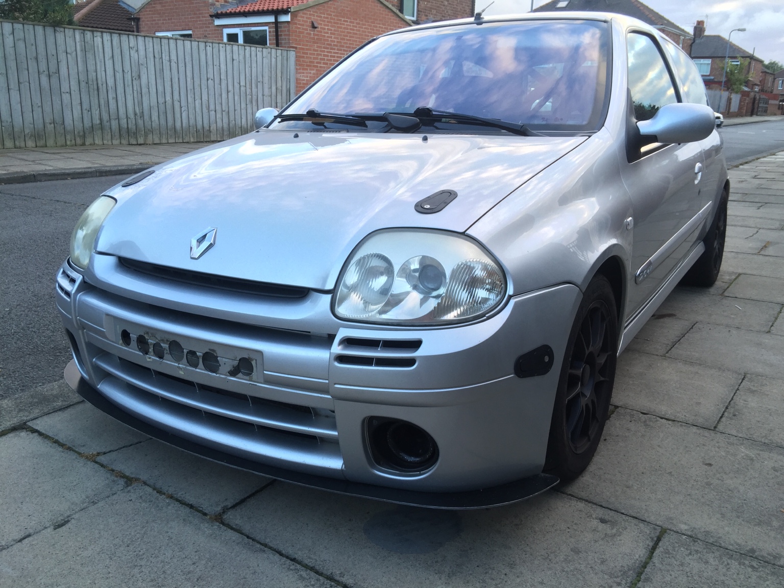

Been doing a few bits when I can, got a set of forge silicon hoses and been collection parts still, bonnet catch broke and my front bumper has never fit perfect so I got some aero catches to both and fitted a cmcomposites splitter and the bumper is now totally solid.

Ordered a set of gaz coilovers fitted them and had a friend from a local race team set the car up, car is now running 1.5 degrees camber, 15minutes toe out.

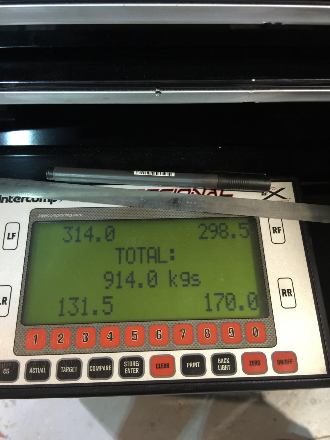

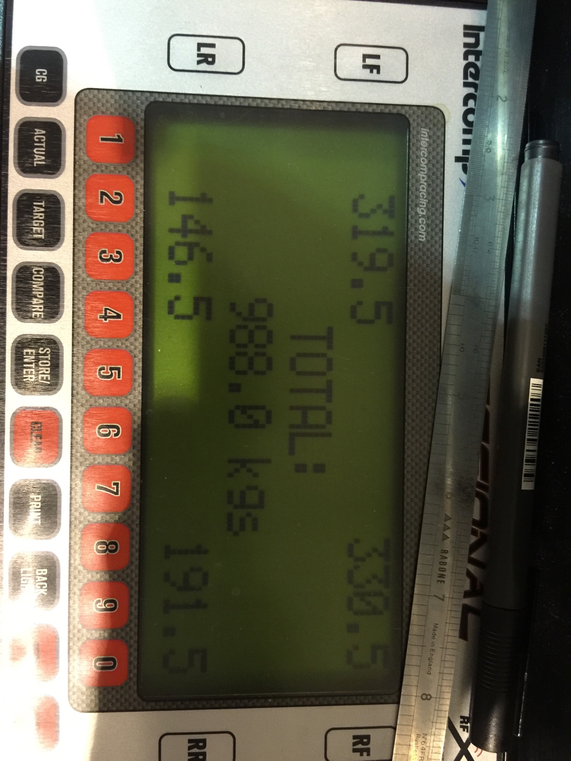

Managed to loose a bit of weight on it too, 914kg with 15L of fuel and 988kg with me in it, happy with that, for now!

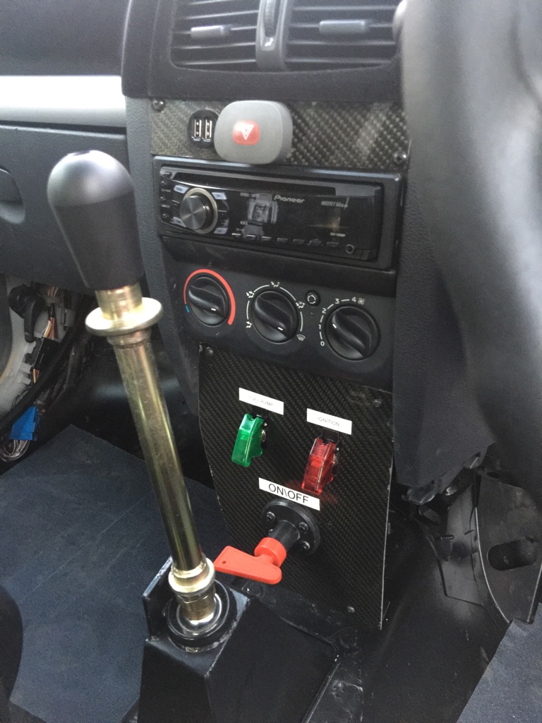

Hey mate, ph1 looks brilliant - got ny information on how you wired up the ignition and field pump to that switch? and have you still kept the ignition on the key?
