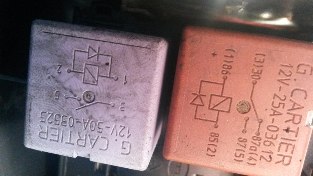

cheers guys, its just annoying after so much effort it dtill doesnt work, i guess thats the 'fun' part about building something which isnt meant to be though.
the problem is the ecu is only seeing 40% throttle posistion at wot and is causing a fueling issue.
need to check the voltage at standard ecu at wot and the adaptronic ecu if there are different then thats where the problem lies we believe.
i also need to check for a ground loop so to speak as this could also be the issue. hopefully ill have some time tonight to crack on with it.
have you found a solution to the problem mate?Sounds like the exact same issue as mine has and you sound as frustrated as me with it. Hope you get it sorted soon.
yep, if i cant find an issue with the wiring, the only thing i havent replaced are injectors, fuel pump and relays, howeer injectors were new less than 1k ago but i imagine it is possibe for them not to work correctly from new.
