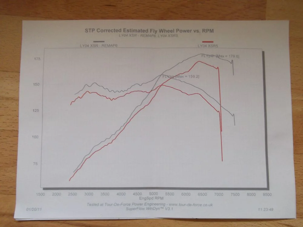

I think someone can't read,the rollers were the same for both runs,read it properly mate,I don't think there is a lot between Andy's and Matt's mapping,they are both very good.
Dave's run prior to having the cams fitted was the same as what my car ran on Matt's rollers prior to having the new cams,will be taking the car down to Matt's to see if the gains I got at Ktec are the same on his rollers.

Good result I think, be interesting to see what figures you get if you go back to the TDF rollers.

ITBS will be nice,if the car preforms with the same gains on Matt's dyno then 198 bhp and 174 ft/lbs that will be pretty awesome from a set of cams,with ITBS it should be epic.:)

Will be going to TDF in the next 2 weeks or so just need to ring them and get booked in,need a couple of bits doing so kill 2 birds with one stone.I had been saving for a s/c kit since I got the car(8 months ago) but decided to spend it on suspension cams ect,will be eating beans on toast until I can afford some ITBS.
