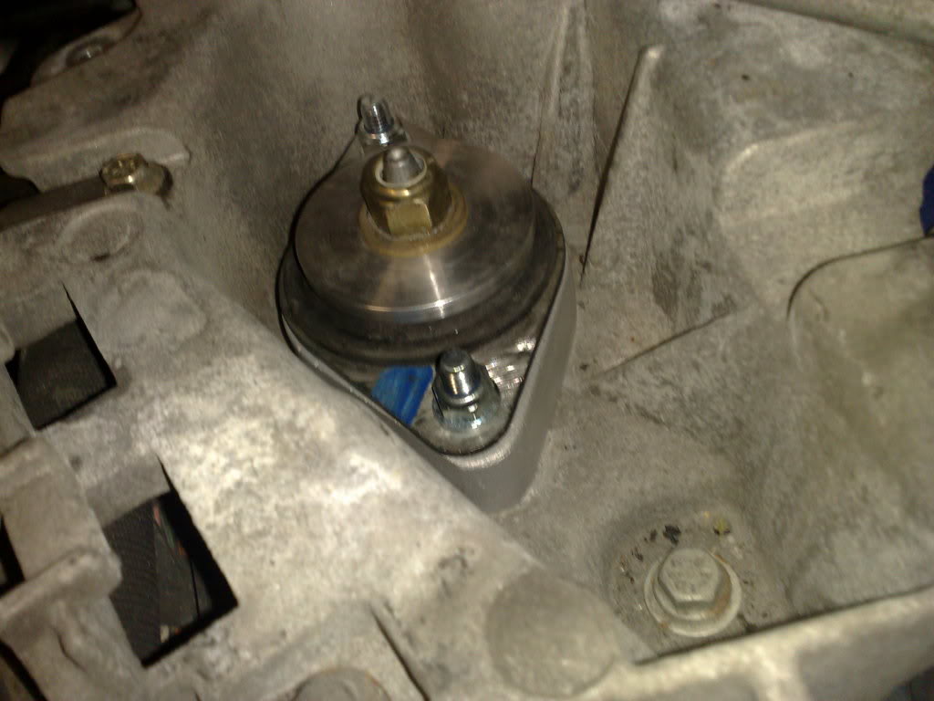

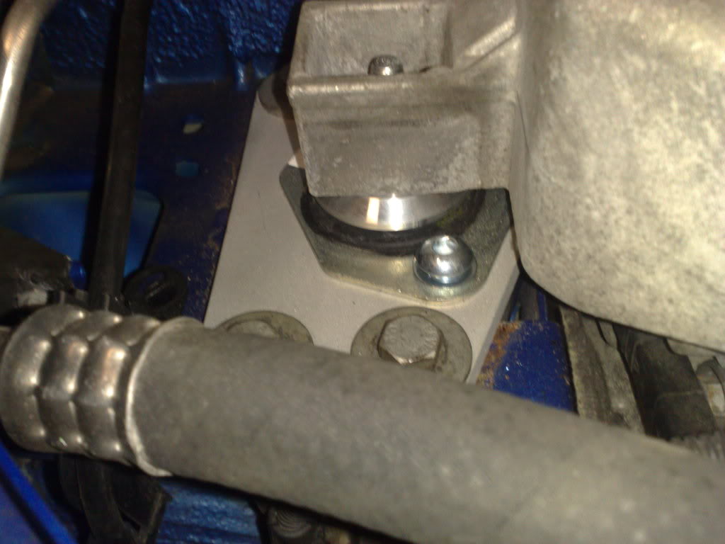

Do they look right?
They feel nice and tight but id like to check that I havnt left anything out or put too much back on lol.
yep they are on right but on the gearbox mount you should have got a new locking nut which sits in the grove on the top plate. as the std nut is not on all the threads
