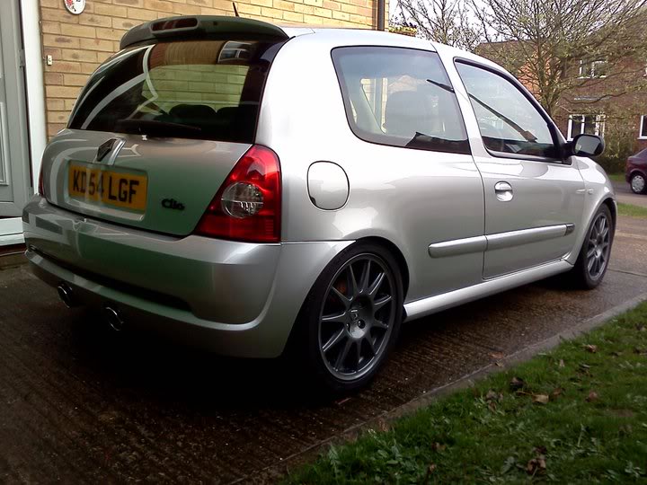

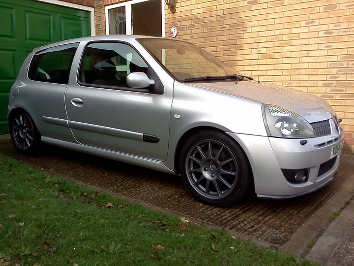

This is on cup fitment vmaxx, slammed and I've been told it doesn't rub with 4 people in it

wow love that mate and thats the exact sort of stance i want maybe the front down a tad more ;) and is that fully wound down?

the fronts come down about 10mm since that picture, we just let it settle for a week then tweaked it a touch. I do them supplied and fitted, prices on my website and in my traders section. Please remember though, they're definitely not a track coilover, they're much too soft for that, but they're nice for a low daily driver.
