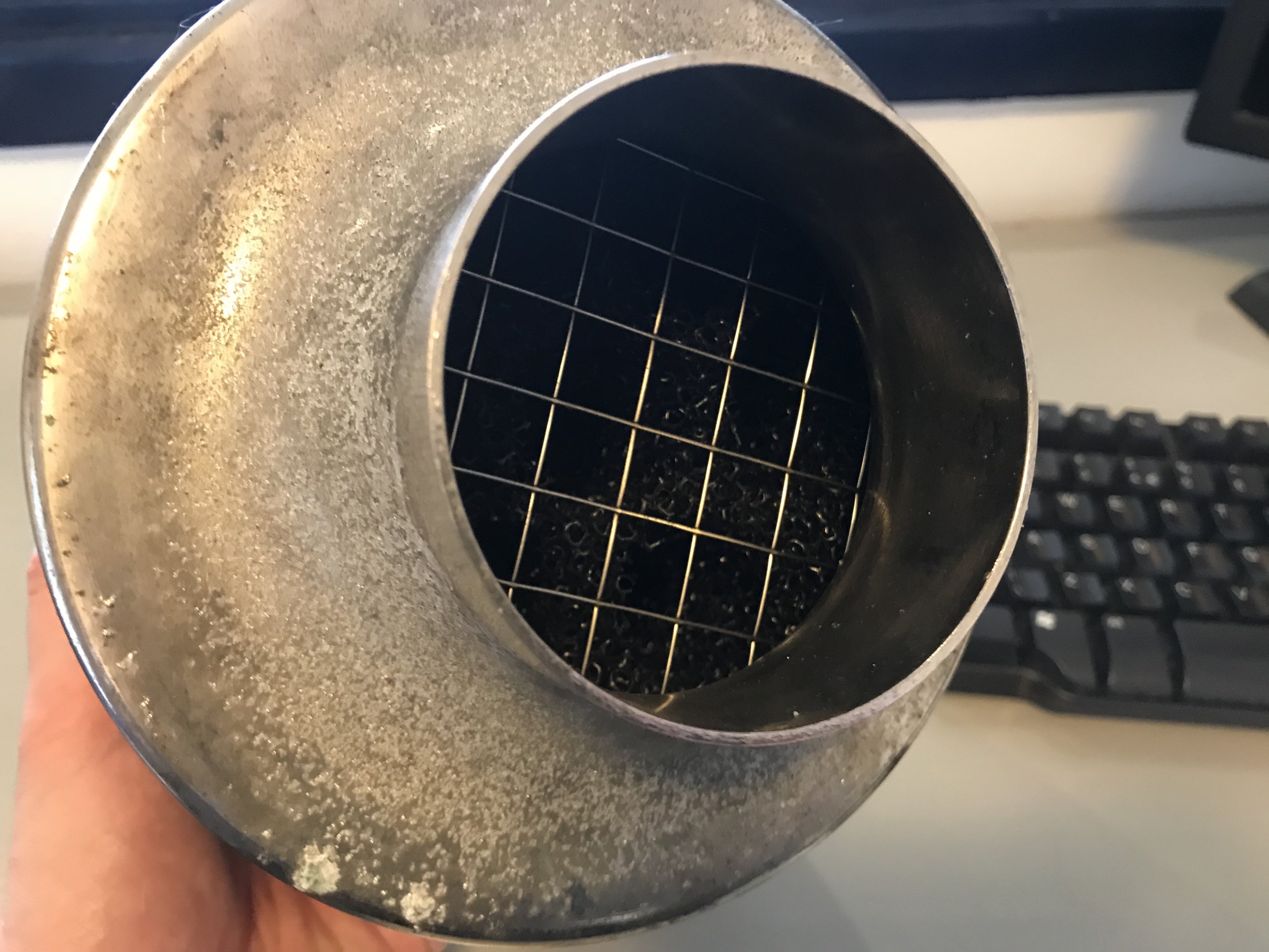

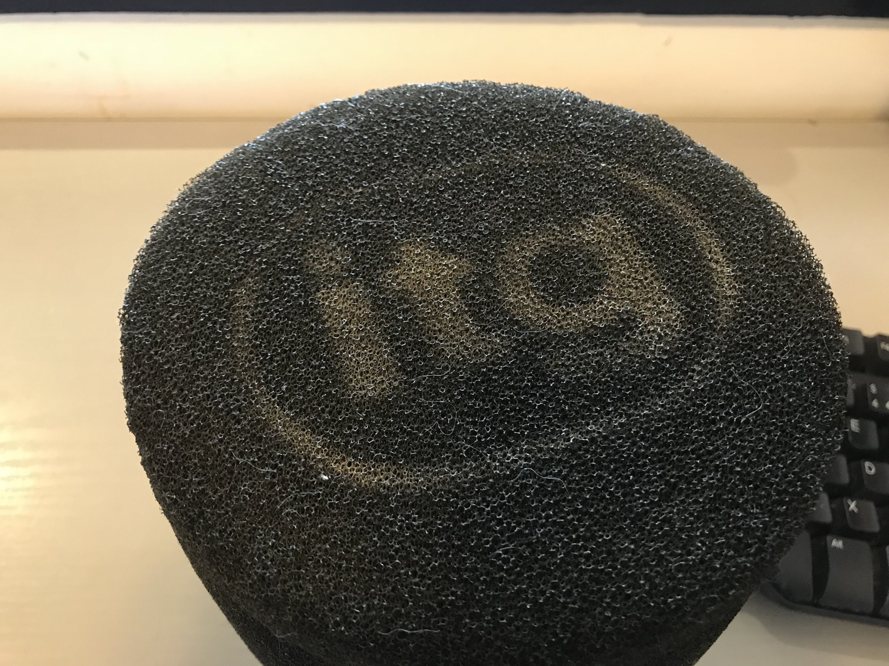

Will check in work tomo, but I’m sure I’ve got an itg filter for some reason.
Remember seeing the box the other day.

Yeah when I spoke to Ryan this weekI’m confident they do. Danced round the subject.
Yeah that’s the itg filter.

Righty, so that filter (itg) fits with moving the battery back a touch.
