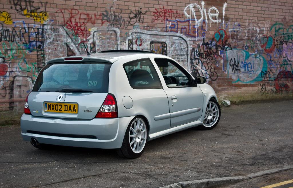

same idea, its a straight bolt on system, you get a template to line up the bumper where it needs to be cut, and you just take a bit at a time until it sits perfect. took me and my mate a few hours.
i was also thinking about getting this. what does it sound like? anybody got one? i want the supersport one!
I have the supersport (unsilenced) version on my rep and its awesome. Very subtle and well made and as for sound well driving around at low revs you would hardly notice it but give it some beans and it sounds awesome. In my experience though it wasnt a straight fit and some welding and cutting was needed to get it sitting the way i wanted it.
Very easy to fit.....just make sure the back box is aligned perfectly and not twisted in any way before tightening all the clamps up. The bolts that join it to the CAT can cause a couple of bloody knuckles to get them to budge. Will take you a couple of hours under the car on stands and less on a lift/ramp. The only problem is to get it to sit higher enough to make it worth while to cut the bumper.....NOISE = awesome :)
