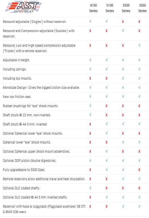

Unless you intend to go into the 750mc series I would get AST over them all day!
frayz
4100s are no longer available. AST don't make them for the Clio anymore.
The 4100s are non inverted dampers with 22mm shafts
The 5100s are inverted struts with 44mm shafts.
frayz
frayz
Oh really what have they replaced the 4100s with then? @frayz
They haven't, they had some old 4100 cases about 18 months ago and made a few sets up.
Once they were sold, that's it. They're easy to distinguish as they have the adjusters at the top unlike the inverted items which the adjusters are at the bottom :)I believe the 2000 kit will be the entry level setup followed by the 5100s.
