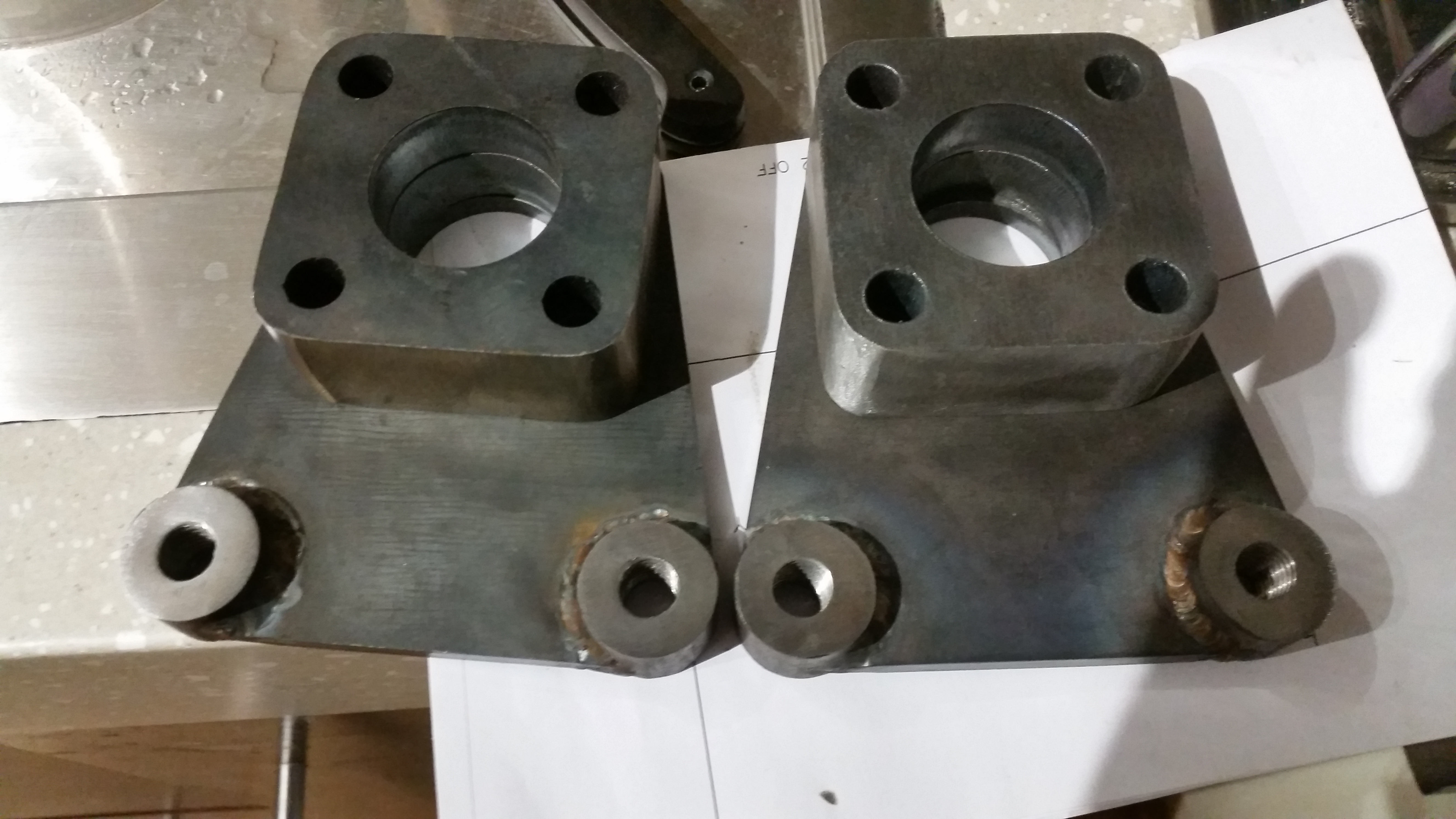

you have to grind off the lityle tube bit on the top left
  Clio Maxi Replica
these were the spacers and caliper holders. i looked up and i used laguna 4 stud rear hubs and espace discs then a mix of csliper parts..

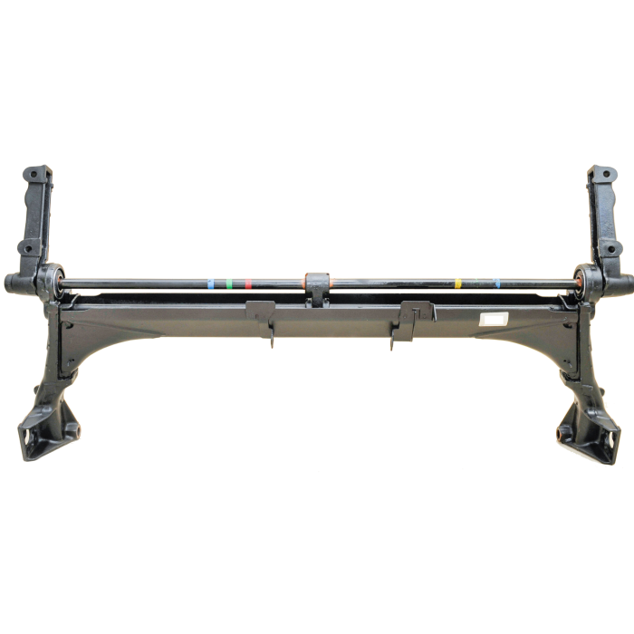

I'm looking fitting the megane scenic rear beam (99-03) but need to check they fit. Did you ever look at that option?
i never did no. only ever looked at how to modify the original. as with anything i guess there is always a way but i dont know the mounting hole spacings on this one.. look wider.. or the shock spacing.. i suspect that would be your main problem but maybe also change in wheelbase also
Did you change the torsion bar on it?
the standard bar is retained but following what renault did on these beams for gr.A i added the option to add an extra external arb. the one fitted in the photos is a front mx5 standard one but i actually changed the front arb setup to take mx5 ones too so there are lots of options on diameter etc for those and you can interchange both front and rear from the same setup so saving 1/2 the cost of options effectively.. just change the bar and bushes.. ive got something like 25 or 26mm front and 19mm rear currently..

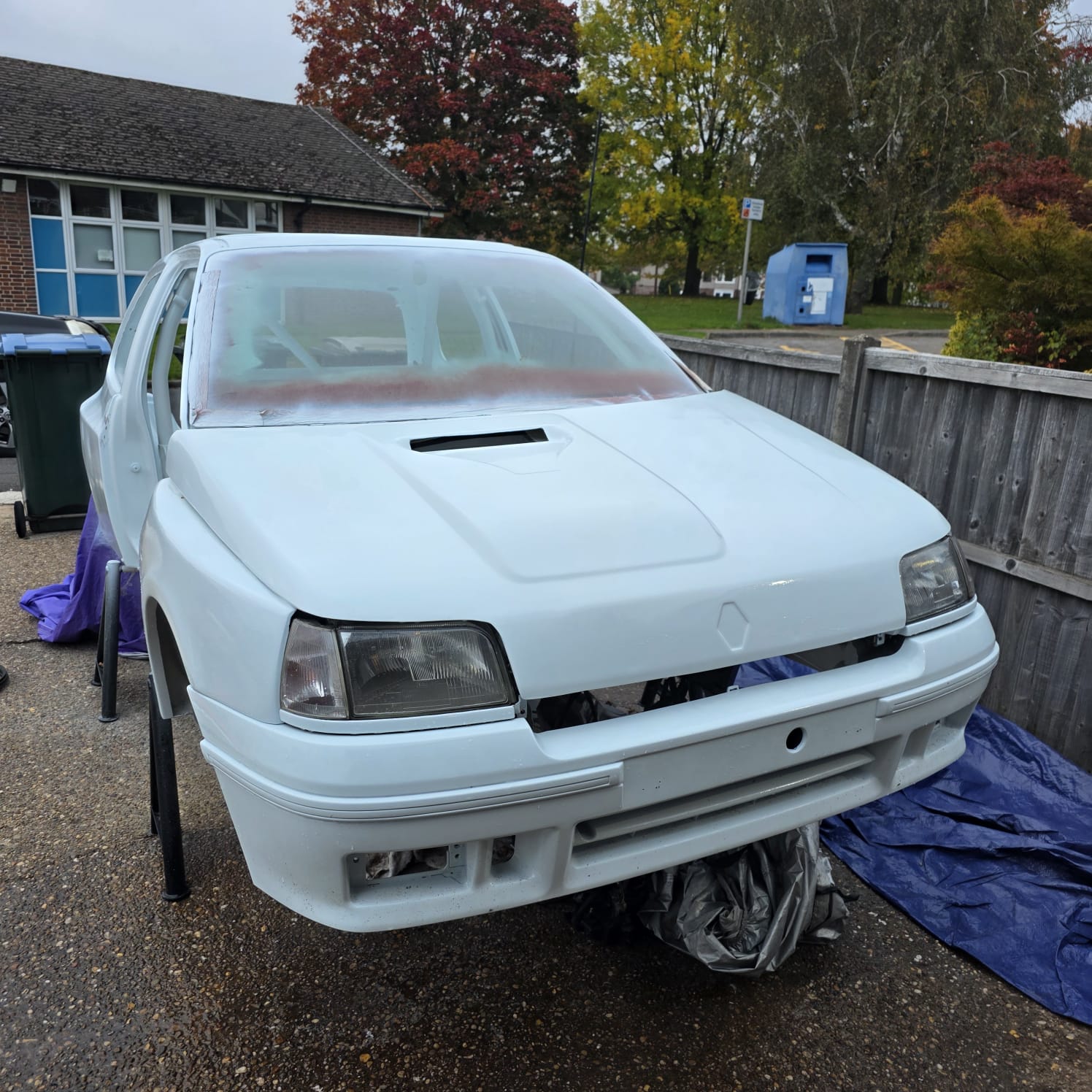

build has been going on so long i started documenting it on a chalk board.. but loads of photos i can dig out.. shell is an ex cup car.. sadly now full of holes so thats the next bit to sort but 2nd engine partly built. low ratio lsd jc5 built and most other parts built more or less from scratch.. if i remember ill dig out some more stuff and post it..

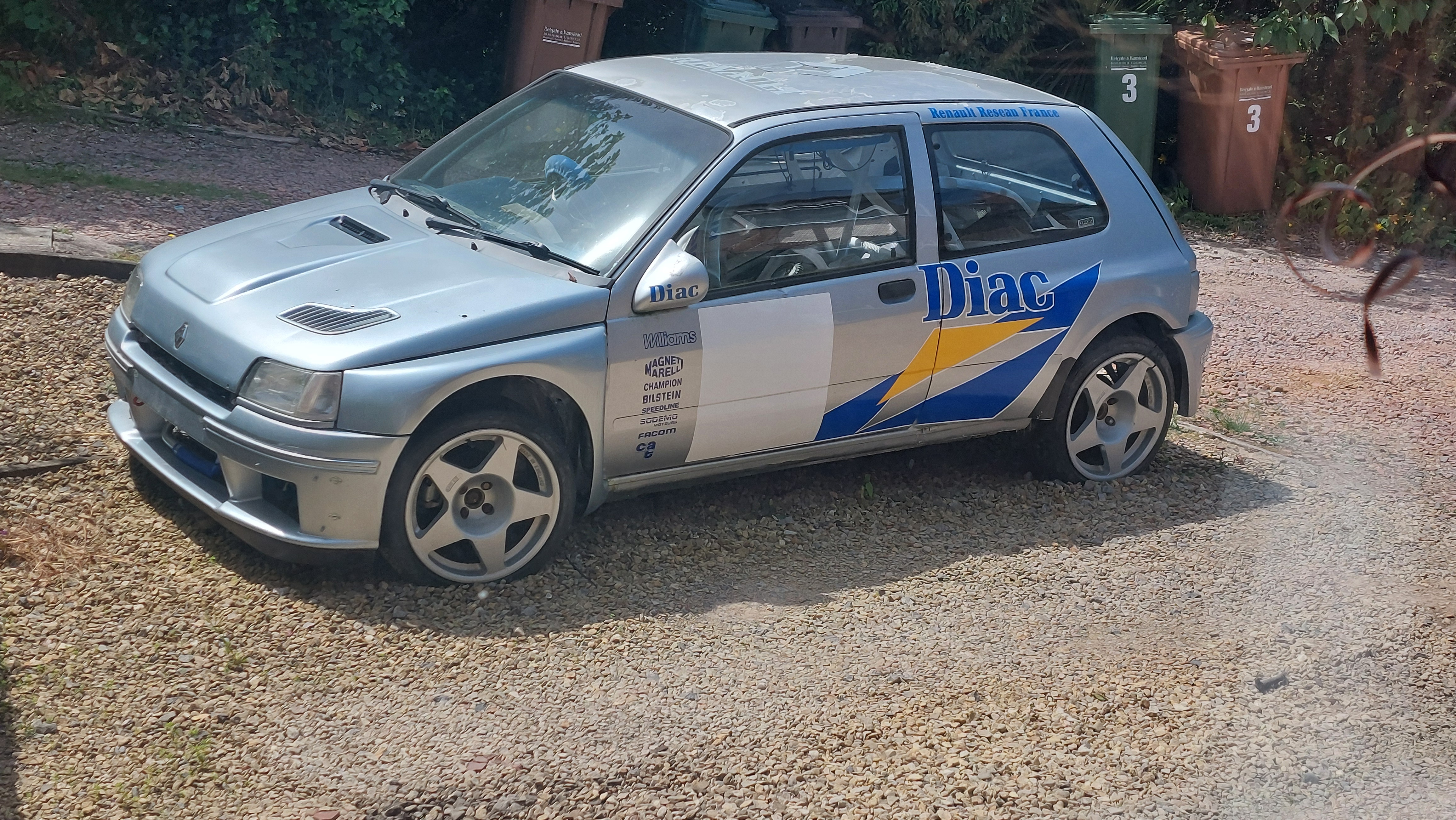

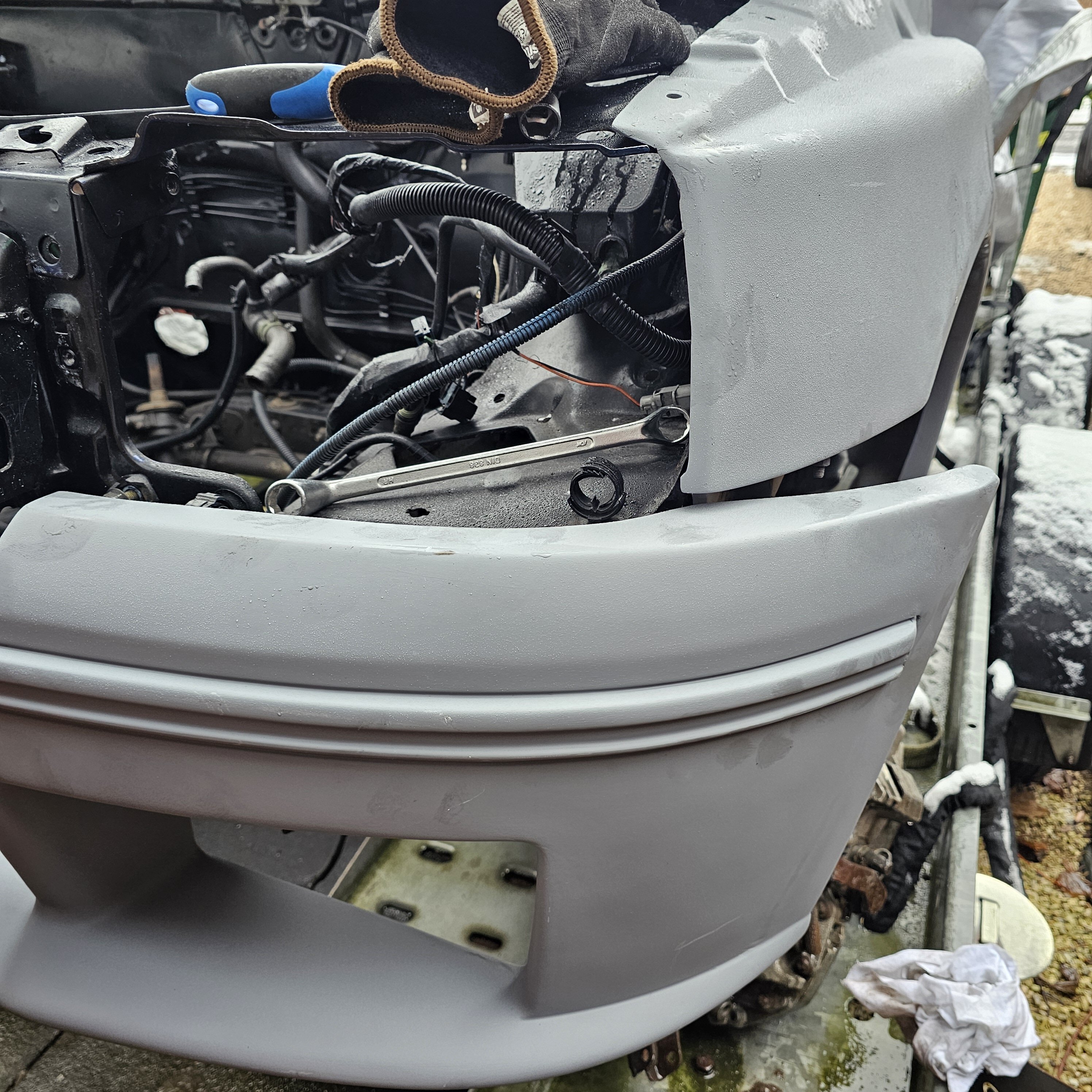

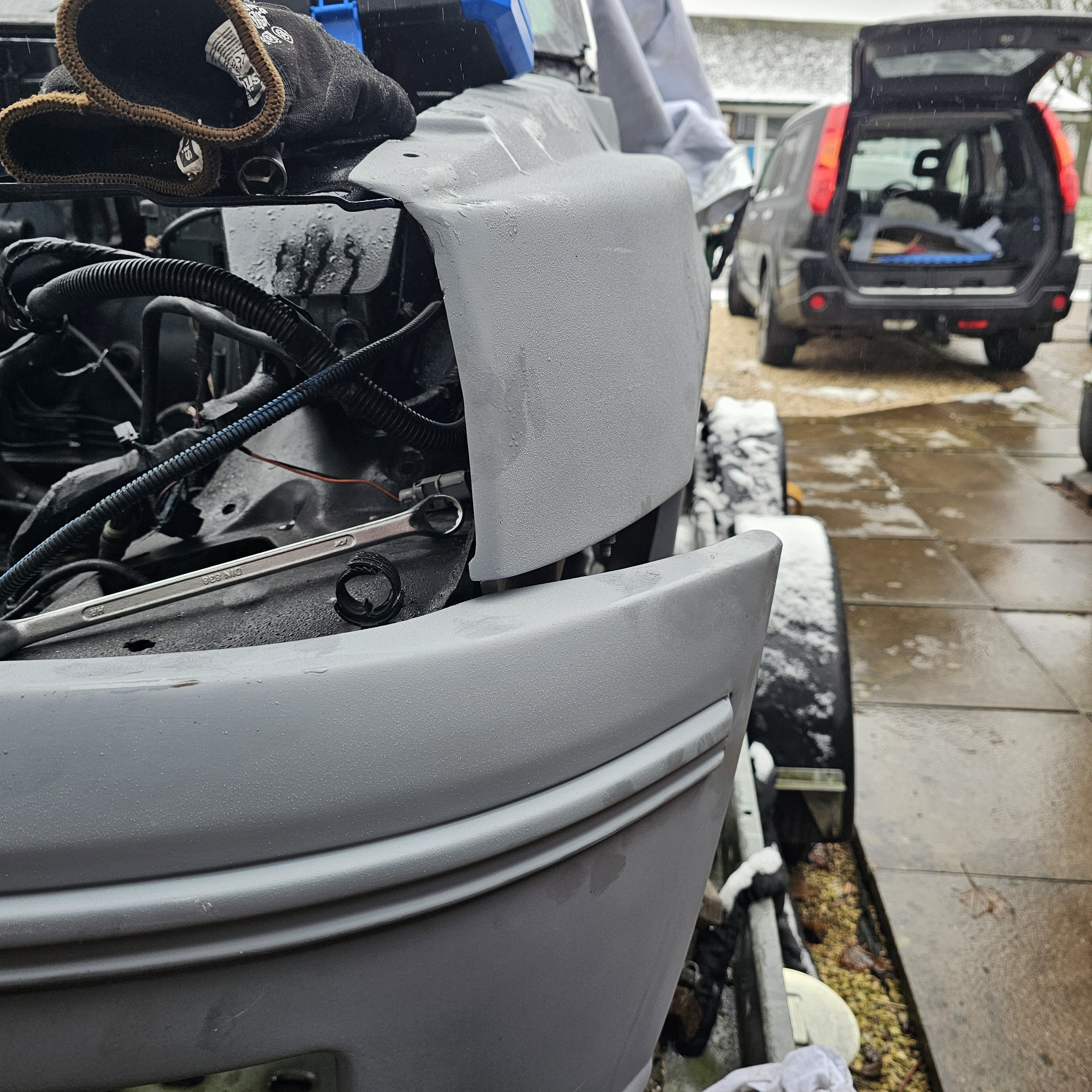

Reason I ask is because I have a non maxi wide front end that works with the standard bumper. I think it may be as wide as the maxi where the wheels are but just comes back in to meet the normal bumper rather than the maxi bumper. I have a picture of them when I offered up the maxi bumper on my phone but can't get it off there as vodafone network is down.
This is the other wide arch kit I have, its 1720mm from the edges of the wings where the face of the tyre would be:

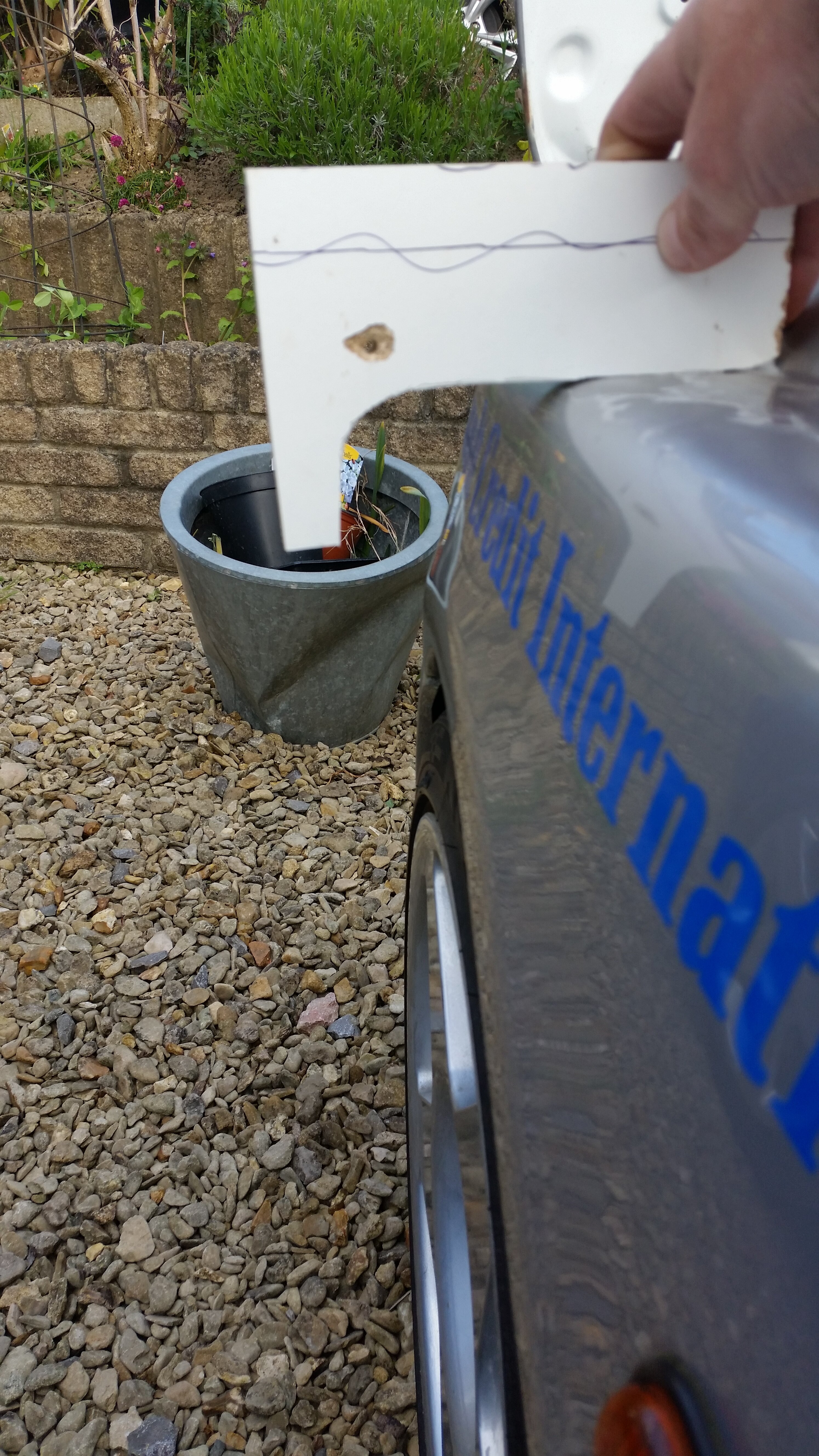

  Clio Maxi Replica
thats the old prima maci kit iused to have. it is narrower. i have pictures of it on 8 inch et 11 rims with a comparison against the full maxi wing
GasManLS7
  Clio 182
thats the old prima maci kit iused to have. it is narrower. i have pictures of it on 8 inch et 11 rims with a comparison against the full maxi wingView attachment 1764772
Perfect thanks, hard to tell in the pic but you reckon about 20mm narrower each side? Would put the total width from outer edge of arch to out edge at about 1760mm for the maxi?
  Clio Maxi Replica
more like 30mm if i remember.. there may also be spacers on there.. its been so long i cant remember but knowing some of the bodging i found, there probably are
GasManLS7
  Clio 182
OK so ~ 1780mm wing to wing, just trying to figure out where my wheels need to sit to fill the arches if I go full maxi. I have the bumper but need to order the wings, going to finish the car as is first though and then see. Subframe is 50mm wider per side and uses Clio Cup LCA's and Hubs etc which give it a little bit more width but not entirely sure how much. It should fill these Prima wings OK but ideally dont want to use spacers to go Maxi, I do have ET36 wheels though so ET6 ish wheels should do it.

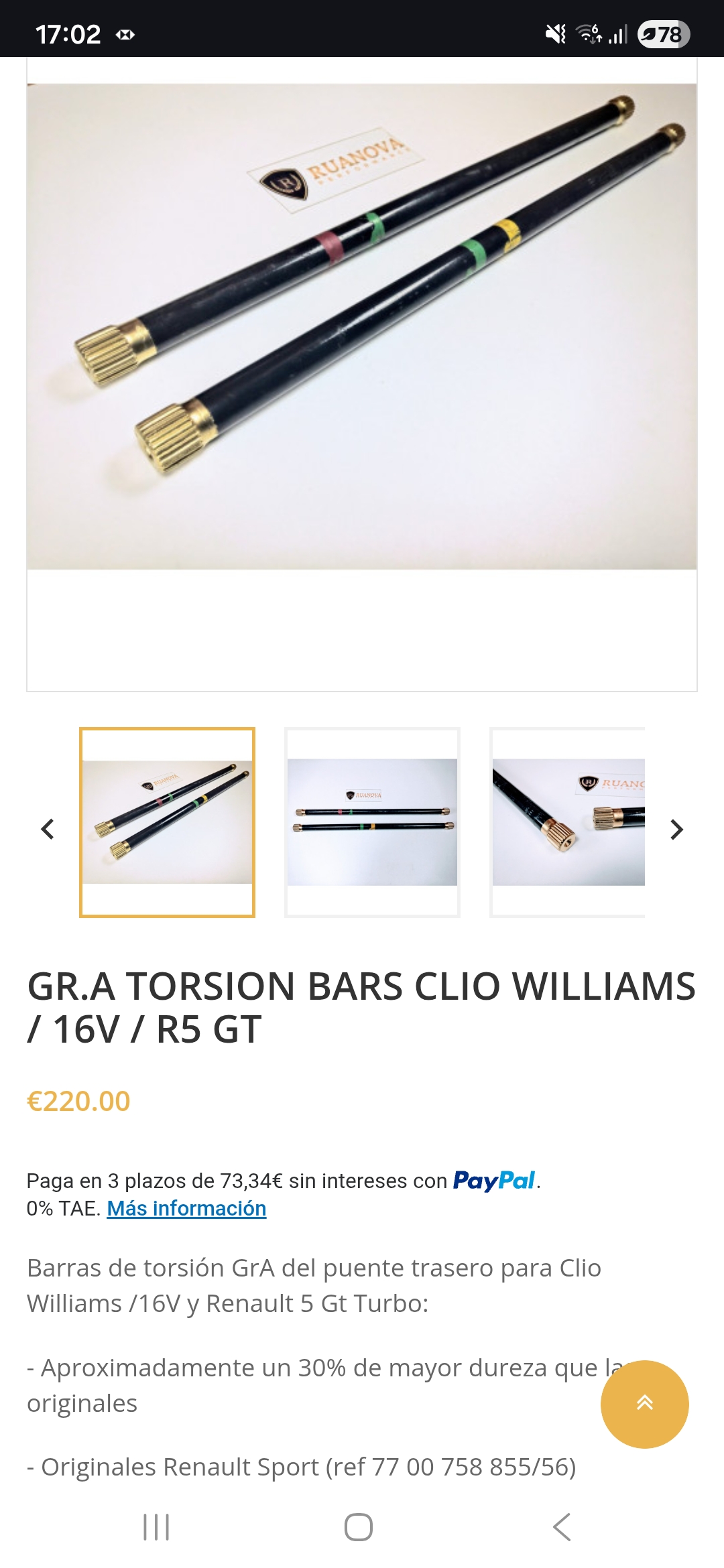

Brigsy
  T.Turbo
kept as standard but refurbished.. they look a good price.. something in my mind says they actually come of a renault van of some sort
Renault extra van are 24mm torsion bars, im sure they are more or less identical to the grp a. Not easy to find these days.
Im sure kangoo mk1 bars are 26 or 27mm from memory. No idea if they will fit.

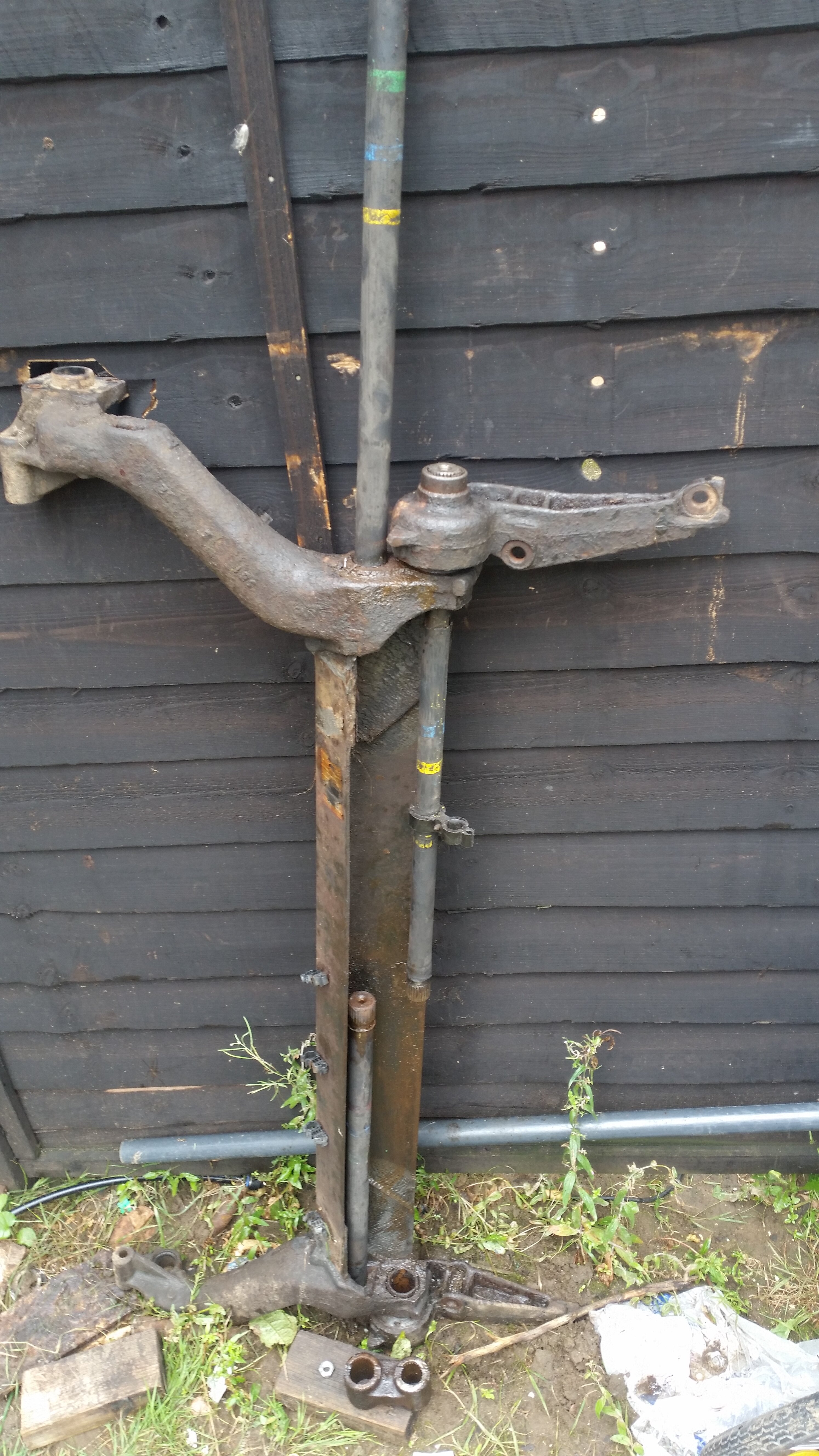

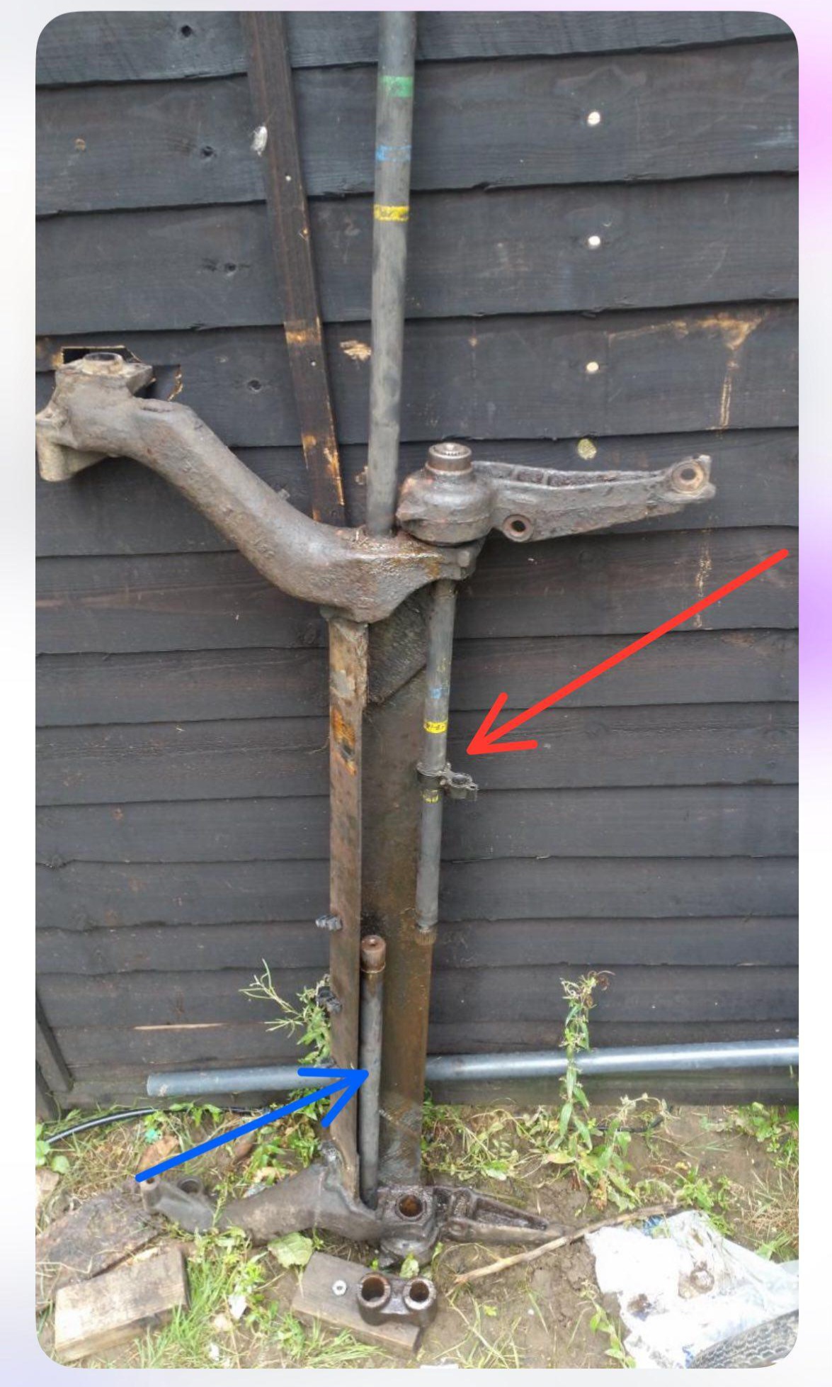

How did you get the mk1 rear stub axles out? Does it go back through away from where the wheel would be?
The mk1 stub axle seems to be part of the rear beam?
