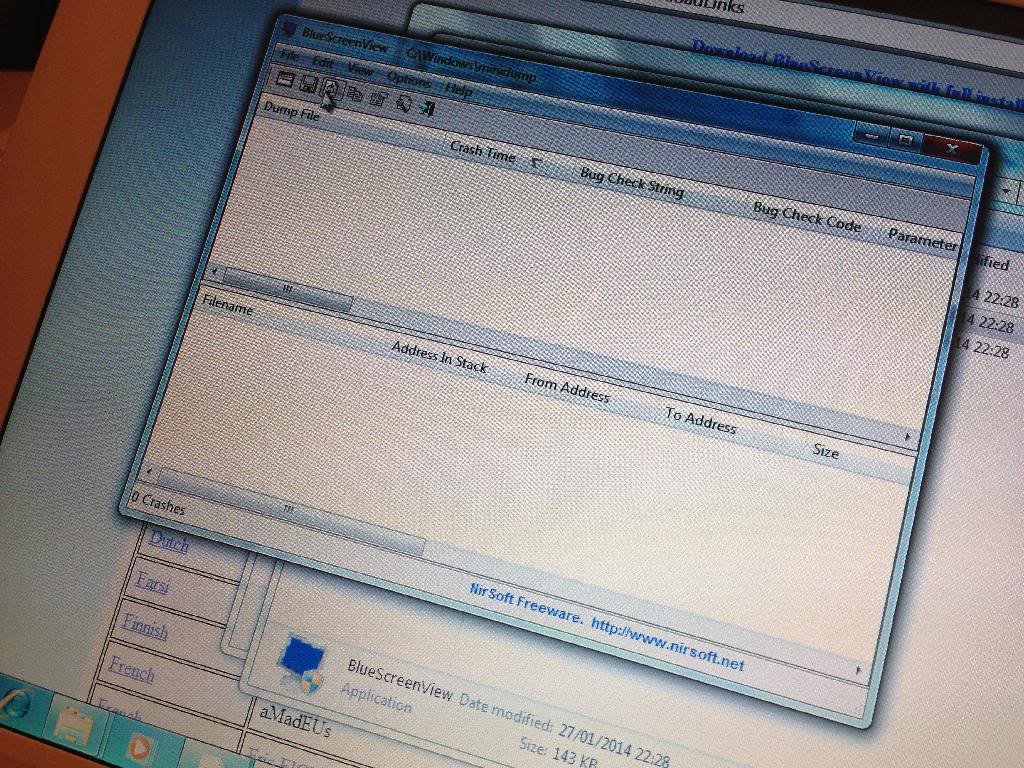

Could be something like a bad sector in the hard drive etc causing it. You can also disable automatic restart on system failure which will show a blue screen if there is one. Press f8 just after the bios screen.

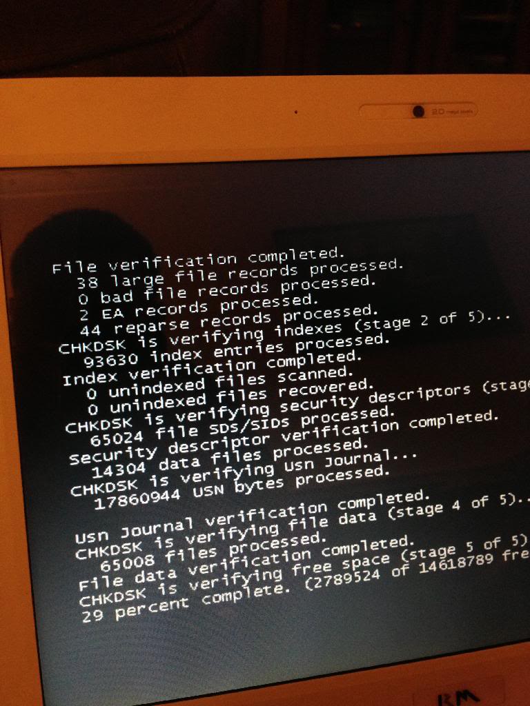

Looking good so far?
Would a reformat sort a bad sector out?

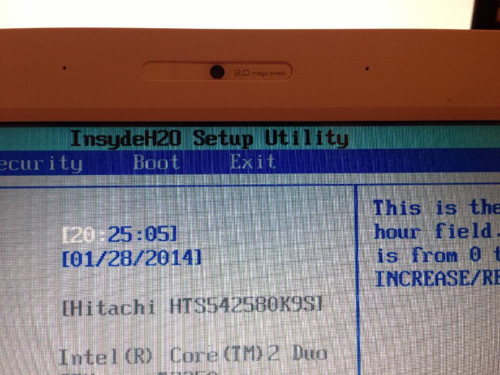

Since changing that setting windows blue screens on boot... Maybe I'm getting somewhere might re install windows in this HDD mode instead?
Edit
This mode is probably the cause of the problem after reading this. I have now set it to AHCI.
Basically AHCI is a newer way to interface with the SATA controller. This allows you to take advantage of SATA features such as Native Command Queuing (basically, you give your hard drive a bunch of commands, and let it figure out the best order to run them in to increase total throughput... without command queuing, the operating system can only send one command at a time, and the OS really has very little idea how to do this in the optimum order... this helps most when you are accessing data scattered over the drive rather than in order... if you run multiple programs that both use the disk it'll help, but it will have little effect when playing a movie off the hard drive), there are some other features that are enabled, but are more appropriate for desktops. The downside is you need updated drivers (which are apparently not on the BART cd).
Yes it will do, however you don't need to reformat it to swap. You can change it in the registry then set it in the bios.
No it isn't, I've installed it on various machines in IDE mode! Worth a shot though!

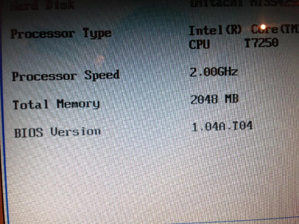

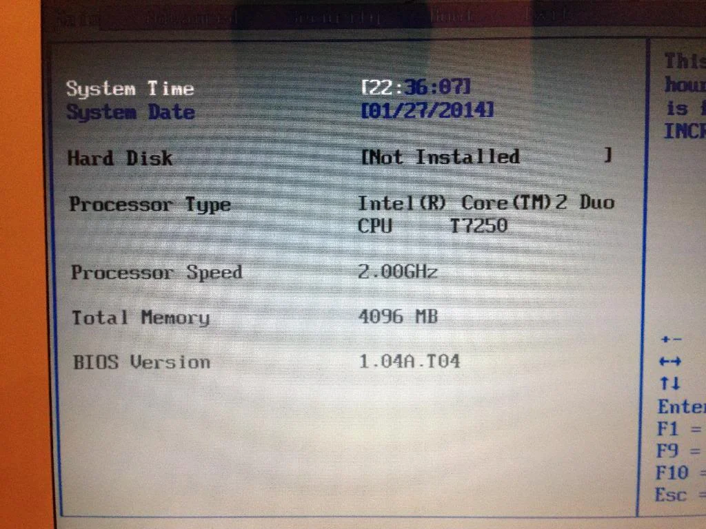

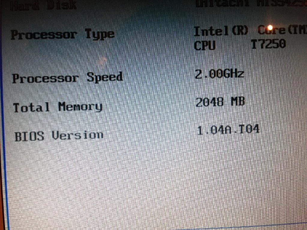

Might be worth just re applying some if you can then. Hm what bios does it have and what is shown for model in msinfo32?
