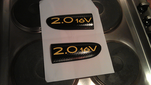

Yeah it is raised on 2.0 16v bullets. But I bought some DCi ones and sanded them down so I could put 2.0 16v stickers on in yellow cos I'd have made a right mess painting them.
This is how they look now and don't think they're going to look much different once they've fully dried.
Can just make out the carbon but it's very subtle. Oh well looks better than if I'd attempted to spray them black.

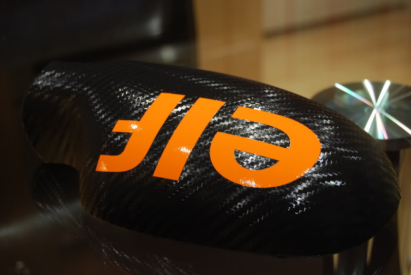

Got to agree that the carbon effect does reduce once lacquered. Here is my wing mirror wrapped in 3m and then 2 coats of laquer. I must admit the gloss has reduced over time. It now looks like a satin type finish.
Looks good chaps, technically you shouldnt lacquer CF wrap (vinyl type) without an adhesion promoter (such as clear plastic primer sprayed very very thin).
