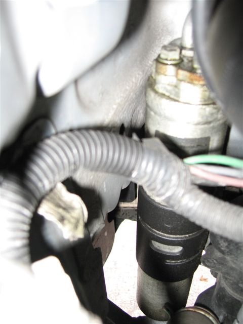

I've attached a better pic of the 'tube'
ah yeah thats what it is well it was bought from a 2nd hand dealer im guna hav to look properly in the day tomorrow although im bloody useless with engines...
