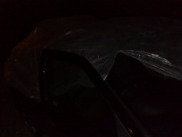

lol my neighbour has just bought a mk1 clio, the tops covered in a massive plastic sheet, one can only guess why.
