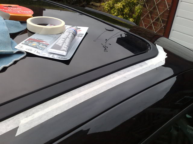

so you are reccomending to seal between the black plastic thats on the outside of the car where it meets the metal ?
thats what im gonna do tomorrow i cant be bothered to take it off... ill just do a really neat job ill get some pics up tomorrow
nice one , i gave it one attempt but didnt do it this way lol it bugs me water dripping on my arms when i drive lol
i have a plan to maskin tape the plastic and the body work so i can just see the gap.. put sealer in then smooth with my finger then take the masking tape off while its still wet to give a smooth neat finish :D
depends on you. it may not work just sealing around the edge, if you get a pin hole game over. plus it may not bond properly

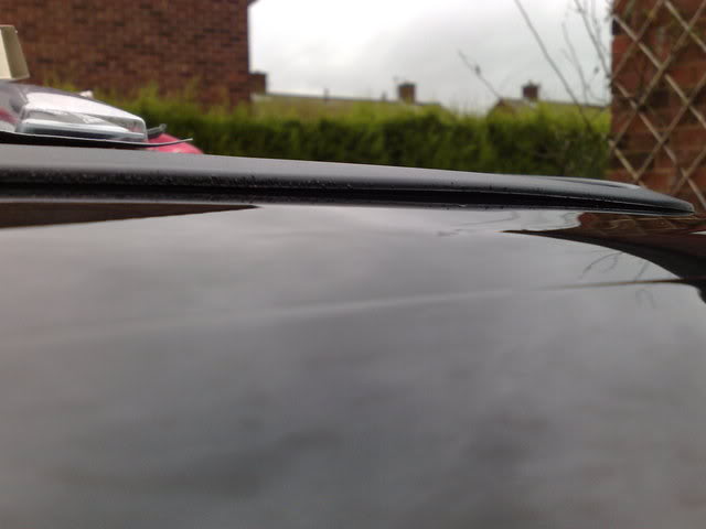

ok so..
thats the gap.. quite big i must say...

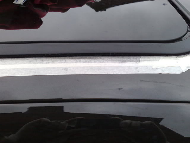

all taped up.. i found i didnt need to tape the plastic cause the sealer just wipes off. (plus the tape didnt stick lol)

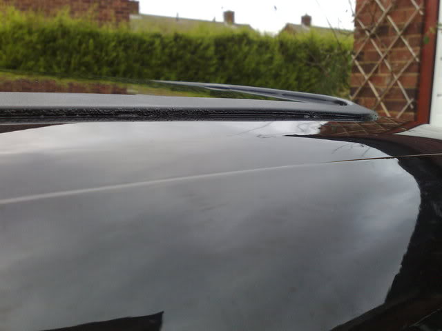

thats with the sealer in
thats it dry :D
now just got to wait till it rains to test it out...

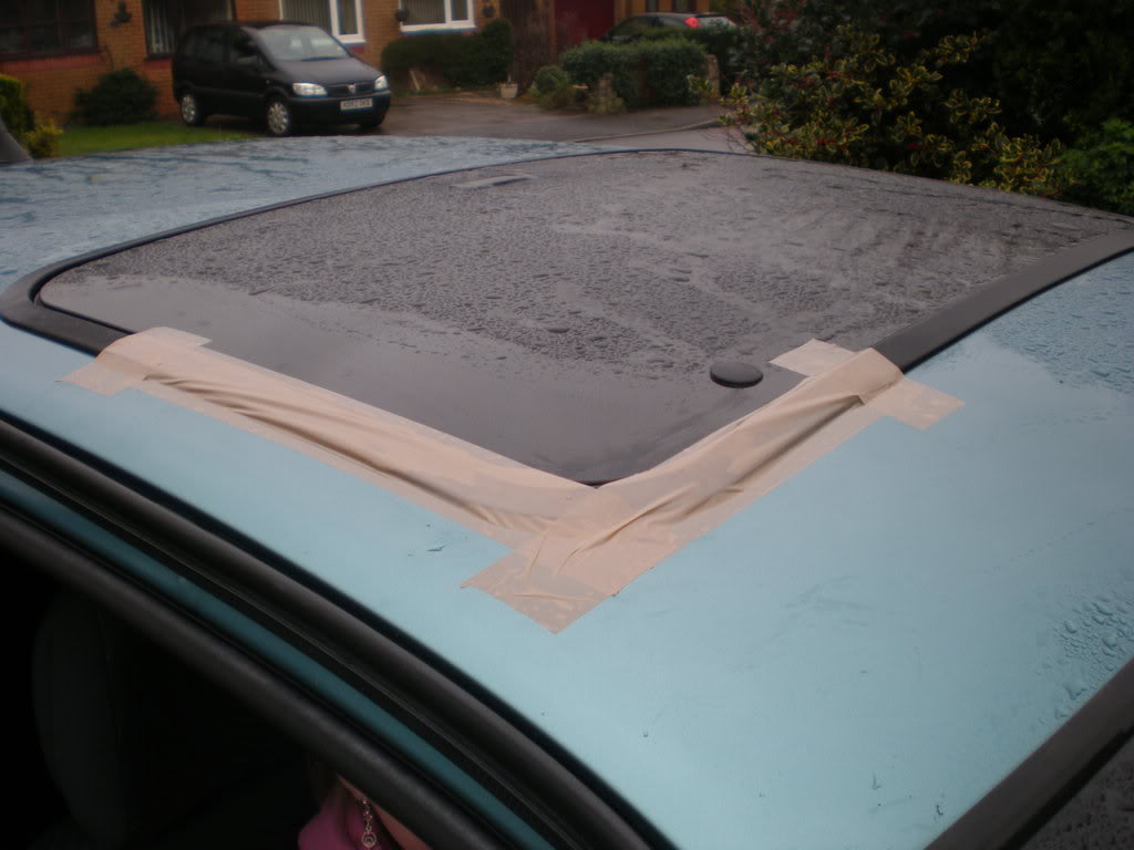

Tried silicone, new seals, drain plug blockage, even siliconed the whole sunroof shut...
still leaking....
same here ! im having another crack tomorra . lol today i even taped it all up in any place it could possibly let water through ( sunroof ) and it still leaked when i just finished work !
