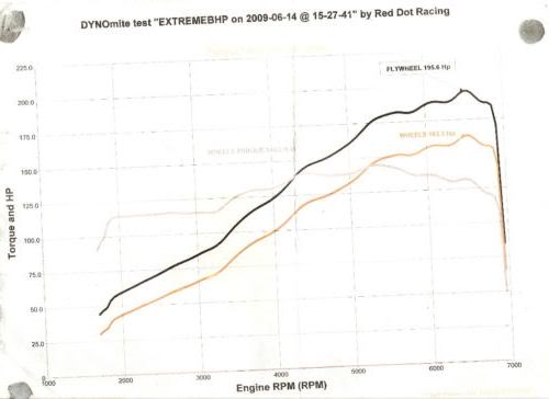

But..HERE IS THE ANSWER YOU ARE ALL LOOKING FOR!
My car has roughly 175bhp at the wheels, with around 220bhp at the fly, The rolling road was done at The French Car Show in 2008 and has had another remap since then, late 2010, ive not had it rolling roaded again but hope its added a couple more bhp on, remember this isnt your average, corner garage map, this is one of the best CUSTOM RE-MAPS IN THE UK.
see http://www.youtube.com/watch?v=b5GAneQPJNU listen at about 4:53 on the video, 195bhp is quoted. I have got rolling road print out showing the 195.6bhp from said rolling road which has been added to the Ebay advert
Most rolling roads work out flywheel bhp, not wheels (see below - example)
Imagine we take a car with a true 200 flywheel bhp engine to each of the various types of dyno. Assuming accurate dynos which is by no means always the case and calibration standards can vary then we would expect to see the following results.
Example - FWD
Engine dyno - 200 bhp
Hub Dyno - 200 x 0.93 = 186 bhp
Wheel dyno - (200 x 0.9) - 10 = 170 bhp
Clio
Engine dyno - 220bhp
Hub Dyno - 220 x 0.93 = 195.3bhp
Wheel dyno - (220 x 0.9) - 10 = 179 bhp

so its a standard engine with a remap, air filter and exhaust?
you'll have around 175bhp @flywheel fella which is 150 @ wheels
  328, MK1 Clio 1.4
I see ads all the time where people are quoting 220bhp from a map and exhaust etc. It seems a bit over the top to message people and be rude just for the sake of it, no matter how wrong they might be.
if a remap, induction kit, spark plugs and exhaust got you to 220fwbhp you have the best clio engine ever made. Nice car btw, but somewhere along the line i think you have been mislead about the power
OK well im only going by what the the rolling road man in the video i posted up and the rolling road (attatched)
Dont know if this changes anything, it is an imported car.
Also Parkers quote my car at 172 bhp? Thats at the flywheel not wheels, correct?
Thanks
Jay
  Lionel Richie
they all make 160-166 from factory, and the mobile rolling road is tosh, they will have fiddled it so it gives everyone good results (no refunds ;))
ask Paul @ RS tuning about red dot racing, all the cars that go there make 20bhp more than on his dyno, they're well known for giving bulls**t figures
a true 200bhp takes £3K, 220bhp takes £5K
I'm sorry that people have upset you with their comments and it's not a good way to advertise the club.
But as Fred says, you won't have that power with those mods. A RR can say pretty much whatever the operator wants it to say.
  172
Welcome, hopefully this thread won't have any of the member in it who make the club look bad :L
As covered rolling roads will read whatever they're calibrated to read. As a forum/club we are very aware of the optimistic claims and BS that remap adverts promise and the big range in RR results.
It simply looks like you've been misled by an optimistic RR print out or put a bit too much trust in it. In my book, and many others I suspect, that's no reason to be abused, threatened etc. You replied to those ebay messages in a mature, grown up and polite way trying to be helpful. If someone can't communicate with you in an equally grown up manor then they're not worth your time.
Parkers only write what Renault tell them. It's 172 PS. Which is 169 HP. However some more forum-knowledge shows us that renault's claims were a bit optimistic too and most 10 year old "172" engines produce around 160 HP at the flywheel. You can now hopefully see why claiming an extra 60 HP from a remap and an exhaust makes us suspicious. There are plenty of cars that could get 60 BHP from a remap and exhaust but the F4R-engined Clio is not one of them.
Let's just say viezu figures are optimistic at best.
They 'live' mapped my old 197 on their dyno and quoted they had mapped me from 189 to 209 at the fly. When trialled on a dyno dynamics it came in at 186bhp with their map, with the standard map put back on it came in at 187.
They have done well convincing people with their own hype about how good they are. Yes, very good..... at fudging figures

Hi, welcome etc.
Firstly, rolling roads or dynos measure the torque at the wheels/hubs. From that they calculate power.
Where are you getting your calculations from ? With the greatest respect, (I'm assuming this was told to you by whoever did your r/road?), they appear to have made it up to look good.
Parkers will quote a '2000-2001 RenaultSport Clio 172' at 172 BHP as that's what Renault tell the world the engine puts out at the flywheel in PS.
One PS is about 98.6% of a single brake horsepower – the two are virtually interchangeable, and PS is sometimes referred to as 'metric horsepower'.
  220 Trophy
My 172 is running 202bhp and 175ftlb, but that’s after spending quite a few quid on ITB's and other bits and thanks to Mr Faulks. I believe 220bhp is possible, but with cams, larger injectors and some head work on top of this.

Id just like to add that I think what was coming across in a bad way was as stated unfortunately most rolling roads do over read - and a dodgy mapper/operator can pretty much make a car show what figures he likes - we wouldnt want you getting any come back by anyone saying you have sold a 'dodgy' car - as Fred said (Well respected Specialist) it will have somewhere around 150bhp at the wheels, which is still a healthy engine :)
Seems then that I may have been mislead, it was not my car originally and all of the paperwork was given to me by the original owner, who is a friend of mine (who was also featured in Performance French Car - MAR/APRIL time)
Im actually glad ive been on here, I was expecting a load of jumped up idiots who couldnt wait for the moment I came on here but now its been explained in english in a polite way thats made the whole thing feel better.
I understand that every dyno is different, i found the calculations on a website which (suprisingly) offered Rolling Road tests. But the thing that still bugs me is, if we cannot trust the rolling road or the operator, how are we ever going to know what BHP the car is running.
What I plan to do now is in the next couple of weeks (if it hasnt sold) is take it to another PROPER (if any) rolling road. Can anyone suggest any that are local to Oxon/Bucks/MK?
