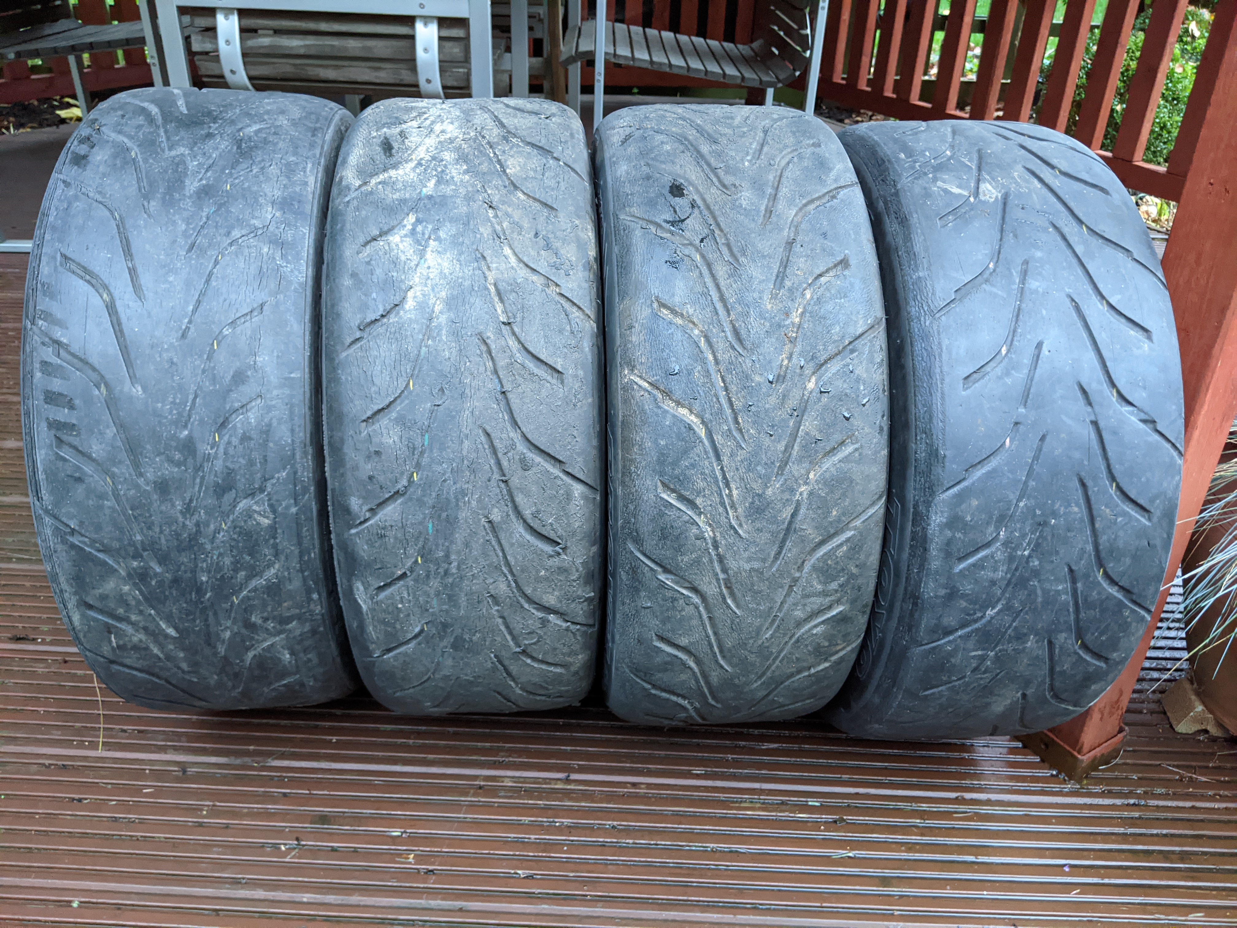

Bought a set of alloys with some used R888s, two are flogged and the other two have reasonable tread to them (2.5-5mm)
I'm going to repaint the rims and purchase road tyres. I want to ask those with experience with these tyres if there is any life left in this set for somebody?

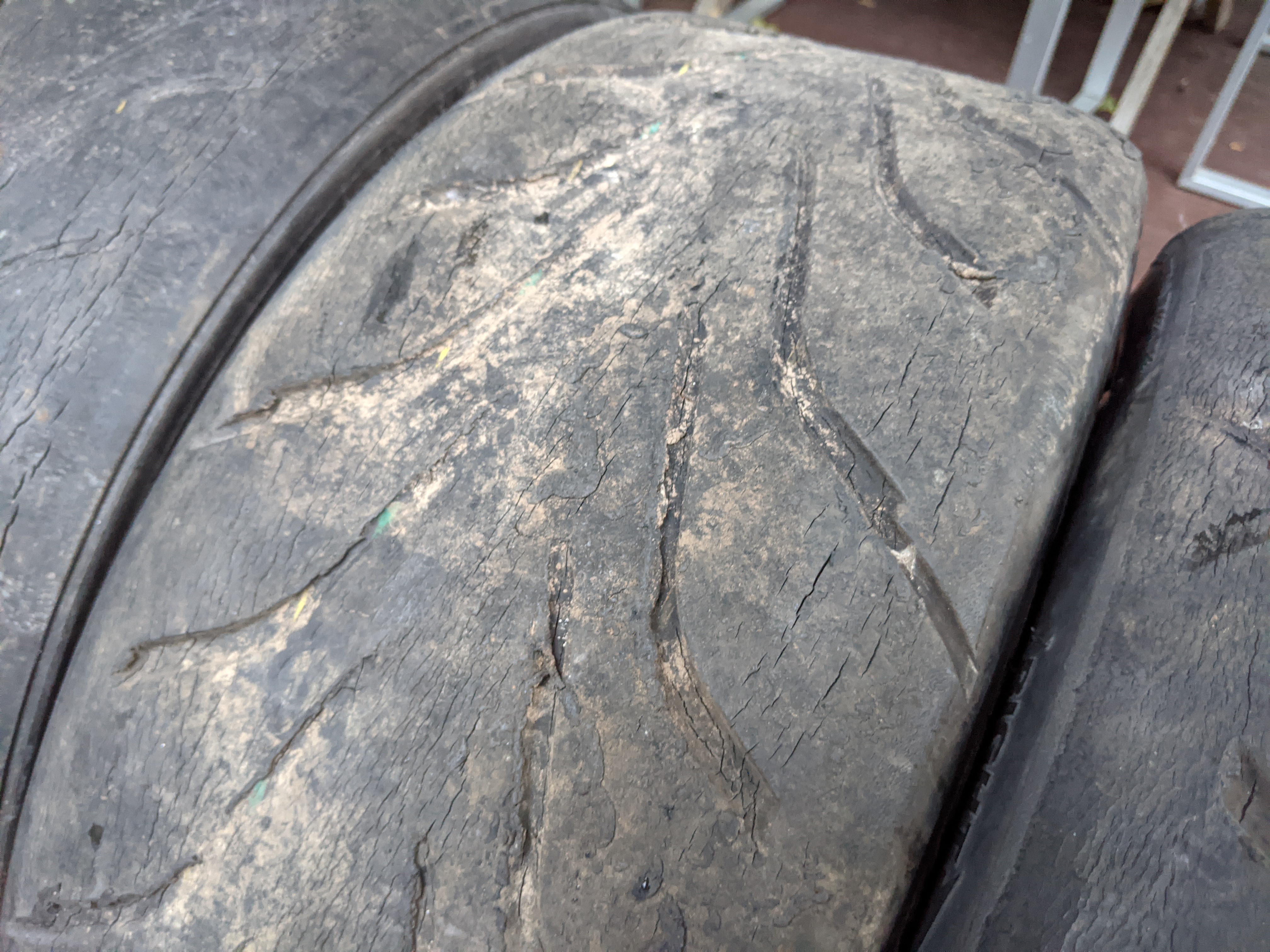

To be fair the first one seems alright. No sign of any hot graining so doesn’t appear to have been used properly on track much, but also no cold graining so it hasn’t been spanked from cold on track either. Wear looks like camber so appears to have been run at correct pressures. But it’s the sort of thing you’ll have in your garage for a year waiting for someone who is after one spare NLA tyre in an uncommon size.
The others have got a lot of cracks.
I’m guessing they’re all around the same age so it’s pretty likely that they’re all cack. If they don’t blow out they’ll have as much grip as a T1R.

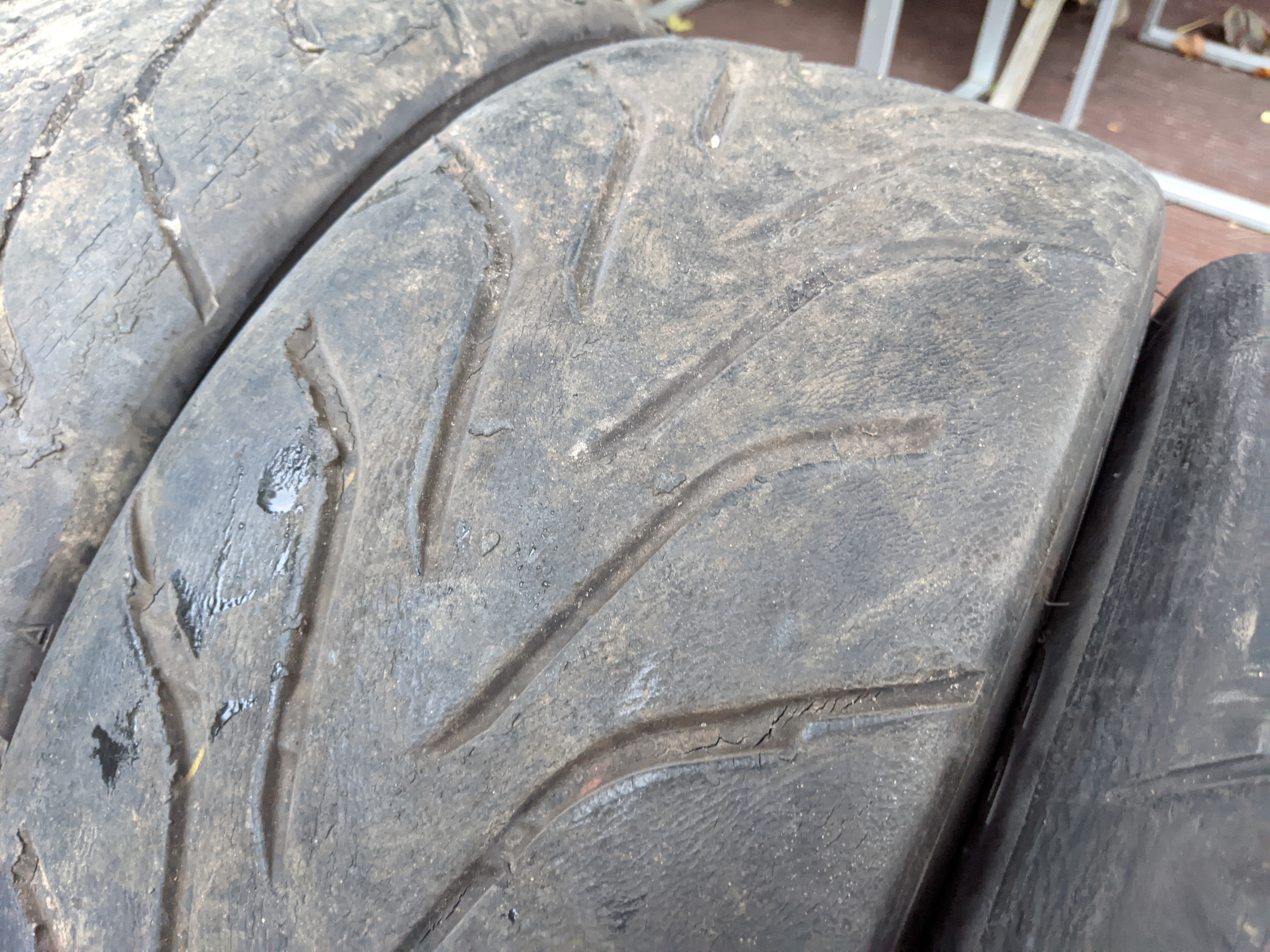

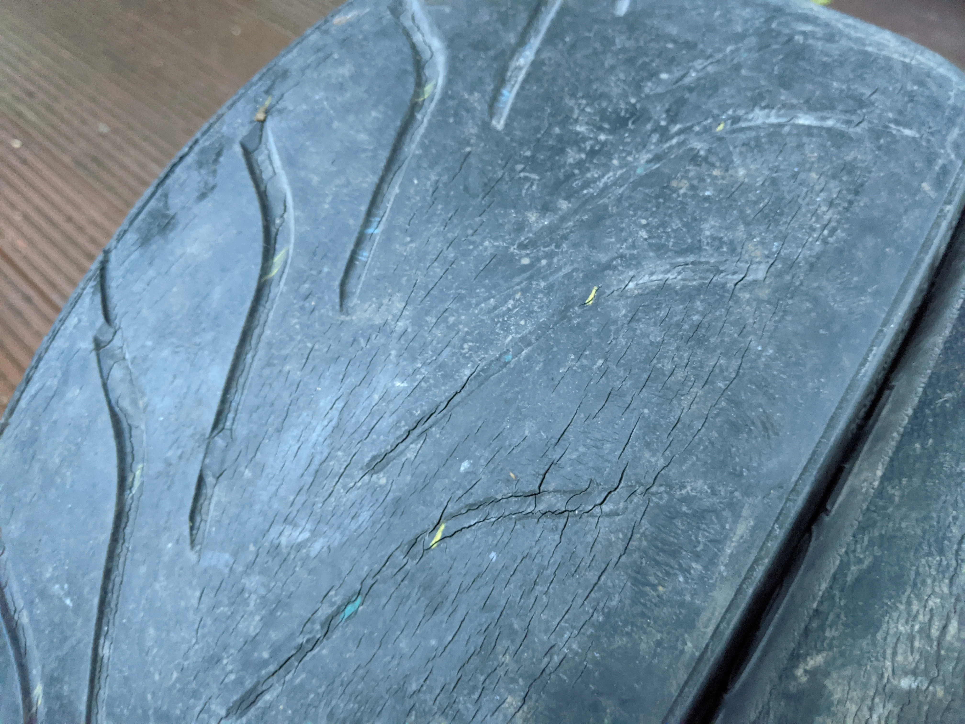

When you zoom in 3 & 4 have a ton more cracks than #1 though which makes me question whether they are actually the same age.
Is #4 cracked all the way around the circumference? Difficult to tell from the angle, but #4 looks to be flat spotted in the area of the cracks. Never seen it before (admittedly I’ve seen hundreds of knackered tyres but not 6 year old ones) but wondering if the two are mutually inclusive.
