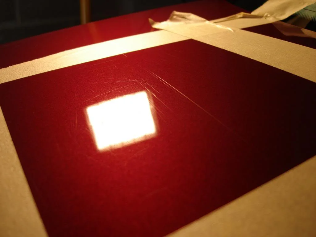

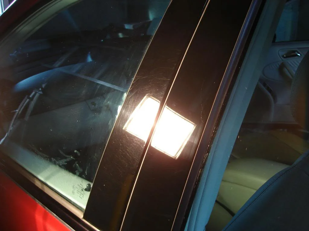

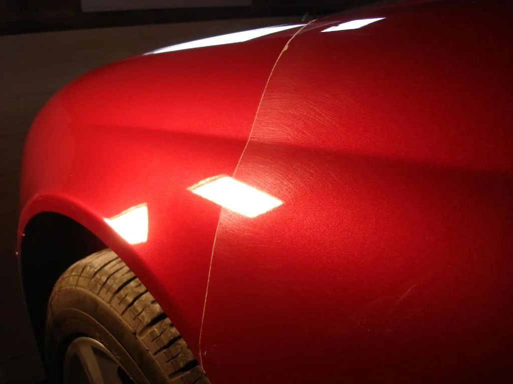

No, get a foam applicator pad and scratch x and work the scratch x into the paintwork using the pad, you need to really rub it in and work the polish untill its gone "greasy" though. The abrasives in the paint will break down. heres an example of what scratch X can and cant remove which i did myself by hand:
Can:
Cant:
Notice the swirls gone, but the deeper ones still there.
I MUST stress that when using it by hand its only for very light swirling or scratches, like the pics and like the very minor scuff/scratch i had on the caravan. if its deep like the ones in the last picture then youll get no where.
