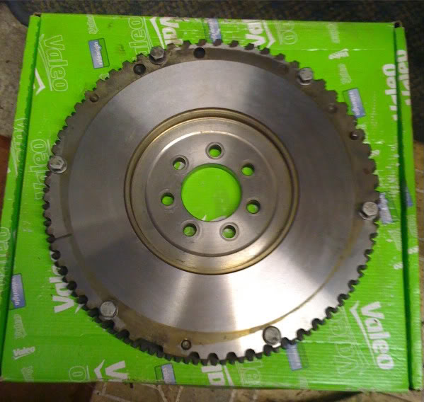

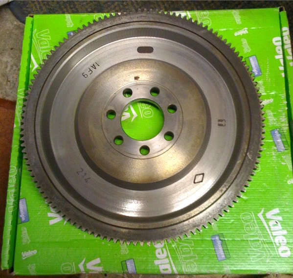

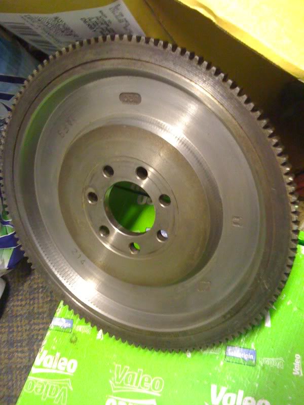

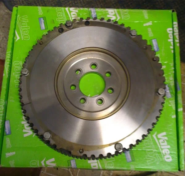

Got the work done through Prima racing... They lightened the fly wheel and dynamically balanced it with the clutch assembly
They managed to take a touch over 1kg off the whole assembly :)
Anybody in the Midlands area I would recommend Prima, although they dont seem to be "mentioned" in the Renault scene any more? they where very busy when I popped over.
Just need to fit it all now... :eek:
