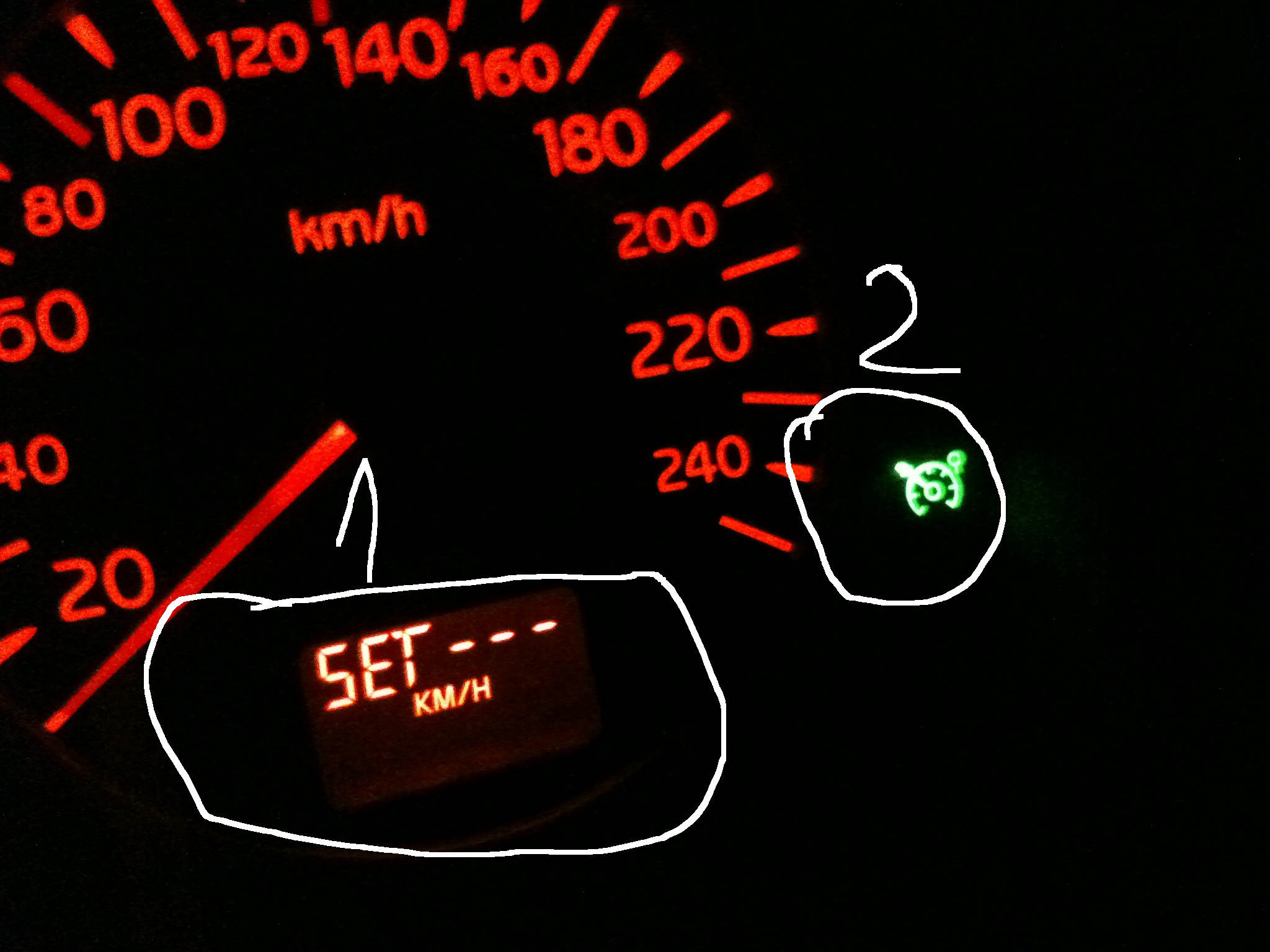

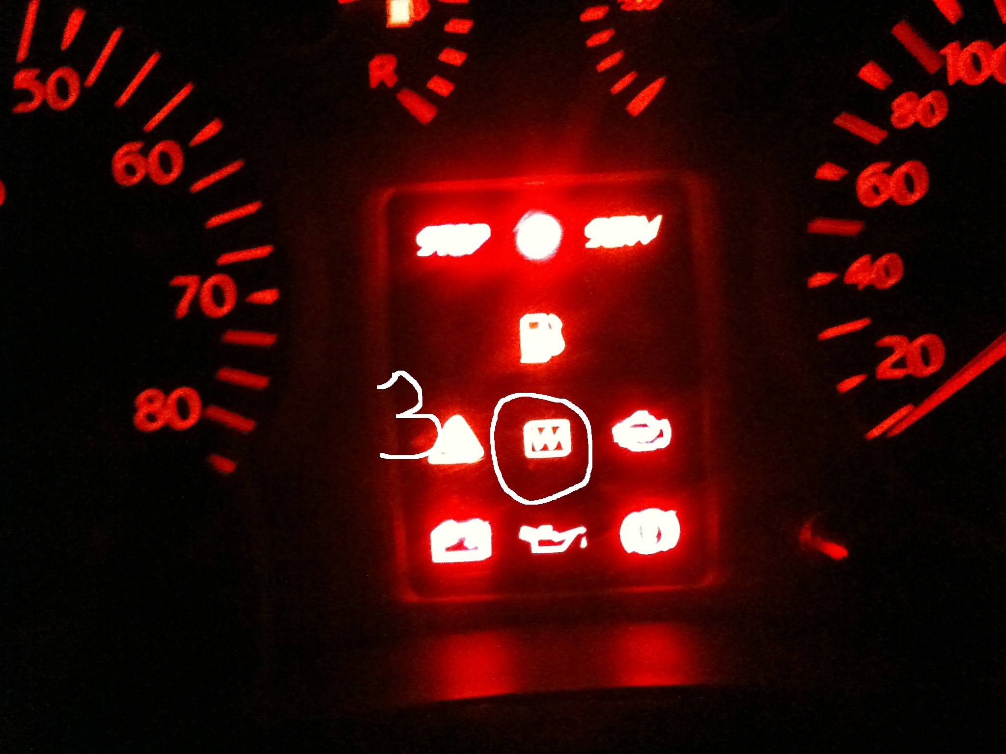

since yesterday my car in a limp mode and dont cross the 3k rpm, in the dashboard its turn me on few lights and i would like to know why and what they are mean.
I allrady understood that the light no 3 is the most serius and is that the one who enter the car in a limp mode, why is that happen and what should i do ?
when the problem has showen lights no 1 and 2 has been show everytime that i turn the car on what is that mean and why?

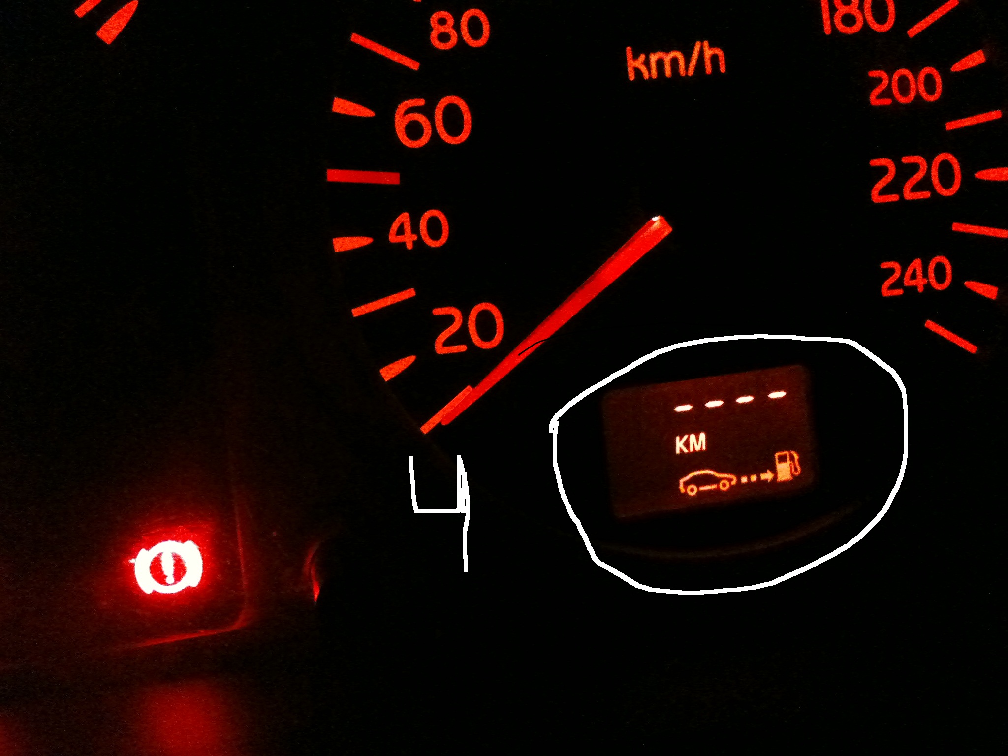

last month i have cleened the fuel injector since than this what the dashboard show me instand of the consumption of fuel, how can i fixed that ?
1 + 2 are because you have cruise turned on.
You need to get the codes read for number 3 i think
Press the button on the end of the right hand stalk to cycle through the fuel display things for number 4.

The light in the first picture is either cruise control of speed limiter. You can switch this on/off with a button to the right of the steering column.
As for limp mode... Use the search function on the forum. There's some good info about, including a thread I started ages ago after having limp mode issues.
tomarrow i will get into my garage and i will worte the coede that the car givres, 1+2 turns off when the problem dissaper so i think that there a connection between them, i've allready tried ti press that it didnt changed nothing about that

#3 the 'microwave' symbol is a fault in engine management, could be anything!?

i was into my garage and he told me that the engine management show's 2 problems the sensor behind the gas pedal and the sensor of the throttle, he cleaned the eroros and the sensors allso and told me to come back if its will be shown again
hope that there not any kind of damge, the sensor of the gas pedal wasnt calibrate
