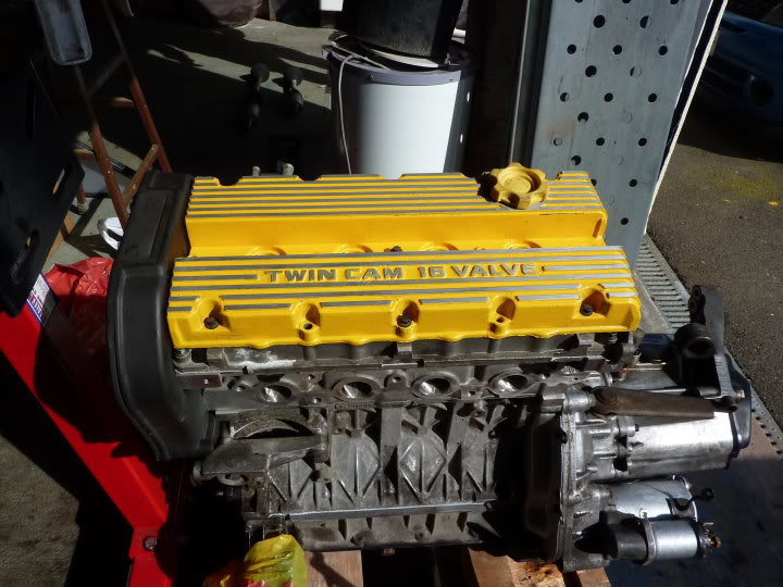

It's a 1400 16v Gti Engine
Custom Race Built
Different Throttle Bodies
Full Induction Kit
Loads more stuff
Theres the engine

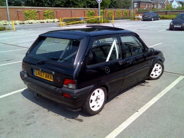

Not fully reshelled but stripped it to bare minimum, then rebuilt to the FIA requirements for my championship :)

Mems 3 VVC with ITB's and Emerald ECU, few other bits and bos exhaust and manifold wise
Found the spec-
mems 3j 160ps 1.8 16v vvc engine
janspeed 4-2-1 manifold
ashley competition exhaust system
de cat
Jenvey 45mm throttle bodies
latest emerald ecu with new software
Currently mapped at 192.5bhp, with printout to prove
1.1 gearbox with black diamond clutch
EBC drilled and groved discs
mintex 1166 race pads
lowered and individualised by reyland running 400psi in front and 450 rear
custom rear strut brace
Fully stripped interior,no dash,carpets,rear seats etc.
Bucket seats up front.
Roll cage
Around 650kg in weight

Ah I recognise that car, belonged to the user Kev180 or something yeah? Had a black gti myself, one of the better colours :)

It started off as a Rover 100 with Metro Gti spec :) Ah thats useful, thanks! :)
if the above car is the one i'm thinking i remember driving out of bournemouth in my s14a and seeing the little thing stuck to my bumper and wondering what the hell it was!
if you can get over the K-series head gasket failure fear they are rapid little things when you do the right mods. Suspension mods are basically free too. Shame they are becoming a rare sight now as most good ones have hit the scrappers years ago. I've had 7 gtis and would love another one to twiddle the spanners on :(
You running one of the Sport and Racing cranks that they sold of a couple of years ago. Claims of 9k reliable and 205bhp were out and about. Also, what rear subframe you running?
Must be fun in a little car like that... how much does it weigh?
Had our K-Series at over 260bhp for a couple of years now and nothing major has gone wrong, just need to be looked after!
