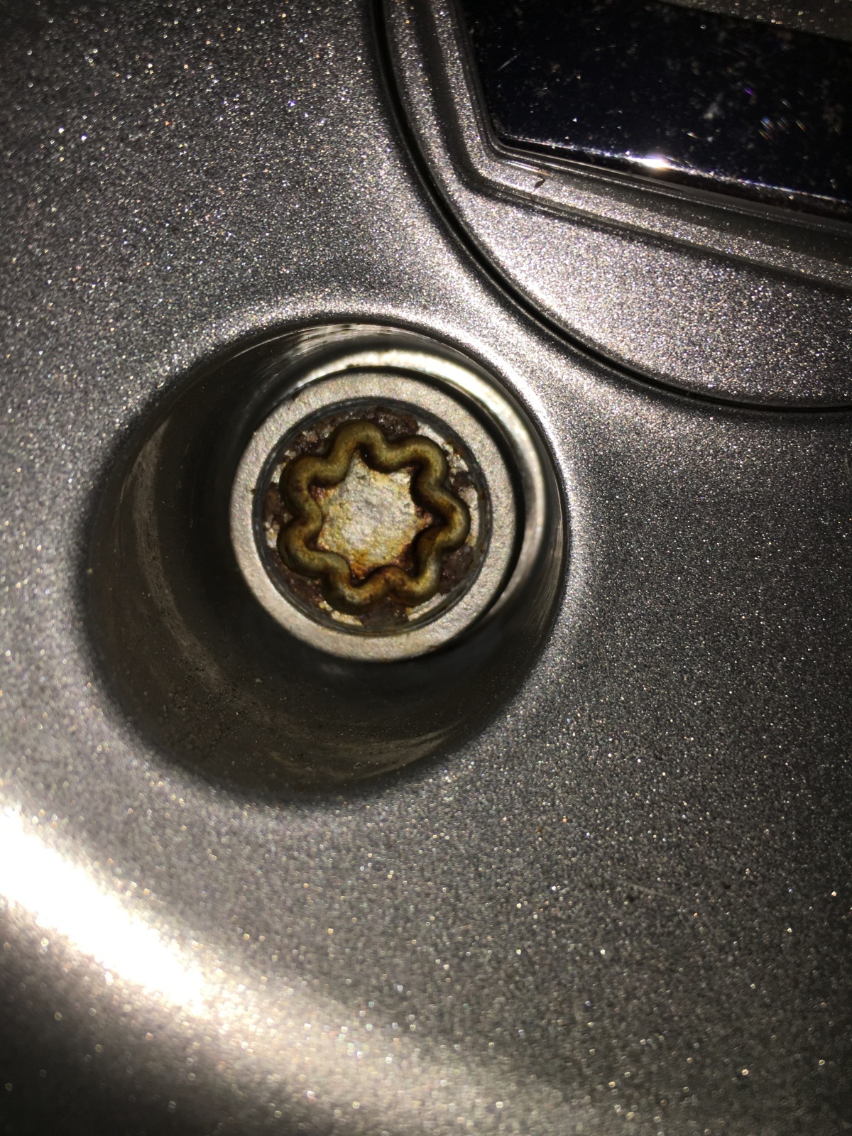

I'm having some trouble removing my wheel bolts. When I bought my car there where no keys to the locking bolts, but 2 bolts per wheel. Left and right different ones. The left side I could hammer an 18mm socket on and get it loose, but the other ones are just a pain..
I tried drilling them out but it just is way to hard. Welding them is my last option, but there is little space there..
I have a picture from the locking bolts, hope it works with the new uploading website. Maybe someone on here knows these and has a key or something.

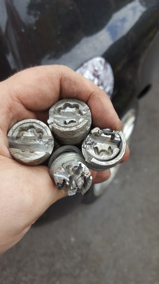

I had the same thing but because the wheels were being scrapped I just took a grinder, hammer and chisel to them (im 25 with no welding experience or equipment otherwise i'd have tried that). Left them in a right mess but didn't cost anything so was still relatively happy, here's the state of the wheel nuts after

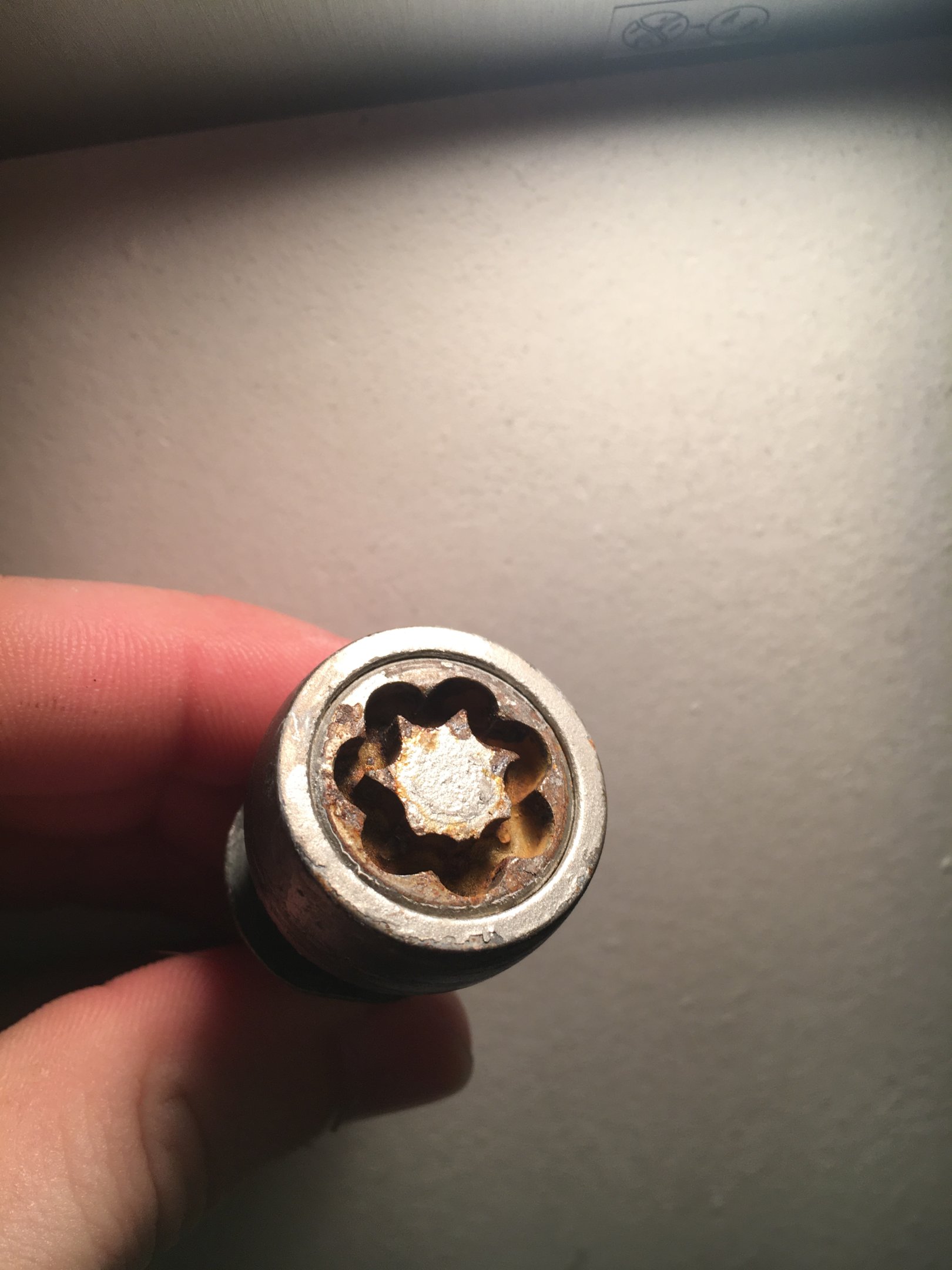

Update in case anyone ever gets the same problem and wondered how it ended - The key I ordered fitted, did have to give it a gentle tap with the good old hammer to get the key in.
Picture for a good reference of the bolts, weird ass pattern and high recommanded as anti theft locks if anyone ever gets a chance to buy them. Thanks for all the answers!
