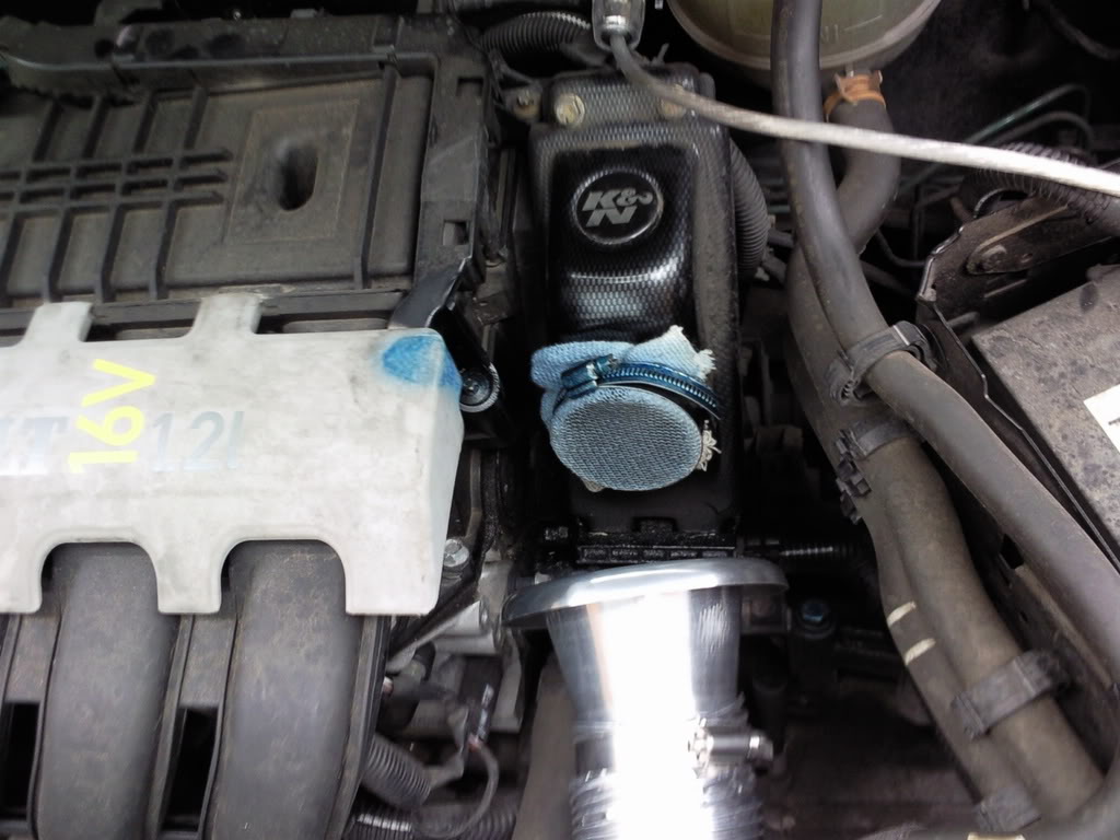

this is what i mean by where the cloth is...
what kind of cloth did you use??
it looks like an auld sock..?

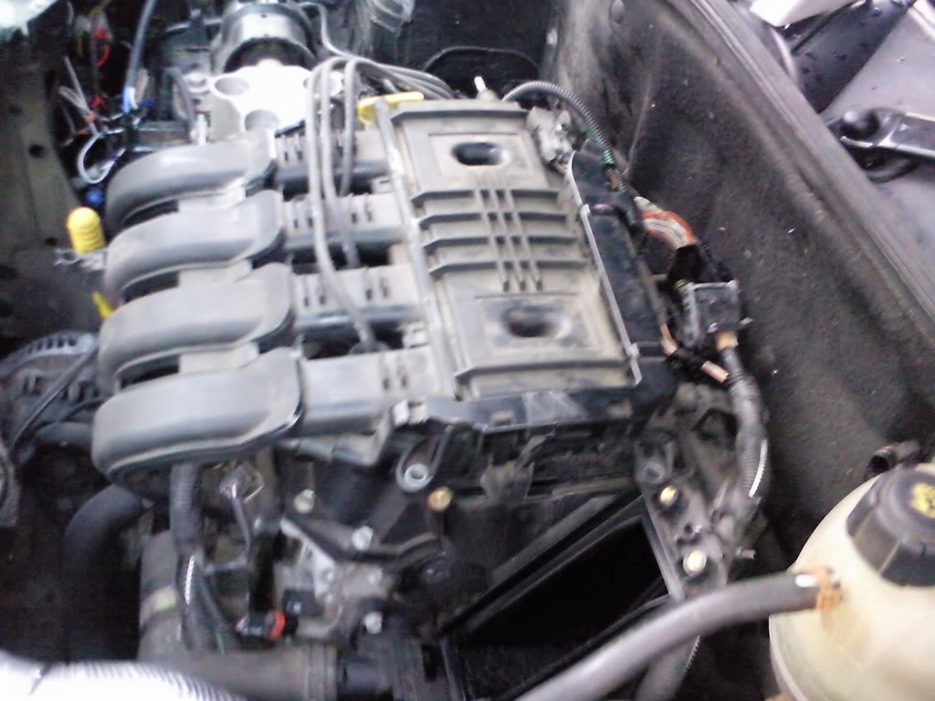

tried to get into the engine... my mate unbolt the head of the engine trying to getin to it, unfortunatly we couldnt find the throttle thing, the butterfly... we dont know where it is!
some pictures

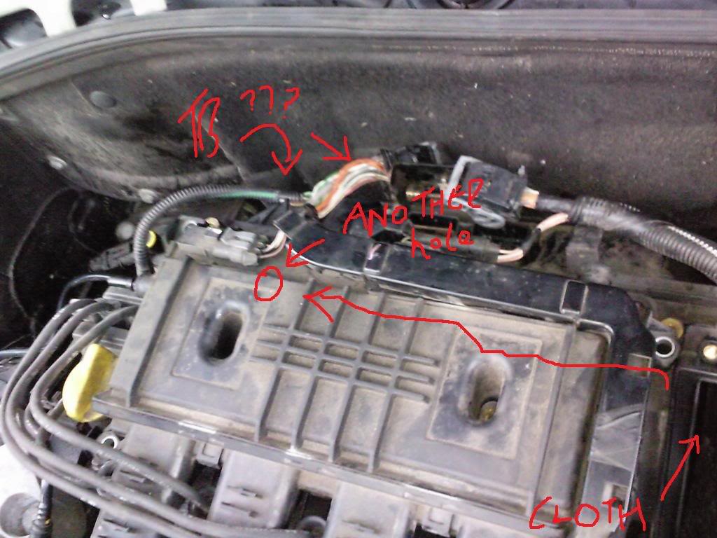

can someone please kindly shed some light to as where it is? the engines impossible to get into at the back and i risk unpluggind the ECU out too... i noticed that the black box is still there just the covers been removed so i couldnt take the b*****d other half of the black box off...

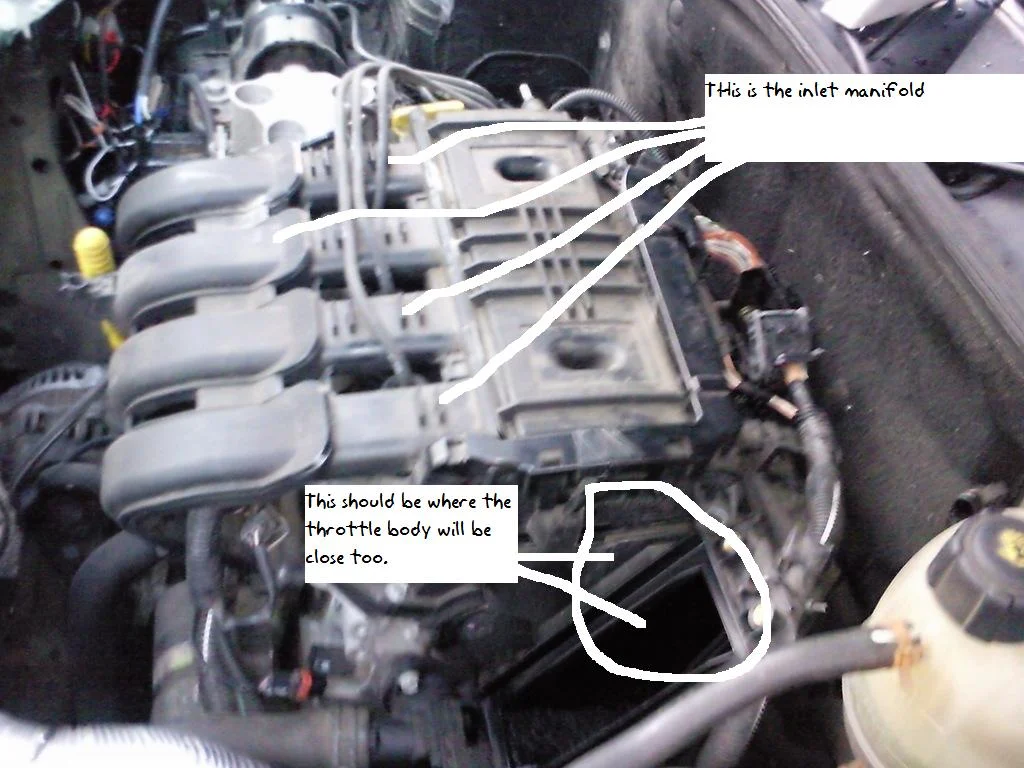

The throttle body is on the underneath of that plastic inlet maifold there easy to get off. the rag is possibly stuck in there and when u switched it off it didnt close and the injection system reads it everytime thus this is very the idle might be low/stuck
yes yes!! thats exactly what my car is doing revving/idling around 1500 revs... where is it did you say? can you tell me abit more specifically and where abouts?
See the black inlet manifold ontop of your engine (where the 1.2 engine cover should be) you have to lift that off and your throttle body is there.

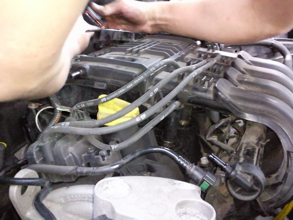

thanks matey :) i un did all the bolts today but i cant seem to yank it off... it was coming off but didnt come off completley... i dont know whats holding it!

how do you remove the coils? i think the wires are stopping me from removing it.

TB is BEFORE the inlet manifold. When you push your peddle the TB opens up and lets air into the inlet manifold. So you really shouldnt be taking that off. Just get to the throttle body which should be very close to where the air filter connects to, and when i say close i mean inches. Simple FOLLOW where the air would of gone from where the cloth first was and you will get the TB, whioch should be visible once the black casing is removed. Are you local to bedfordshire?

no am not local mate, btw is the TB at the back where the ECU wires are?? bear in mind this is a 1.2 engine we're talking about. people say its near the inlet manifold, then its near the induction/air filter area... am so confused
The pic with the arrows shows it perfectly......
The air goes into the filter/cloth, then left down a pipe towards the throttle body. You can see how far down the throttle body is height/position wise on the back of the engine by looking at the level/height the pipe is at thats leading to it.

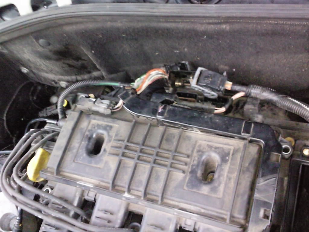

IIRC to get to the throttle body, you have to take that back cover off, which is attached to the inlets.... the black square thing, then the throttle body will be under there.
The air goes through the throttle body, then upwards into the inlets on these engines i think, so that HAS to come off to make the throttle body visable.
thanks for the replies, ive looked inside theres nothing in there but another hole.. we couldnt completley remove the plenum because the coilpack wires were holding it down, but as far as we could tell it wasnt in that chambre, the TB wasnt in there too...
only way you'l be able to investigate it further is by unplugging the coils, undoing the inlet and lifting it off, then go from there.....
