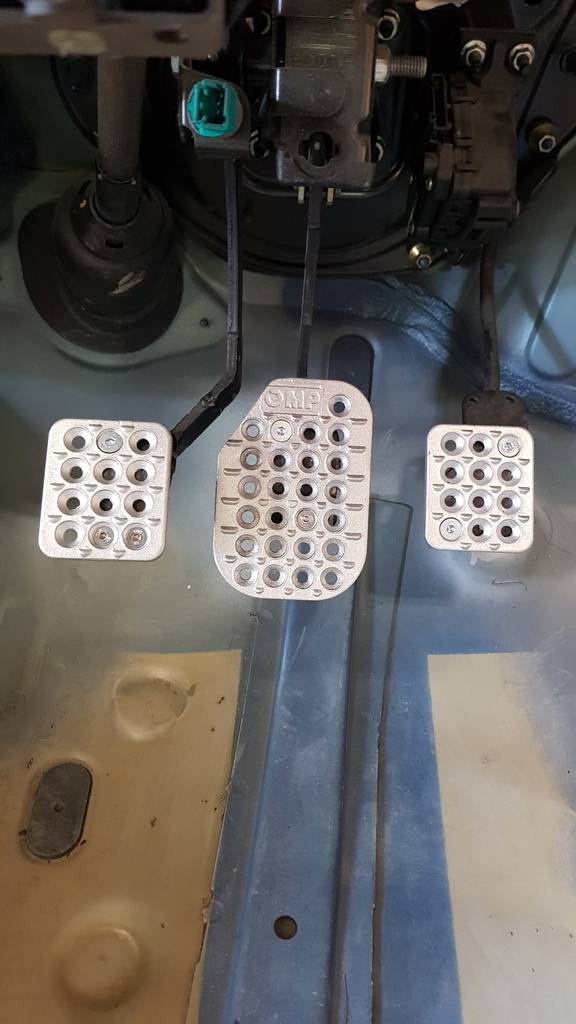

Those pedals look great. I'd be left foot braking when dipping the clutch with my trotters! Pedals look great for heel and toeing though.
Tempted to push the like button, but not untill you tell what they are, and where you can buy them.
All will be reviled once it's complete, although you could probably work it out from the pic with the part number on it ?

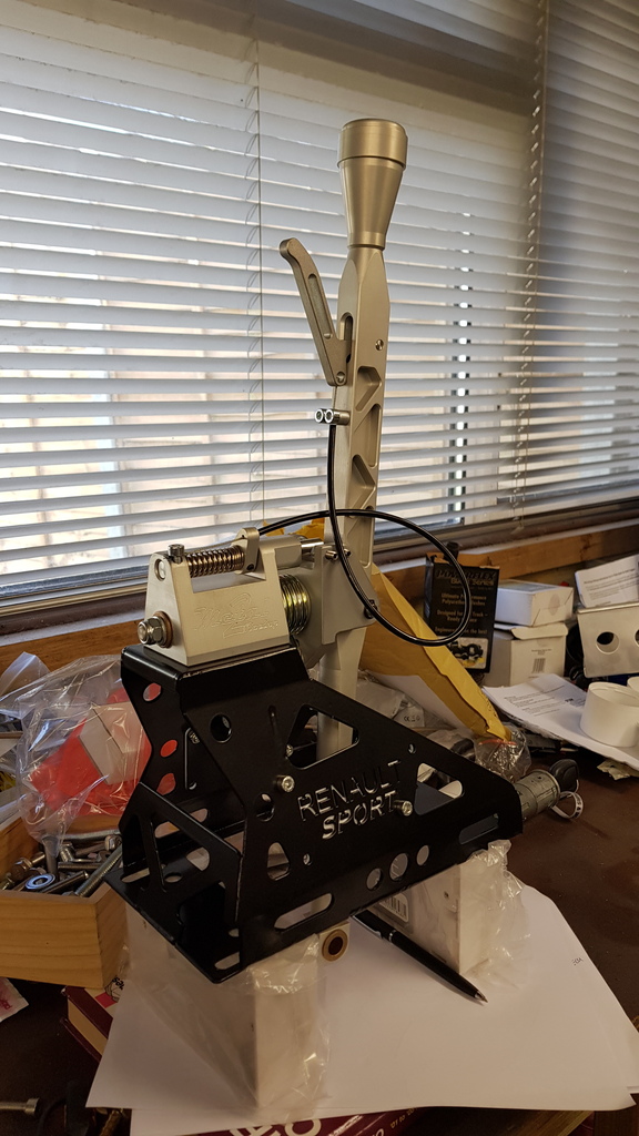

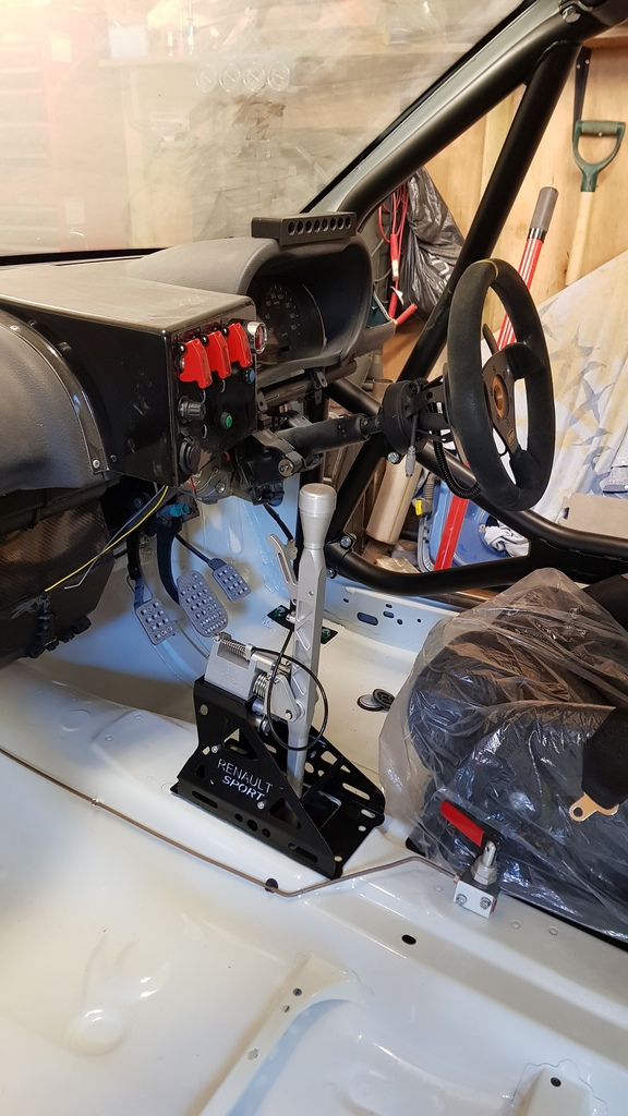

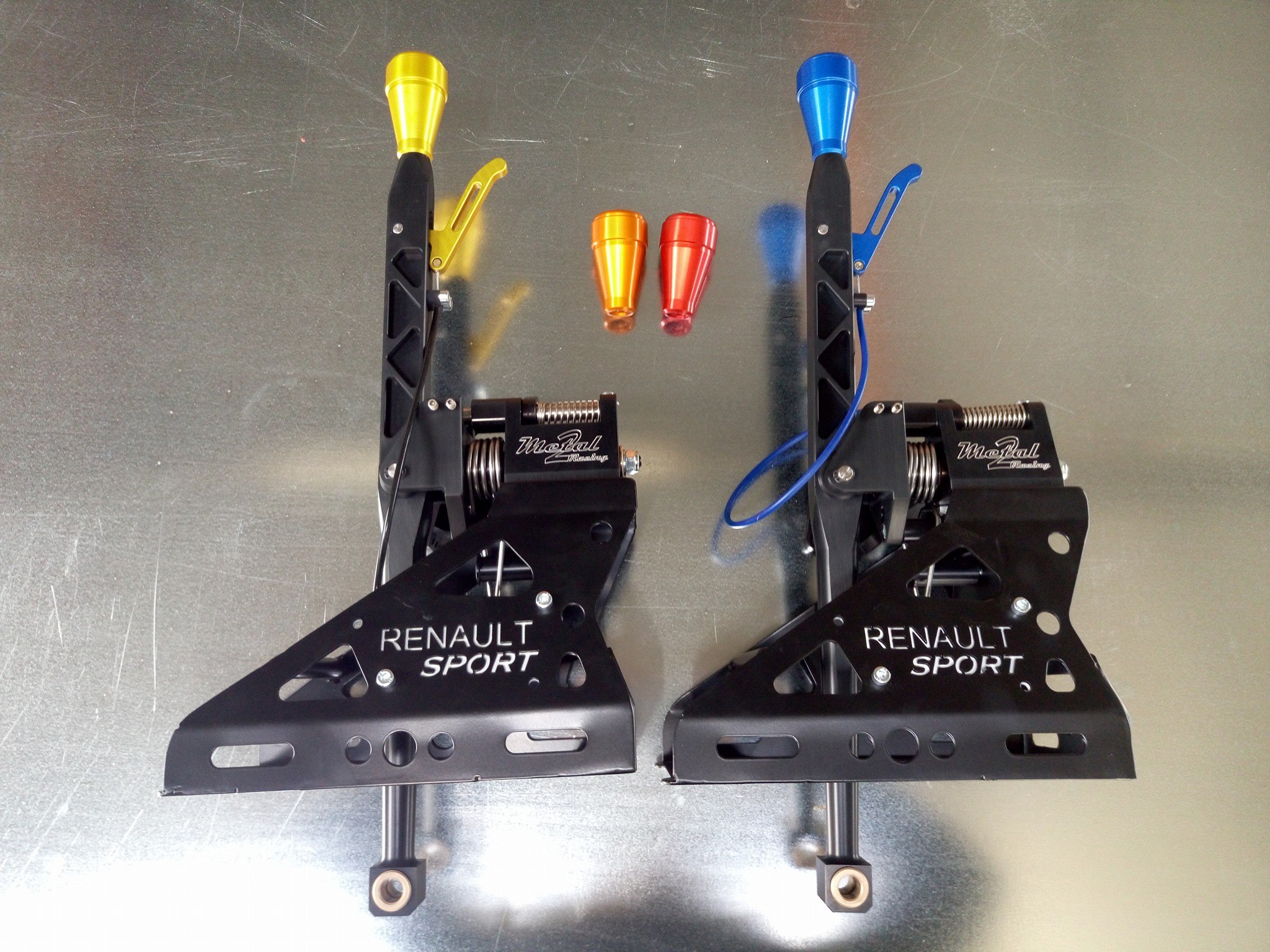

Looking good, what’s that shifter mate? Think I need one ?
It's a Metal 2 Racing shifter (on Facebook), similar to the CAE shifter.
That shifter looks a bit tasty!
Nice neat job with the handbrake hole. What you doing handbrake wise?
Thanks, no handbrake !, don't need it on a track car ?
Search on here or google metal2 racing shifter about £330 quid so reported
Try about £460 posted ??

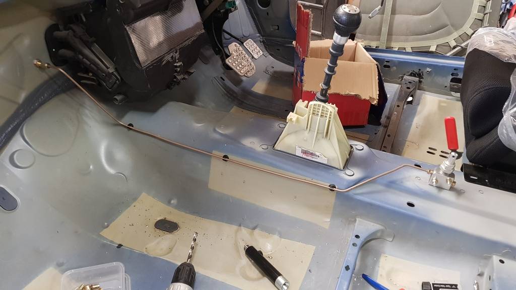

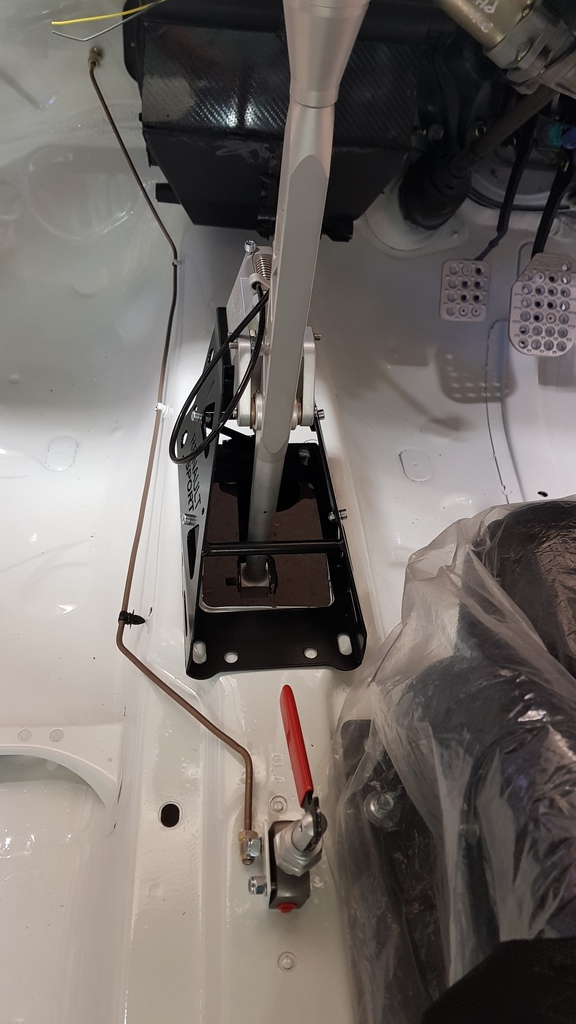

Soooooooo, been spending a bit of time and cash recently. Got myself a Cartek battery isolator as i didn't like the pull cord jobbie. Got a rear lever bias brake proportioning valve so i can make a start on the rear brake lines. Also been purchasing switches, relays and having parts 3D printed. I'll show the 3D printed part once its fitted.
I'm tempted by one of these..... over the PMS shifter but on the fence at the mo.

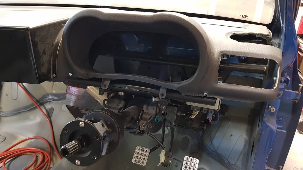

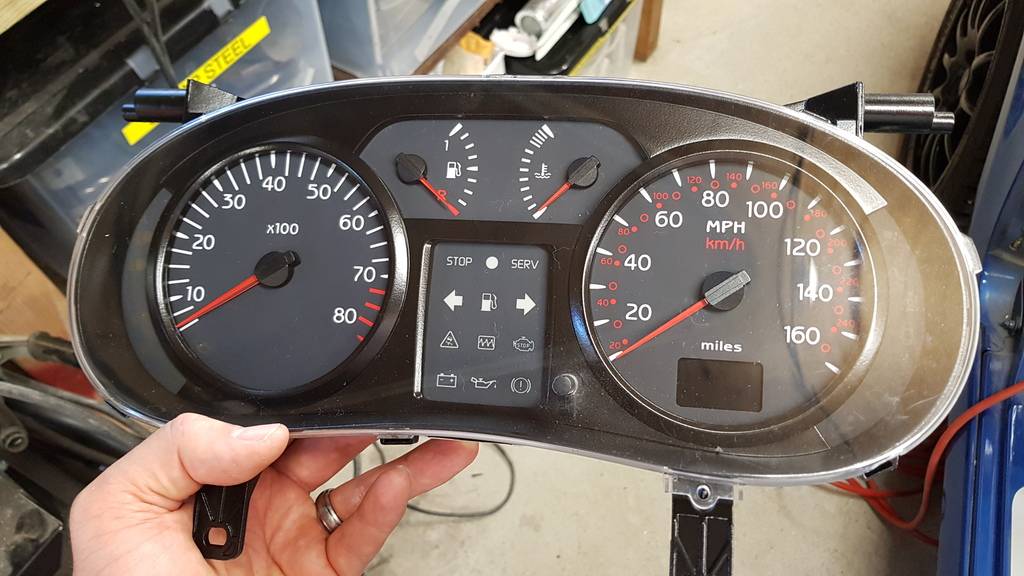

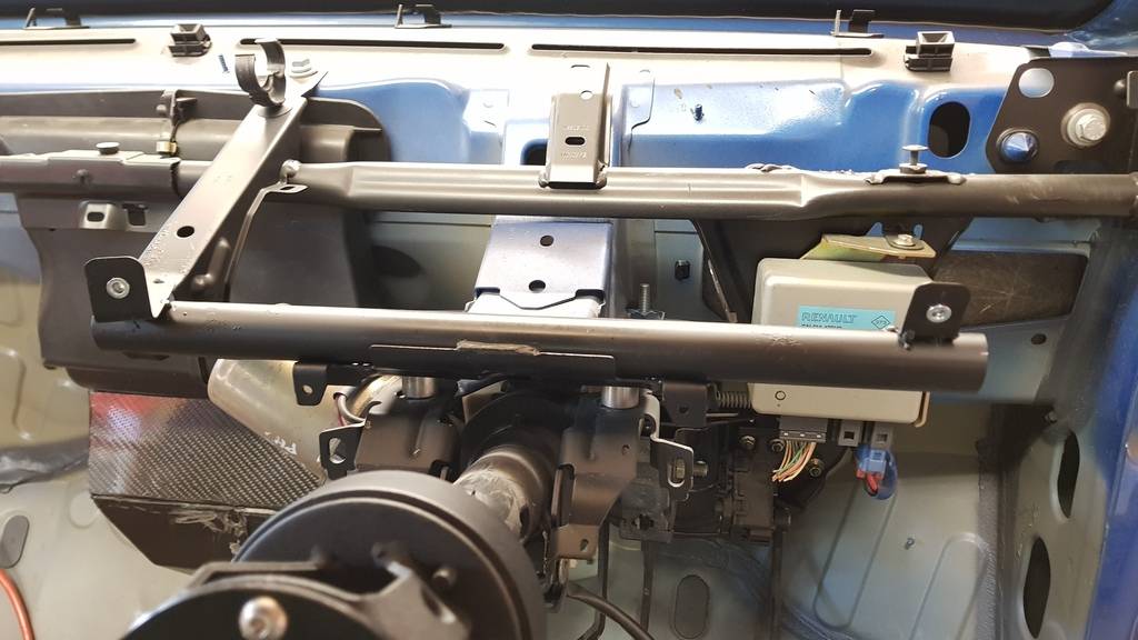

On to the dash.... I wasn't happy with it floating around between the rollcage so i've welded on a couple of brackets with a rivnut so i can screw the dash to it securely. I've already changed those silver hex screws for black dome head hex screws.
I've also painted the clock surround black.....

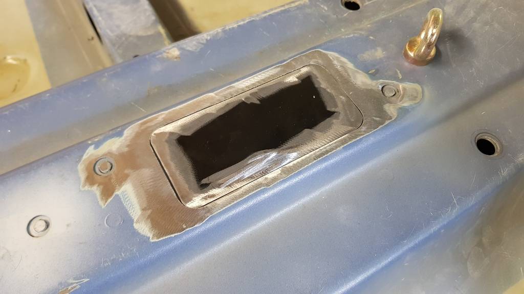

Whilst i was welding the brackets on i decided to weld up the hole where the handbrake was (don't need it anyway)....
Pedals are fitted....

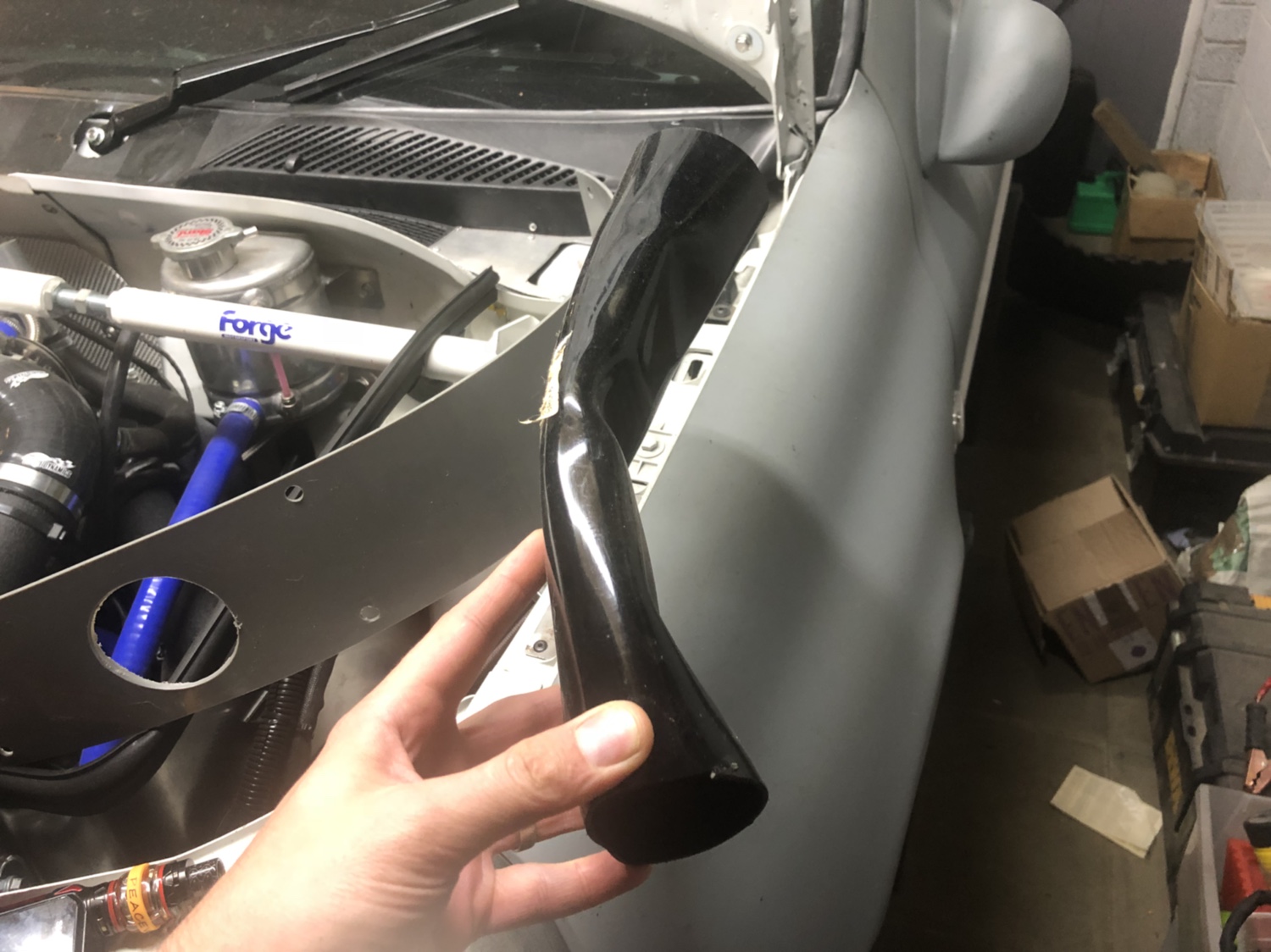

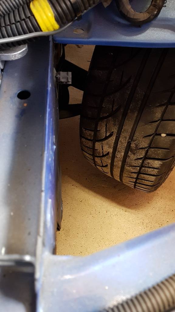

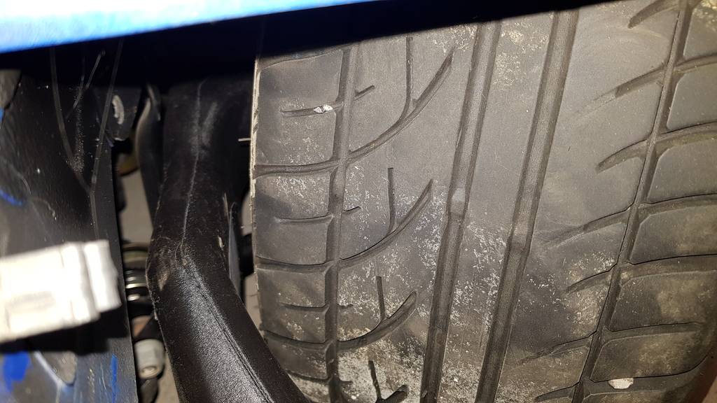

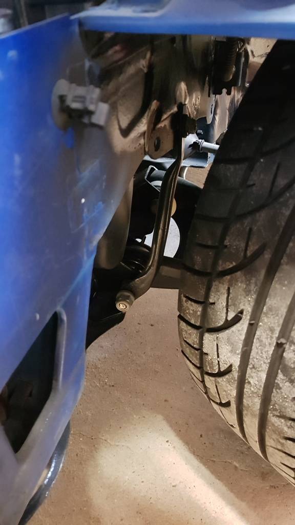

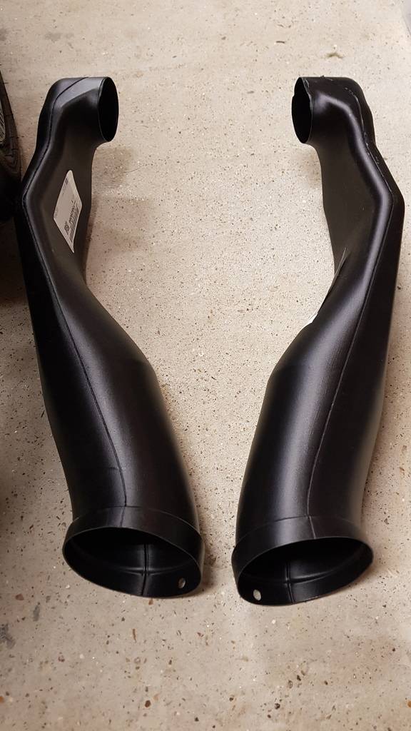

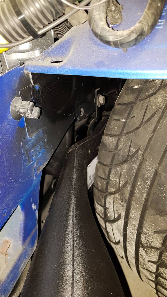

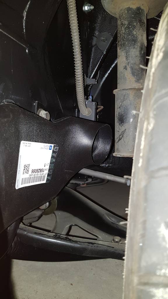

And now onto the head scratching part.... Brake cooling ! I've been thinking about the best possible way to get fresh cool air to the brakes. As you can see, its pretty tight on full lock....
But there is a good couple of inches and so the search started for ideas and i found one which i think works.....
The routing is pretty perfect and it lines up with the fog light holes. I'm also thinking of a bit of ducting to either the disc or caliper, haven't got that far in the plan yet but just getting the air flow to that area is a massive step !!
Hehe I was looking at those duct about a month ago.. didn’t want spend what they wanted. Not this in particular but similar. Even tried make my own (melting and bending gutter pipe) but looked to ghetto to fit to a track car haha. So resorted to a slightly different solution. Will update my thread once finished

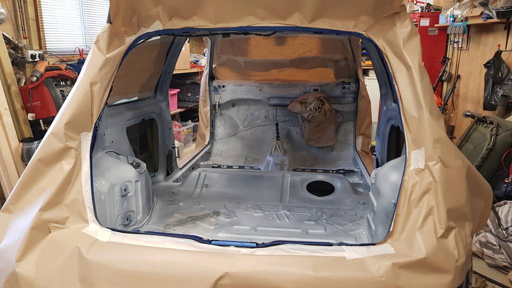

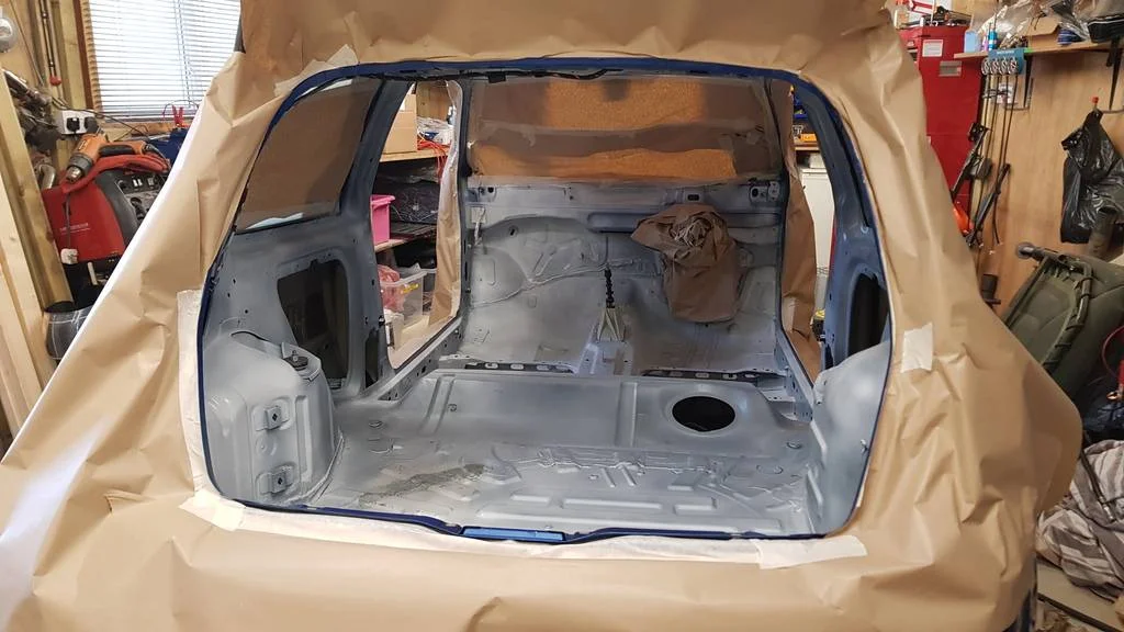

The other day i decided i would start on the rear brake lines, starting of inside the car.....

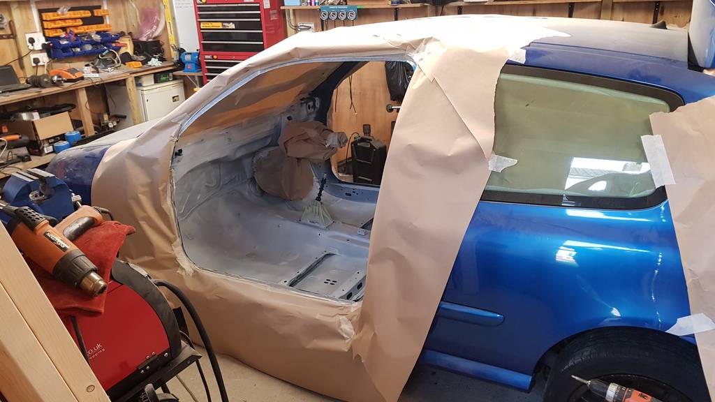

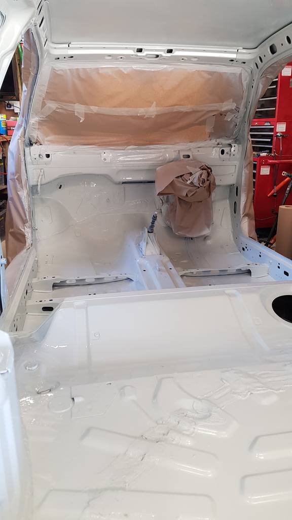

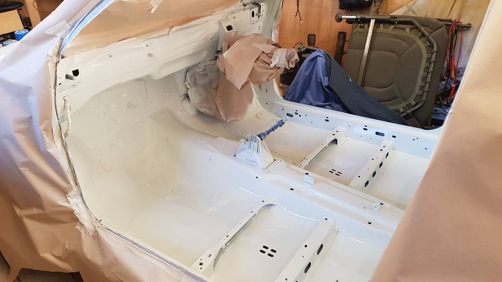

But then i thought nah.... i'll paint it so i can get the inside finished off. Did some masking and then started spraying with rattle cans but after 3 cans i had had enough and my finger tip was numb, plus the coverage from utter sh*te....
SO i bought a cheap HVLP spray gun and some Ford Diamond White 2K paint.....
It's by no means perfect but for a first time HVLP spray job and it being just a track car interior it will do! Then I started the interior rebuild....

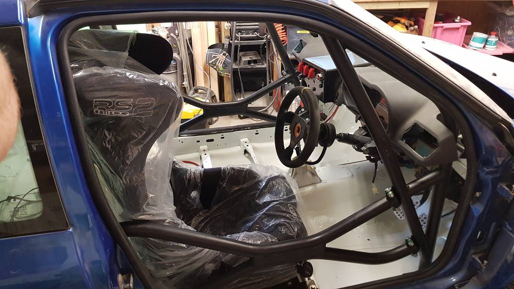

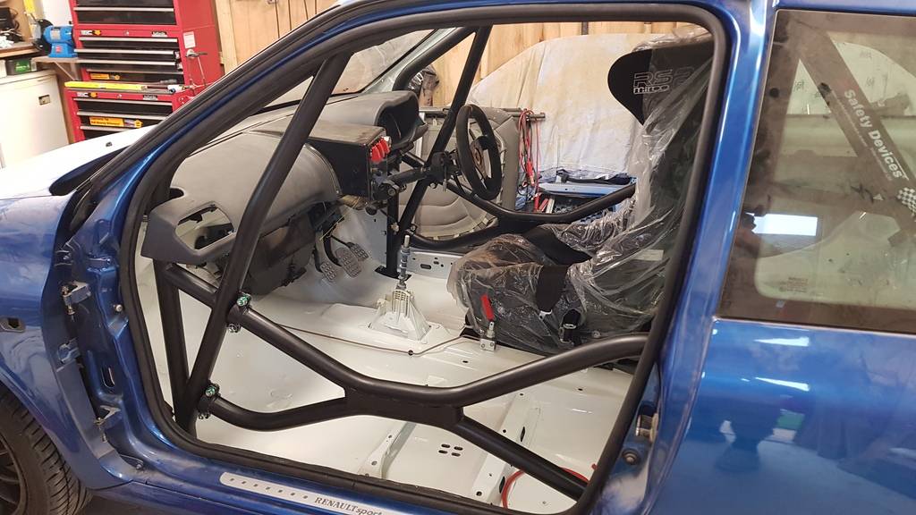

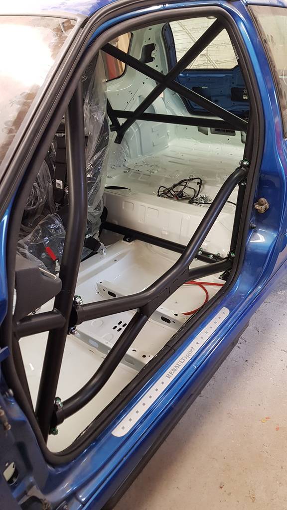

Rollcage is fully fitted now, all bolts torqued up marked with torque/nut security paint.
I'll be moving onto wiring next before getting the car back up on axle stands for the rear end strip down and rebuild. Plus a few other goodies to fit ?
What shift lights are they dude? And any info on shifter?
Good alternative option to PMS? @AdamCup
DIY, designed myself and had it 3D printed. It houses 10x 10mm LED lights. However, i think it might be too big. Also, that's not its final resting place, it's actually going underneath where it is now.
The shifter is a Metal 2 Racing shifter from Italy https://www.facebook.com/racingM2/. As far as i know i'm the only one in the UK to have one. I bought it as an alternative to the PMS one and it looks the dogs b****cks !

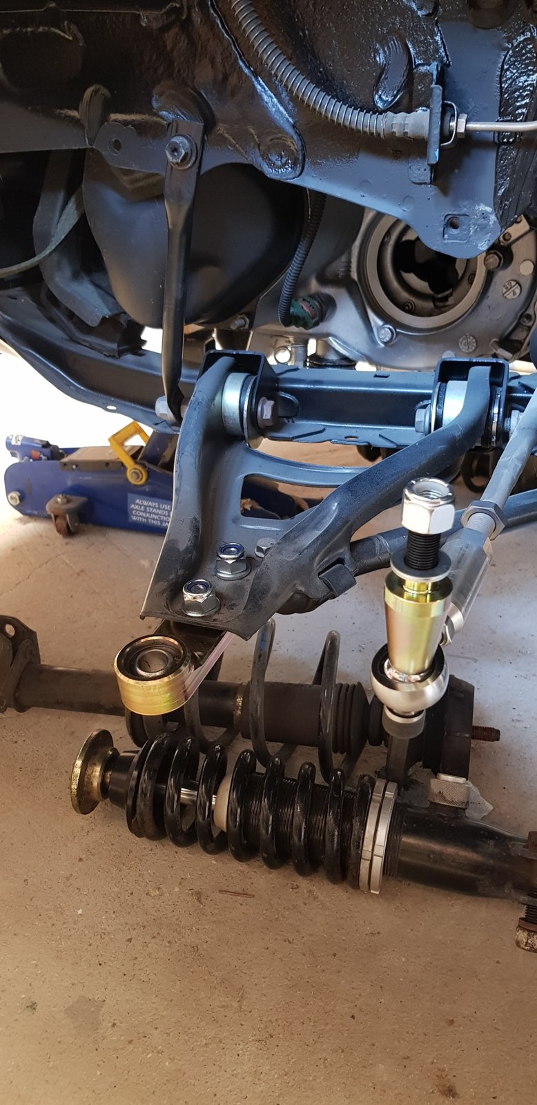

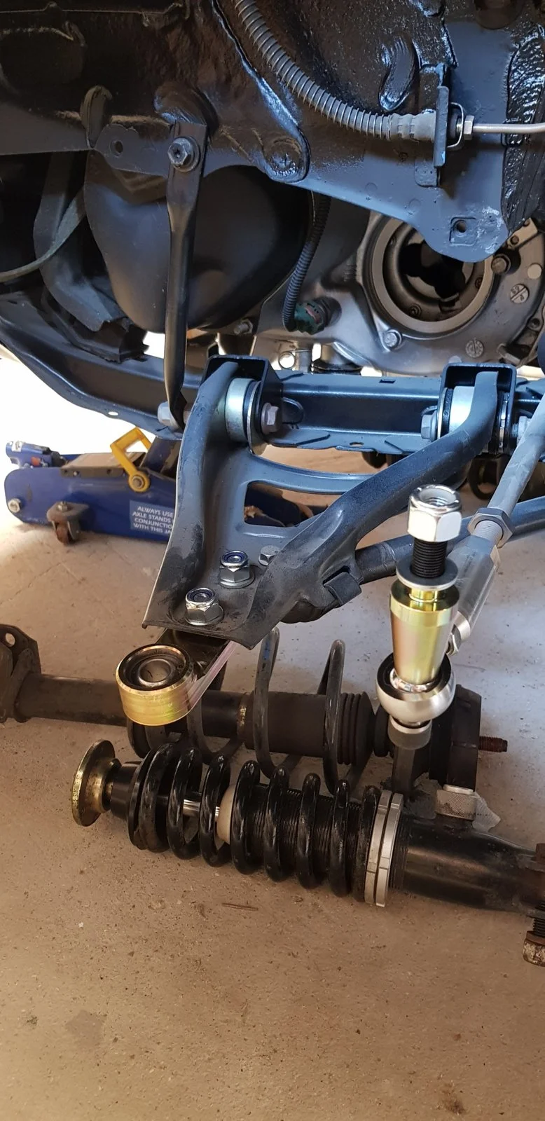

First thing was a set of Gaz Gold coilovers, 2nd hand, 12 months old and only done approx. 600 miles. They have 600lbs springs on the front and 350lbs on the rears.

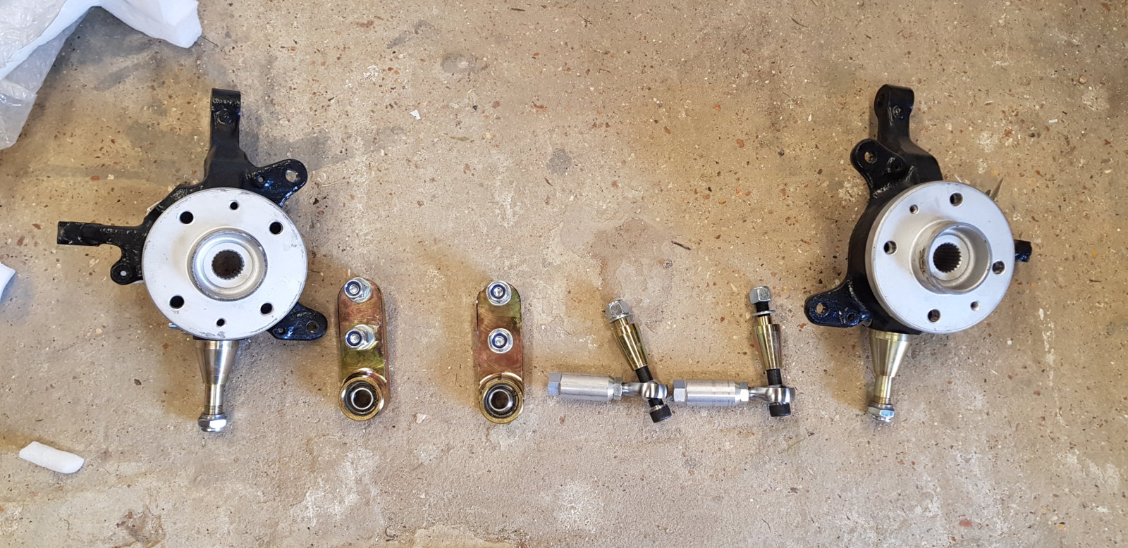

Now from the last pic you probably noticed a couple of other bits i purchased, 2nd hand Pure Motorsport strut brace (not pictured) with top mounts and a @NorthloopCup roll centre/bump steer corrector kit :cool:
More money....... Pure Motorsport 22mm ARB, rear beam stiffening kit and front wishbone stiffening plates.

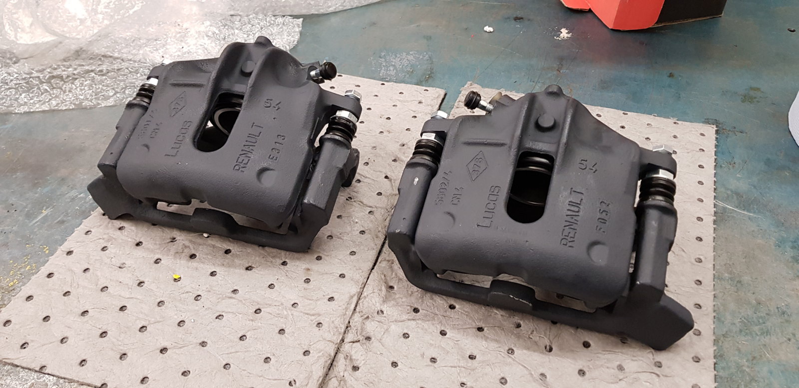

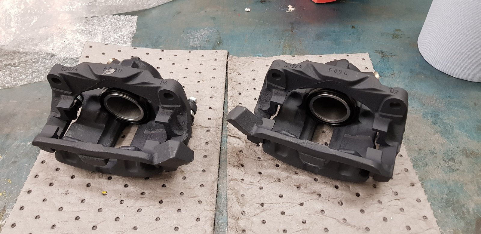

I suppose the only actual bit of work I've done is rebuild the front calipers......

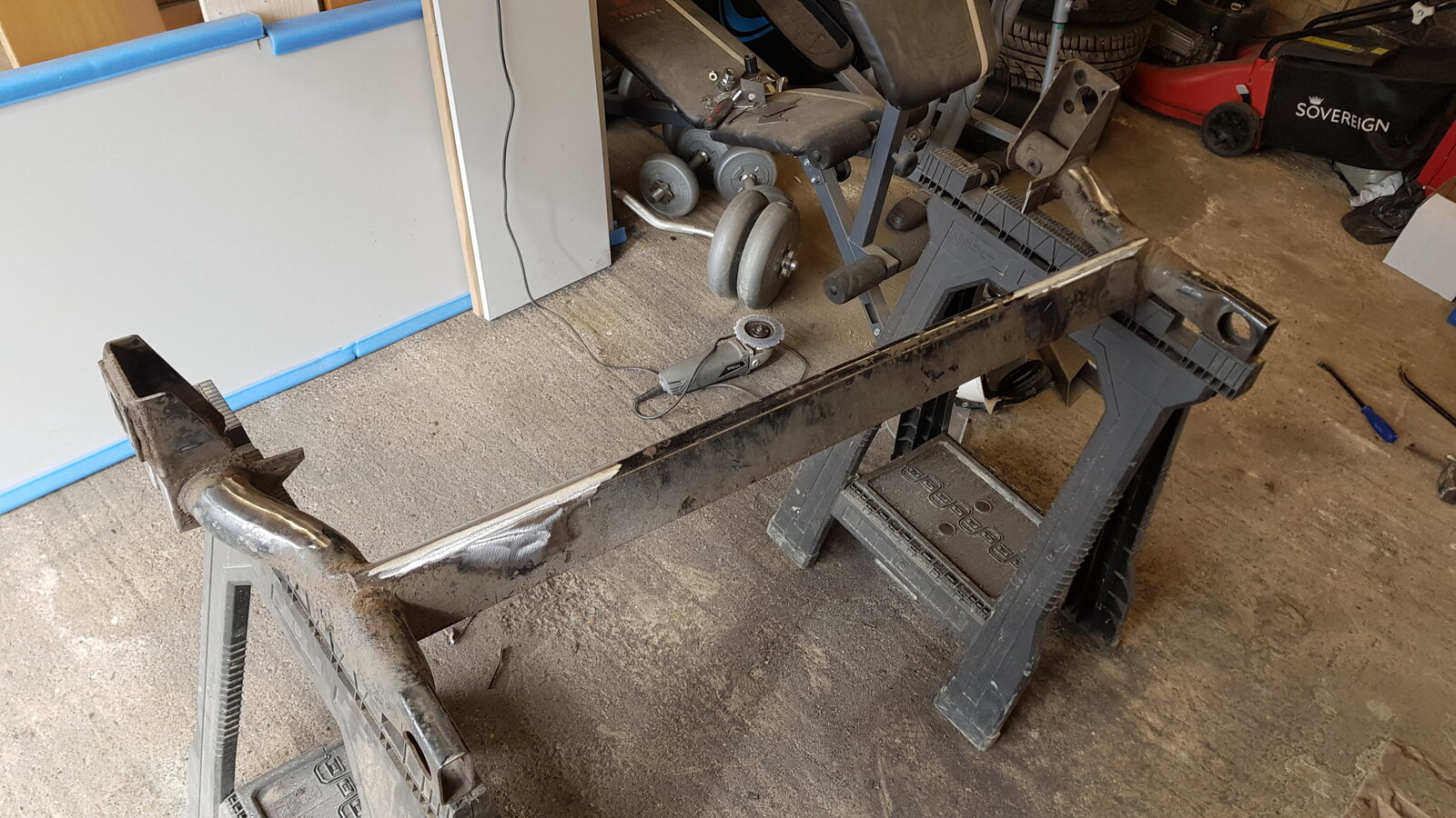

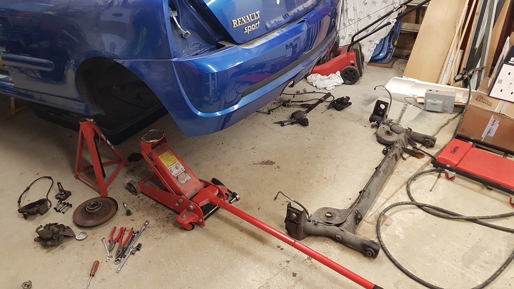

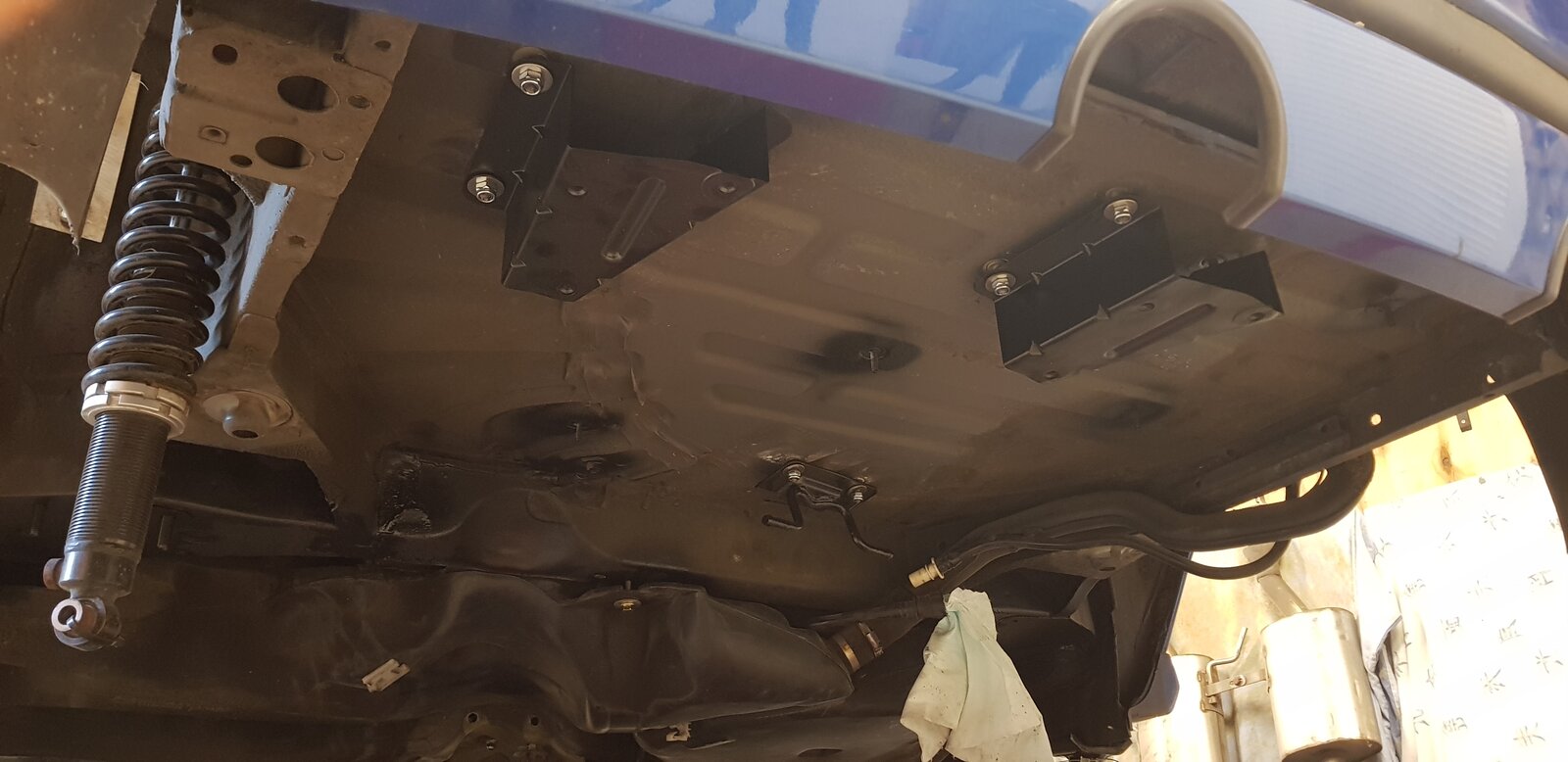

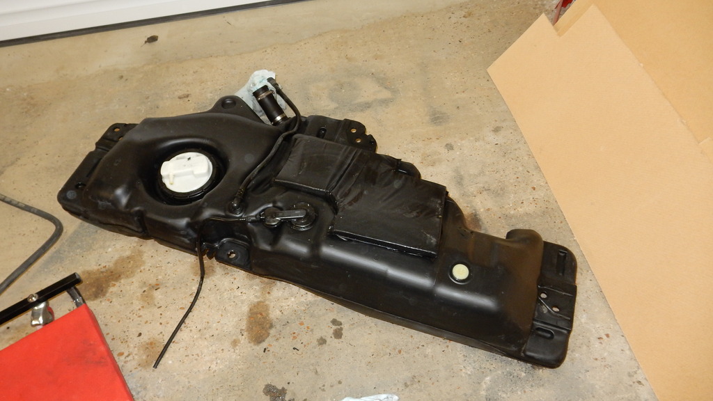

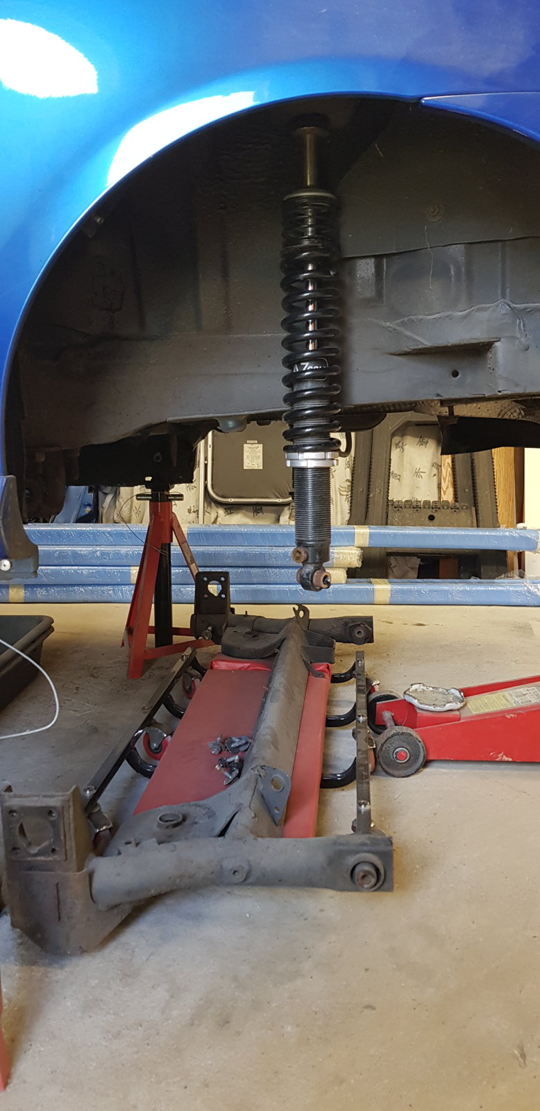

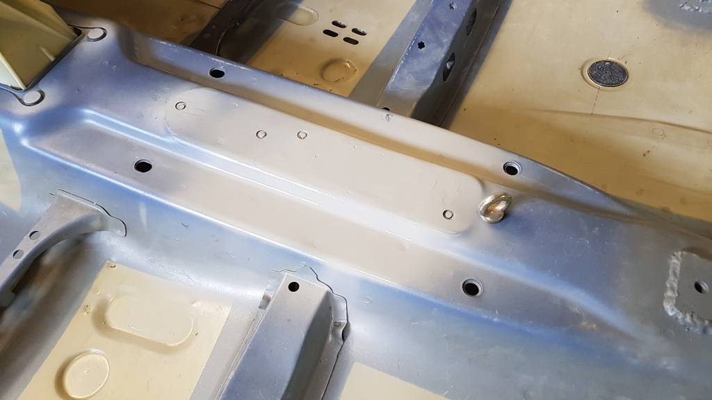

I've been working on the rear lately, as and when I can. With the rear beam off, there was some tidying to do on the underside. Some light rust patches, gone with a wire brush, treated and then sprayed over with some Hammerite. Fuel tank refitted with new bolts. I sand blasted the exhaust mounts and got new nuts and washers. New rear beam mounting bolts have arrived to replace the original ones, I went for M10 12.9 High Tensile Allen Bolts.

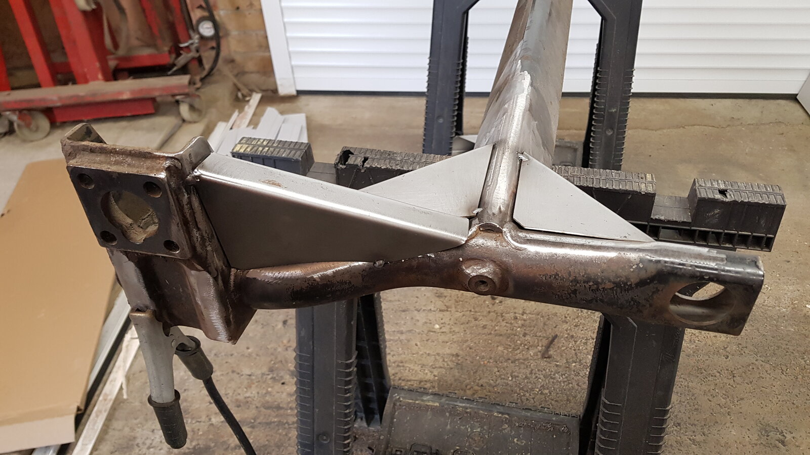

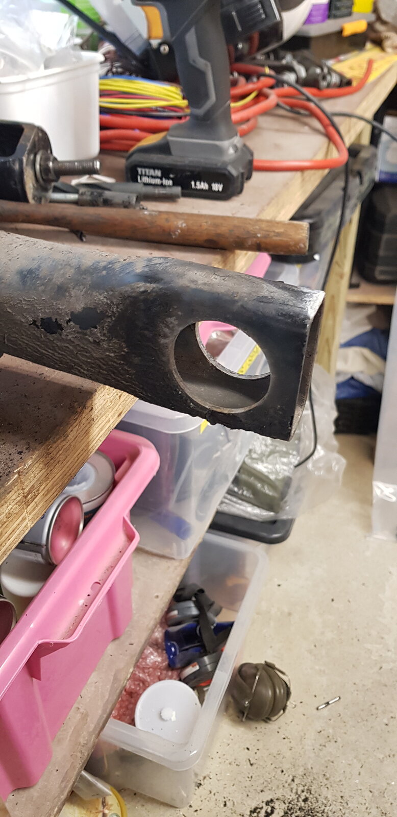

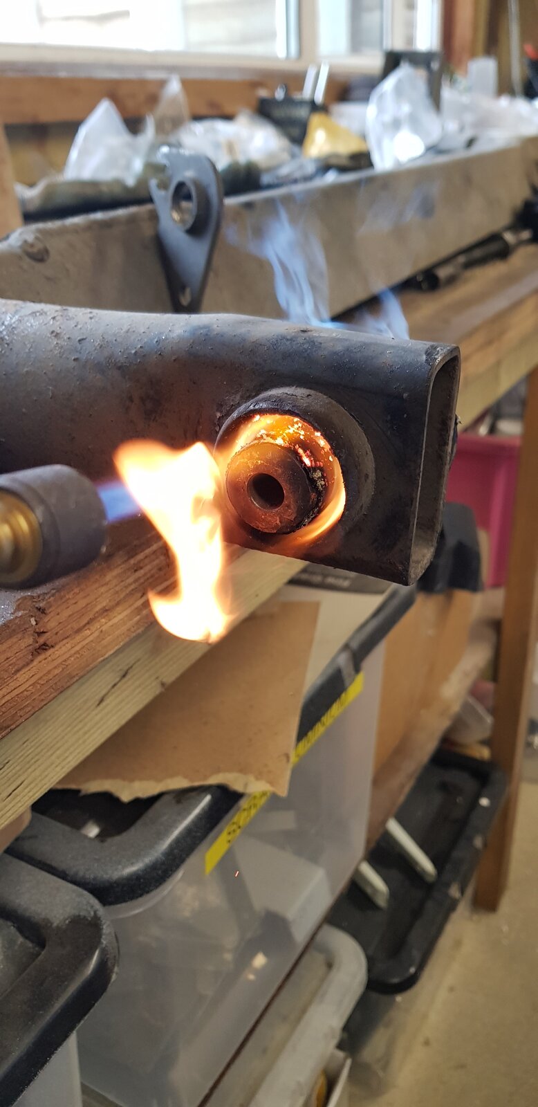

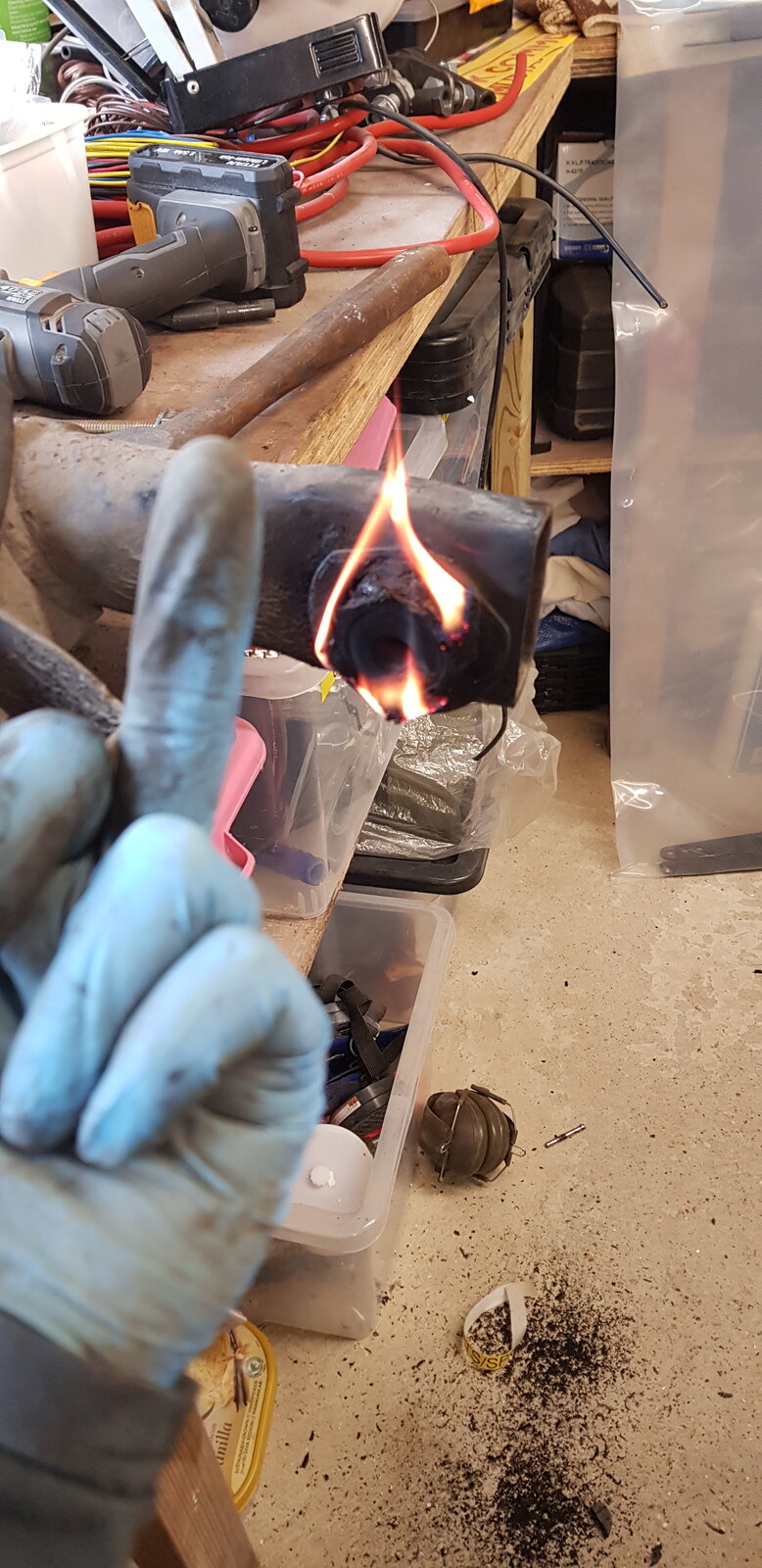

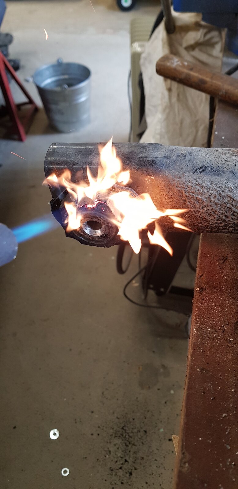

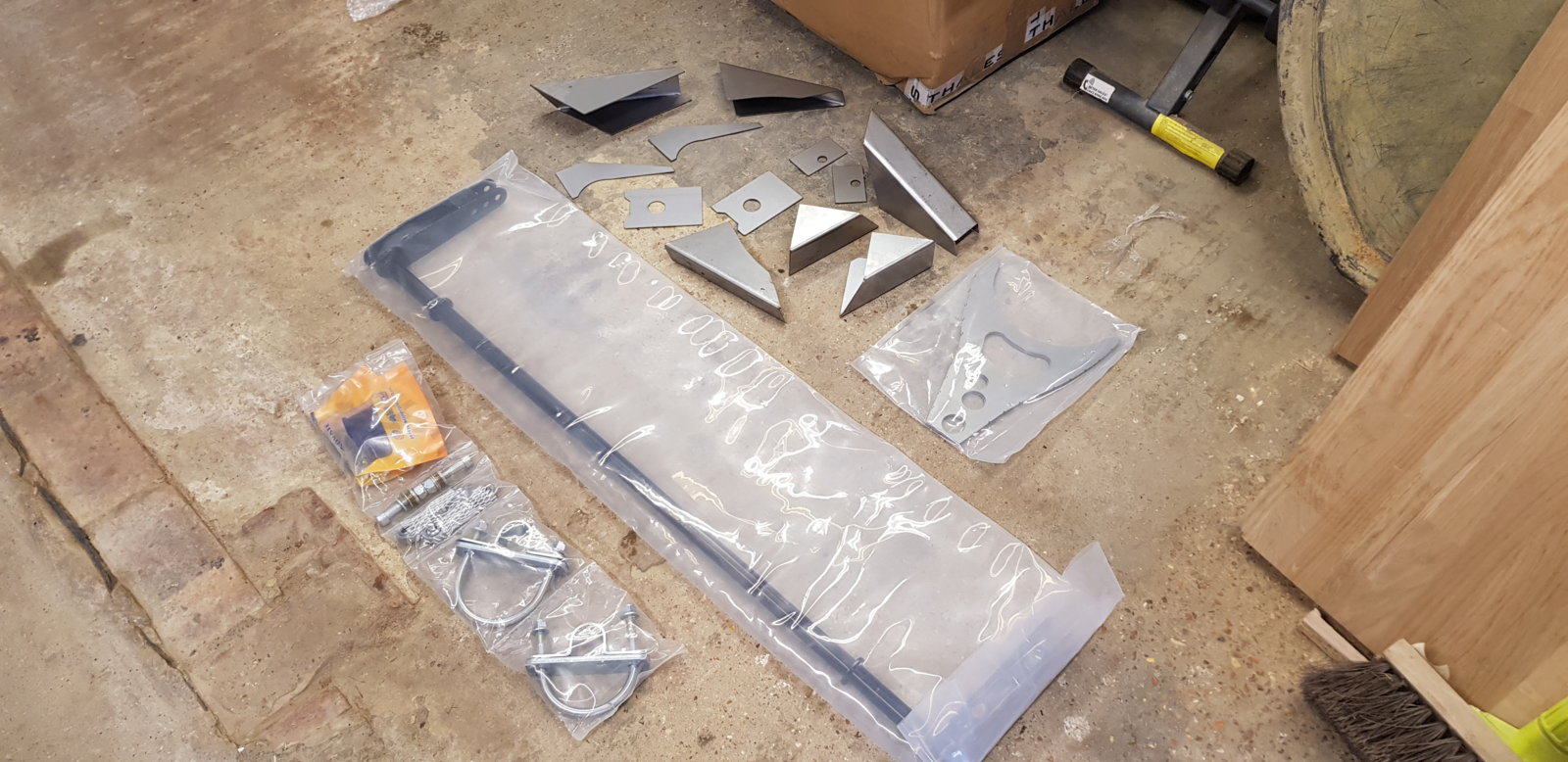

Next on my to do list was getting the rear beam ready for the PMS stiffening kit and black series polybushes. First job was getting the old bushes out. What a faff that was !!! I tried my bearing remover/press but wouldn't go over one end of the bush so I got out the blow torch 🔥 ! I also broke 3 drill pieces trying to drill it out :mad: but eventually i won.

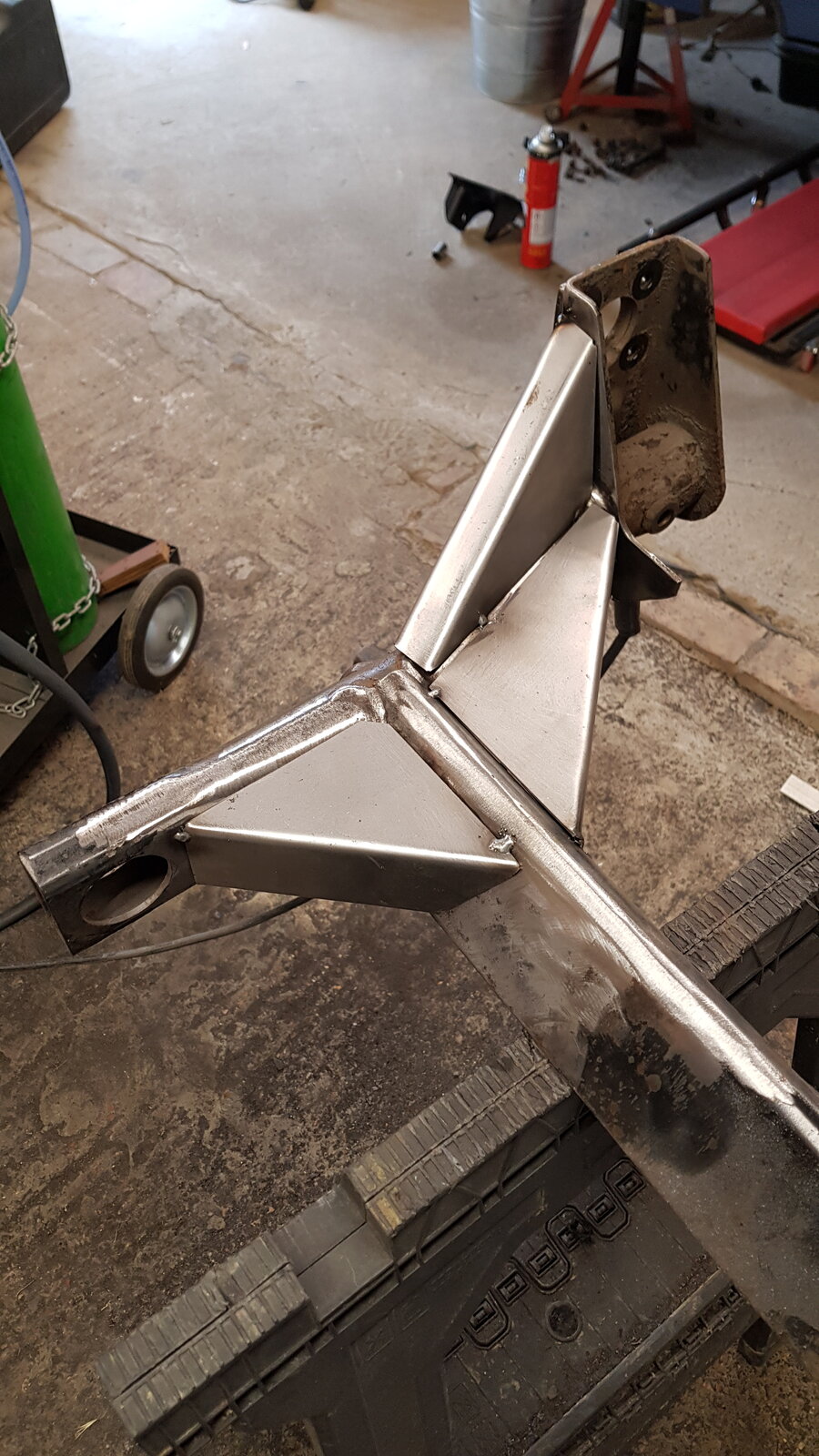

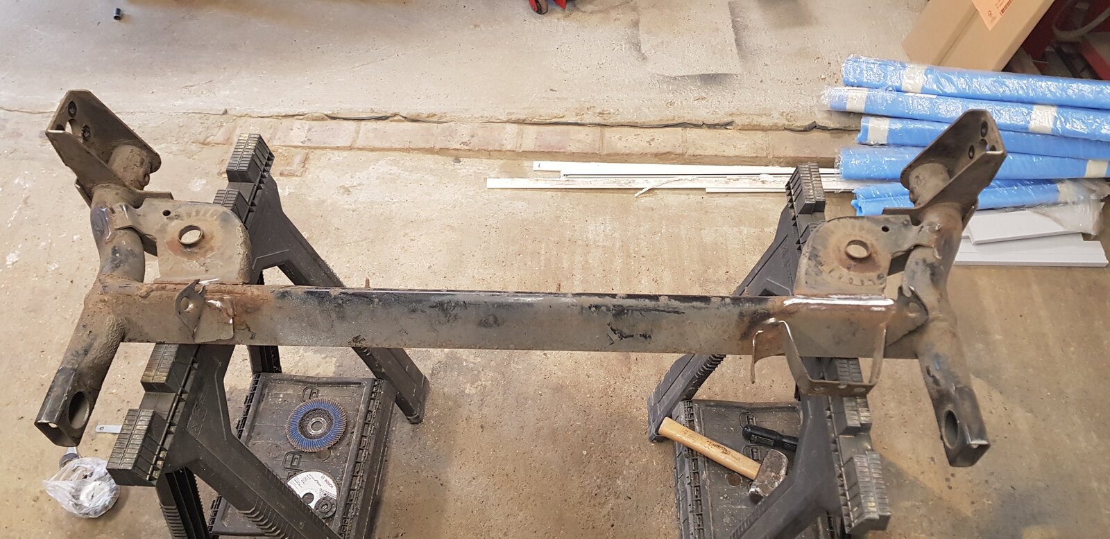

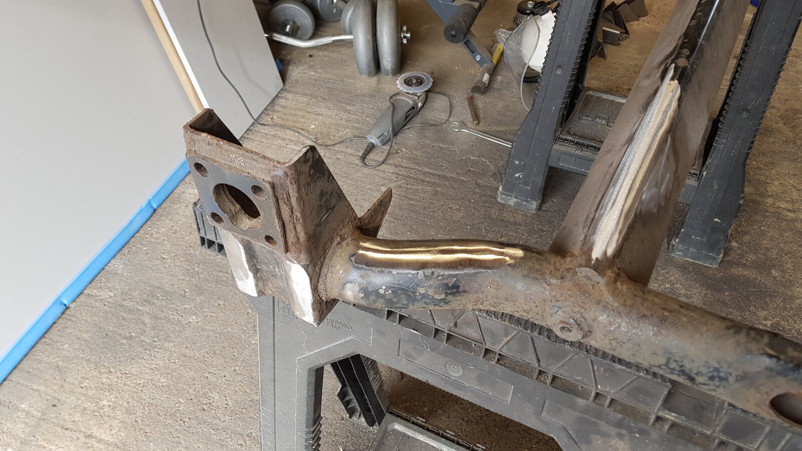

Next up was removing all the old bits of metal no longer needed from the rear beam now I've gone full coilover. I was kind of expecting this to be a bit easier than it actually was, it was quite a job in the end. I thought.... cut here, cut there, grind here and grind there but NO, there's bloody welds all over it and the spring platform wraps underneath which i didn't realize ! Eventually I got it all off, ground down the old welds and in a semi ready state for the PMS stiffening kit. There are a couple of groves i need to weld up after going a bit deep (mad) with the cutting disc 🤫
Before;
After;
And that's where I'm currently at. Once the PMS kit is on, I'll be getting it of to the sandblasters and then powder coated(y)
