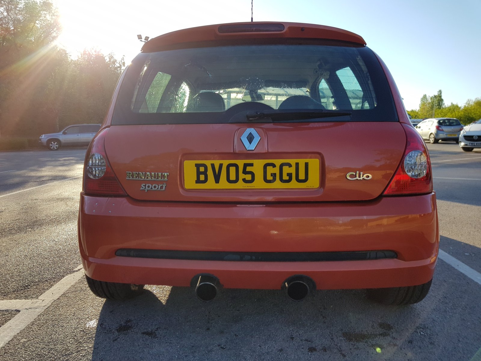

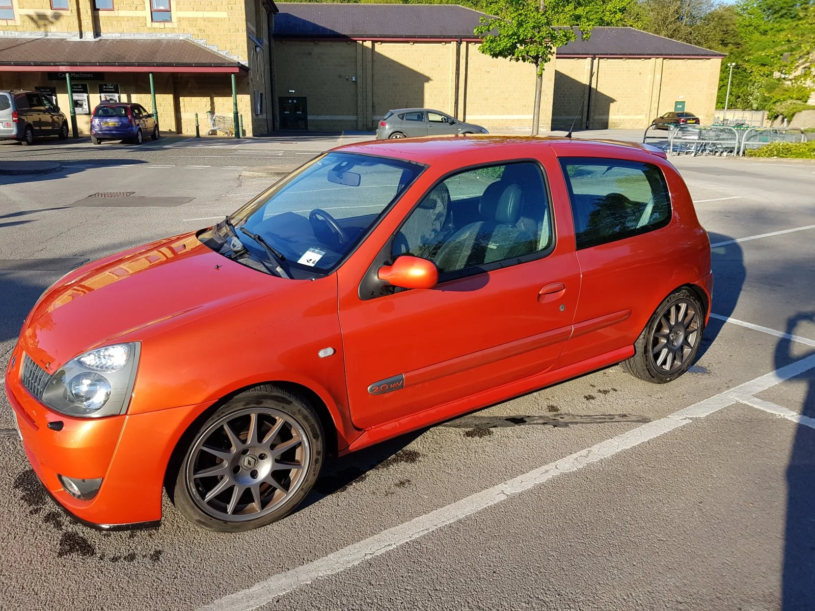

Looks like my bean got written off this aft :(
Just been and given it a quick wash and tbh it still passes the 10 foot test alright apart from the bumper damage.:LOL::ROFLMAO::unsure:. Am I being stupid swapping???
New bumper, jobs a good'un.

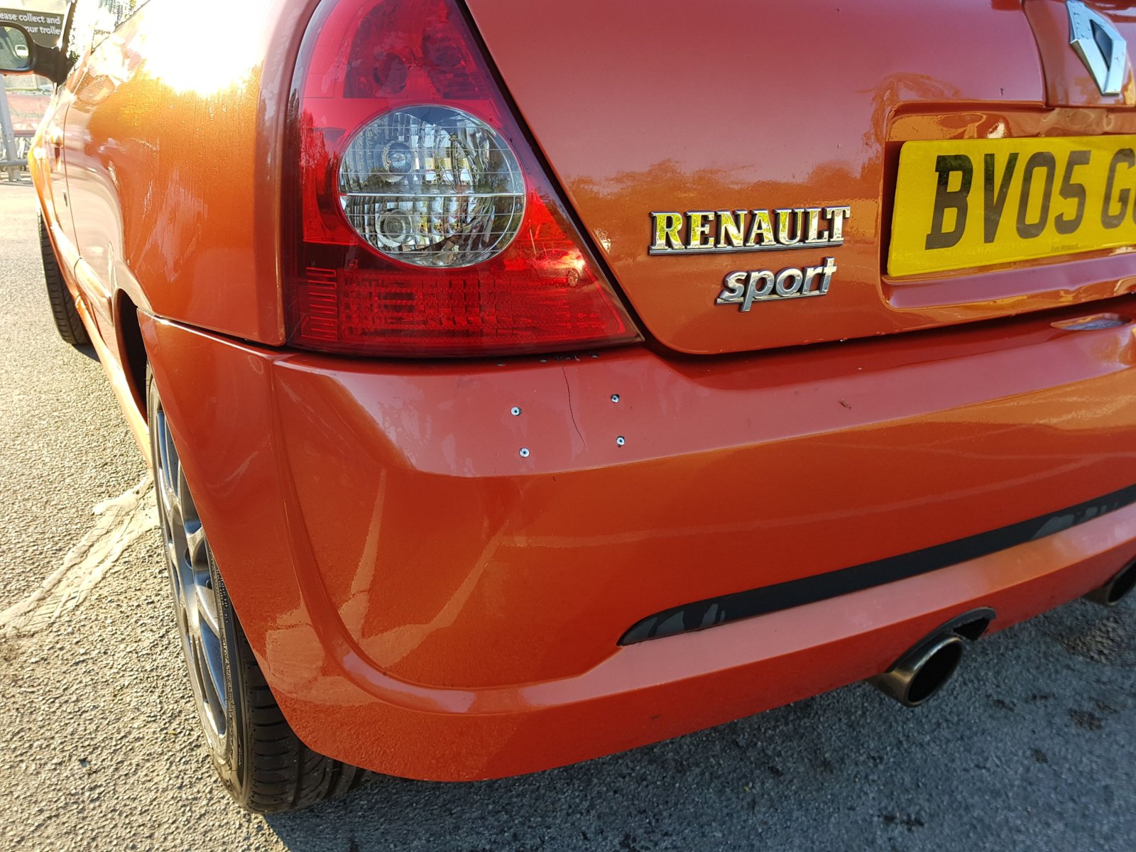

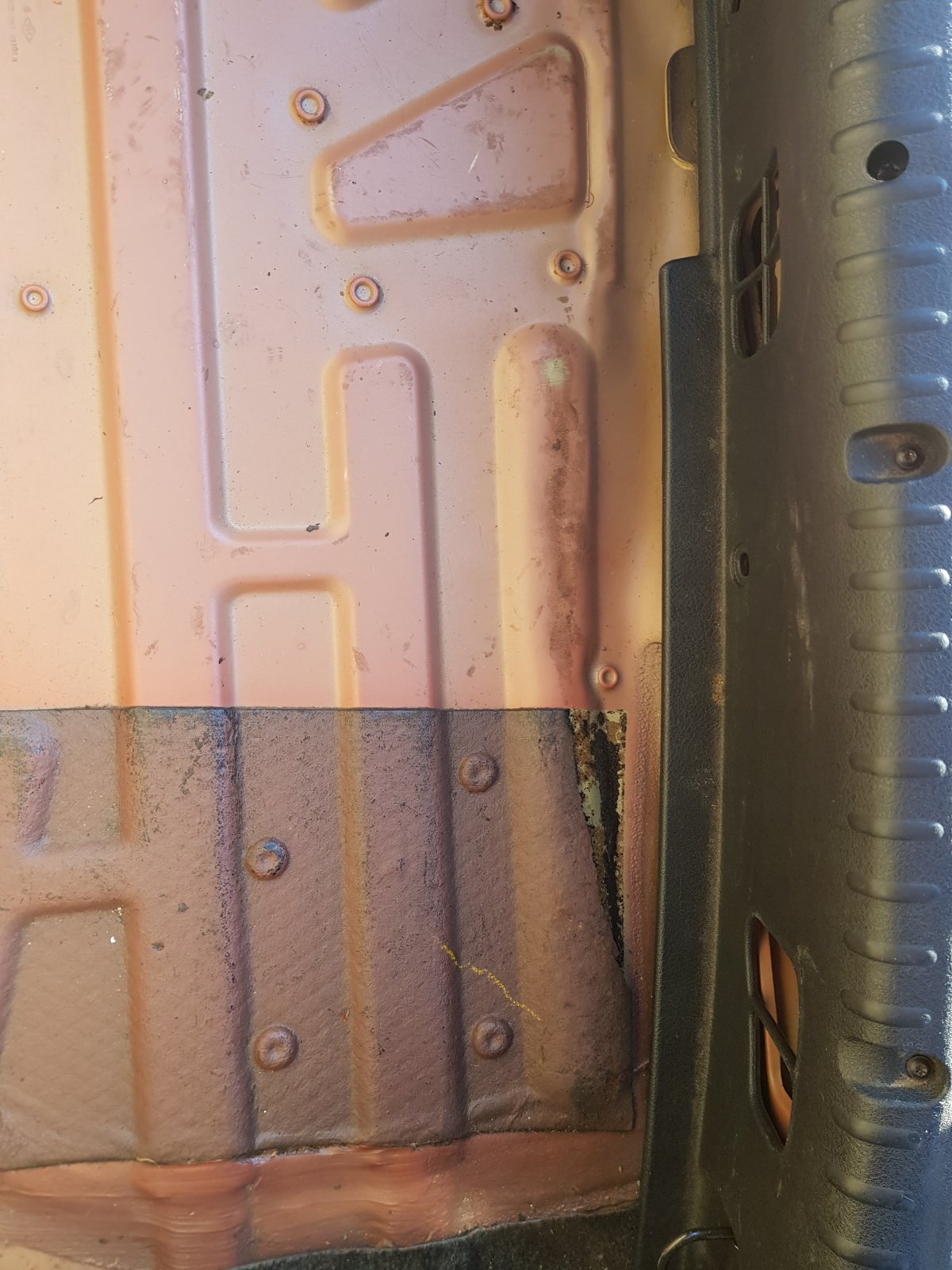

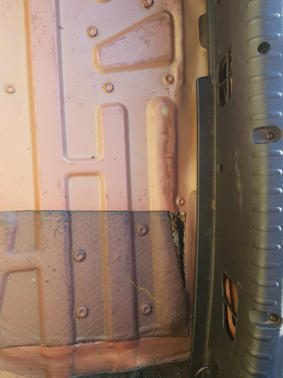

I'm a BMW senior ATA panel technician and looking at the damage to the boot floor, back panel, tailgate and bumper, this I would repair all day long.
I would buy a pattern new back panel and fit it, whilst the back panel was off i would straighten the the boot floor.
Then weld your new panel in and try to match the seam sealer as close to factory as possible then paint it.
I would find a second hand 182 bumper and second hand tailgate, prep them paint them, fit them and your done.
You wouldnt be able to tell.
