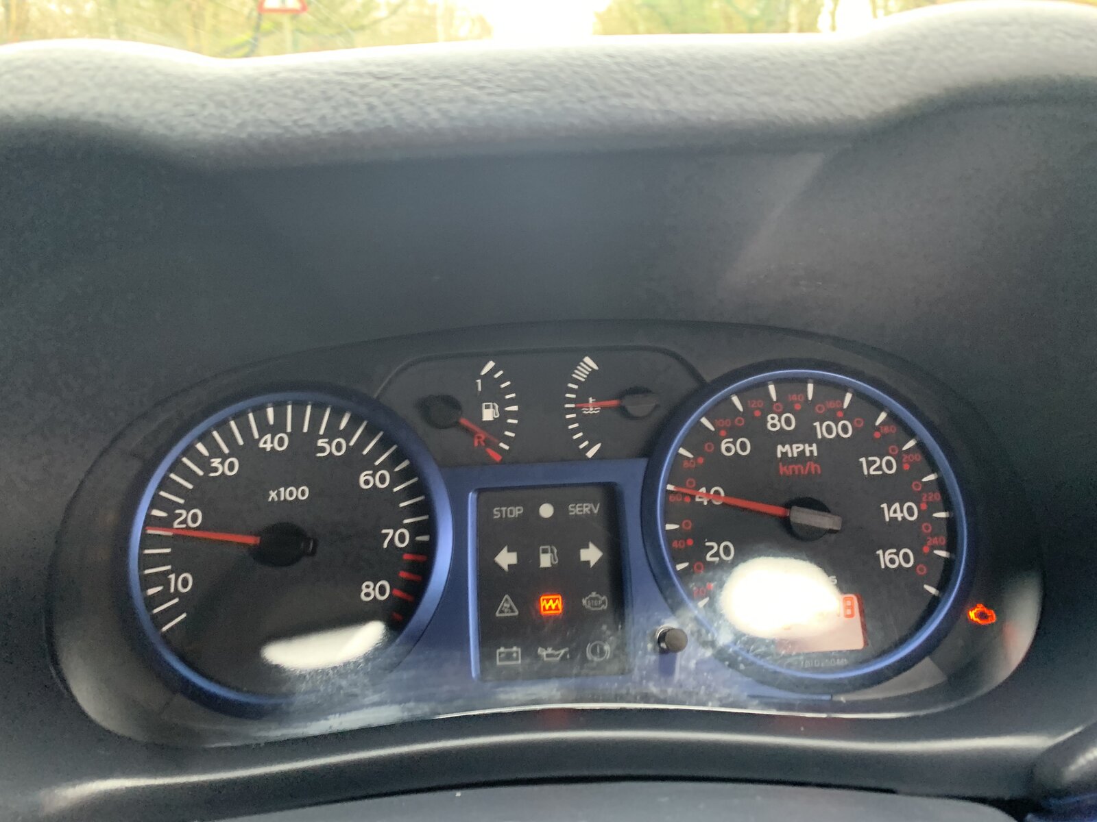

Driving home this morning and power just dropped and these lights came on dash. Not flashing but no power over 2k revs , cars at garage waiting the call of death
it cleared after turning off and reappeared on route to the garage
any ideas ?
many thanks
Mark
some light research has suggested to me it could be ignition related, I know EML comes on for Coilpack issues. Have you changed plugs, leads, coils etc recently or has it had a recent service?
  Clio 172 Cup
DF129 pedal potentiometer circuit 1 def
DF254 motorised throttle control 2 def
these are the fault codes it thrown up apparently???

Try connectors to the throttle body and coil pack are seated correctly and not corroded.
I thought it was generally a electrical issue of some sort. Have you driven it in a lot of rain recently?
Had this on a couple of 172/182 and both were throttle body issues.

The rain has been horrendous here last month or so, I was surprised at pedal issue to fault at the same time tho tbh
  Clio 172 Cup
Hi all just an update on the car got it back had the throttle body replaced and new wires from pedal to ecu car is back to full health and has a thorough check and everything else is spot on. I am considering put this up for sale despite the massive amount of money I have put into it and getting something more sensible 😢
