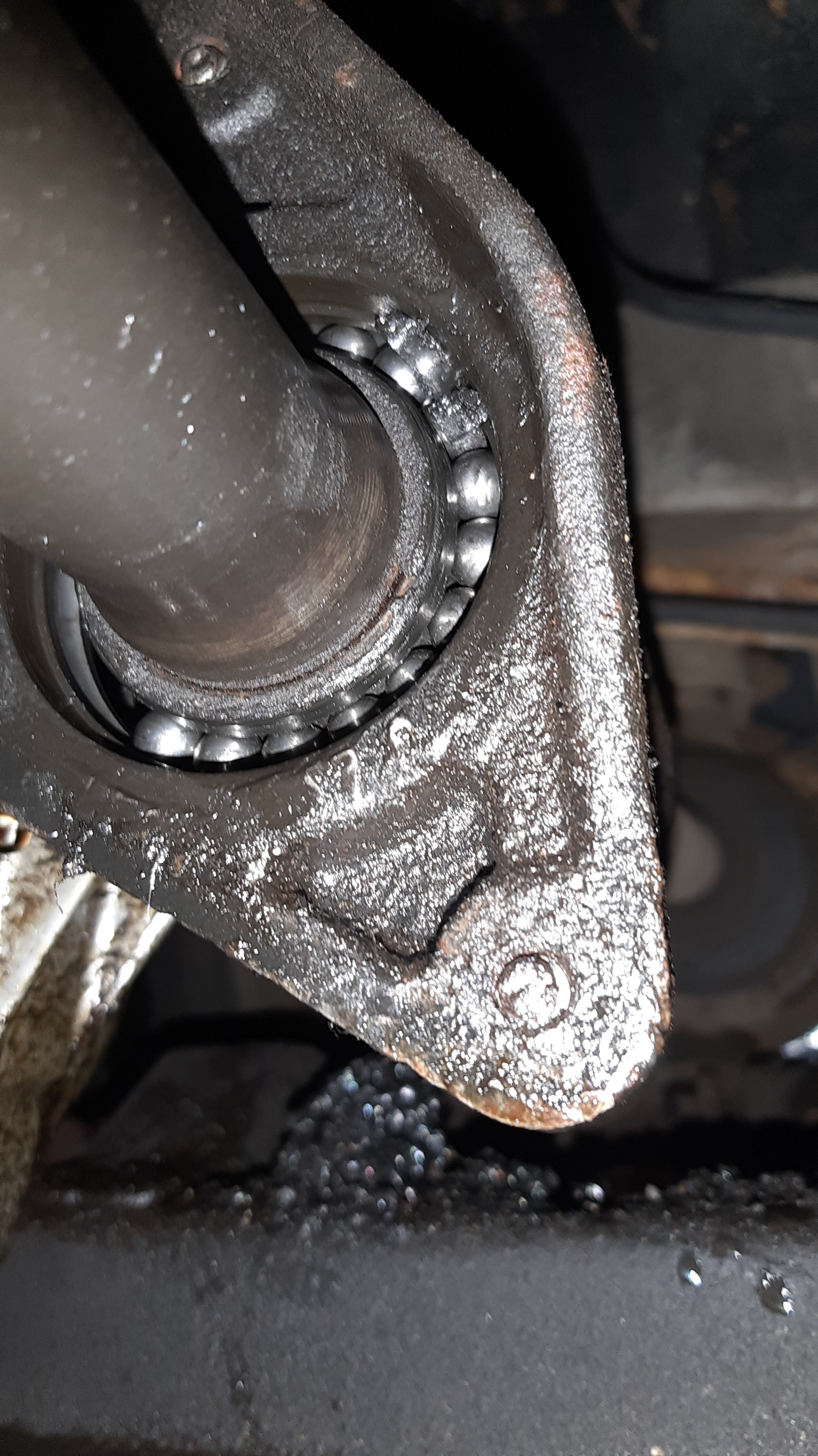

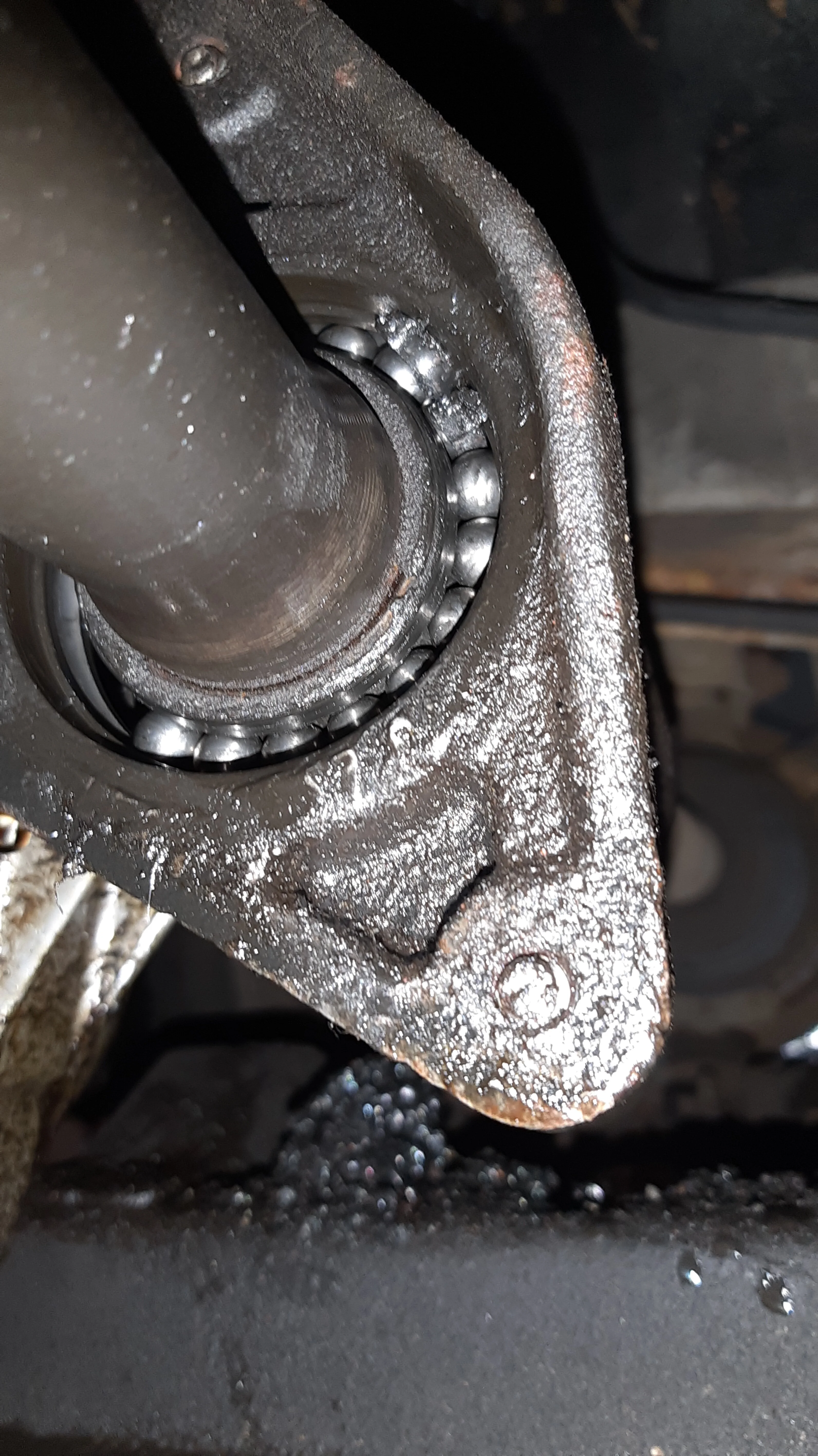

It would appear this drive shaft bearing is ruined. This'll be the source then.
Is it replaceable or a new shaft?

Yeah the bearings are replaceable.
I'm sure they're the same as the Megane 225/R26/175. Message MND Motorsport on Facebook, Matt is usually cheapest and best on delivery of the bearings
The bearing is the centre support on the shaft, without it it would just flop around surely

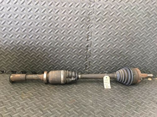

PH2 Shaft below with bearing

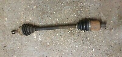

172 CUP/PH1 shaft below which doesnt need the bearing
I'm intrigued to know how the f**k your shaft didnt put a hole in the block without the bearing 😂
