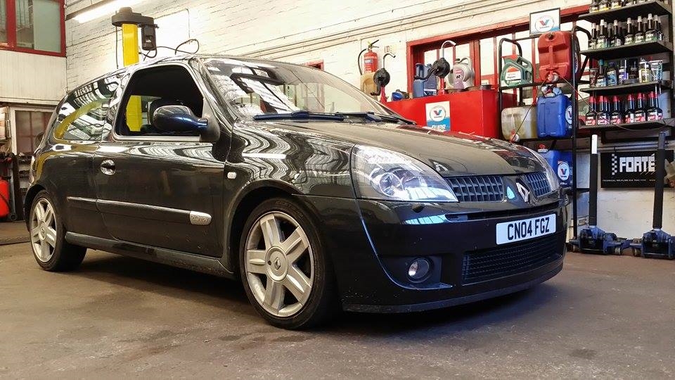

LeeRS
35mm on the back 30mm on the front.
16s and no scrubbing. That's with cooksport springs.
EFA. This was just after fitting so is lower now as they settled in.
  2003 Clio 172
I lowered the suspension last night and immediately experienced the same thing.
I get these aren't really for a slammed ride but I personally found the drop quite moderate, a finger between fender and tyre, but it would still catch on the liners.
How do they do it? I'm thinking of those with R comps and a much lower ride height. Removed arch liners altogether?
