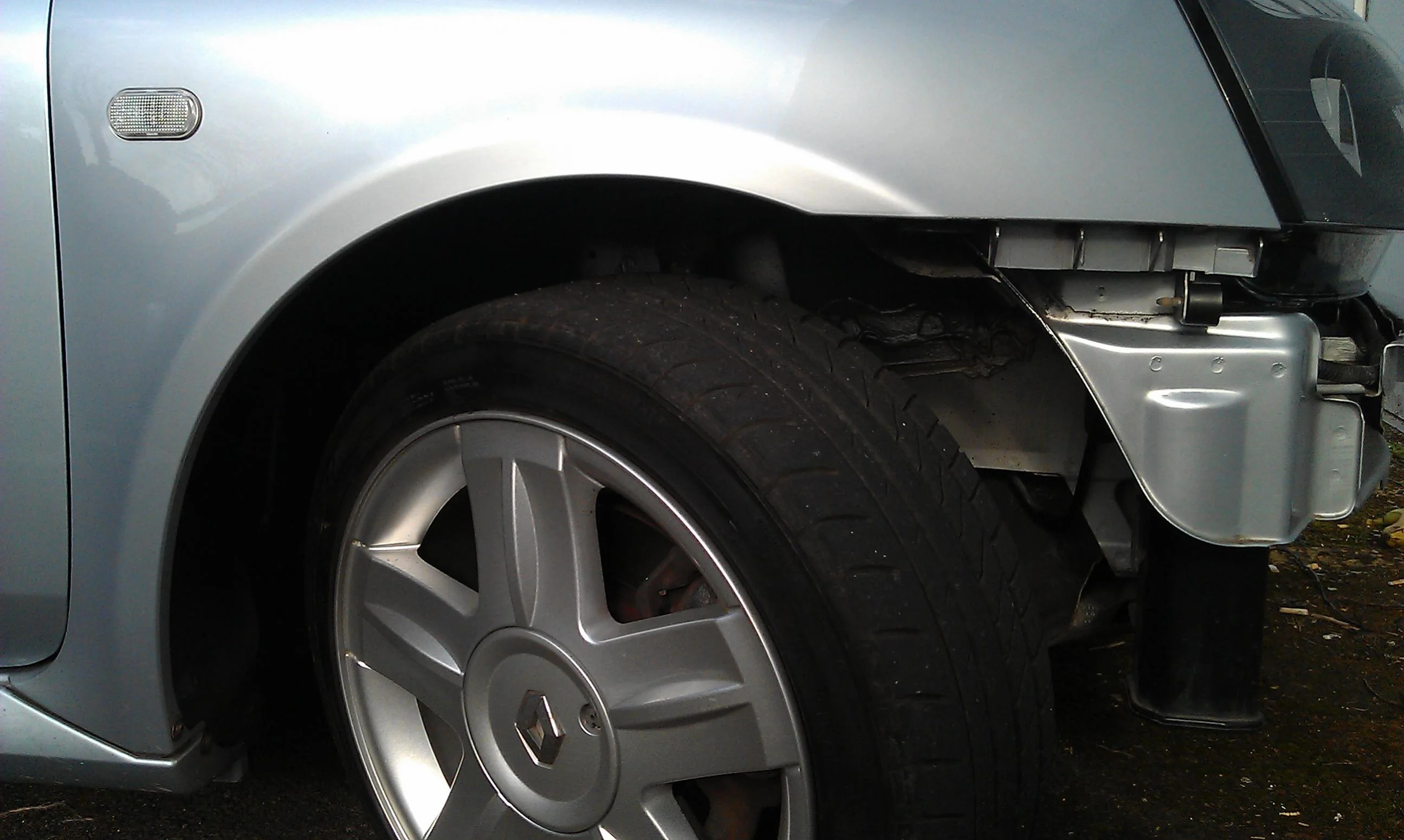

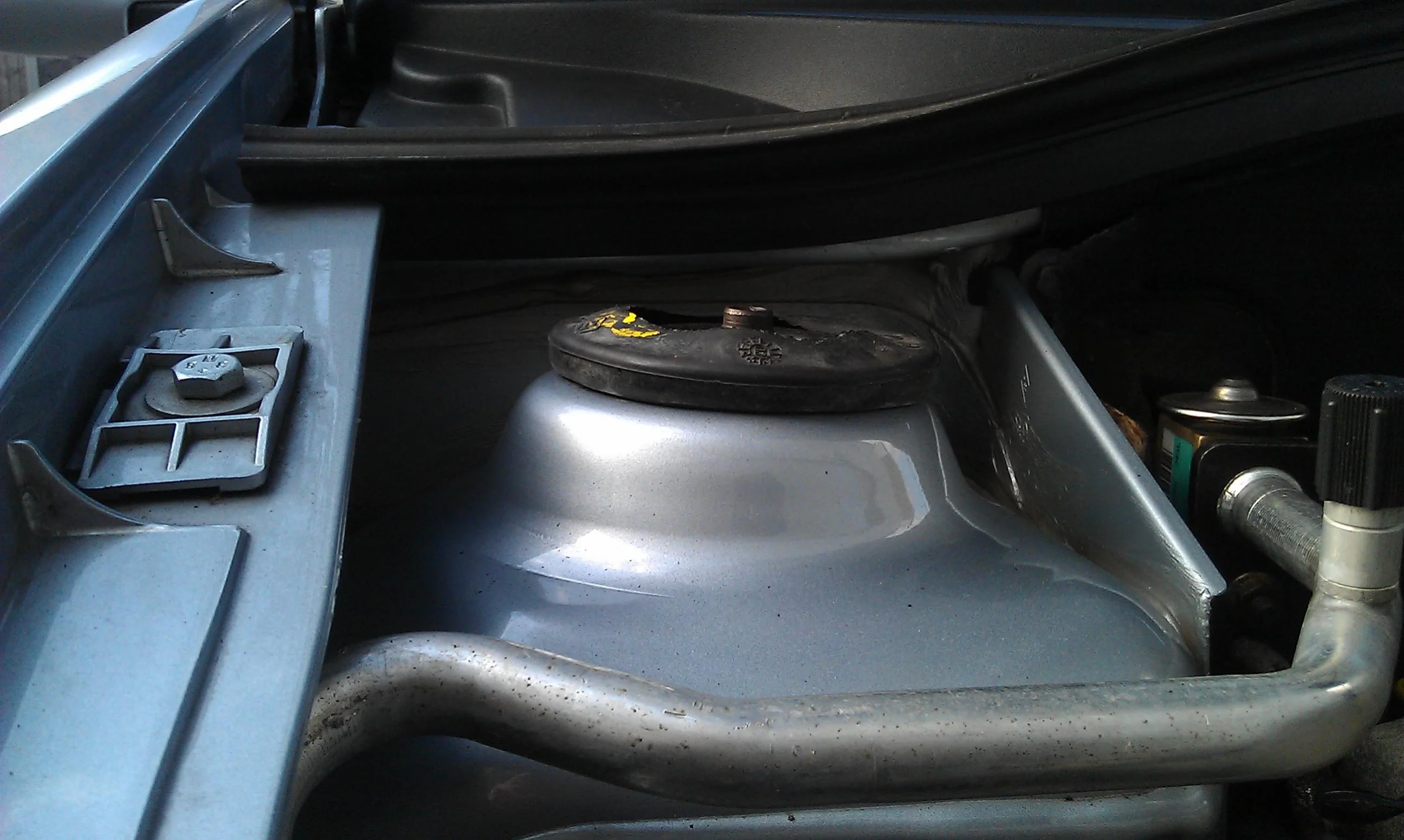

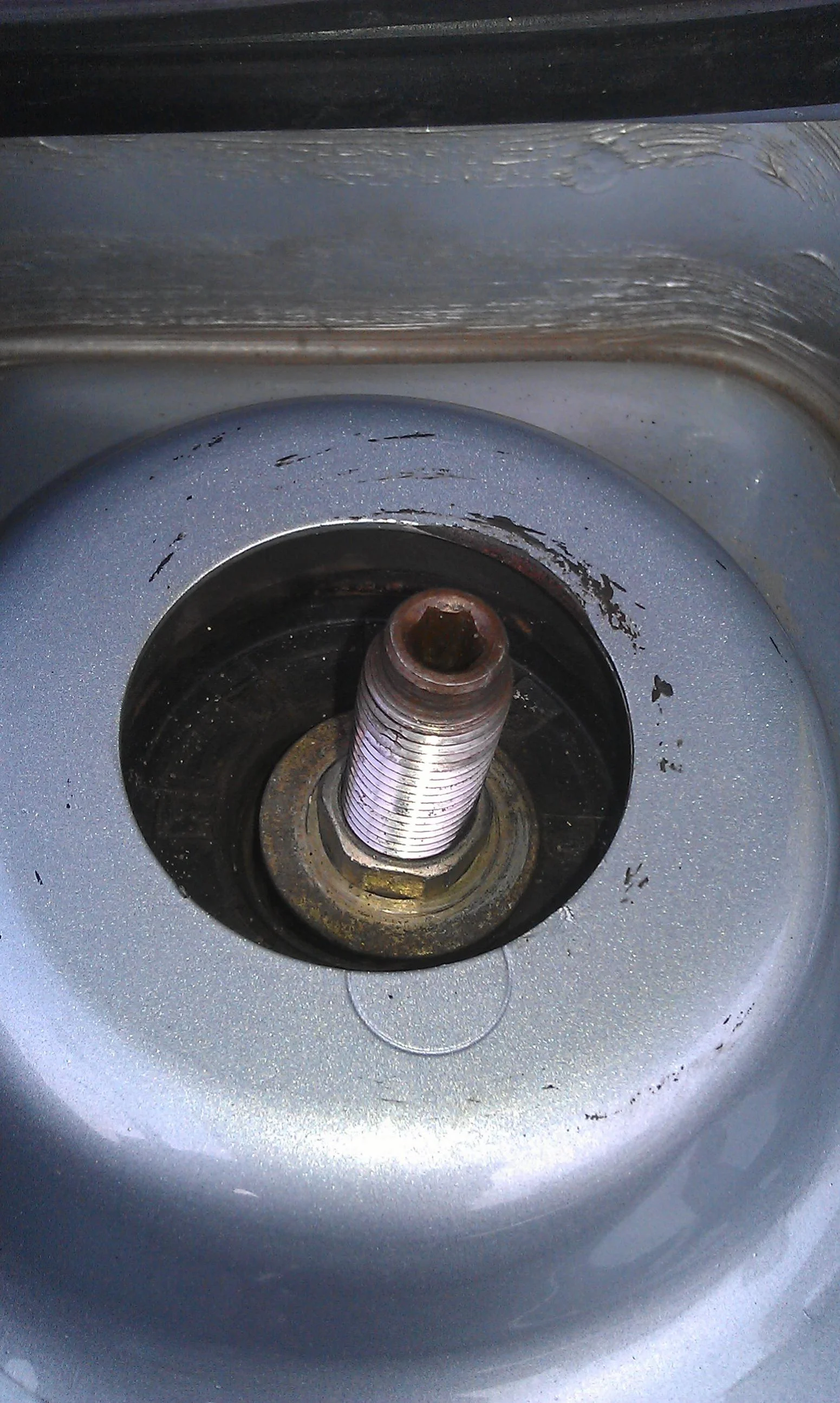

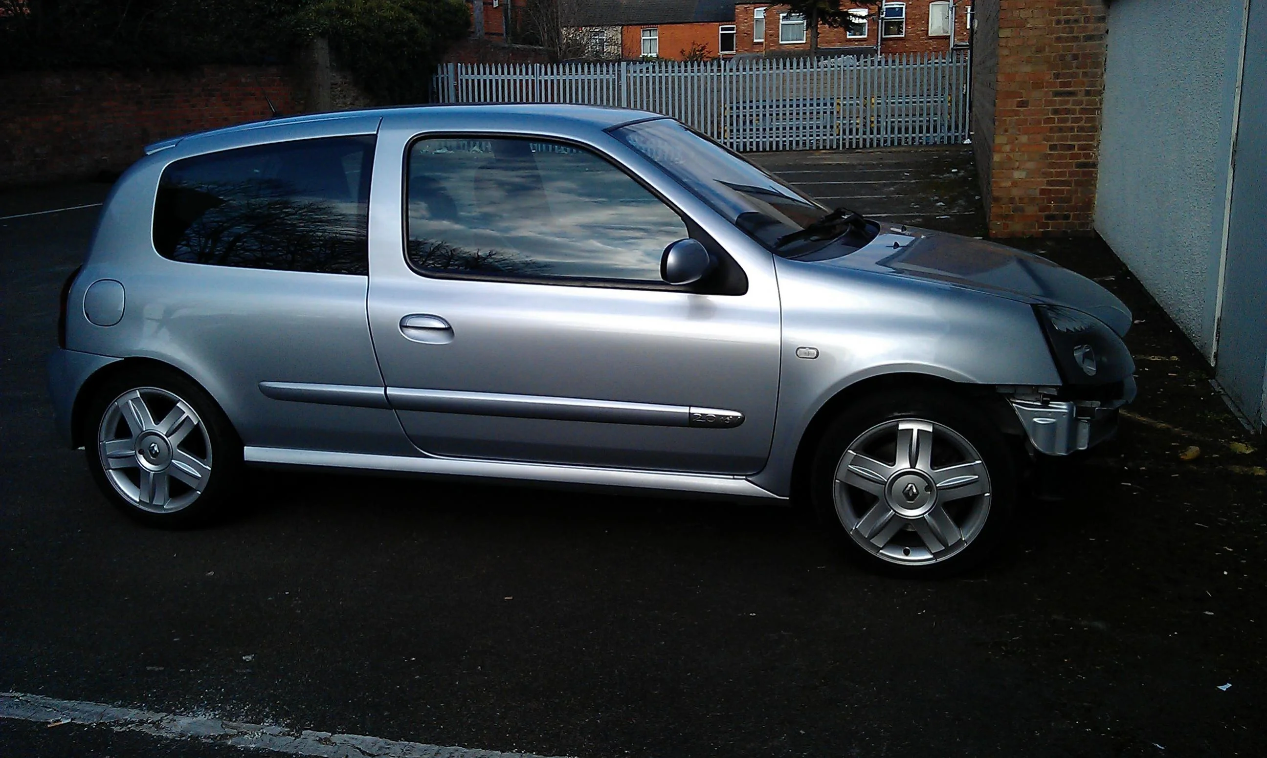

Here are some pics. These photos are from yesterday so sorry I hadn't fitted the newly painted bumper yet!
How can I tell if the rubber donuts have been put on the right way without taking the struts off again?
Nothing shouts out as wrong from your pics. Although is that first photo of your last post with the car on the ground?
The top mount should stick higher up than that if so, maybe the rubber but inside the arch isn't sitting properly..
Maybe take the shocks out again, and double check the assembly of the top hat, bearing etc. Get some pics of that.
You might have the bearing upside down as another possibility..
