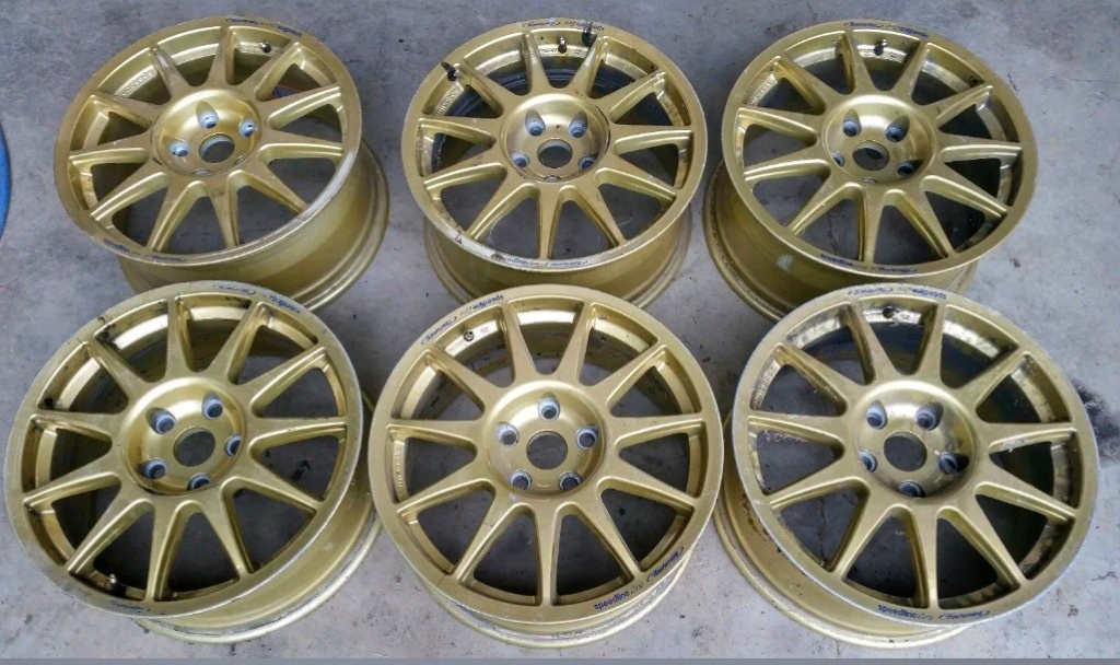

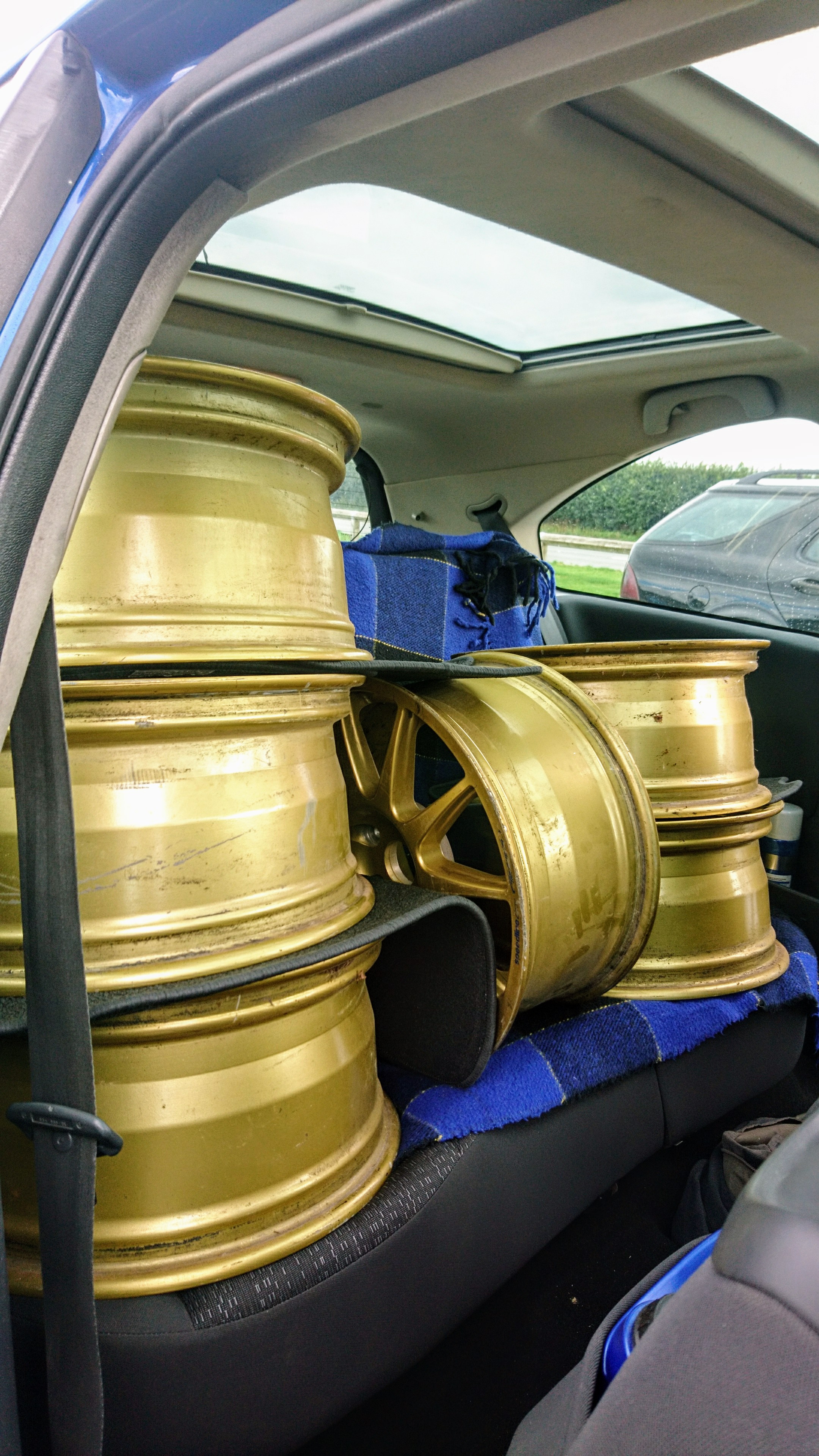

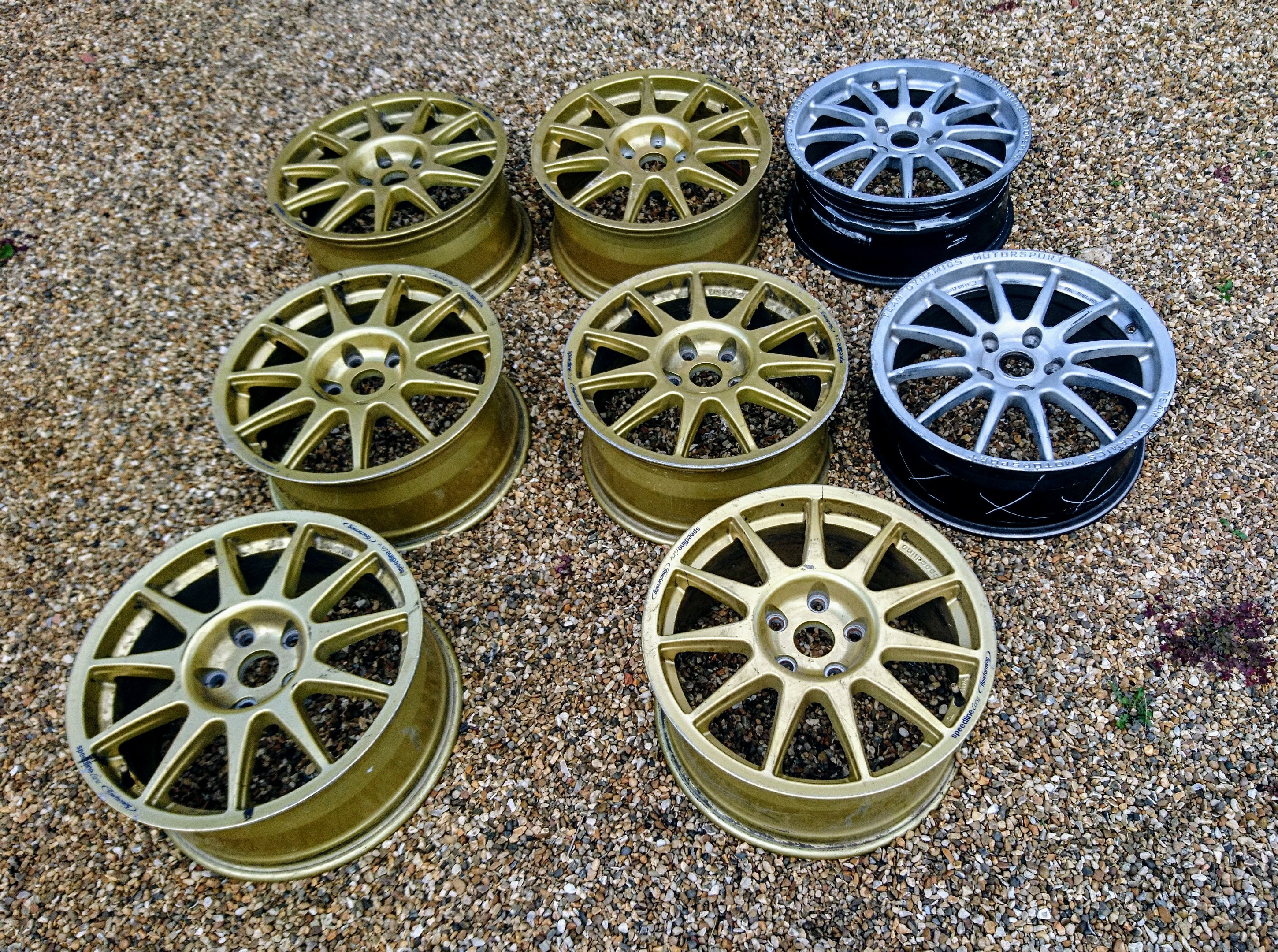

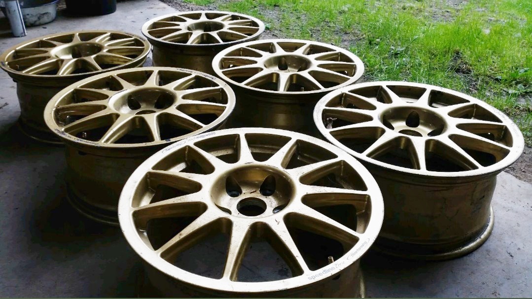

I should stop browsing Ebay really, I'm a sucker for wheels. 9pm last night these came up on my radar in the 5x114.3 search. By 10pm I'd agreed to buy them and pick them up.
So after 385 miles and 7 hours driving to Shrewsbury and back this morning these are wheel
option 2 for the EDC. They're off a Subaru so I have to machine the centrebores 10mm bigger, the ET is gonna be soo tight. I think the wheels will sit virtually flush to the arches but I won't know until I've had the centre machined out so I can offer them up.... But I'm quietly confident they'll work... I'll get them to work.
I'm looking to paint them white.

I do like the TD's in silver. A timeless looking wheel. Same with the Speedlines tbf.

The Speedlines are edging it for me at the moment, I like the fact the spokes go right to the edge of the rim and they're fairly flat. Unlike the TDs that roll down towards the rim and also do it more rolling towards the bolts at the centre.

You could safely have 3mm machined off the face to reduce the ET.
Thats good to know if I need it, more so on the back as the fronts have more tolerance in the arches.
OE wheel 7.5Jx18 ET55
Speedline 8Jx17 ET49
TD Pro Race 7Jx17 ET40
The TDs do work, my number crunching on the Speedlines suggest they'll stick out another 6-8mm than the TDs... Which is just in tolerance to the arch... So in theory that 3mm skim could help which I'll have done on 2 of them.

I think the Turinis will suit your EDC better over the TD's. The sharper spokes will compliment the angles on the body better.
I do like the TDs but as soon as I offered up the Turinis next to them they just looked bigger as the spokes run right to the edge. Fingers crossed

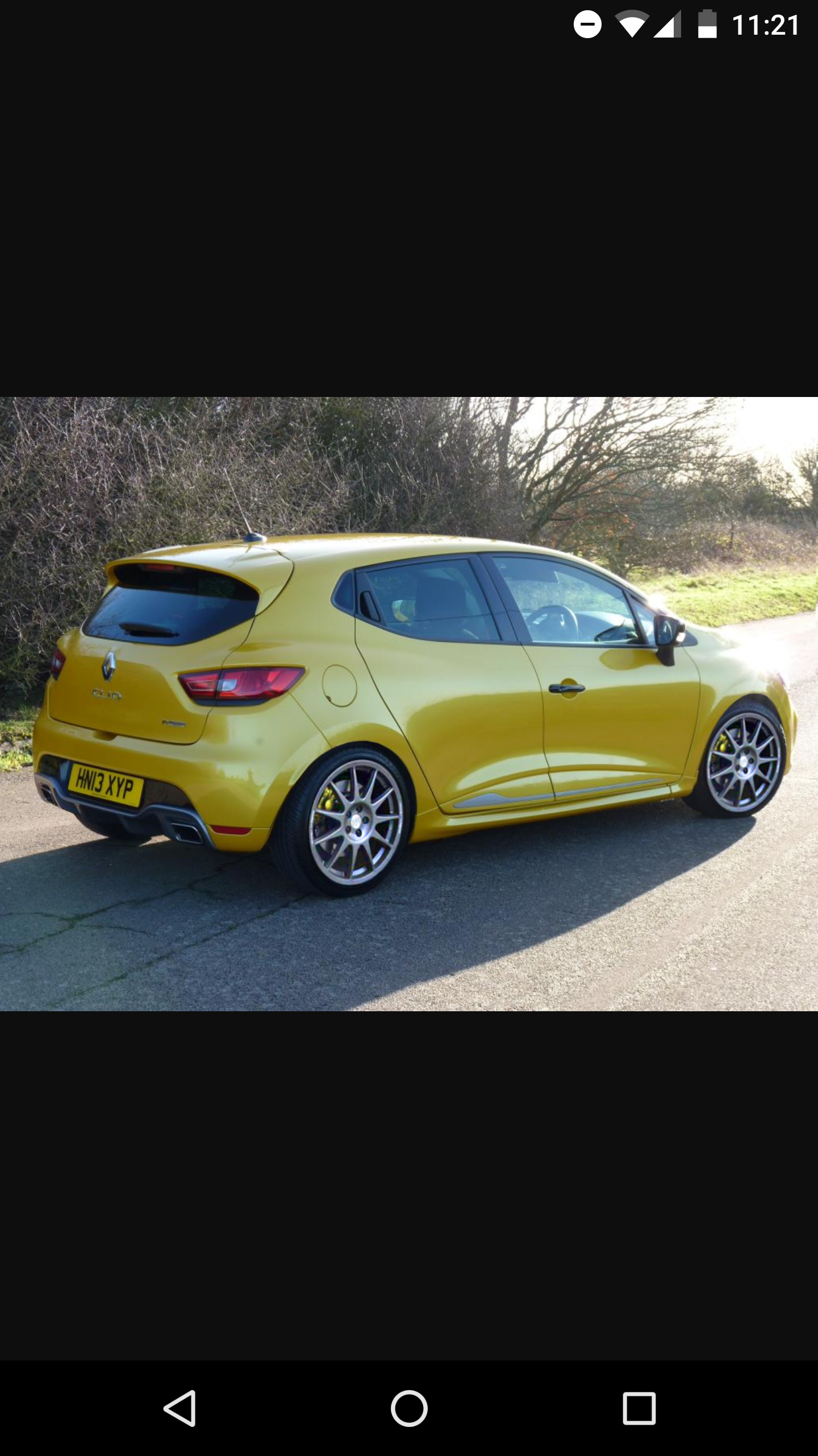

I'm thinking outside the box Ian, I want to try something different. No one's really changed wheels on the EDC apart from Tom Cazneaux with the HLTs, I fancy a change in appearance and think the Turinis will do that.

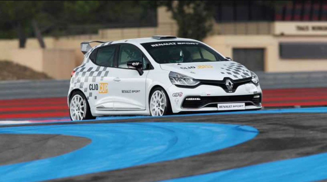

Me too! Itching to trial fit them so I'm calling the engineering company tomorrow to get them in hopefully for Tuesday. I think white will make the difference, I think they need to be that opposed to black or anthracite otherwise I feel they'll be 'just' another wheel.... But not whacky in colour.

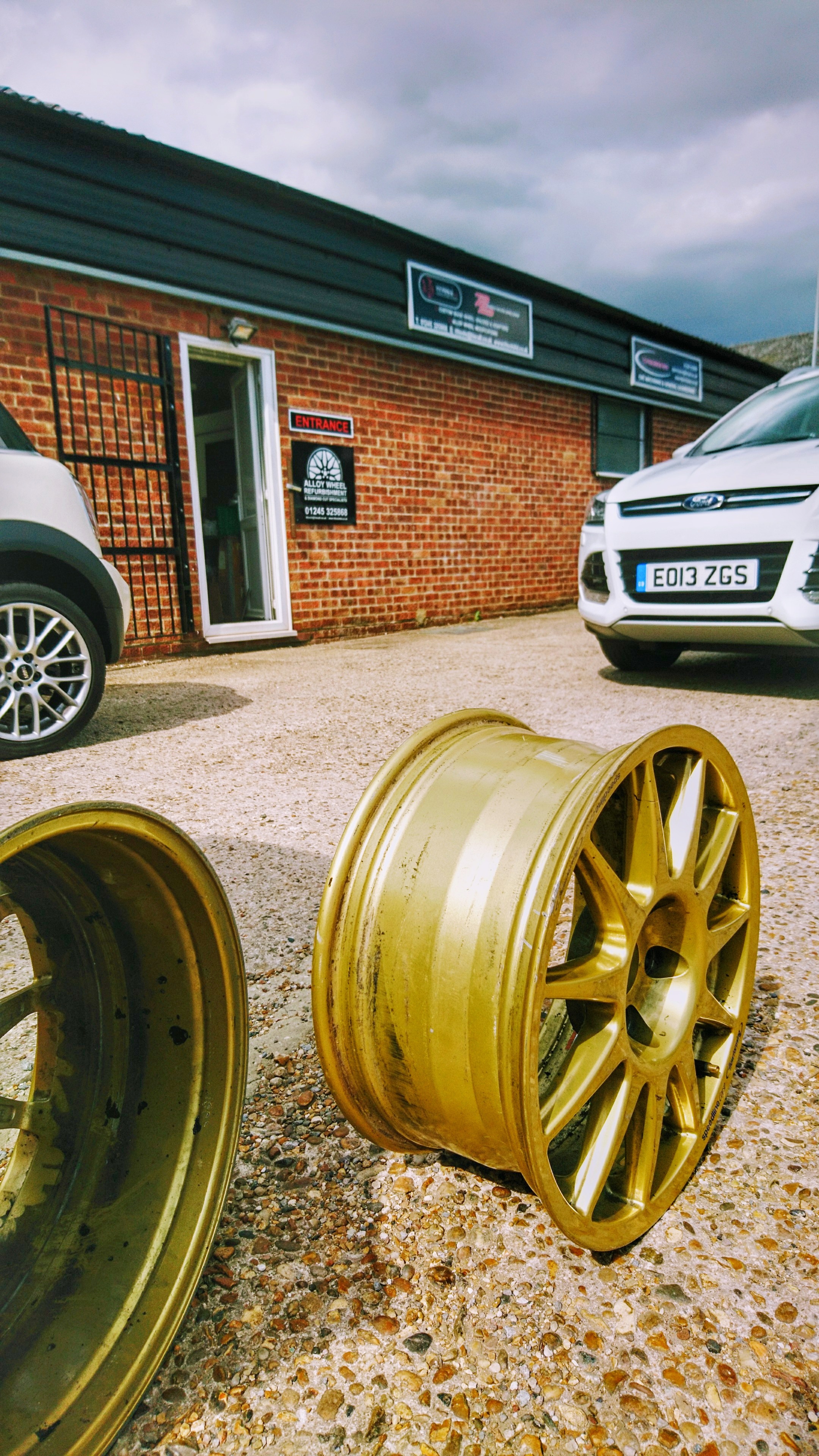

Just booked the wheels to go in tomorrow after work, £25 each to have the centrebores machined out. Its a next day pick up so hopefully Thursday latest

Dropped a pair off at the wheel place after work today and will be ready for the same time Tomorrow. If I wasn't so busy tomorrow evening I would have trial fitted them, so Thursday it is.
