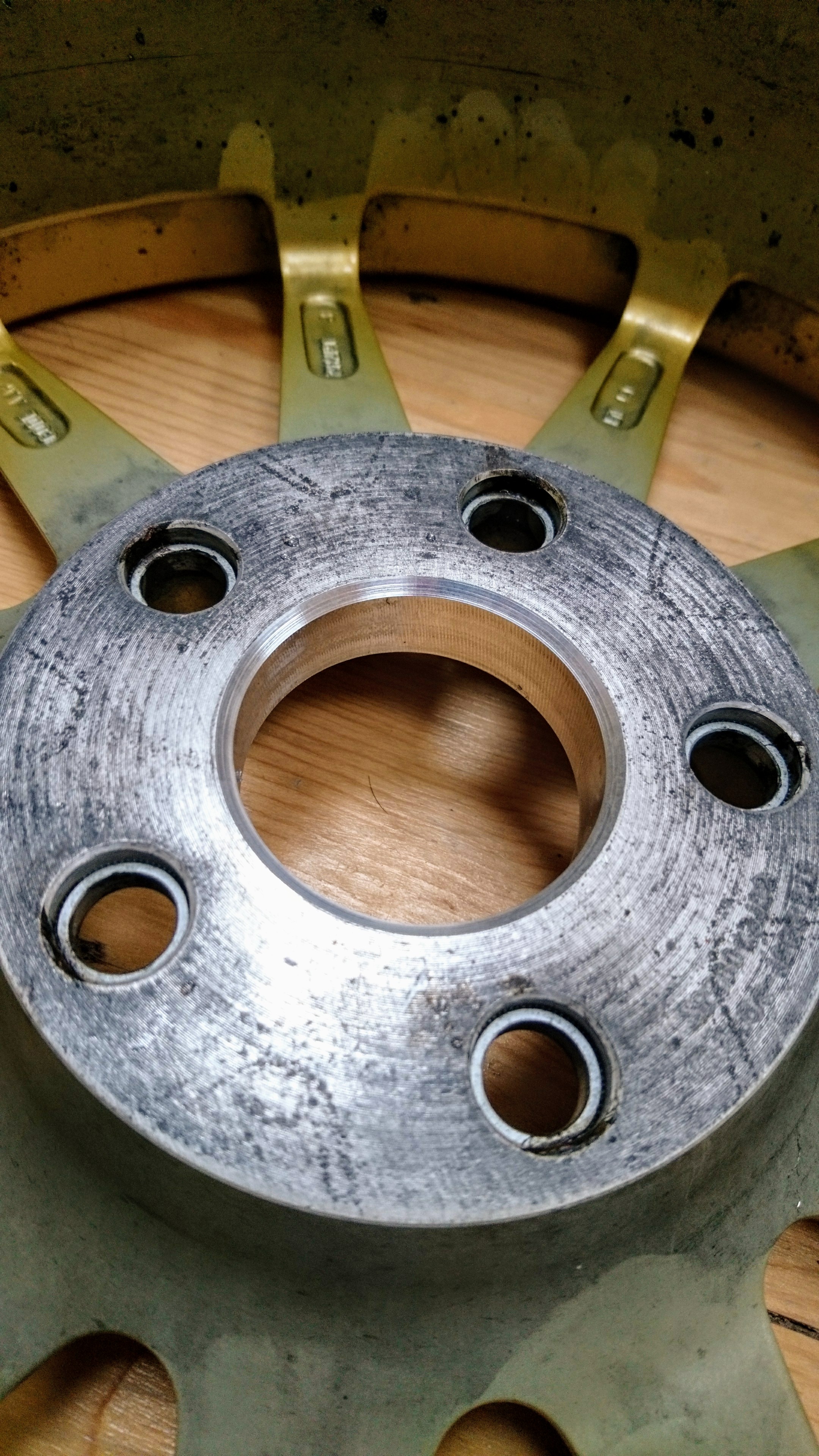

lol I'm lost. Do you refurb wheels or are you a machinist?
Neither, for some reason the engineering shop have that sign on the wall. I'm paying a company to machine the centres for me. I've DIY painted a few wheels over the wheels and I'll paint these ones too, only if they work out on the Clio otherwise I'll just sell them on

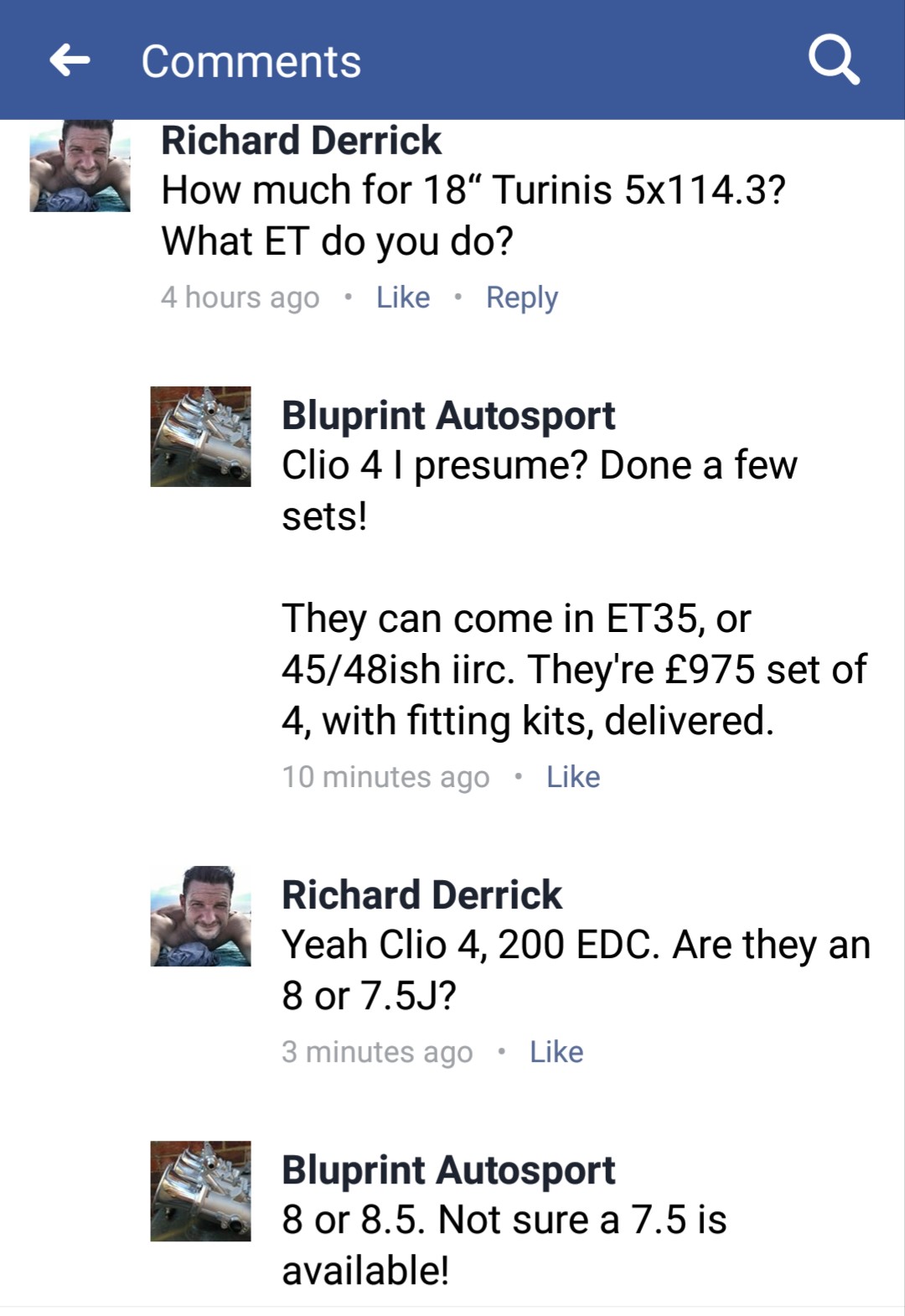

Appreciate that Chris, so in a round about way it seems the 8J works with the offset by asking a company on FB who are selling Turinis in 18".Trouble is I'm tempted to go up to 18s now! So my 8J with ET49 could work on paper..... Fingers are crossed still

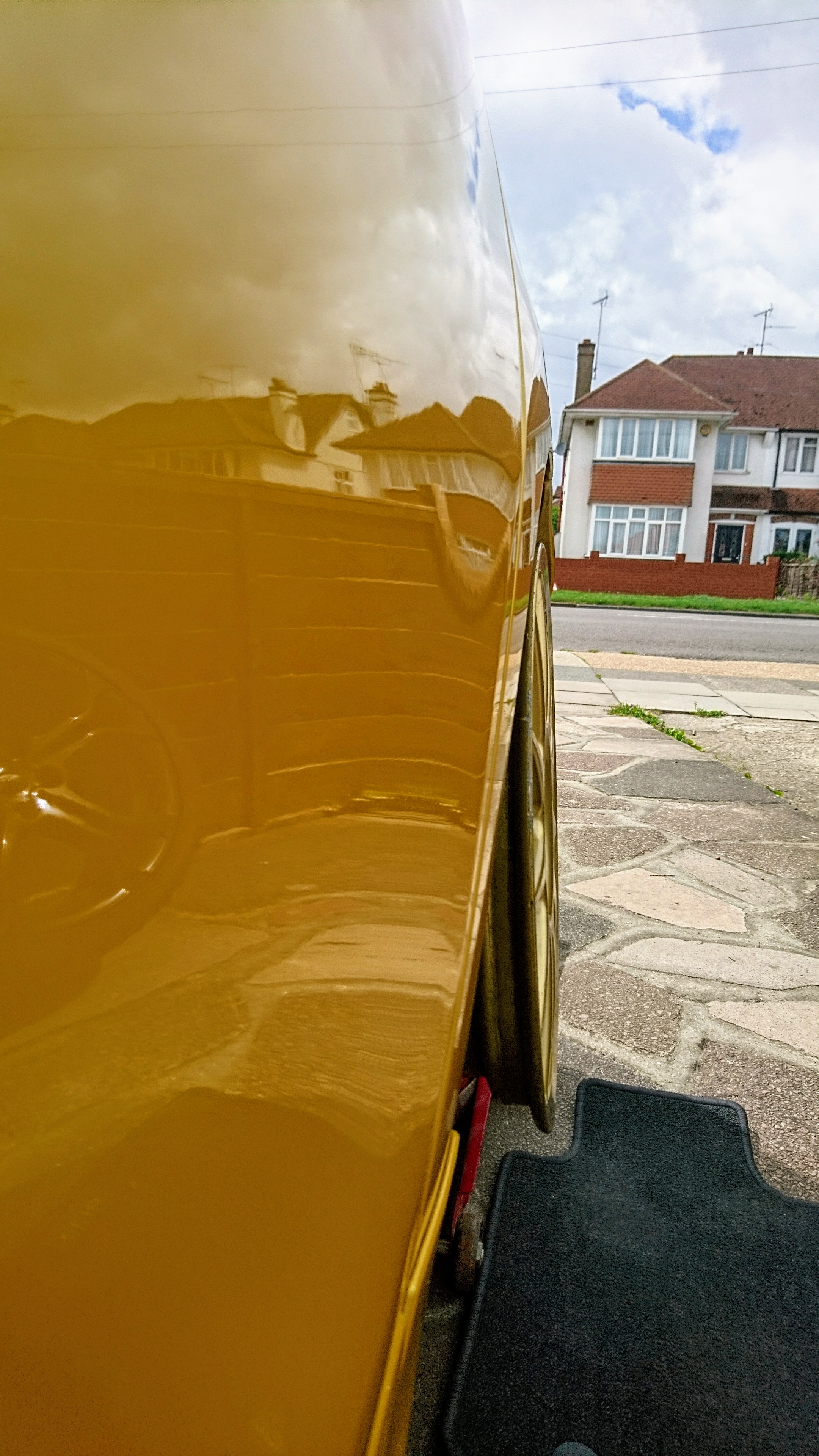

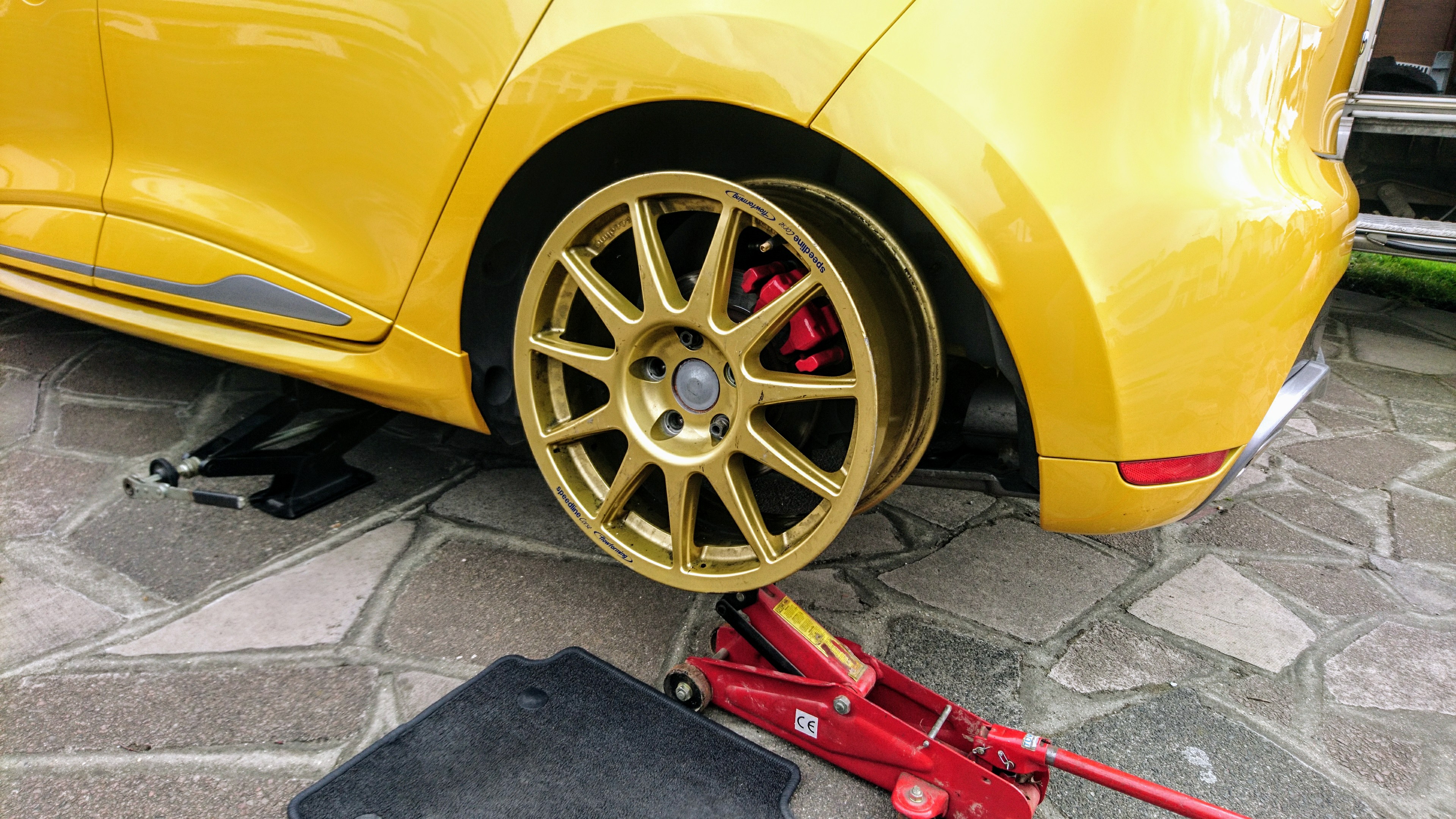

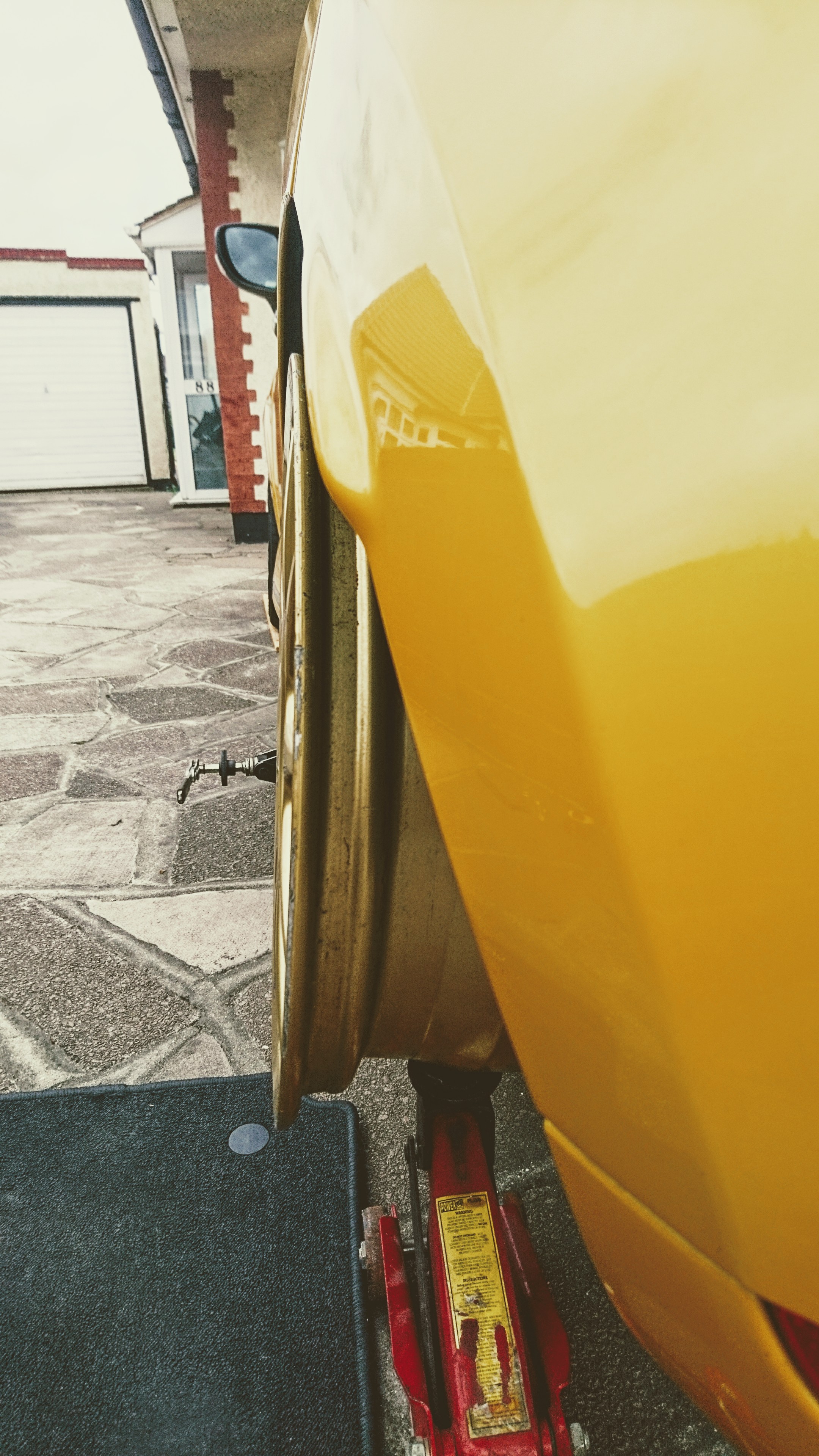

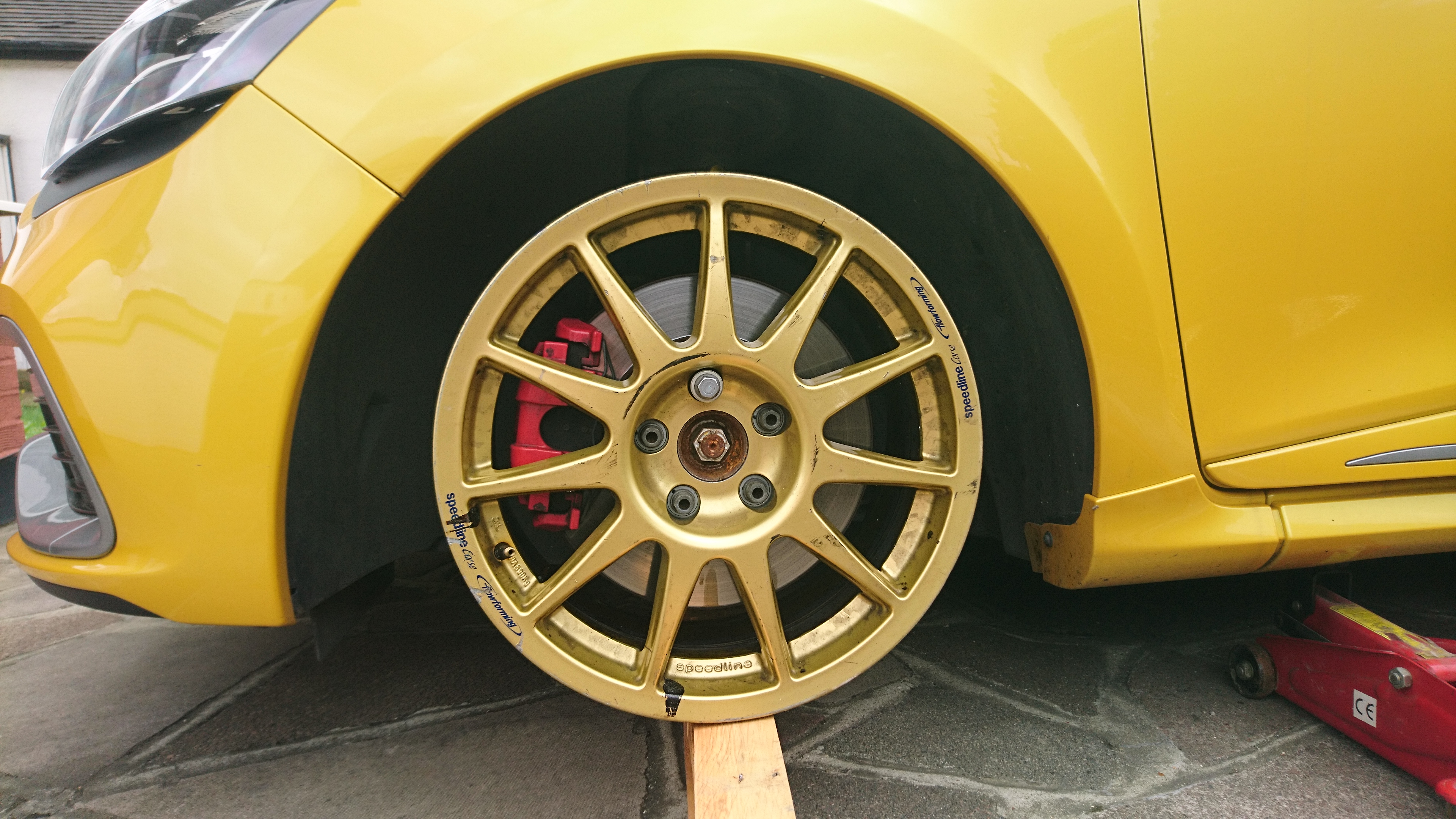

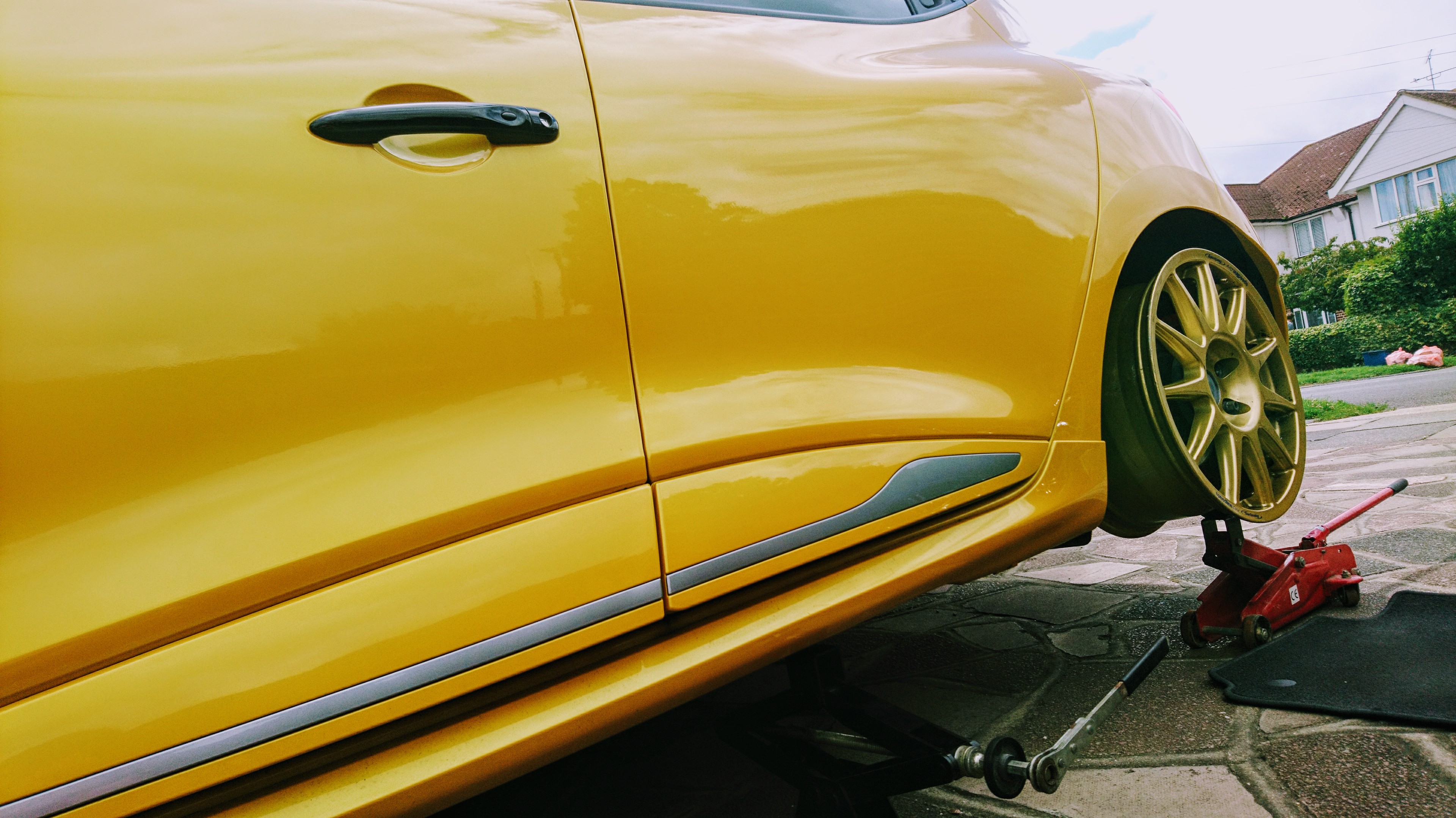

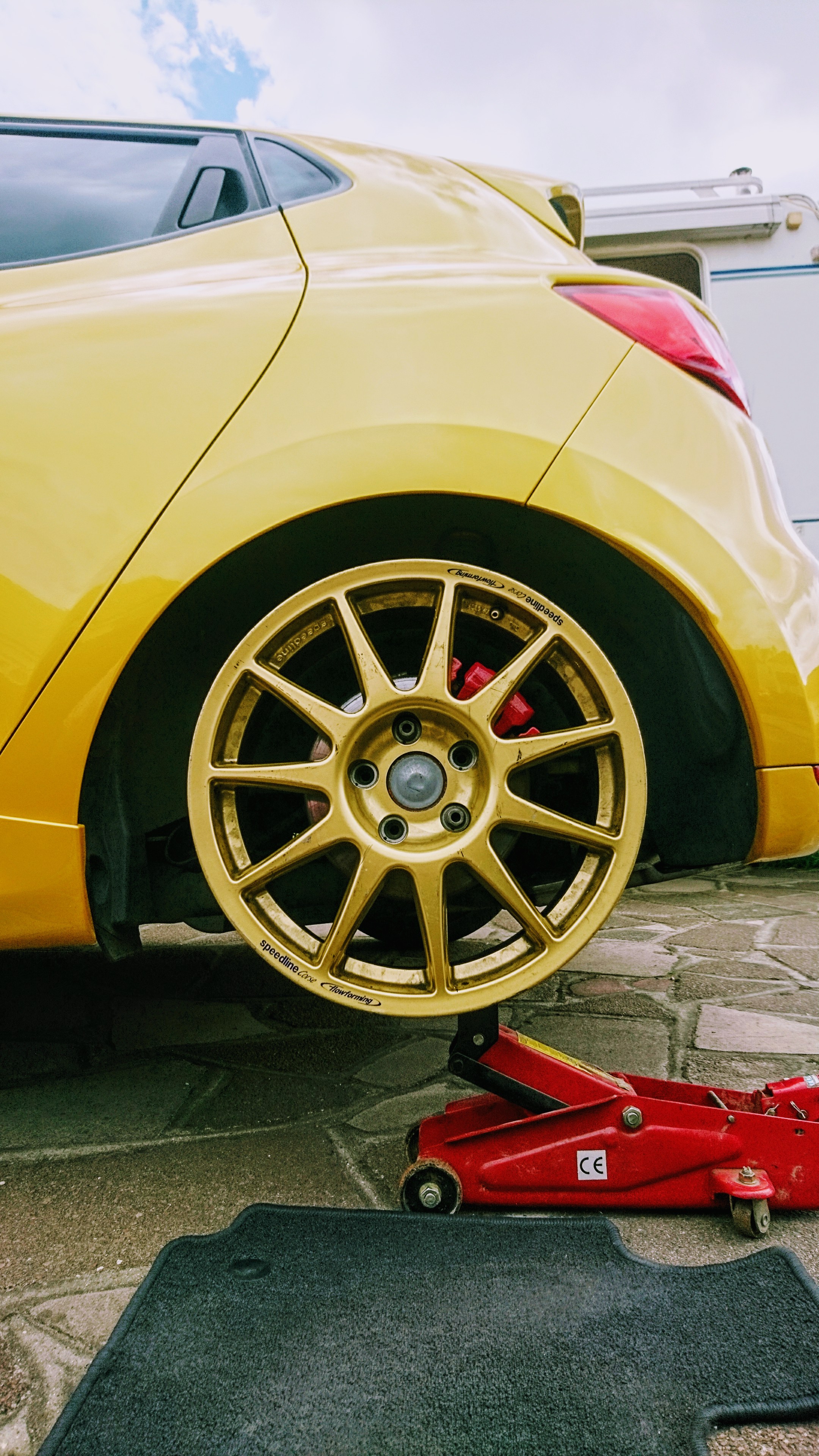

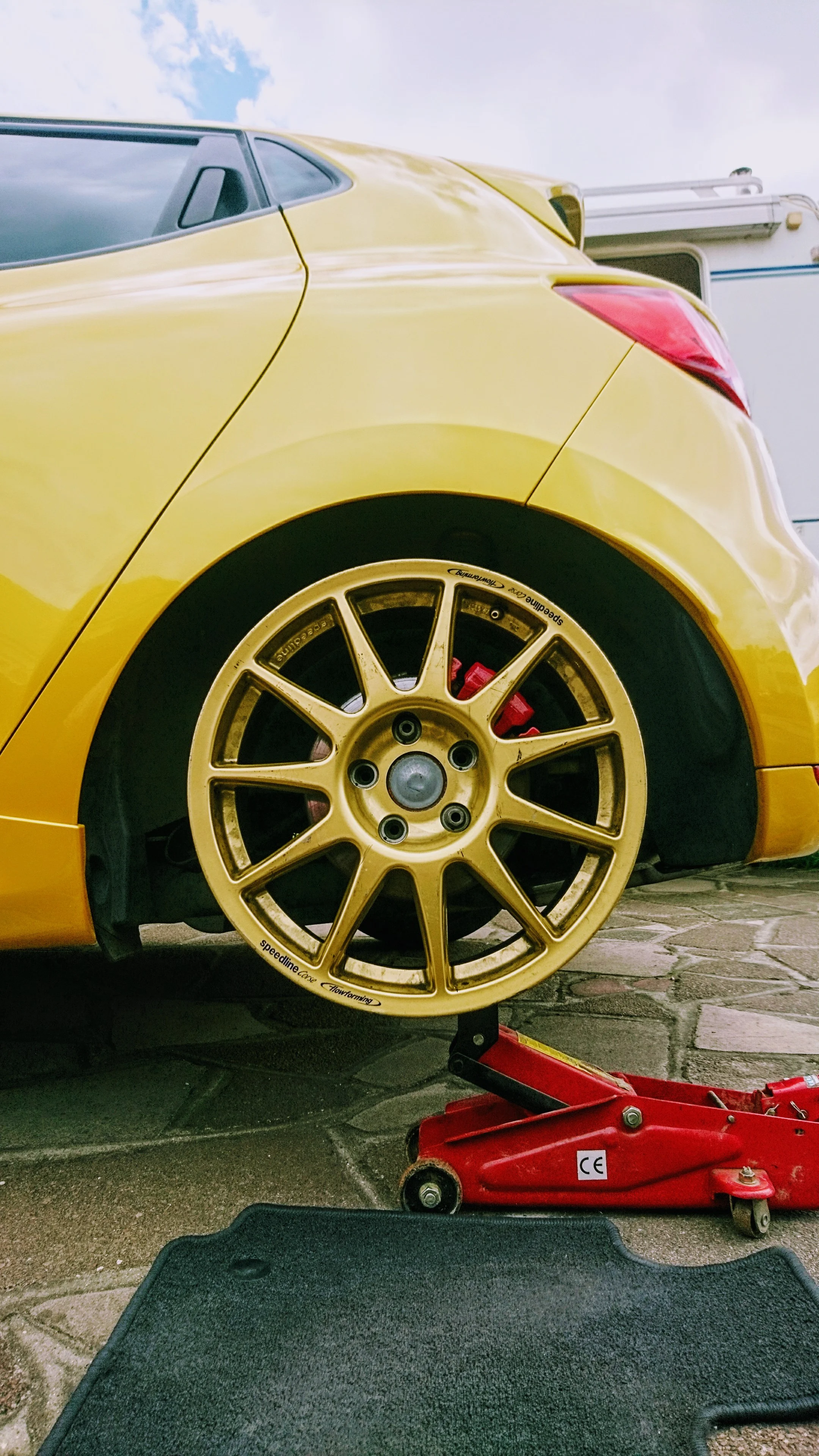

Excuse my French, but f**k me they're close!! But work! So there's a 45mm gap between the rear strut and the inner part of the wheel. Up front there's a 13mm gap between the strut and the wheel, the 8J brings the rim closer to the strut so there's absolutely no tolerance for them to go in any further, thank god they don't need to!
The back has always been more critical than the front so I started with that first, it literally sits inside the arch, literally! To be fair it's borderline. Up front I'm more concerned about the gap between the strut as the wheel sits in the arch a bit more so I'm happy with that, the fronts will work.

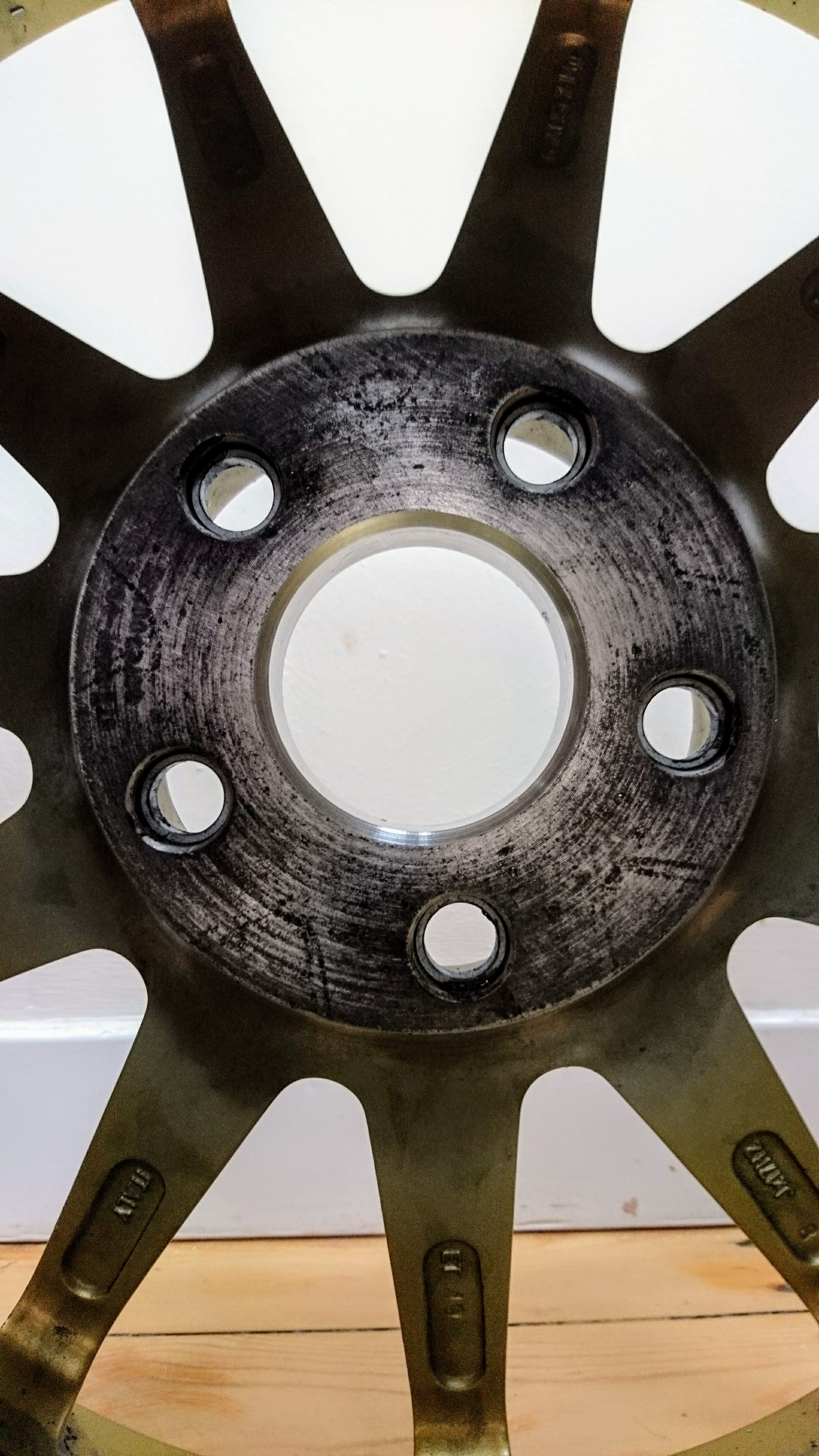

Now I know the centrebores have been machined spot on I've taken the other 2 to the engineering company. I've also asked them to skim the backs by 4mm to give me more tolerance on the rear, I know they work but I'll be much happier with them tucked in a tad more and for £10 each to be skimmed it's worth doing while they're having the centrebores machined.

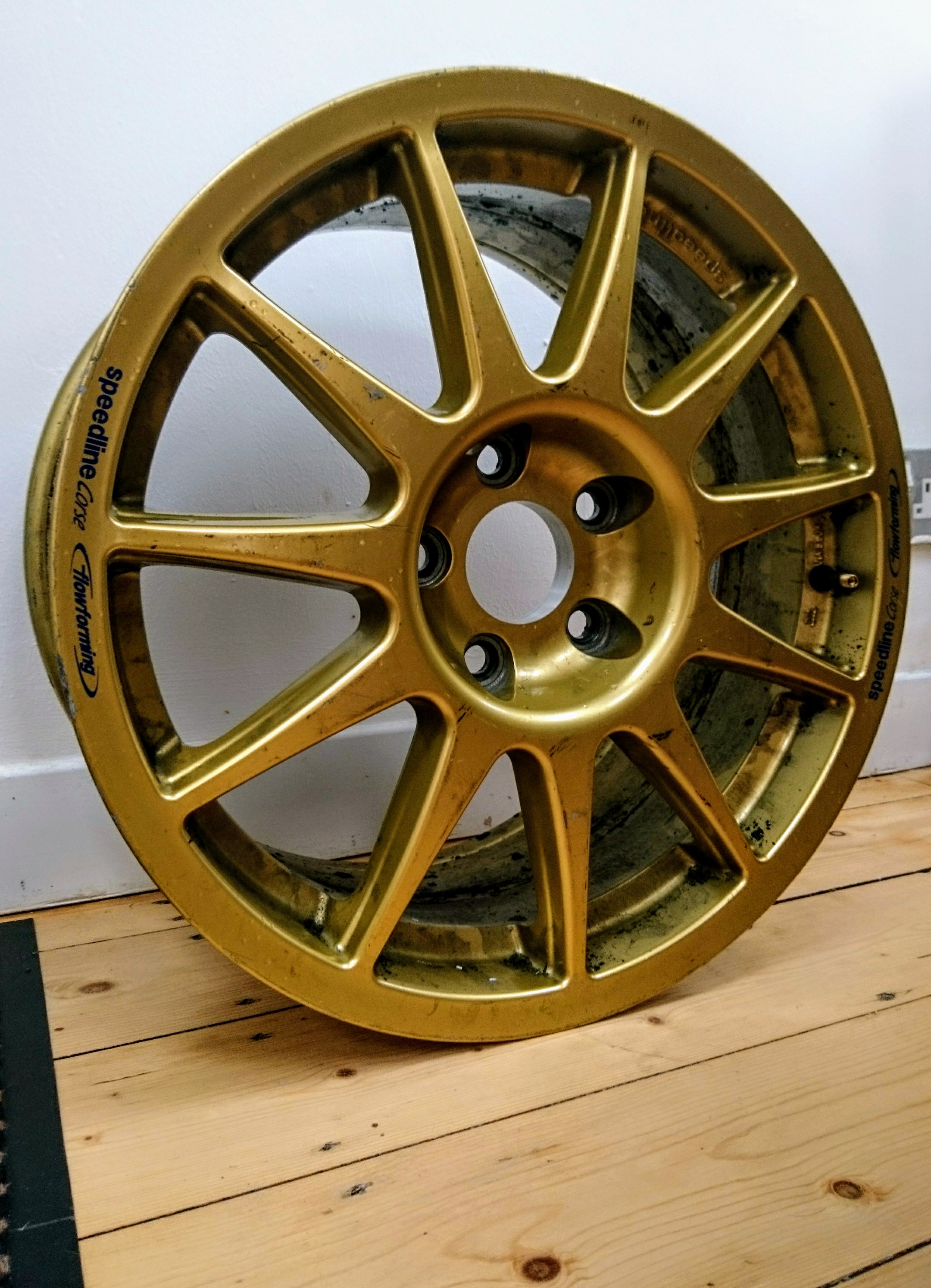

Everyone's raving about them looking good in gold with the LY.... I just don't get it, well I don't see it, maybe I'm missing something. I was all set to go white with them but now tempted to put a tyre on the wheel then fit back on again to see what's its like.
As for tyres I might go with a 205 width which is what's on at the moment but a 45 profile. I get the other 2 wheels back today so the set is all complete.
Ricardos
  LY 200 EDC
Silver. The gold looks horrific against LY.
Like I said earlier I must be missing something or getting older as EVERYONE is saying stay GOLD. It's like I'm the only one not seeing the biggest trend out at the moment.
I still say white but knows what will happen. I'll paint one, put a tyre on and fit them... And hate it, there's nothing worse than trying to pre empt a look. I did it before with funnily enough your old RB, I bought a set of OZ tarmac rally wheels in white then painted them dark anthracite. Had new tyres put on, fitted them to the RB and instantly hated them and wished they were white with the original OZ graphics on.
Knuckles
ClioSport Admin
I'm with you on the no gold thing. Doesn't work with ly
I considered looking at a yellow r27 with ly wheels before I bought mine. It looked horrific
White ftw
I was going to do my speedlines white, but ended up buying a litre of BMW space grey with my mate for £40 so chucked that on them, I was quite glad I did as the photoshops and other pics made anth speedlines look crap.
I got lucky that space grey matches the decals on the r27 very well so I think that helped

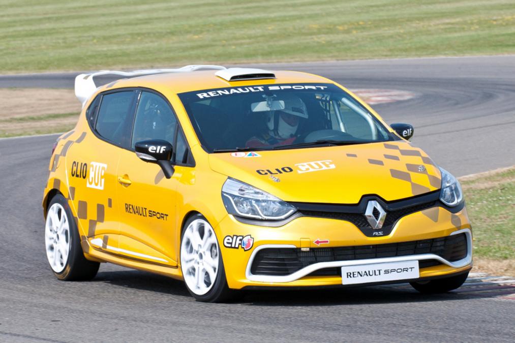

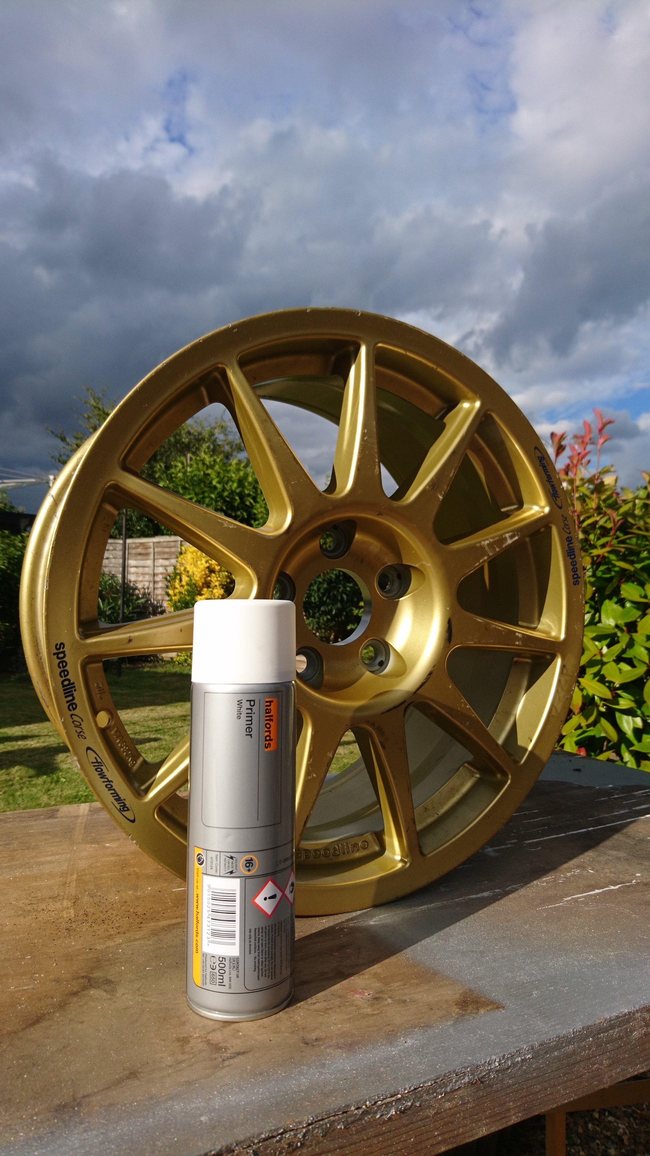

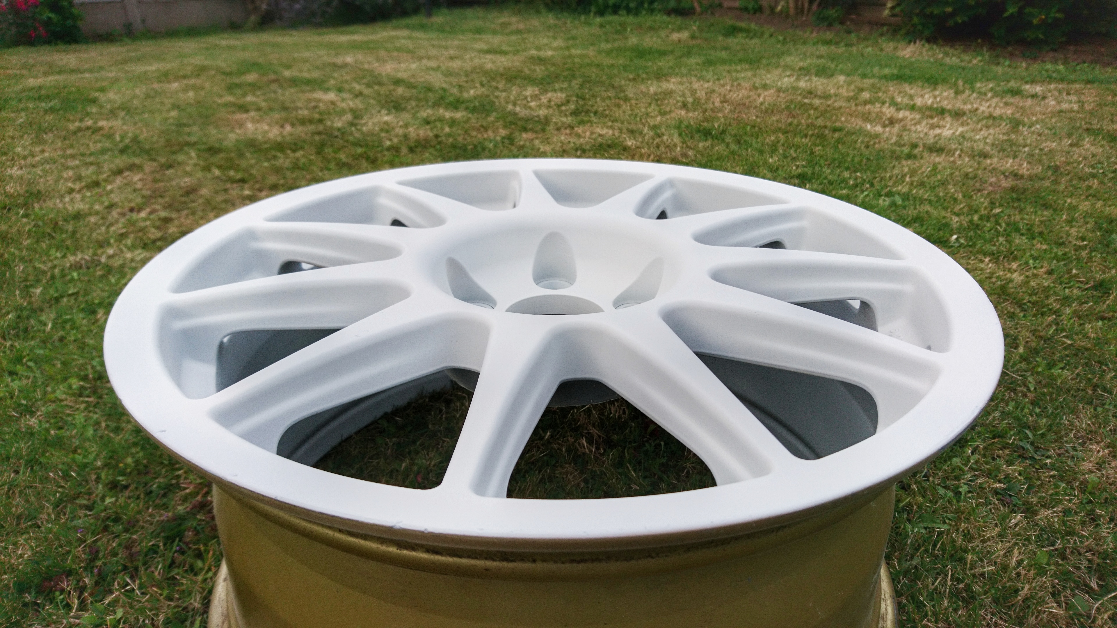

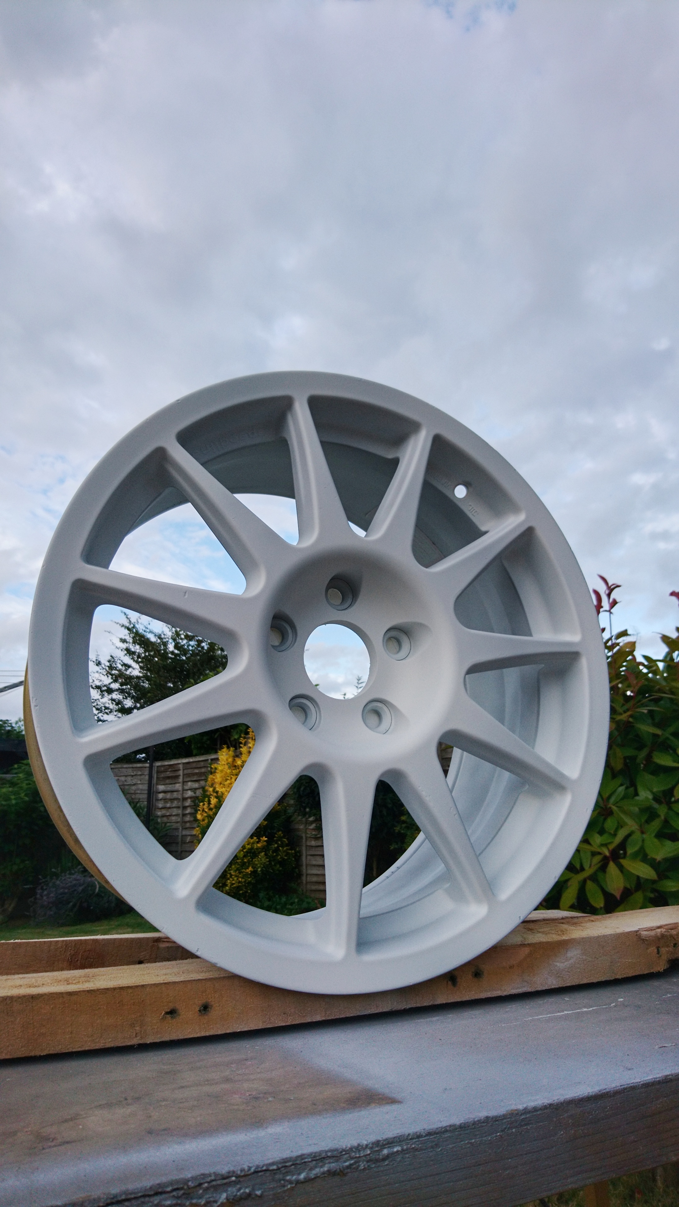

I'm gonna try white first, it's the colour of choice I wanted to go with based on the above cup racer photo and the white cup race car on white Turinis. 99% in my mind it works the other 1% says a clash with the blade and side trims.... We'll see, half the fun should be in the working out.

The colour is a tough call. Definitely not gold. White could look brilliant or awful. I'm unsure but it will be interesting to see. Silver or anthracite are safe but both will look good.

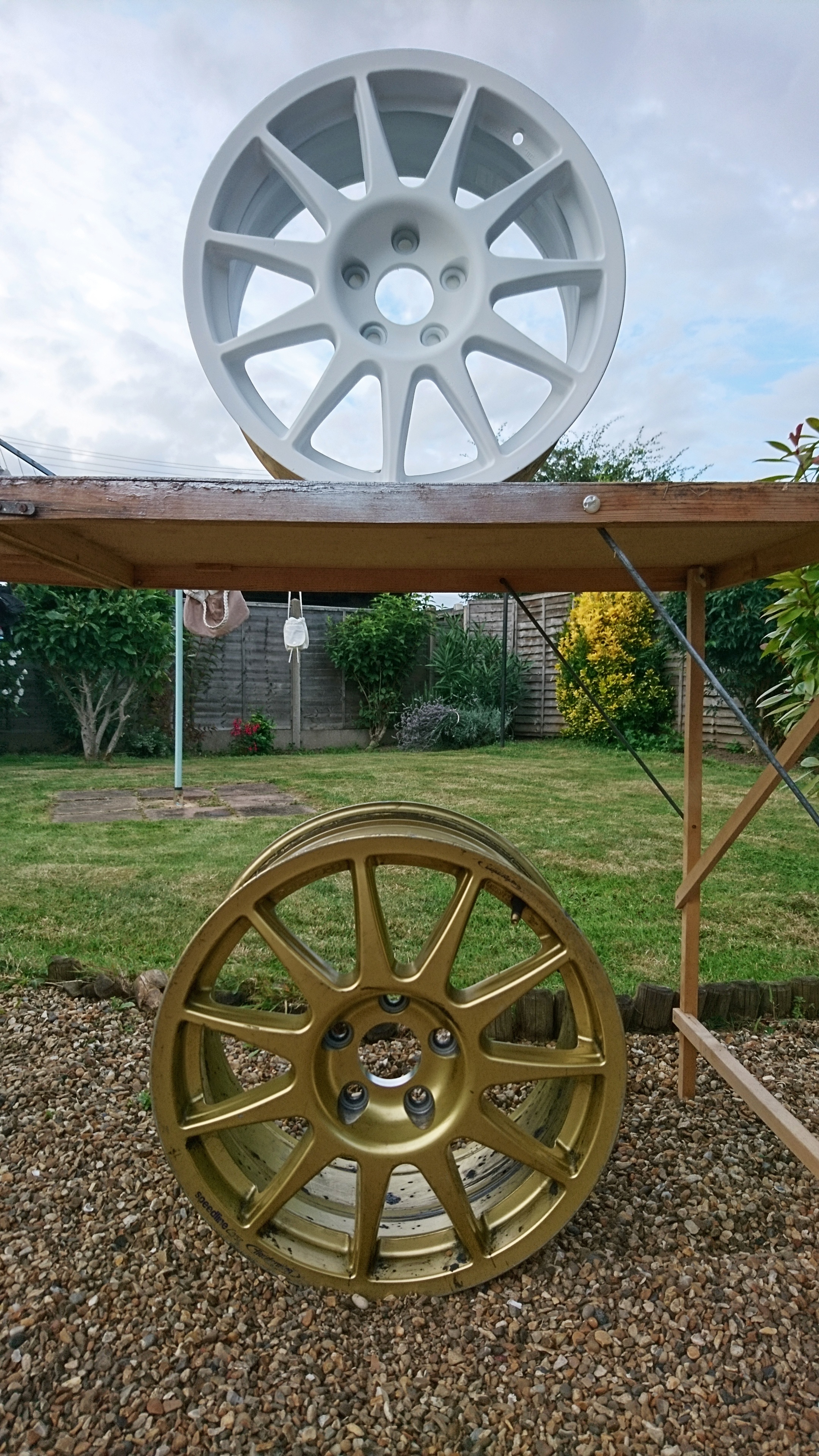

I'm soo busy but absolutely itching to spray a wheel now just to get an idea!
NorthloopCup
You know what colour would work, and work quite well? Liquid yellow. There, I said it! The black of the tyres and the red from the calipers would break it up enough to pull it off I reckon. And pull it off well.
