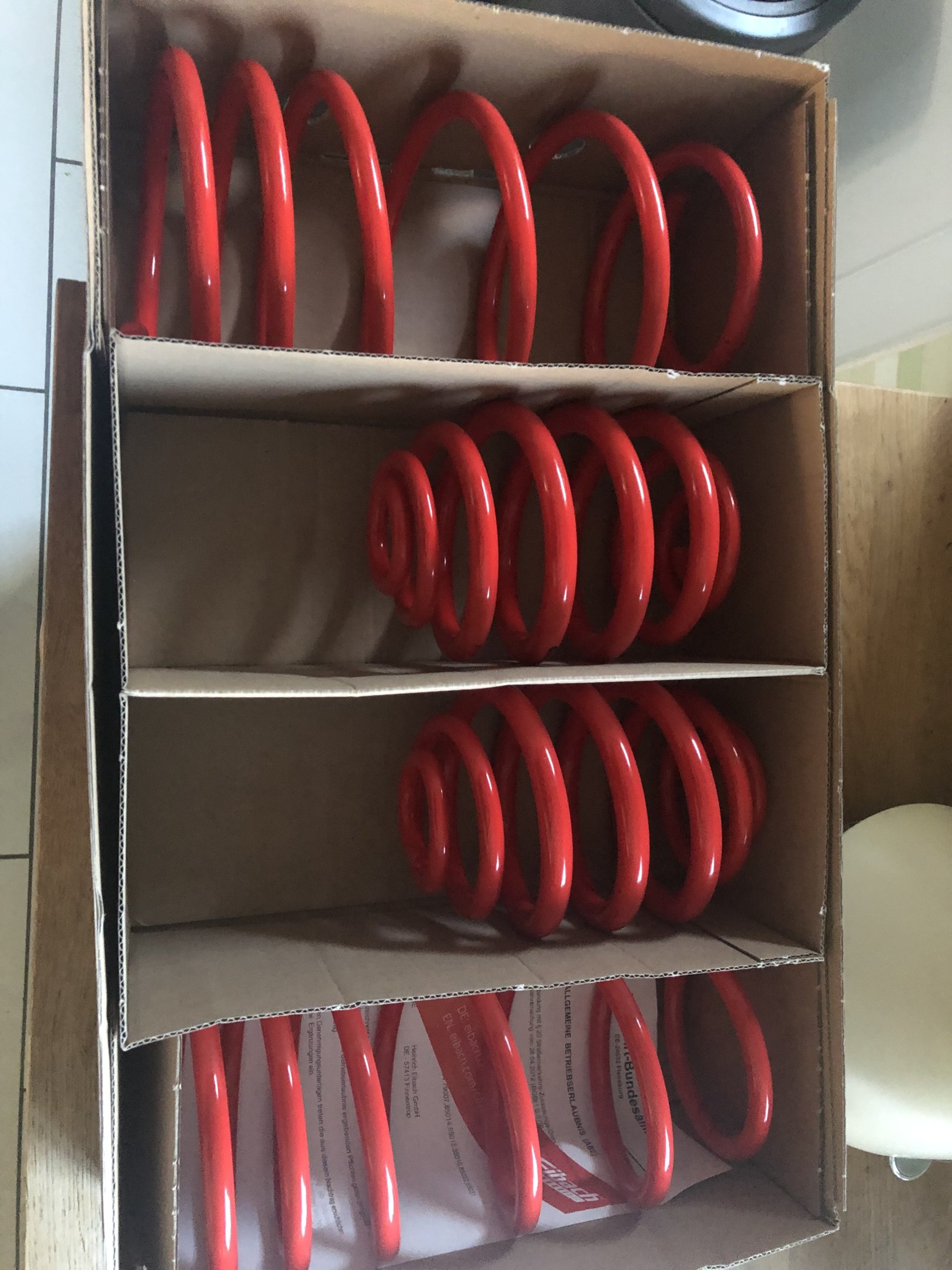

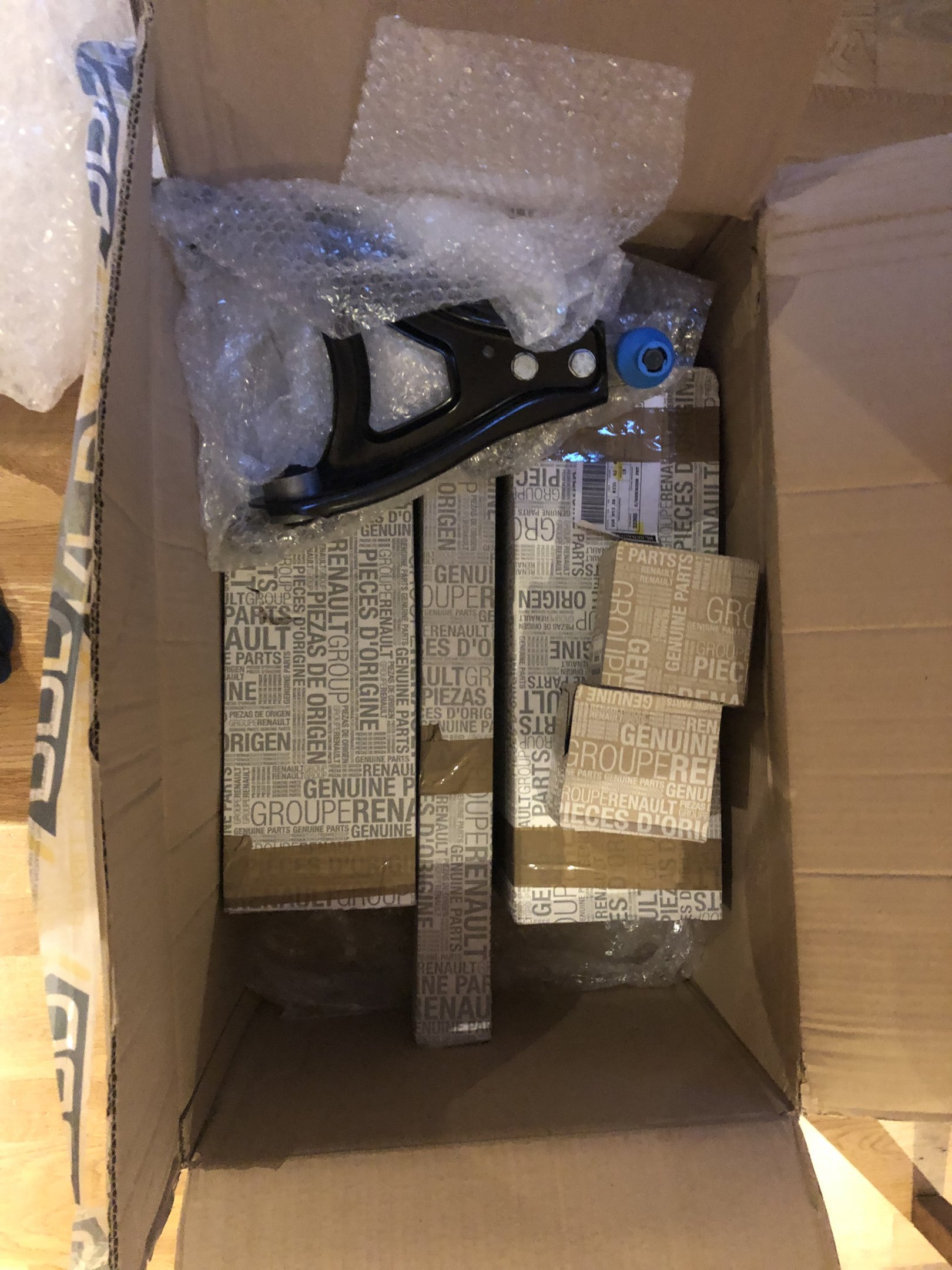

All my new bits arrived today which is great. Ordered a new set of eibach springs from Germany for £107 delivered!

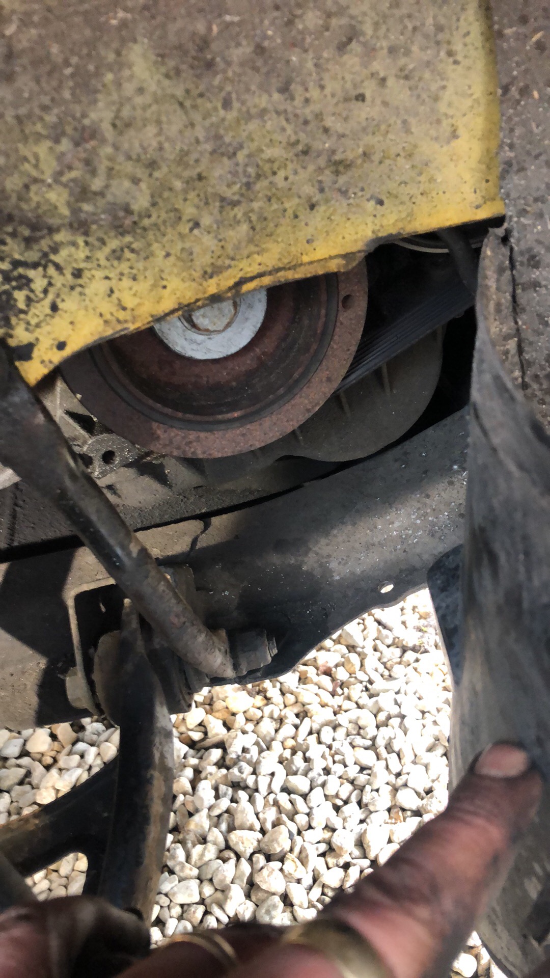

On the big negative side I inspected the auxiliary belt whilst everything is off. Not a great thing to see. Cracks.
1409371
Fitting new engine mounts tomorrow so I will inspect cambelt at the same time, not holding my hopes up. Belts were done in Dec 2015 25k ago. That auxiliary belt is a hell of a mess for that milage.

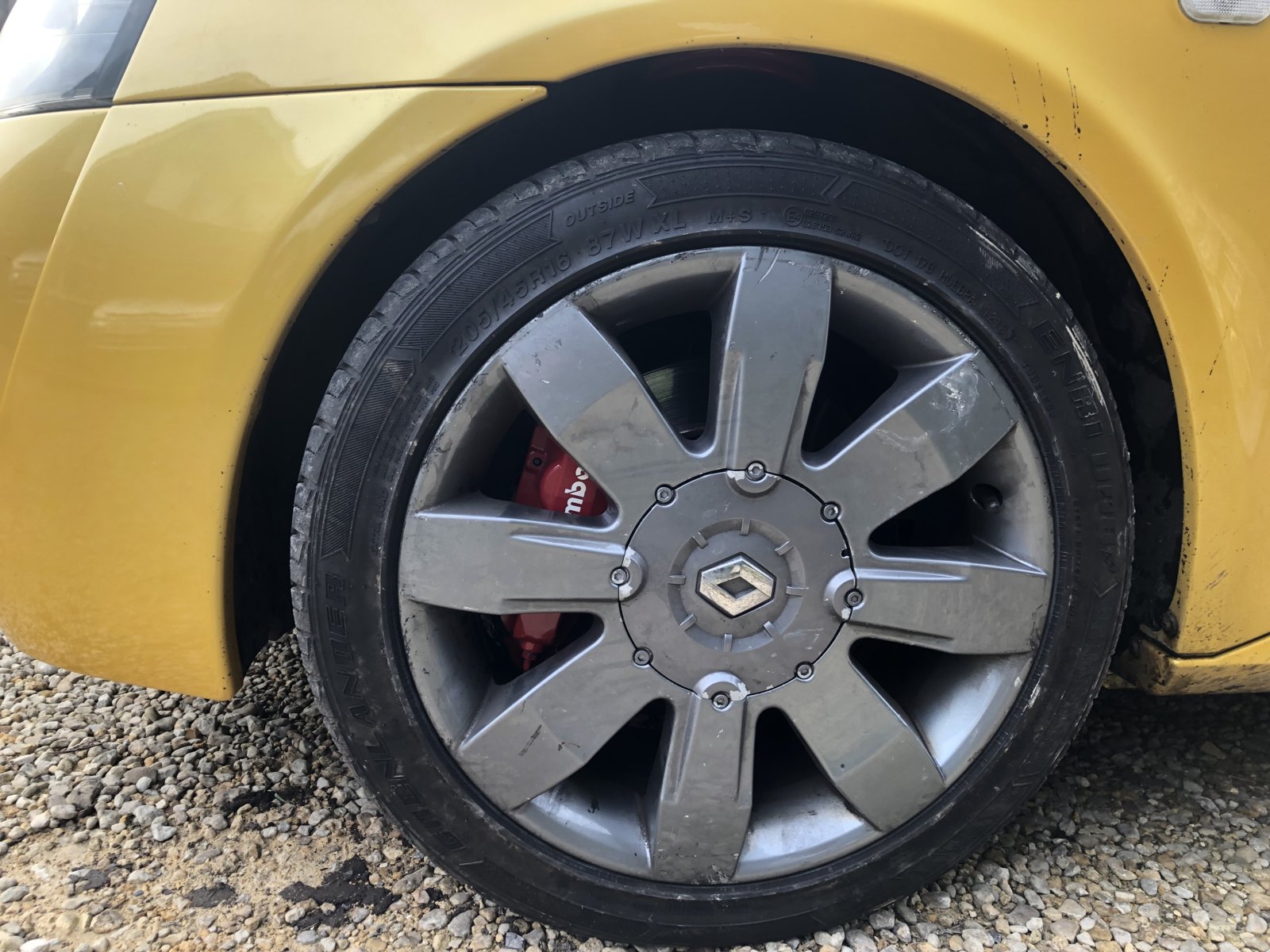

Fitted a 280mm brembo setup today from my other car. What a wanker of a job.

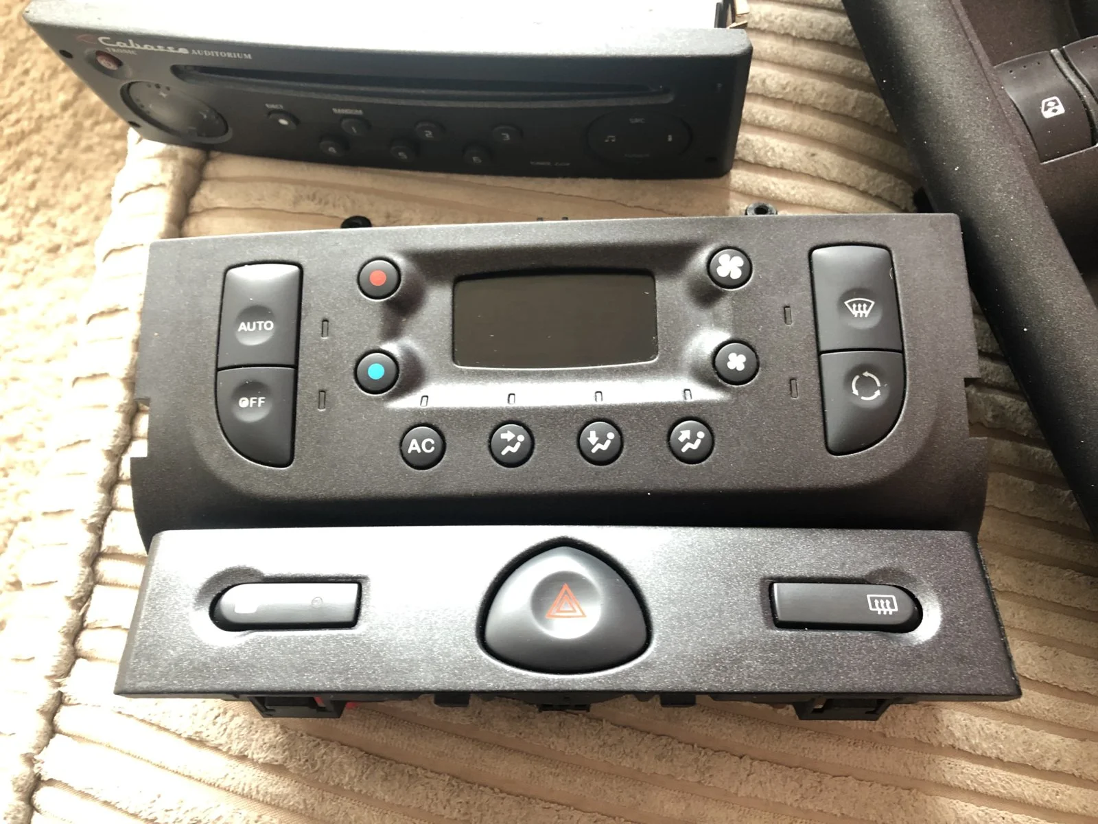

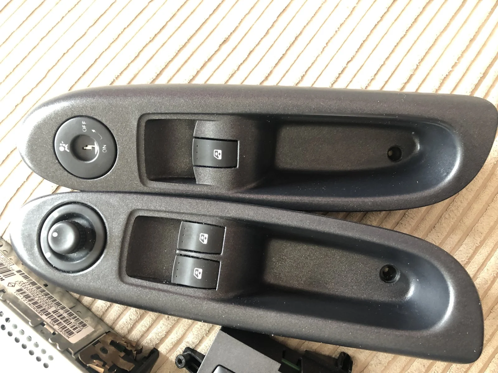

Started getting some of the dash pieces ready to fit as the current parts have seen better days.

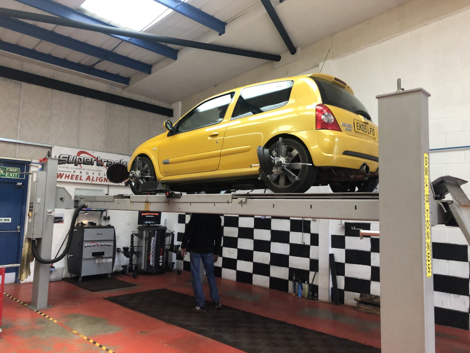

Alignment tomorrow, belts and service next week. Now need to sort body and wheels whilst working on interior.
