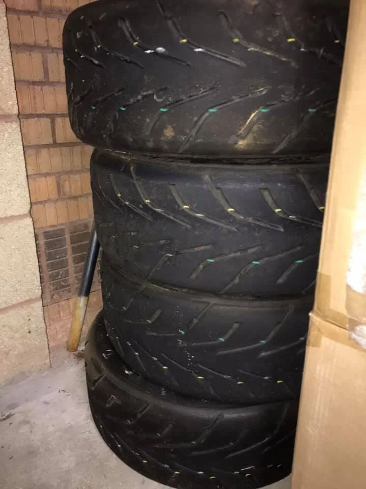

Collected the 182 alloys today with the 888s. All have 4mm left across the tyre which is grand. Correct size also, 195-50-16.
Sourced a mint set of turinis without tyres so trying to decide if I should go with those, £560 all in with tyres fitted, or £320 with 182 alloys refurbed and tyres fitted. Choices choices.

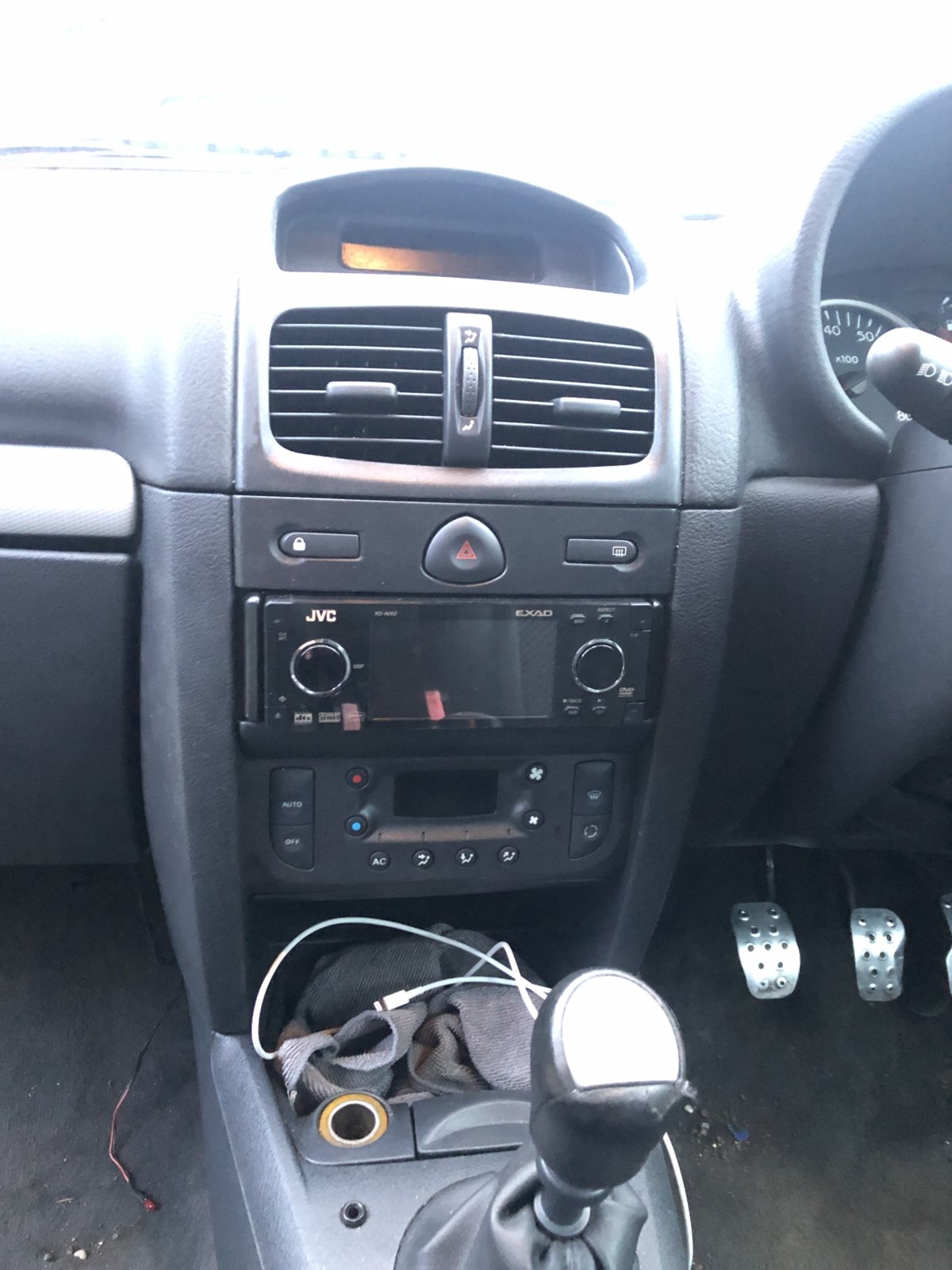

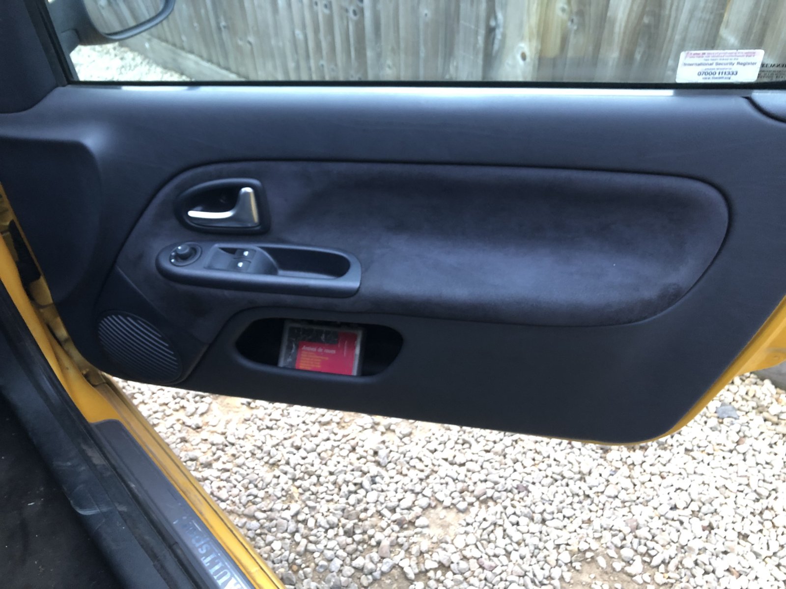

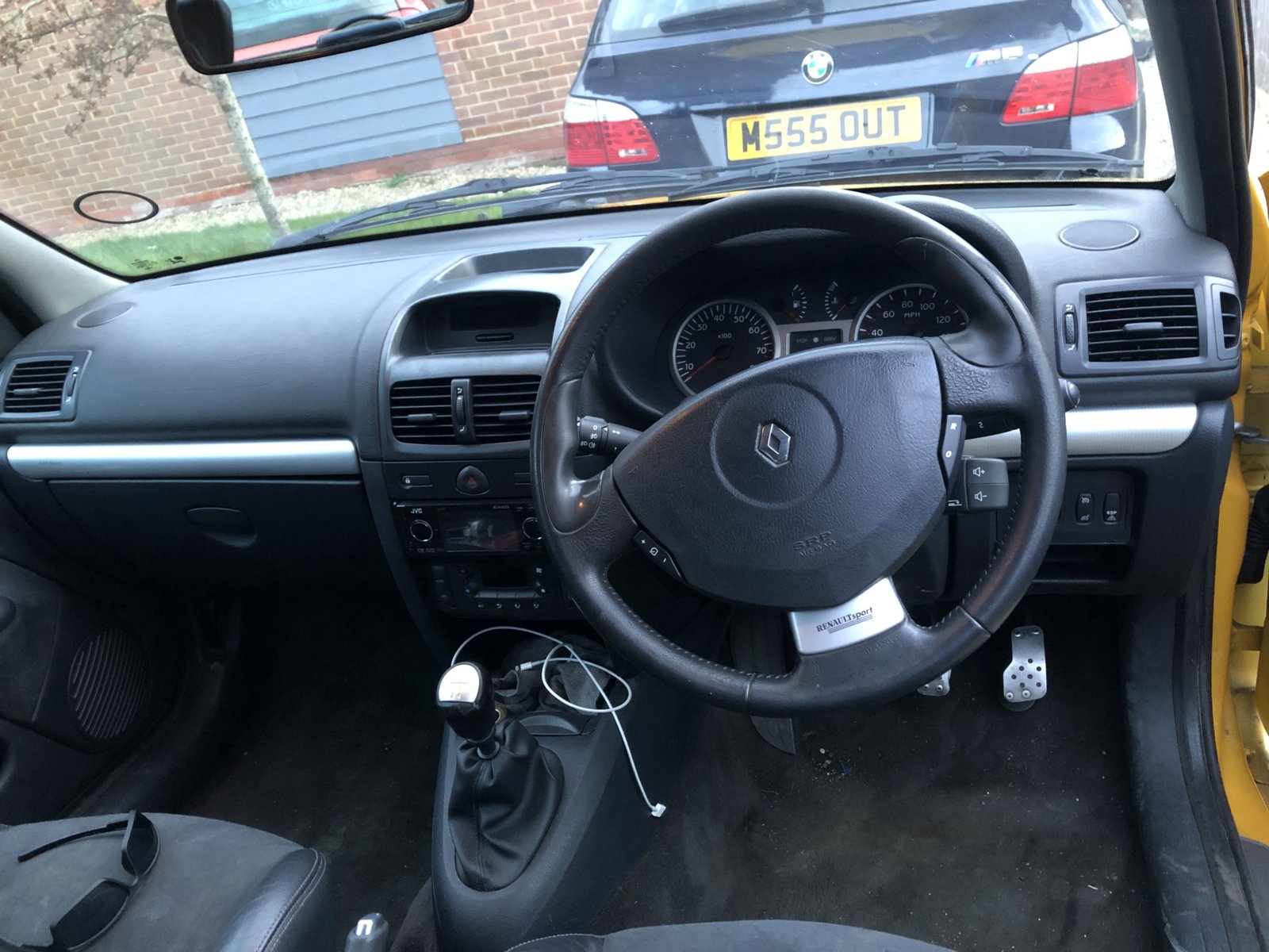

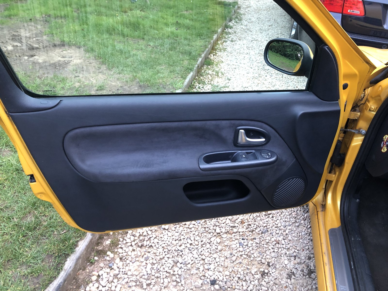

Spent a few hrs fitting a acceptable steering wheel, mint front door cards and window switches, sorting the stereo wiring, fitting the temporary headunit, and mint dash inserts.
Certainly feels and looks much nicer to look at. Now need to remove seats, clean carpets, fitting other interior trims and replacement seats. Oh and clean the minging seatbelts.
Got dark so pics aren’t the best.

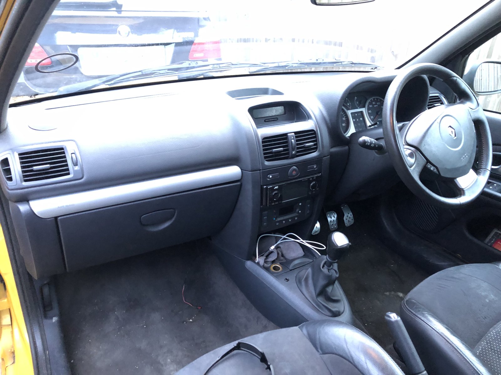

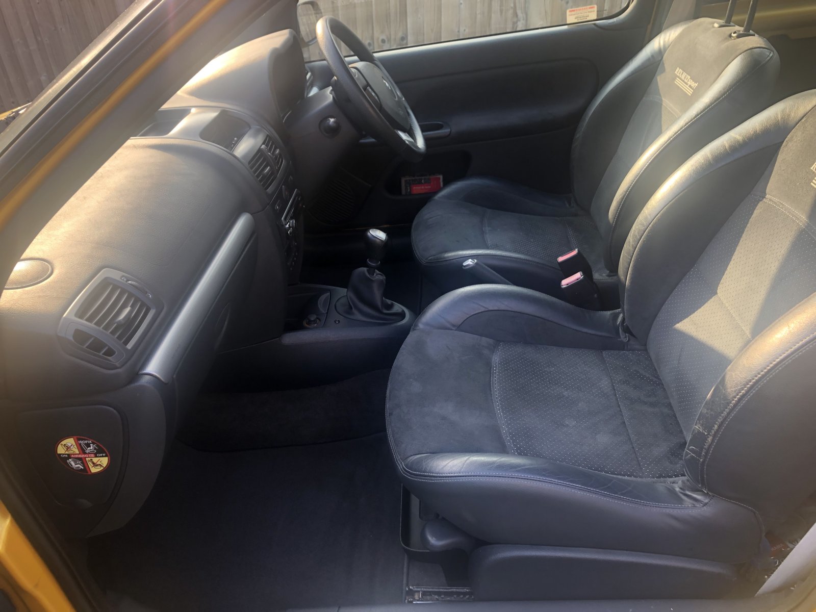

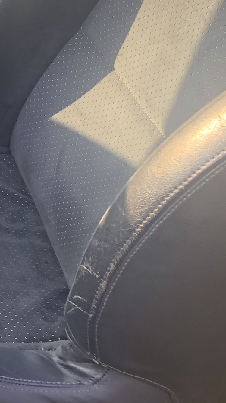

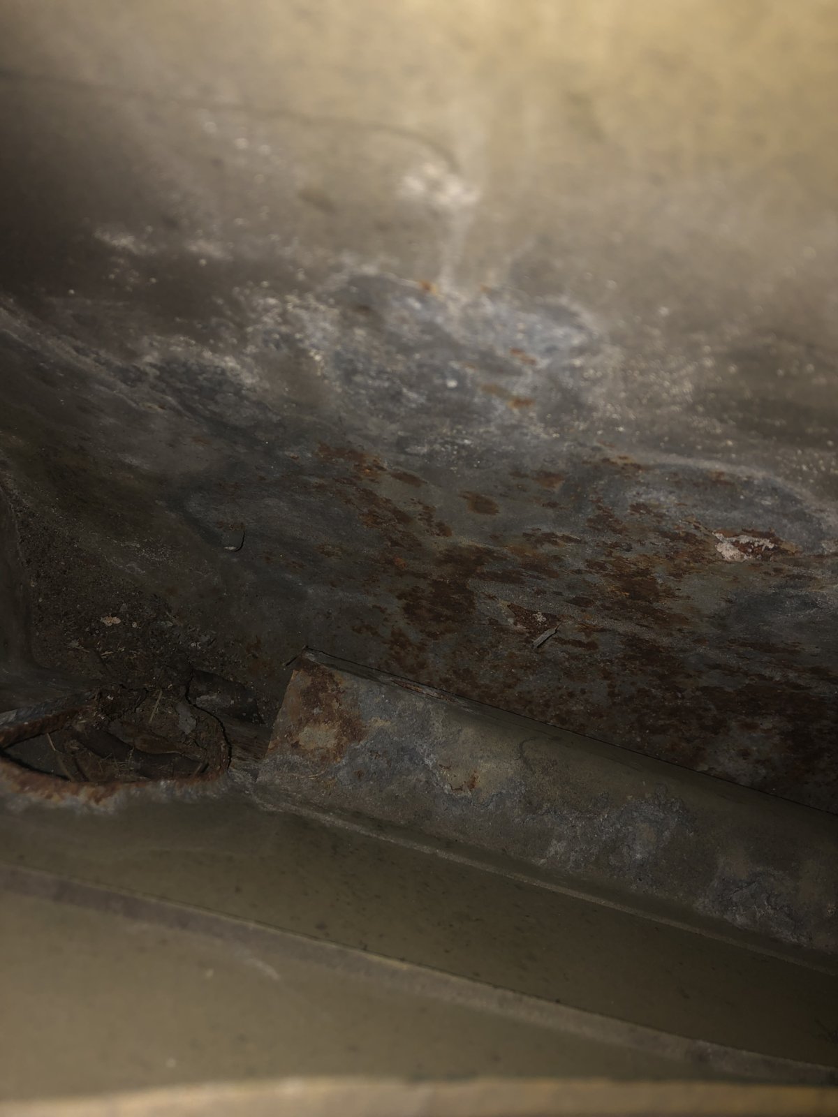

Interesting day.

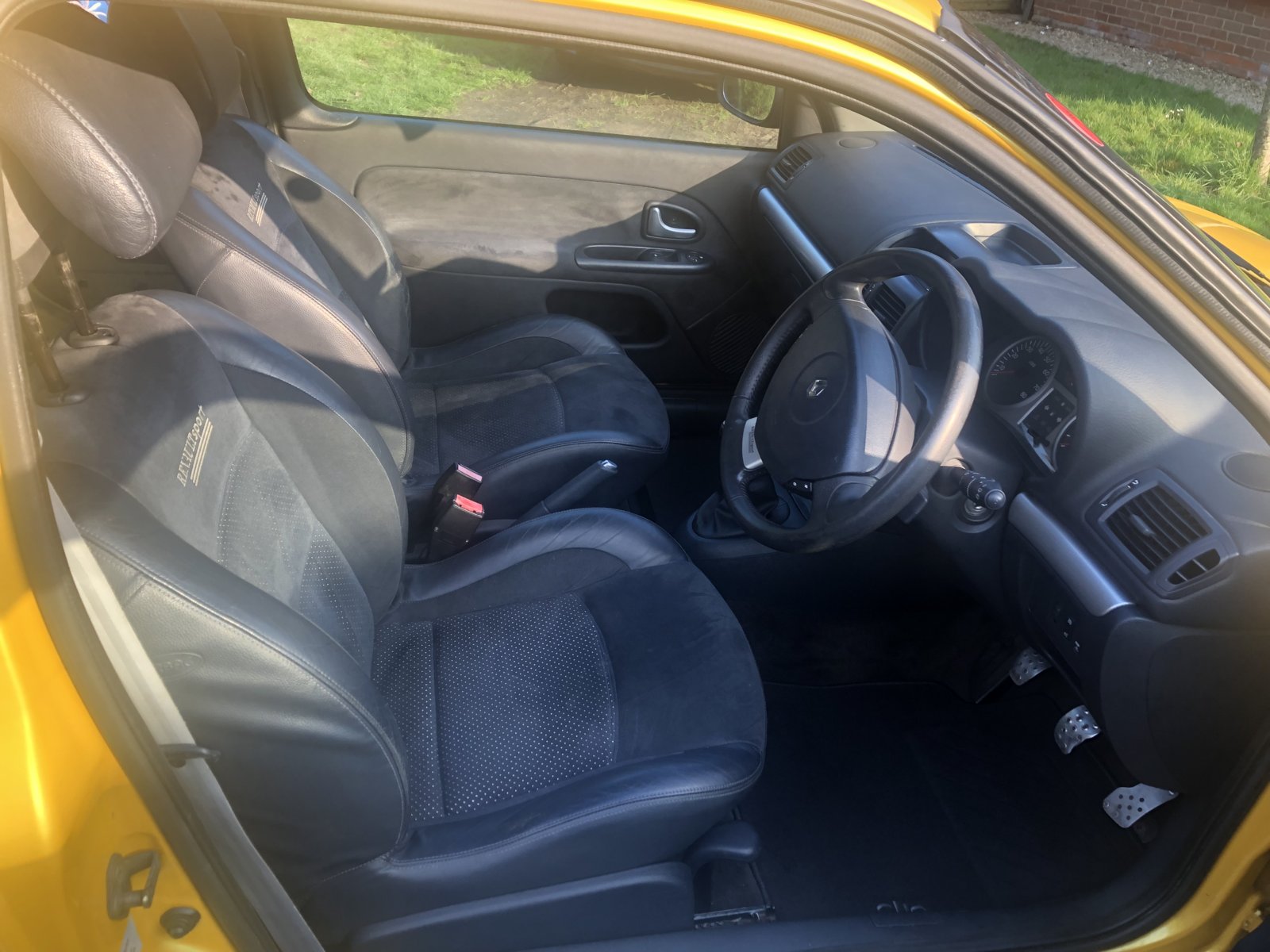

Finished the inside front of car, best I can get it and it’s actually a nice place to be now. Deep cleaned seats, all plastics, etc and fitted new mats.

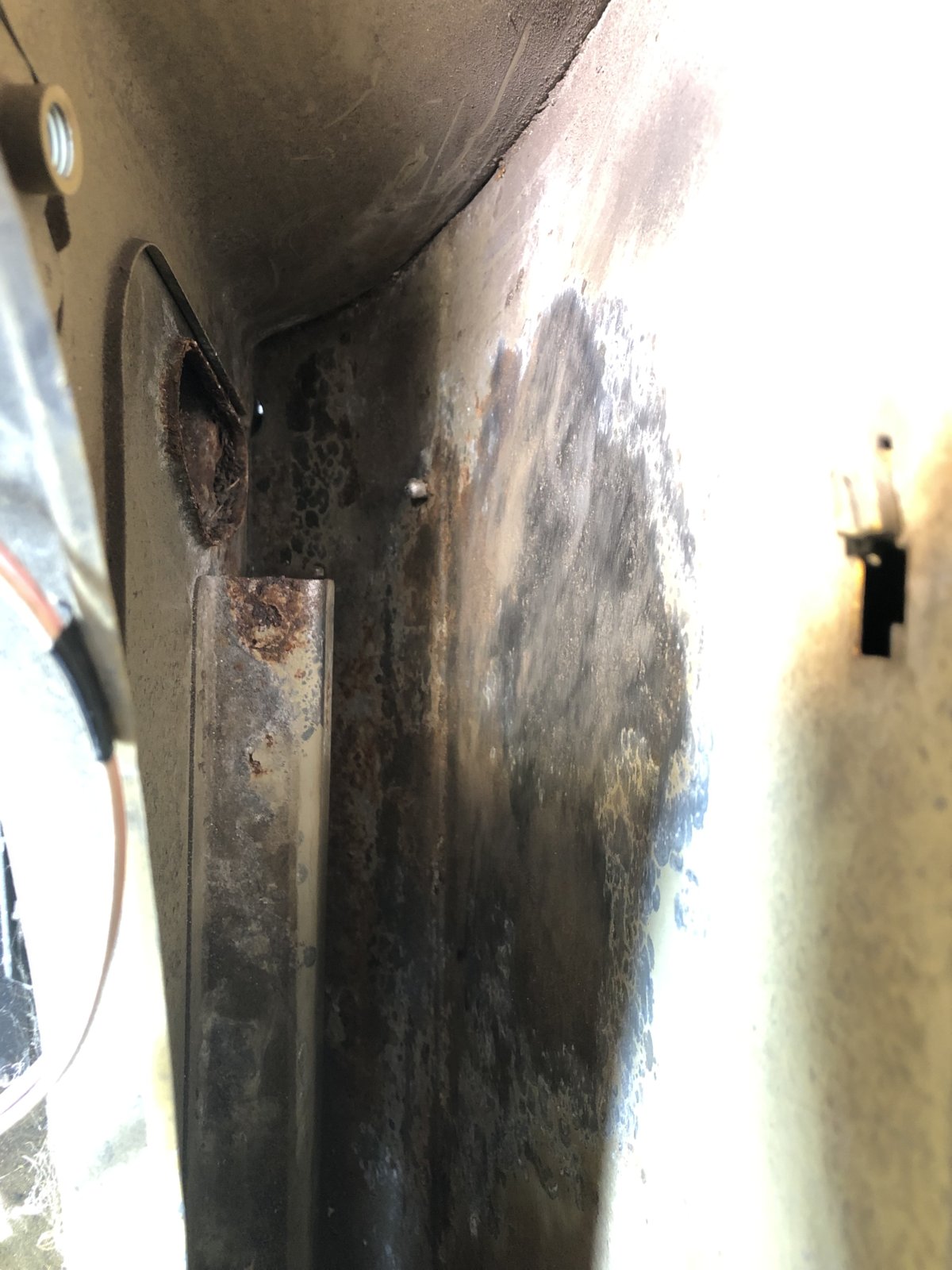

Rear is done but working on inner arches before I put back together.
Mine aren’t bad but I wonder how many people have actually looked??? Looks like the phase 2 172 and 182 is going the same way as the phase 1s......
Before
After
Now wait for area to dry before I put permanent treatment down, prime and cavity wax.

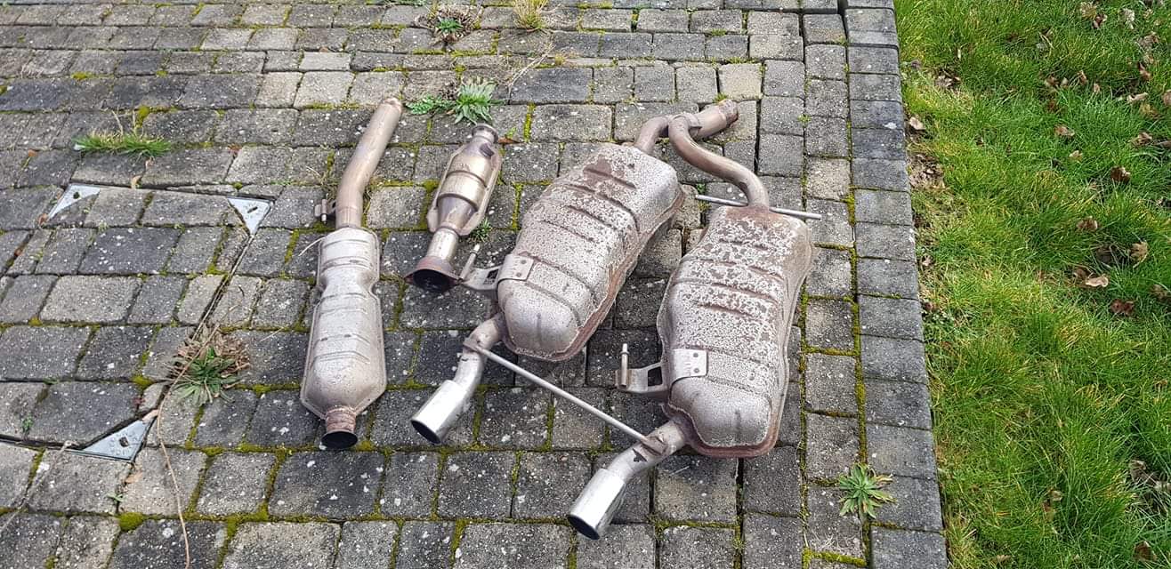

Also have a standard exhaust on its way, can’t fit the replacement front seats yet as the after market exhaust is in the way of bolts. All new hangers and mounts will be fitted at the same time.
Brigsy
  T.Turbo
Ive seen a couple of rusty arched ph2’s, assume its come from inside on a lot of them as down the seam. Caught that just in time, will clean up ok
