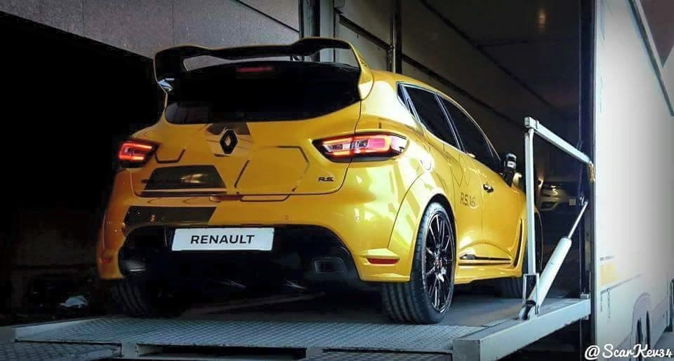

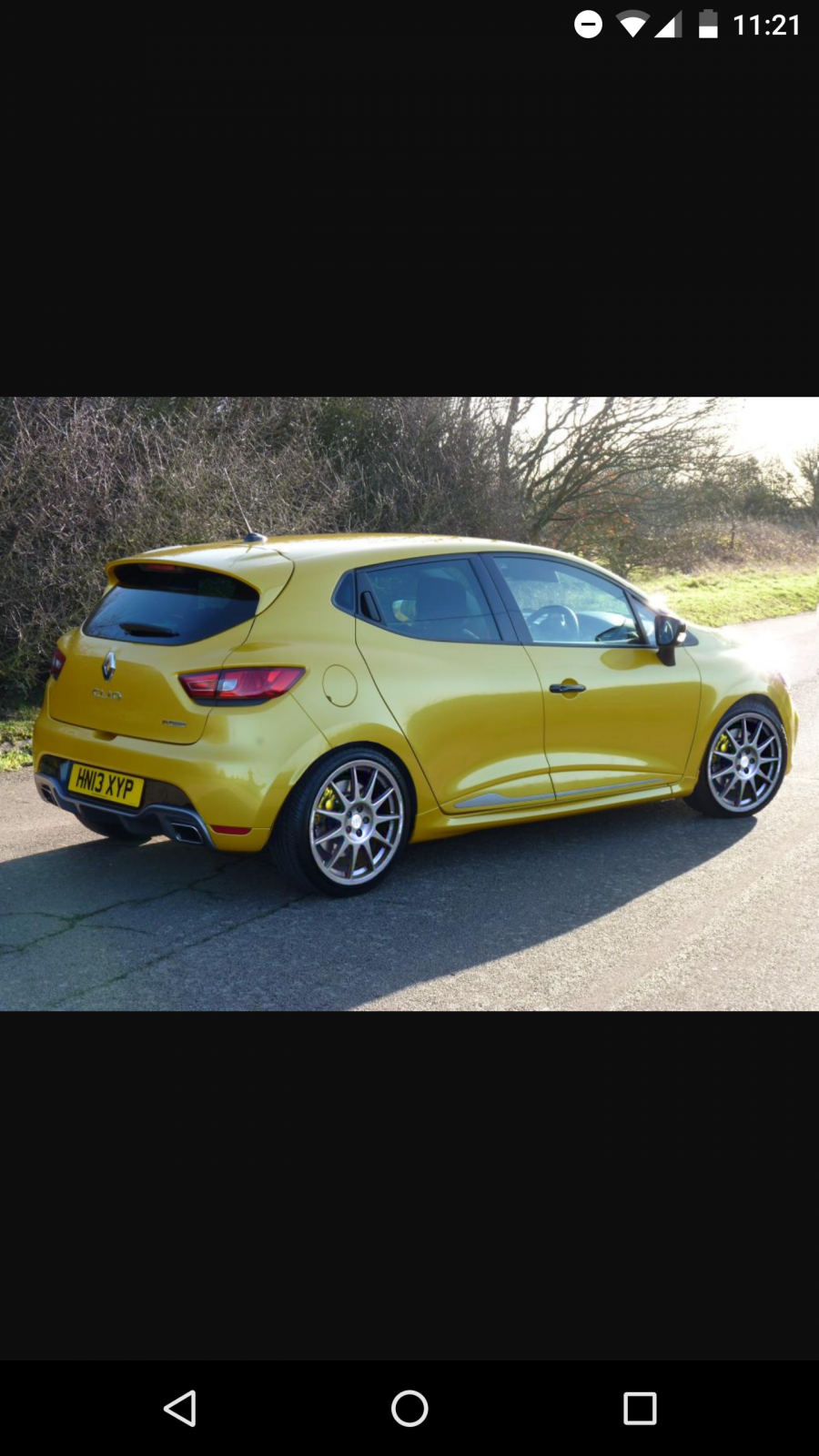

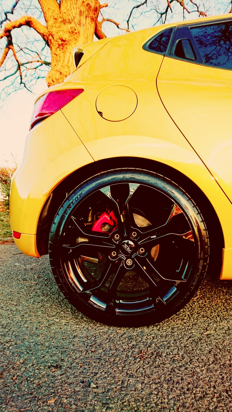

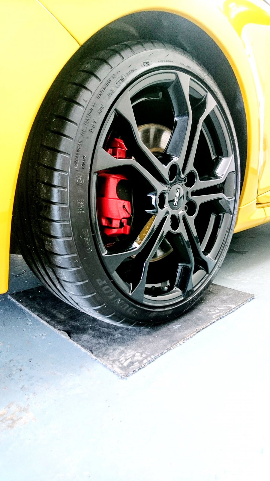

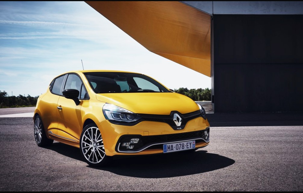

Really struggling with finding a set of wheels due to the high ET the EDC has. While I was in Renault yesterday they have the facelift 220 and saw the wheels.
I asked parts department for a price, in my opinion it would give mine the look of the facelift model. Then I saw that the French models have them like this.
I'm leaning towards silver if I can get them here in the UK, the black wheels seem to get lost and you can't see the style of the wheel on mine. The black 220 are better but also like the silver.

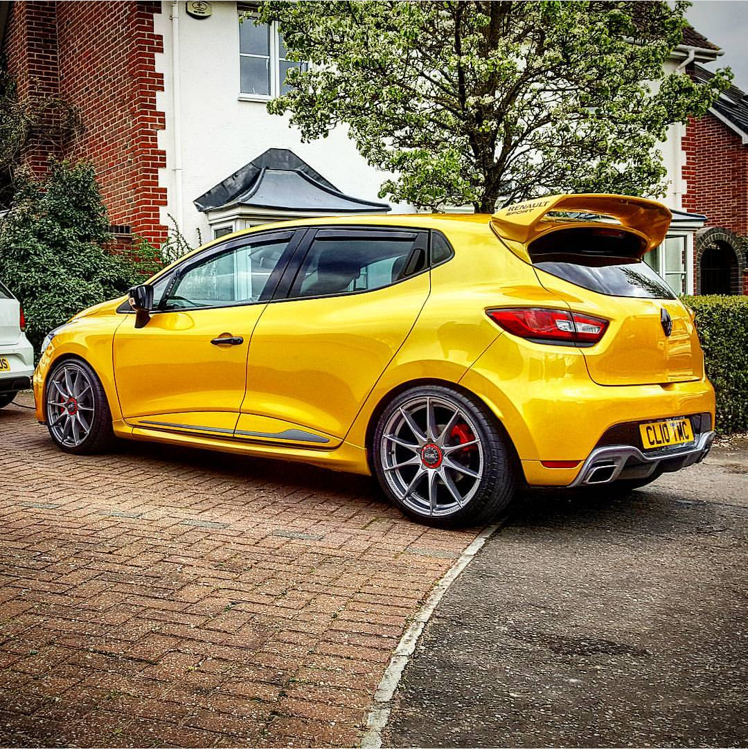

They look awful. Like a 17 year old whacking some giant Halfords wheels on thier 1.2.

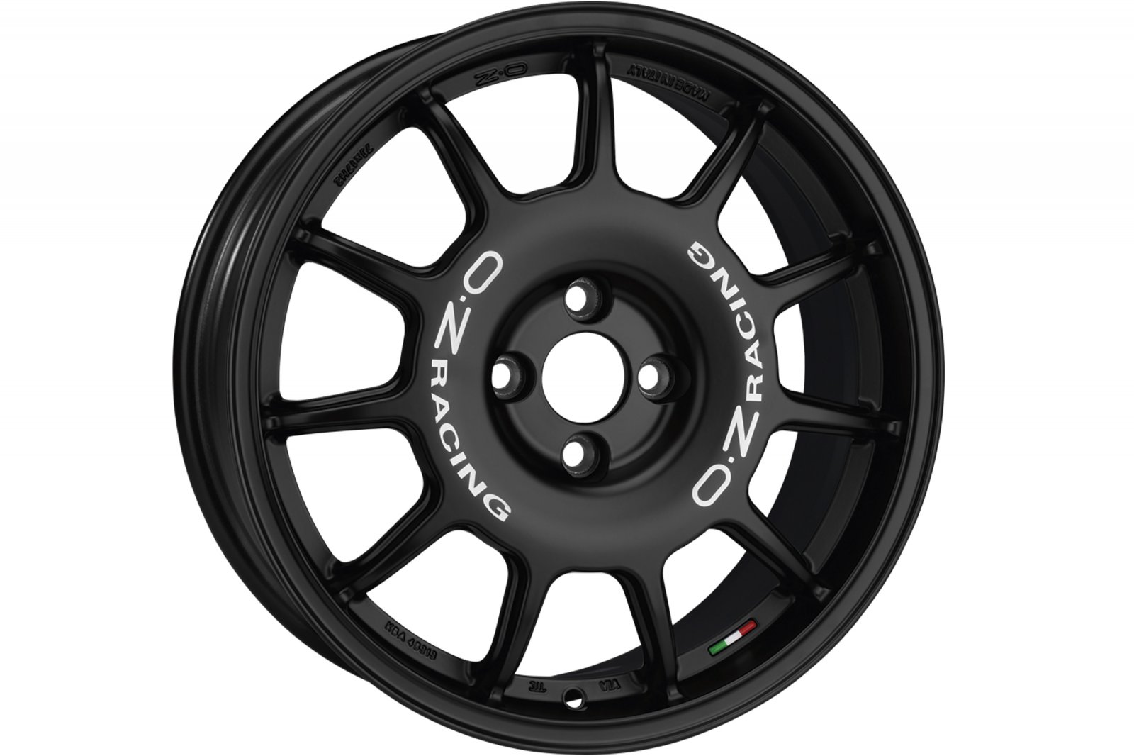

Leave yours alone.. or go mad and get some Ultraleggeras !
Ultraleggeras are a good shout. I do like your current wheels too though but the centre nut thing would do my head in.

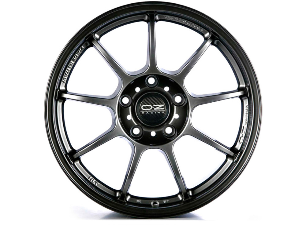

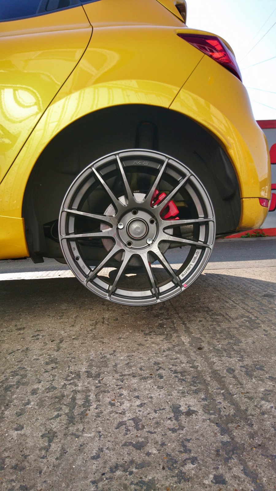

The HLTs are a 7.5Jx18 ET47 offset, I'm not copying someone else as much as I like them. Believe me for the last 2 months I've been scouring the internet for new and 2nd hand wheels in an offset that will work.
So I tried an 8J ET48 as recommended by OZ but this is what happened
They stick out past the rear arch by 10mm, as this is a company that give the 8J the green light. When you go to 7.5J you're severely limited in what style wheel to have in 18".
Another option is to go 17" and go 7J but then it means new wheels AND tyres, I want to use my OE 18" tyres.

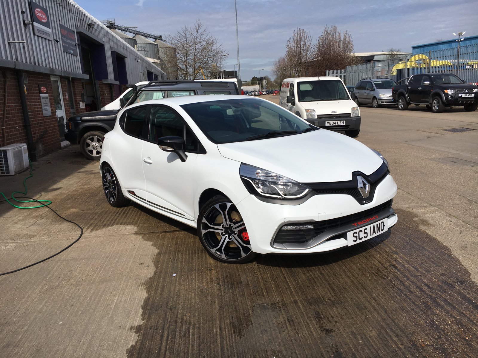

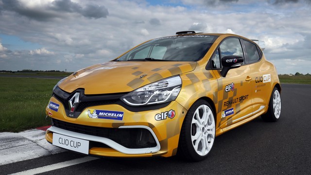

I was going to suggest white like the cup racers but

I wouldn't get those 220 trophy wheels. They look a bit spindly. But you're right that silver is better

The white actually doesn't look too bad, again it's a struggle with the high ET and 7.5J width. The OE wheel on the rear already sits close to the edge of the arch.

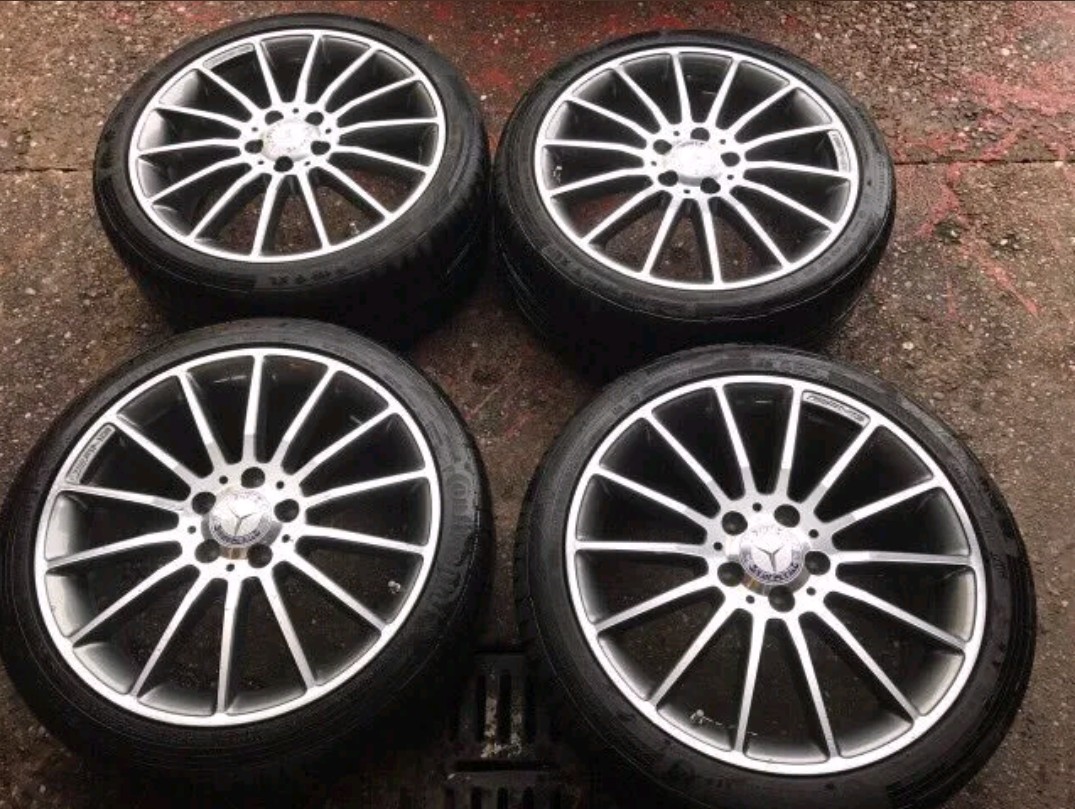

I even looked at these as a possibility, 7.5Jx18 ET53, even the same centrebore, BUT 5x112 which would mean using wobble bolts
View attachment 185627 View attachment 185628
What's wrong with 10mm poke?

It sits outside of the wheelarch and will rub. I don't want a car that looks like it's had the wheels 'spacered' big time. Either flush or literally just inside.

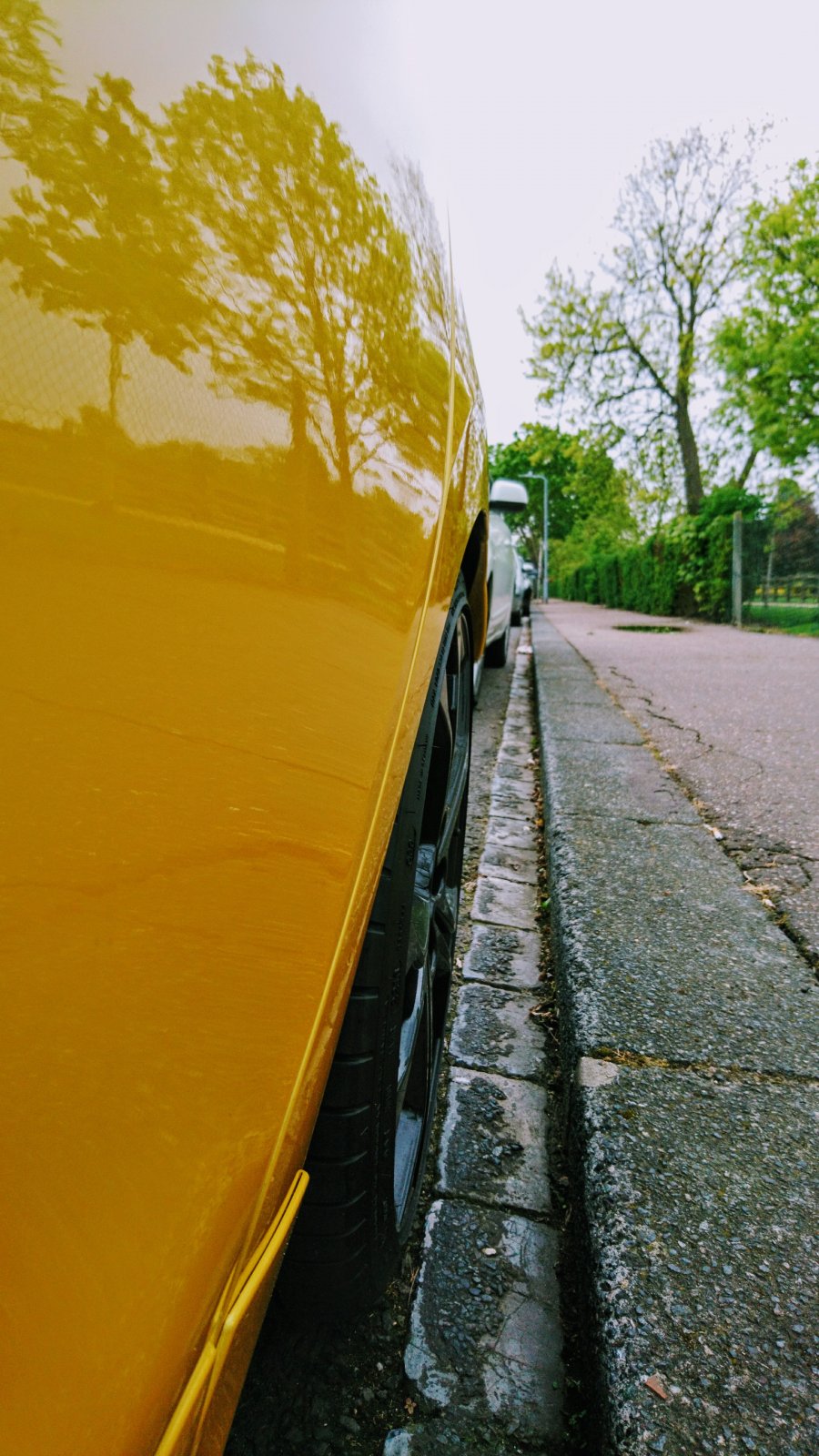

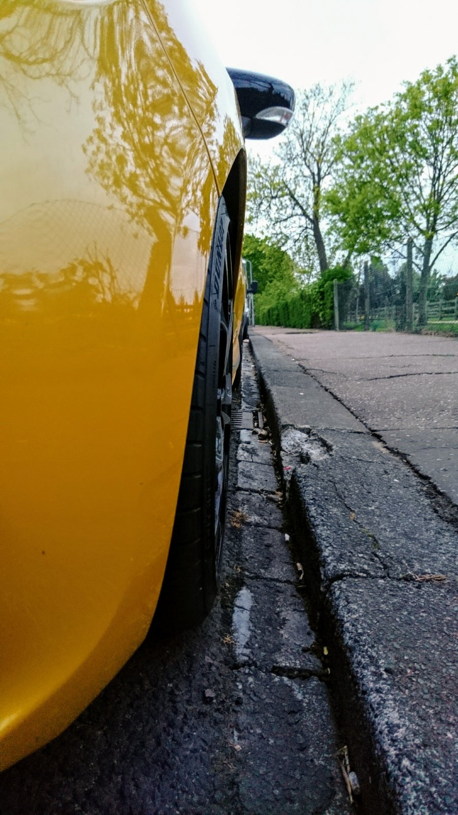

I took a photo of the rear wheel and arch, bar getting a tape measure I think it shows how close it already is with the ET55 and 7.5J.
An 8J instantly pushes it out 12.5mm
Ricardos
  LY 200 EDC
At the top I'd say it's in by approx 15mm, my concern is the radius of the wing to front bumper falls away to expose the tyre tread.

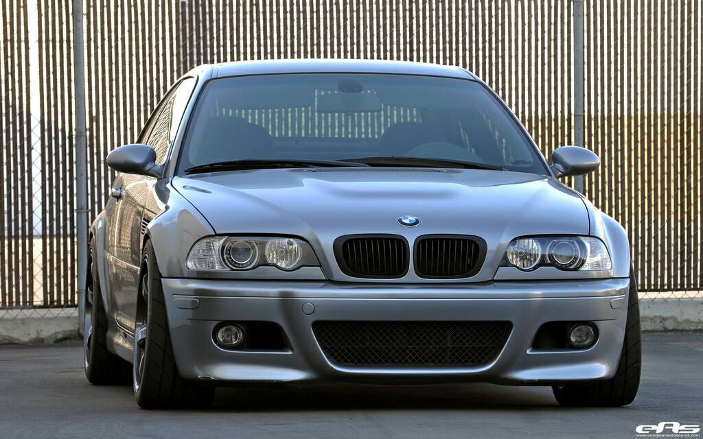

Something like this might be enough for you, you can see it just brings it under the arch. Obviously an extra cost though (mine were about £200)
