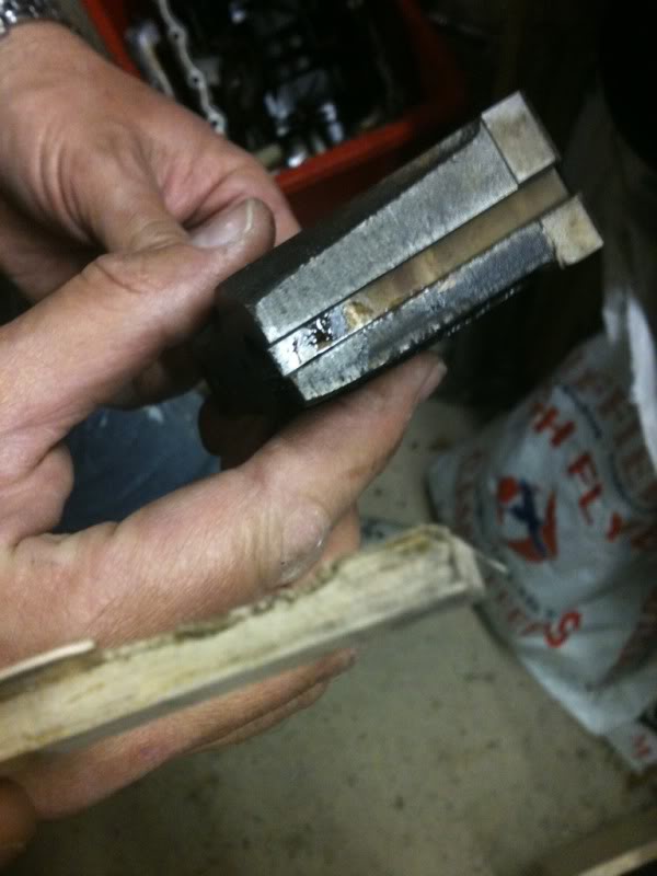

Guy's what is this sealant round main bearing no.1?
Is it just a sealant or is there a reno part?

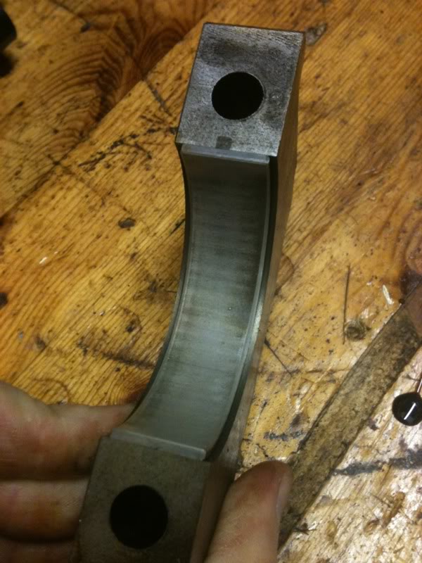

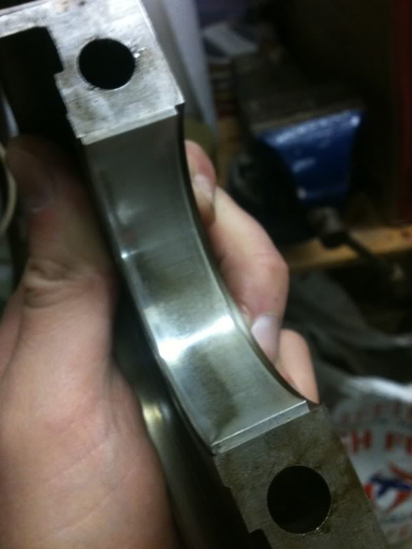

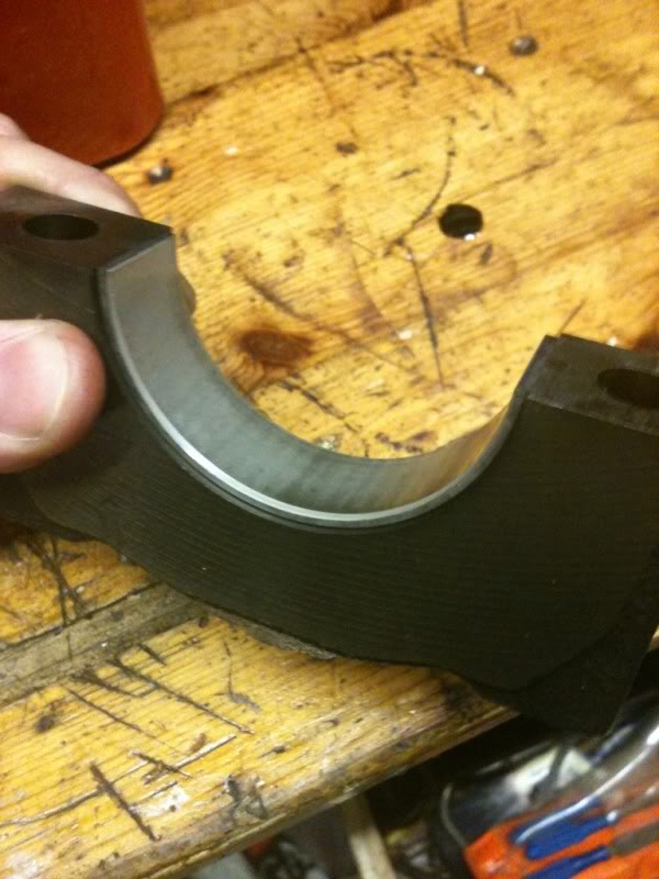

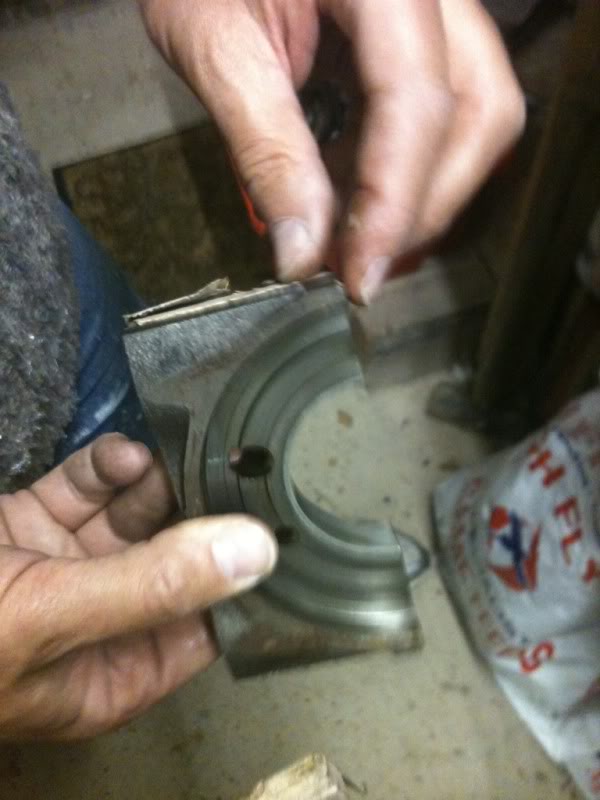

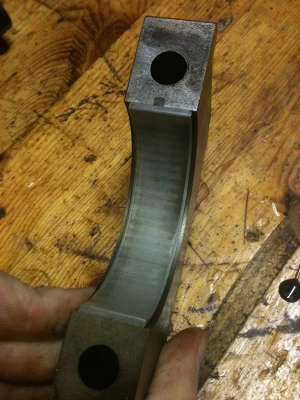

Also would you re-use these:
They don't look too bad to me, but there is the odd mark, nothing major. Big end bearings are as clean as a whistle.
Cheers
Bearings look perfect. I'd say it's a pretty big waste of time to do a rebuild and not replace them though.
The sealer is liquid gasket. Be generous with it, and make sure you add some into the bottom corners of the block where that bearing cap fits to. This is where they ALL leak from after rebuilds
