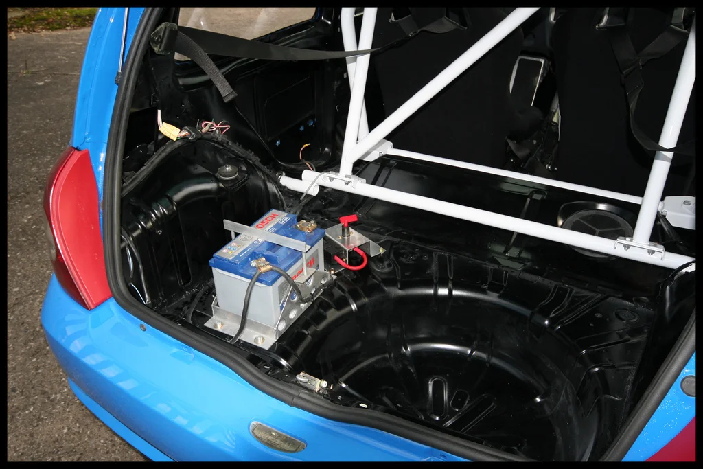

Got the battery in the boot of the 172 track car. This also features an isolator switch with a fuse box built onto it. Until recently the car has been fine with a 125a megafuse (blow rating of 250a). Blown two of these fuses while starting the car in the past two days so replaced it with a 150a megafuse (blow rating of 300a)
what size fuse should i be using?

the fuse that keeps blowing is the fuse which is located approx 20 cm away from the battery.
this setup was done by angelworks tuning so im disapointed if they have used the incorrect cable :S

how it looks now, mega fuse is located in the black box which is connected to the isolator
