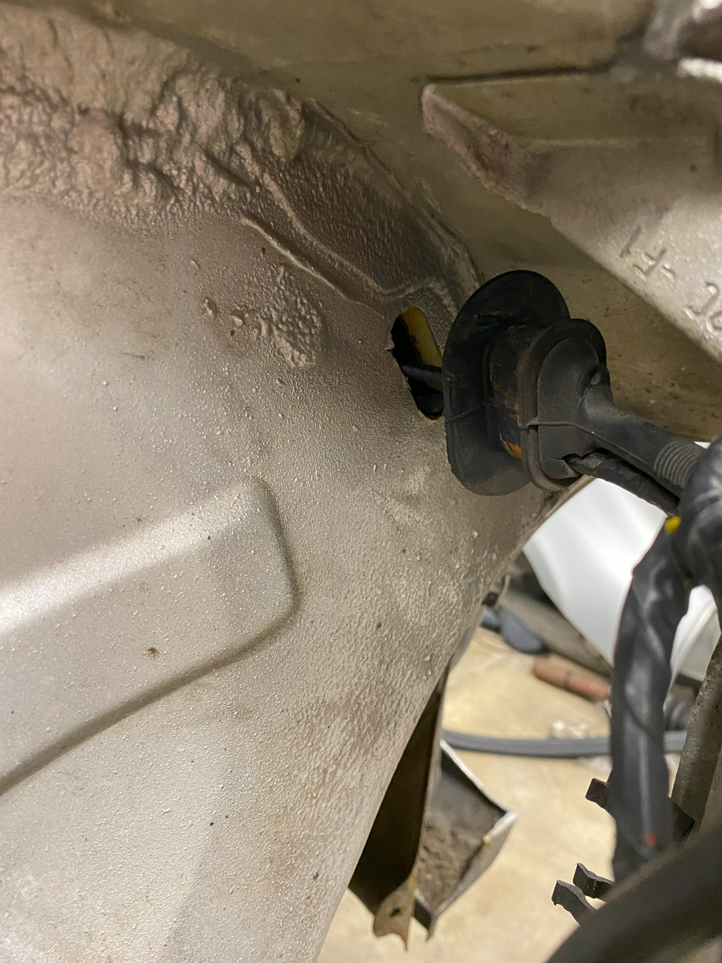

Here is one through the bonnet release cable grommet.

Have a hunt under/around the ABS pump and you’ll find a big rubber grommet with a wiring harness going through it. It’s a decent size and more than big enough to poke holes in and run extra stuff through it. My boost gauge hose and wiring for sub both run through there.
You can access from the inside, you’ll see it at the very top of the passenger footwell which makes pulling things through it a lot easier
KitsonRis
Currenlty have my fan controller wires going through that one - but I have managed to put them through the original hole in the grommet (which was a right mission putting two wires in!) and there is no room for two 16awg wires in it as well! If I can find something that will work as a grommet so the wires dont get damaged then I might remove the original grommet and pass all the wires through it.
