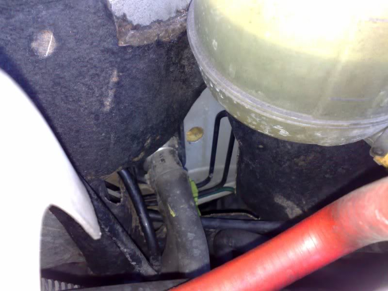

About the bonnet realease gromit its a small round one you can see it if you look behind and below the water tank, heres how I did it...
I pushed the gromit through from inside behind the glove box, so its loose on the bonnet release cable.
I attached some thread/string the power cable and tied it tight enough not to come off
I used a screw driver to help push/feed the thread slightly through the gromit hole and the screw driver wedged in the process, holdng it in place.
I then went inside and pulled the thread through far enough so it wouldnt pop back out when i removed the screw driver
Then pulled the thread and power cable through.
No need to remove the little fuse box attached to the wire!
Job done!
