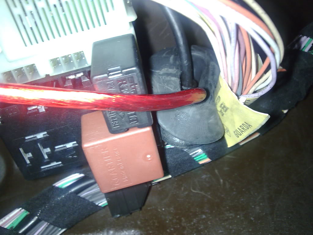

It took us ages mate, we found the grommet (its oval shapped and has a black wire going through it) and to find where it came out (in the engine bay) we put a small screwdriver through.
Once we found that, we put a bigger one through so we could fit the wire through.
Then we attached a length of wire (like a wire coathanger) to the loop on the power cable at the end that connects to the amp. we then fed this through the hole, whilst slowly removing the screwdriver. once it got into the car we pulled it through with pliars to get a better grip.
Now i had it through i ran in it under the carpet through to the boot.
hope that helps, any questions just ask

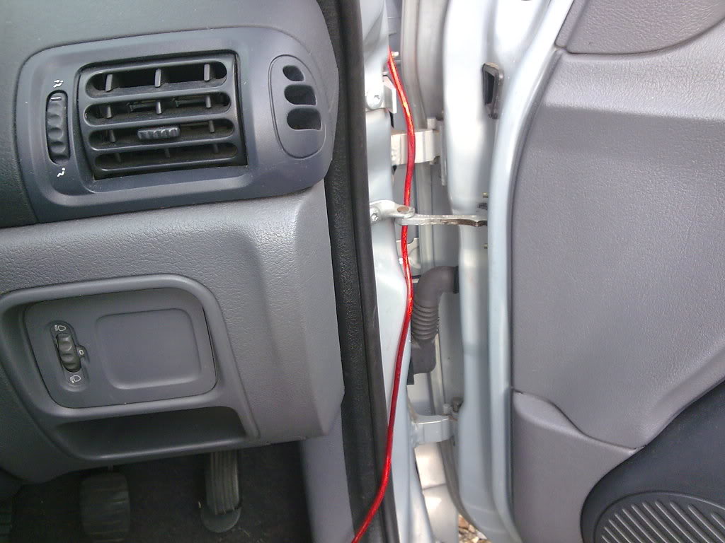

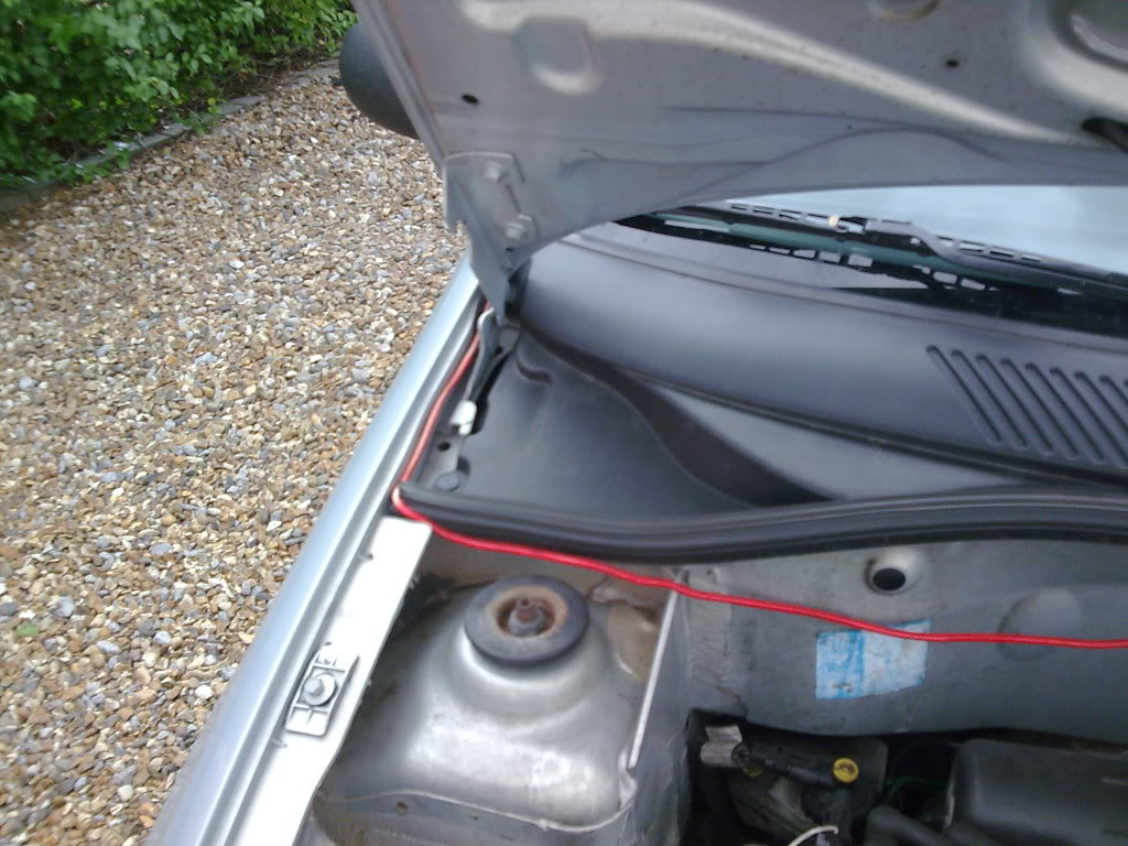

he did it in a rush... and couldnt find the grommet.. he tried putting it in through the grates at the bottom of the windscreen! he then ran the wires over the top of the seatbelts and didnt tuck them away much. he also selotaped the wires into the back of the sub. i had to get someone else to sort it out but obviously he was too lazy to sort out the wiring.

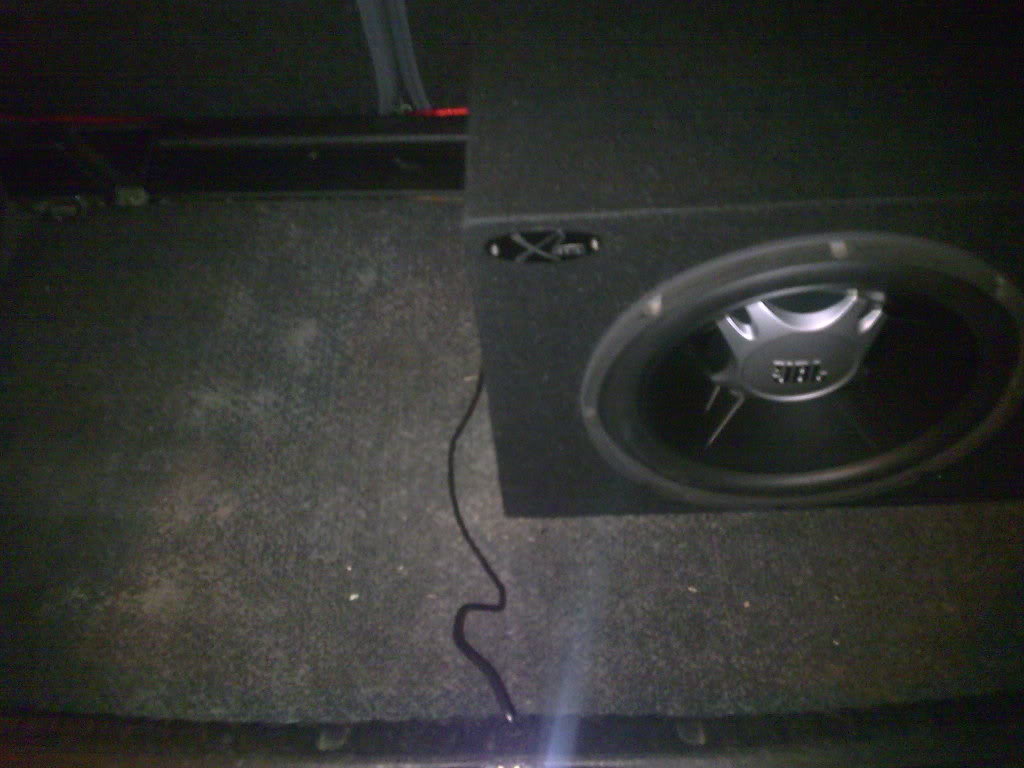

the next step is to sort out the earth cable. it comes out the middle of the trim in the boot... surely thats not right?
  1 Series Coupe
Best place to Earth the amp is the left had bolt that is holding the big black thing down in the boot. Undo the bolt, scratch some paint off underneath. Crimp the correct conector on the end of the earth cable, put in place and do the bolt up.

Where abouts is this grommet located? and hows the best method to find it? Afaik it came out nearer to the skuttle panal!
Is the grommed still undamaged? any noise coming from the passanger footwell?
behind the glovebox. looks like this when i was done

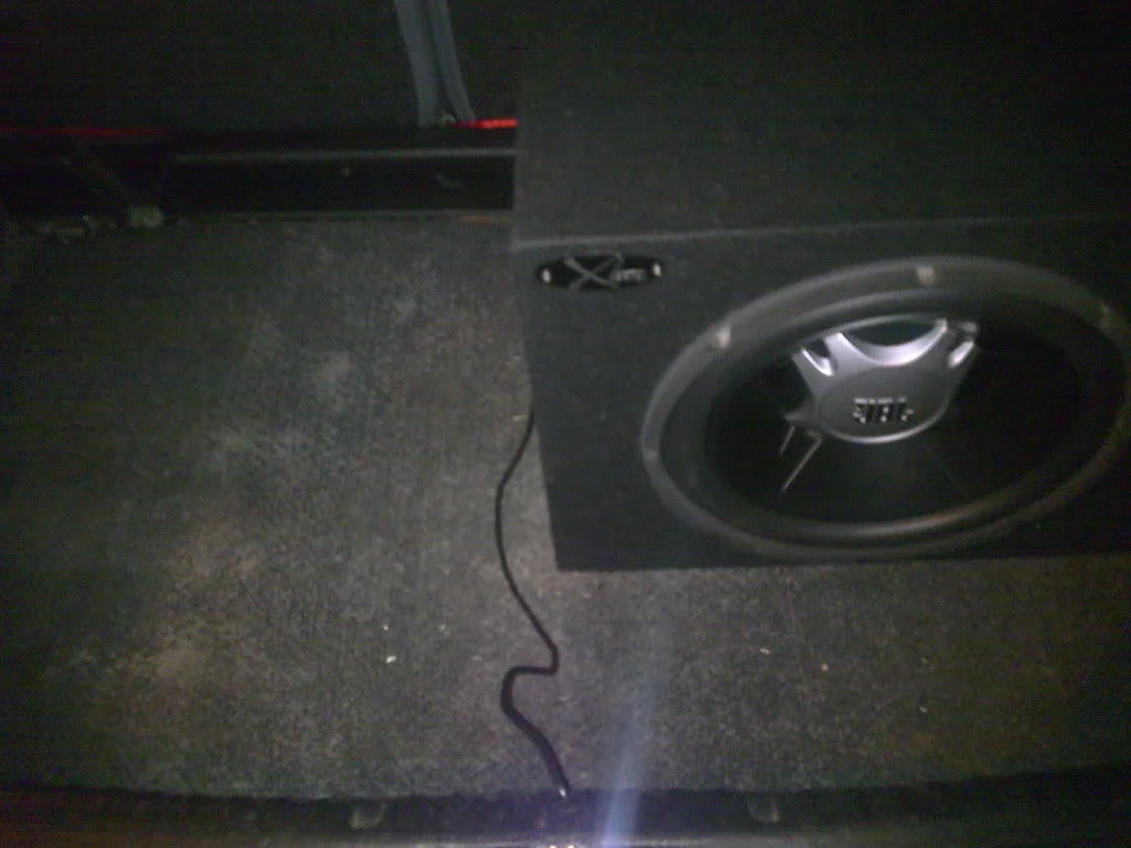

i think i get what u mean... looks like this at the moment:
  MK2 PH1 1.2
Back left of the pic fella, That earth looks wayy to thin! Did it come in the amp wiring kit?
i havent got a clue mate haha... got it back in april/may some time? and as i said i didnt do it myself. didnt look right when it was done though, and i'm trying to tidy it up so i might as well try sort that too.

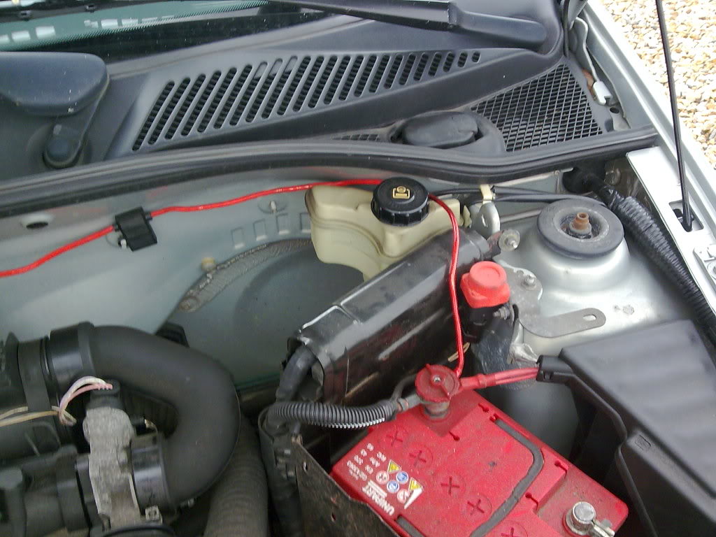

if you unclip the power steering reservoir this makes it a lot easier to get your hands onto the wire as it is thread through the grommet

it isnt hard mate there is just a clip at the top then it slides upwards and it comes free. if you cant bend the clip enough with you hands get a screw driver behind it!

Twist and pull up
You will have to give it a bit of force for it to free up as the chances are its never been unclipped before.

Baaaaaahahahahahahahaahahaha!!! Just seen that first pic. I hope you killed your mate for doing that!

please dont tell me that black wire running across the boot is for the earth? lol
if it is, remove it, theres an earth directly along the back seats, undo the big bolt and use that as your earthing point, and as everyone else has said, that first wiring picture is awful! lol, the clio is really easy to do, theres a guide somewhere for where the wire can go through the bulkhead
