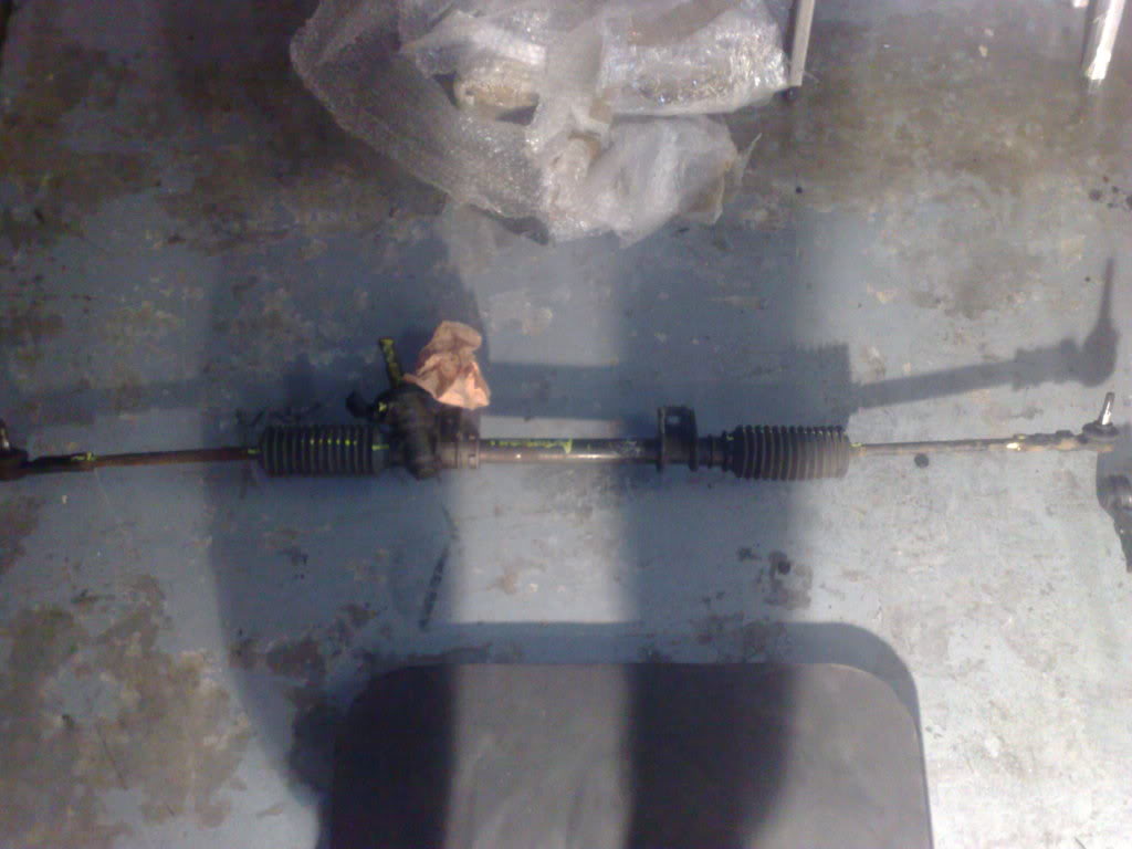

i just got a manual steering rack of an 04 clio, well thats what the scrappy said. it is immaculate and still has the sticker on it with loads of numbers
they are
JALY x65 DMDE <373>
69 00 001 703
6017030001227
82 00 891 309
can anyone confirm if this is the correct rack? it is to fit on a 182 so will i also need to put on the 182 track rods and track rod ends?
it was only £50 so it seems a bargain if its correct!
thanks to anyone that can help!

hi jacking the thread slightly, but why would fitting a 1.2 rack onto a 182 give faster steering? are the steering arms shorter on the 182 or something?
sorry for the dumb question
  clio 182
It won't, its slightly slower but nothing noticable I don't think! It is purely to get rid of pas when using a volvo set up etc
