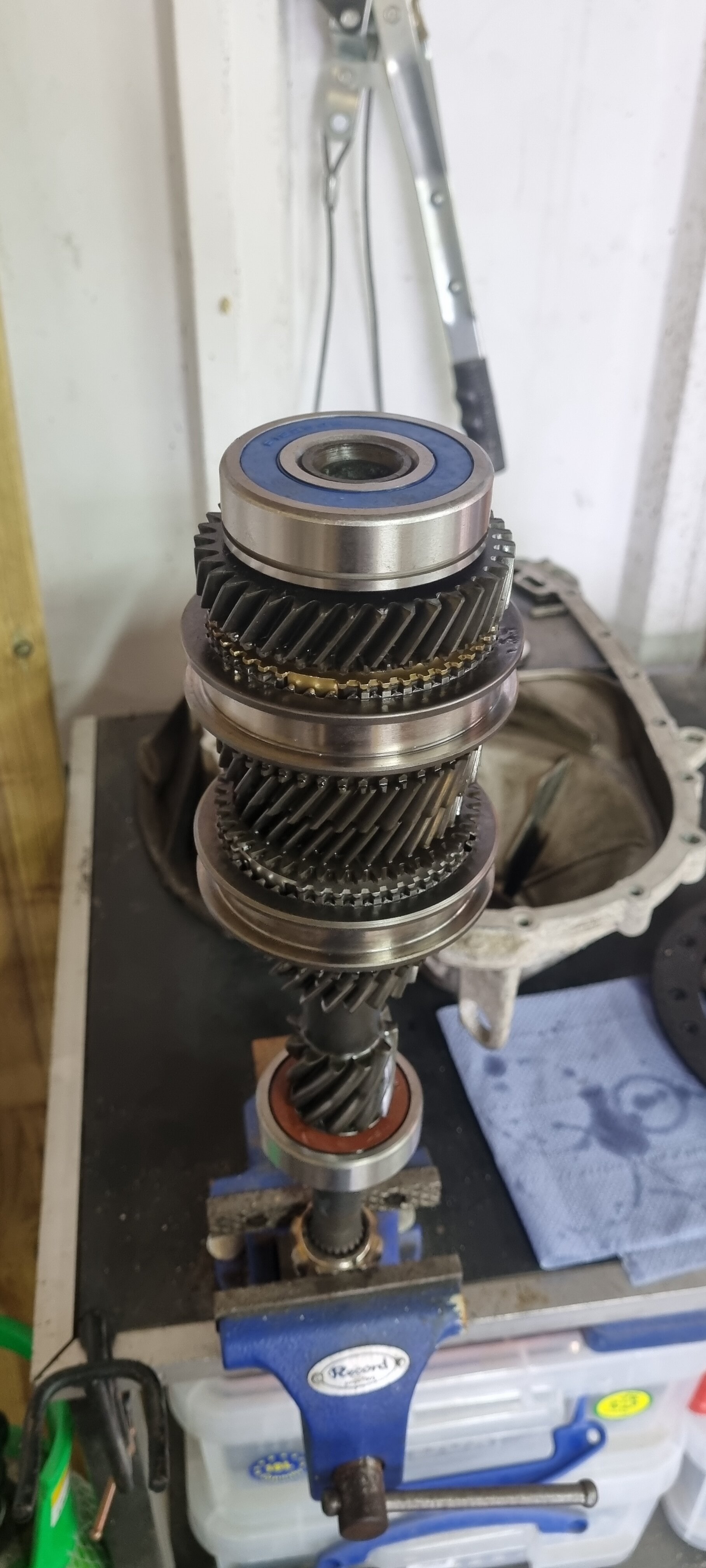

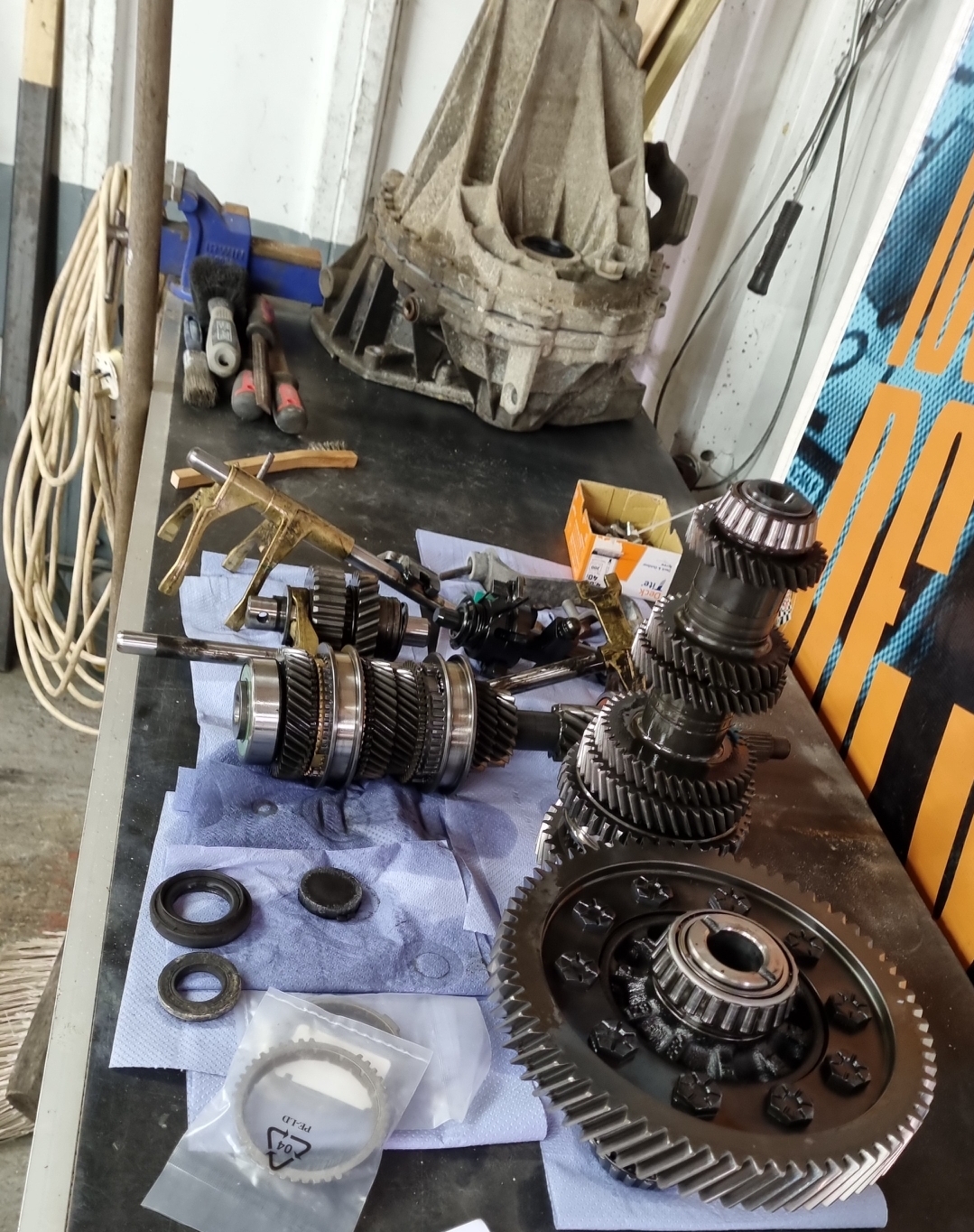

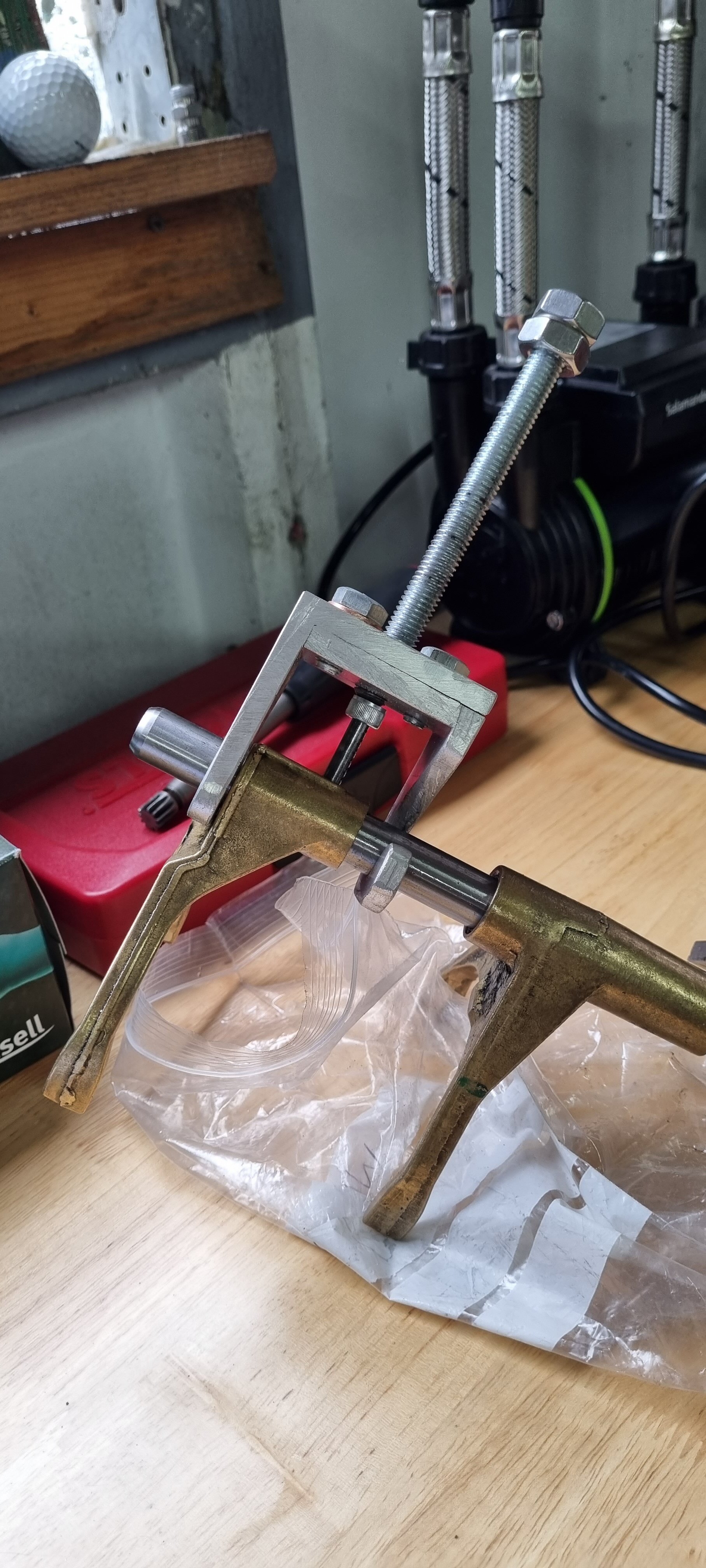

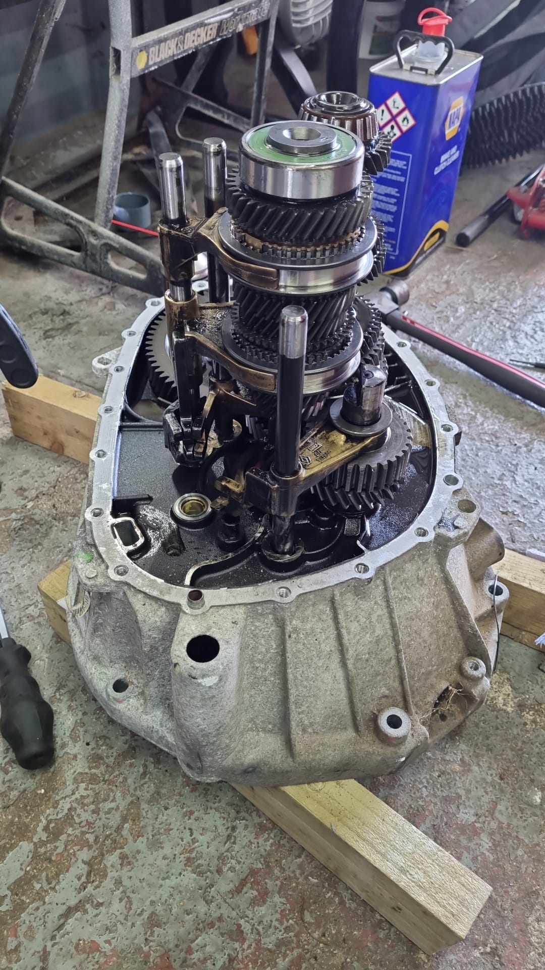

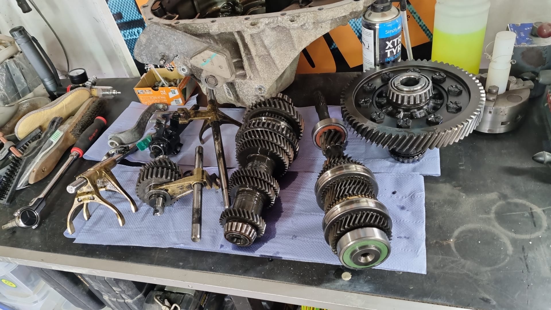

I've had a 200 box with the shorter 1-3rd gear ratios for this for a while with new synchro's to fit and a new clutch to fit at the time but never got round to it until my Mrs used it for ONE DAY and managed to break it!!!!! in her defence the slave cylinder failed and she lost the clutch pedal so i pulled it home on a tow pole on the back of the kangoo work horse and dumped it at my house to come back to another day.
The legend @aldo_87 is doing the synchro's for me as he's got more experience than my zero!
Surprize surprize the syncros are on their way out on that box too, the guy I bought it from did say they were ok! but obviously i was going to change them anyway.

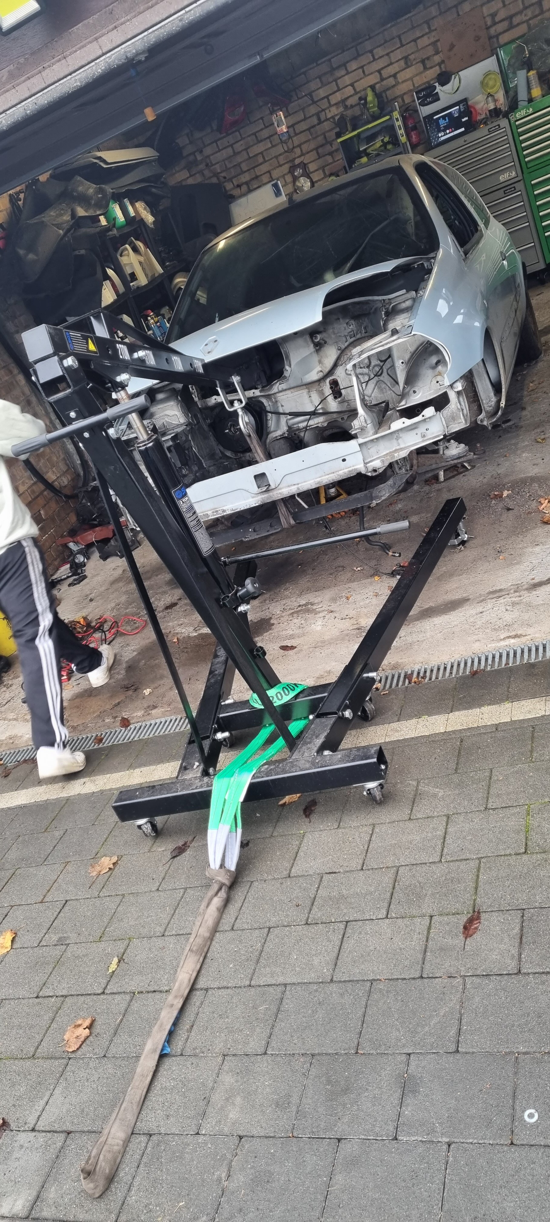

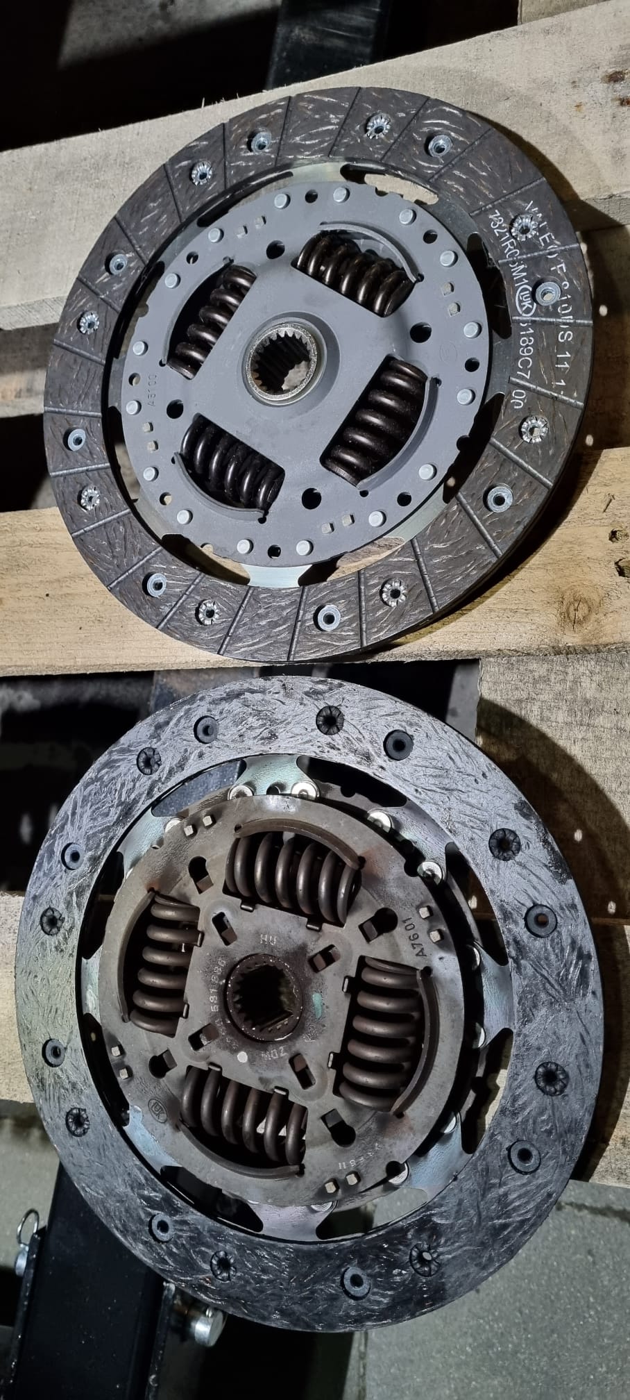

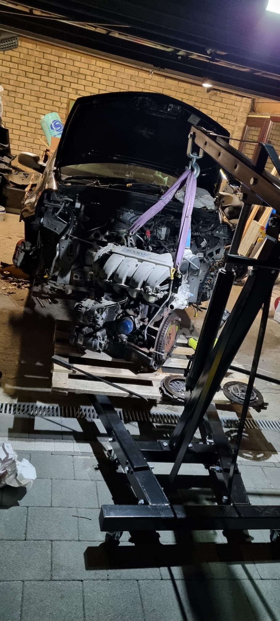

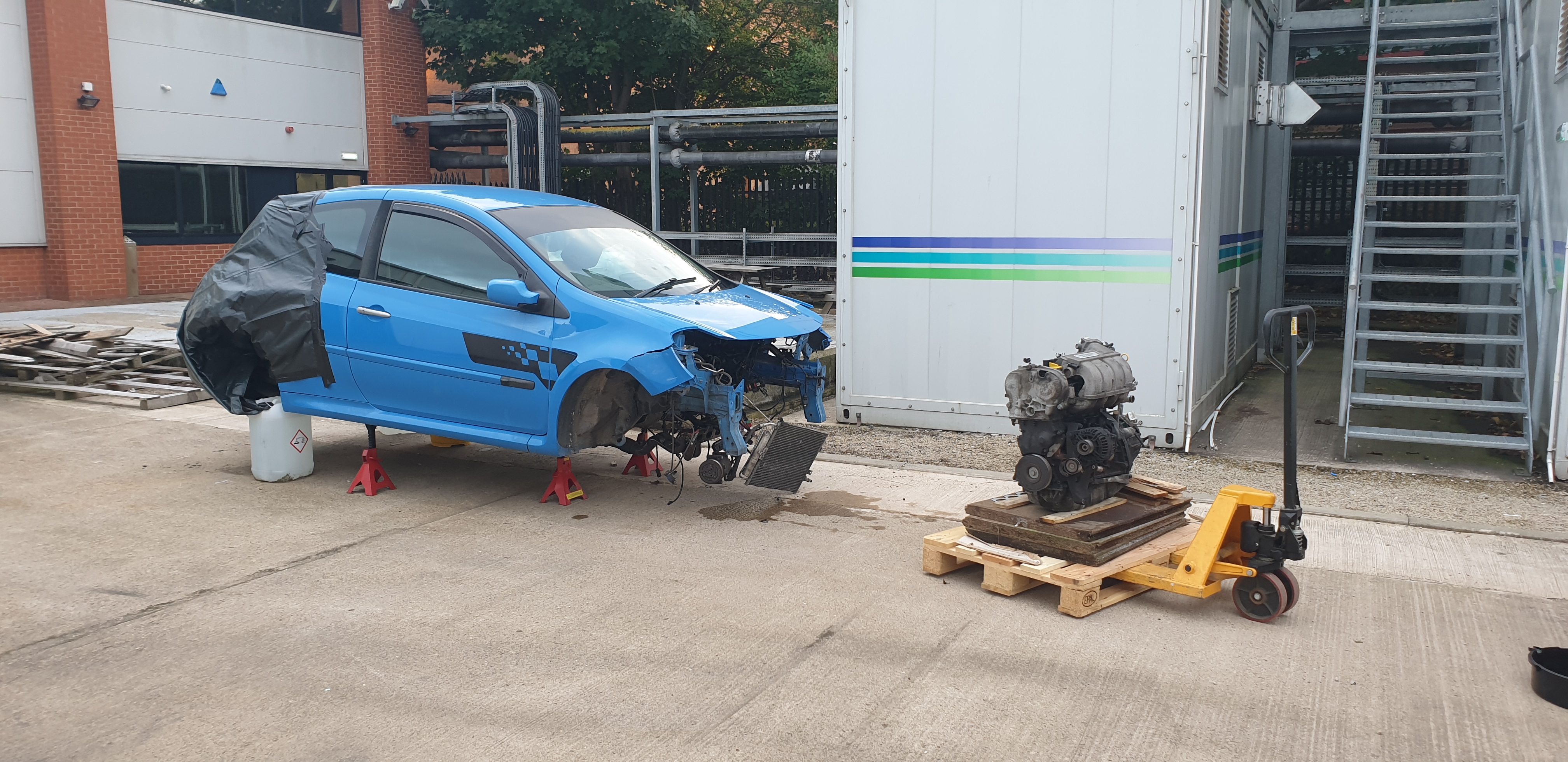

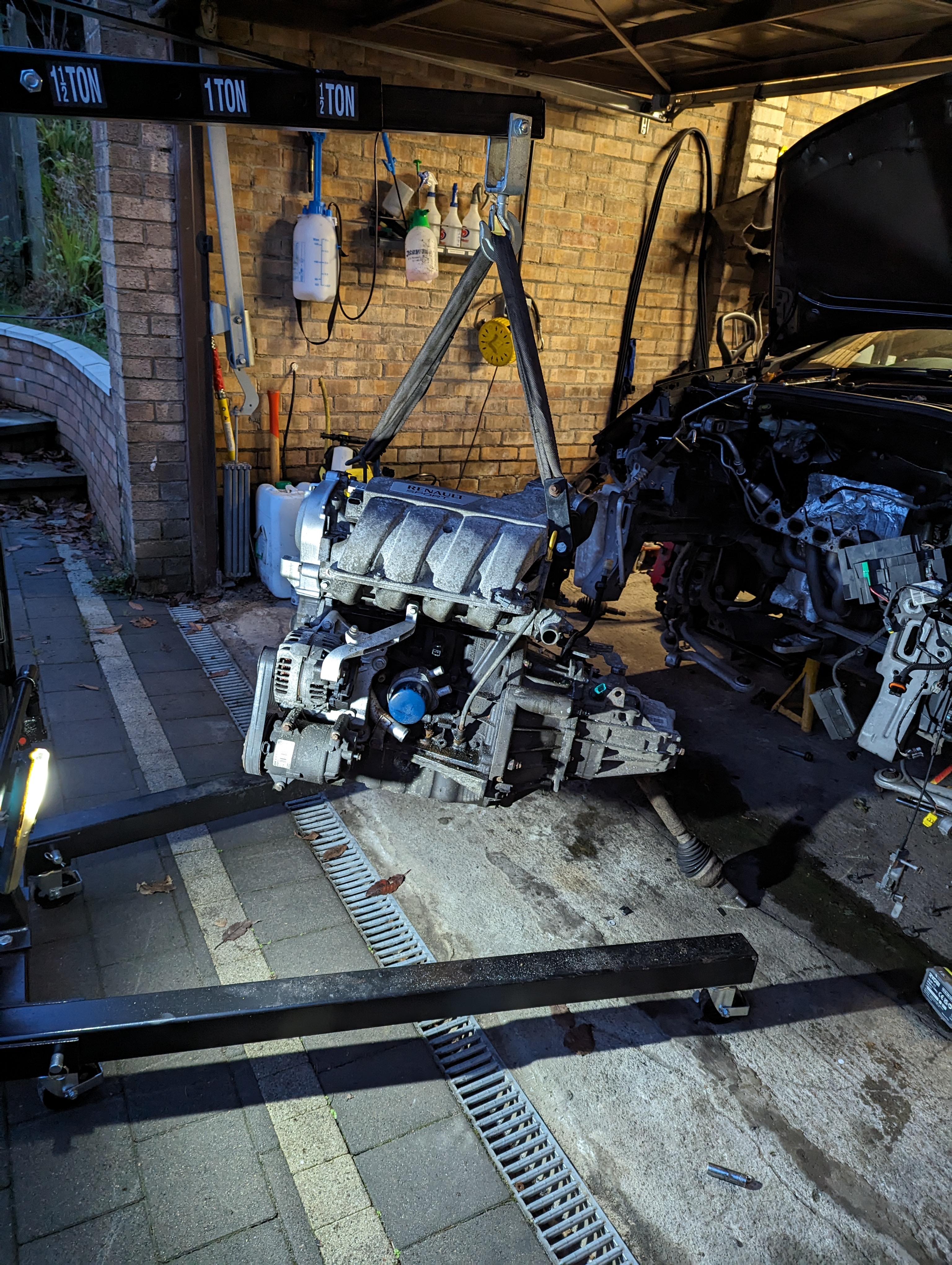

This morning i went out with the intention of pulling the box to swap the clutch over ready for the box being finished but things got out of hand quickly when i decided i may as well pull the engine and box in one go and do the belts since they are long overdue (and it has a dodgy looking crankshaft damper pulley)

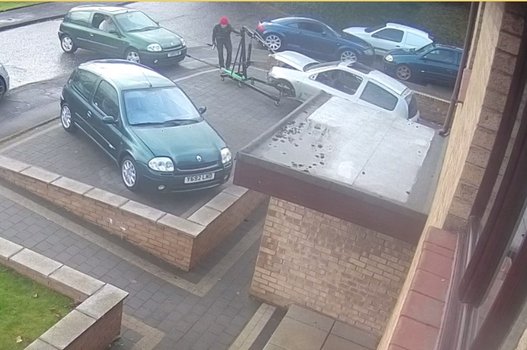

I usually borrow an engine hoist from next door but decided its probably about time i had my own so its due Tuesday and ill finish the rest, ive just got the shafts to come out, gear linkage to remove and she should slide right out!
There's no warranty on the box btw... 🤭
Martin_172

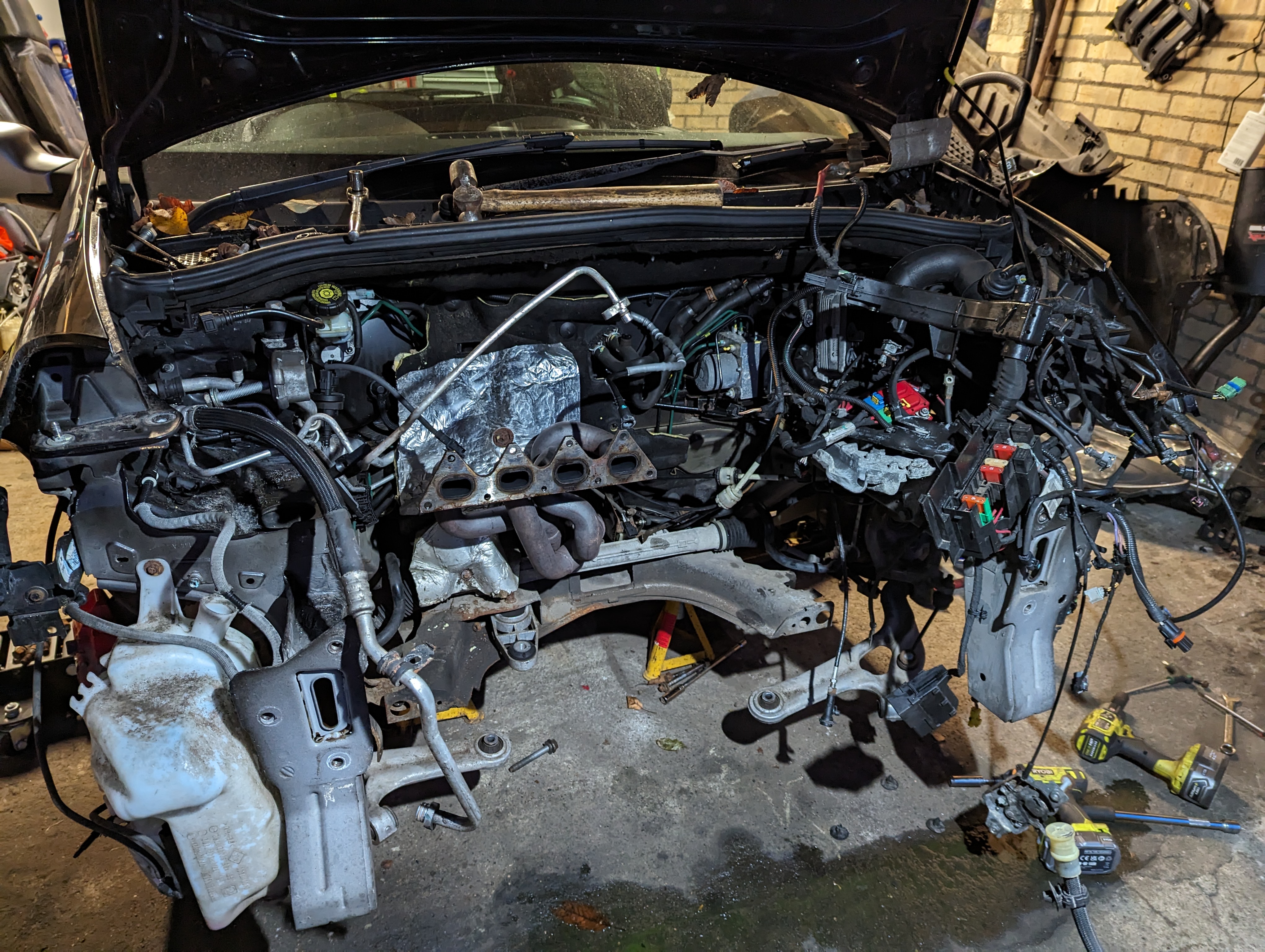

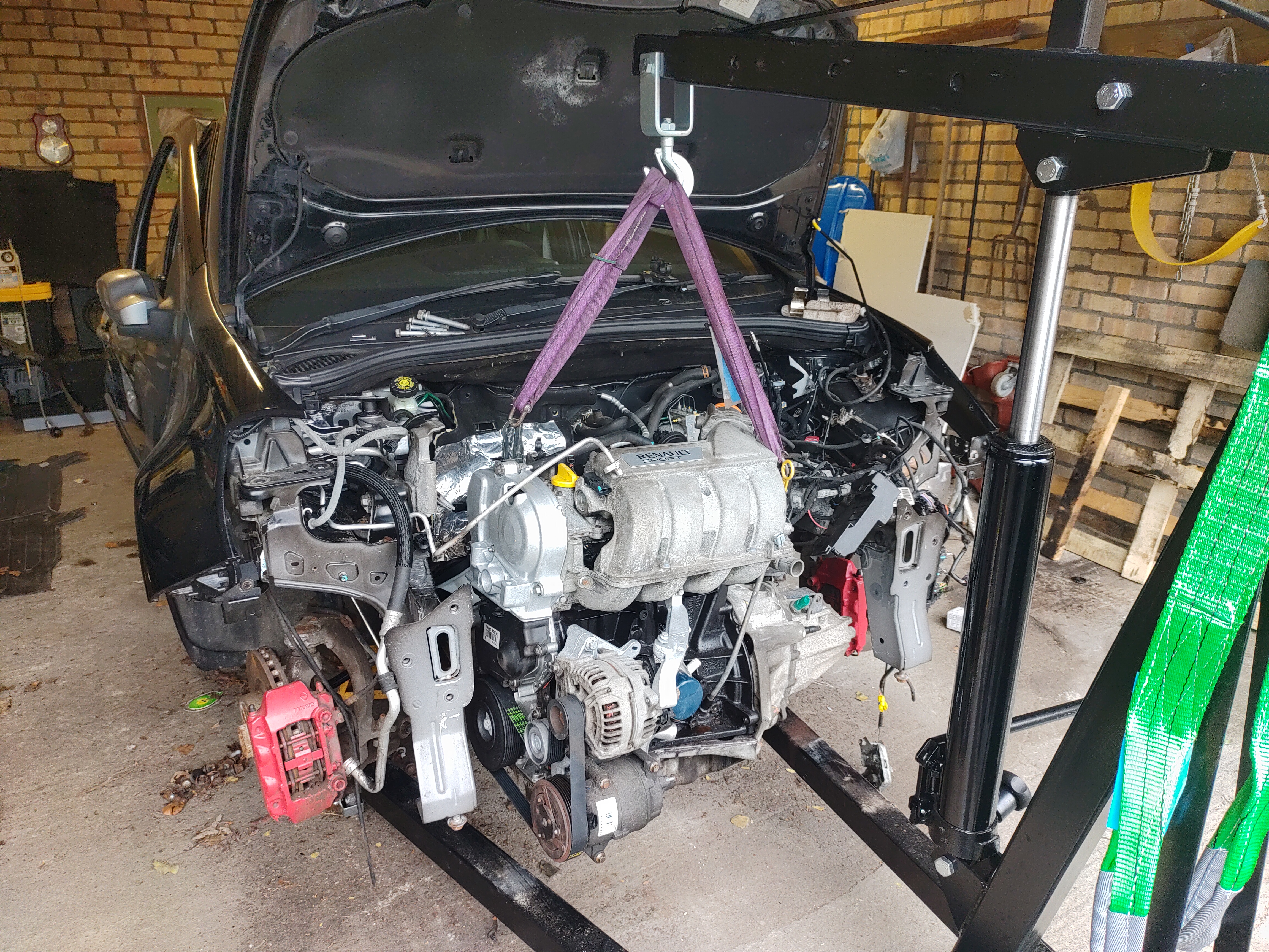

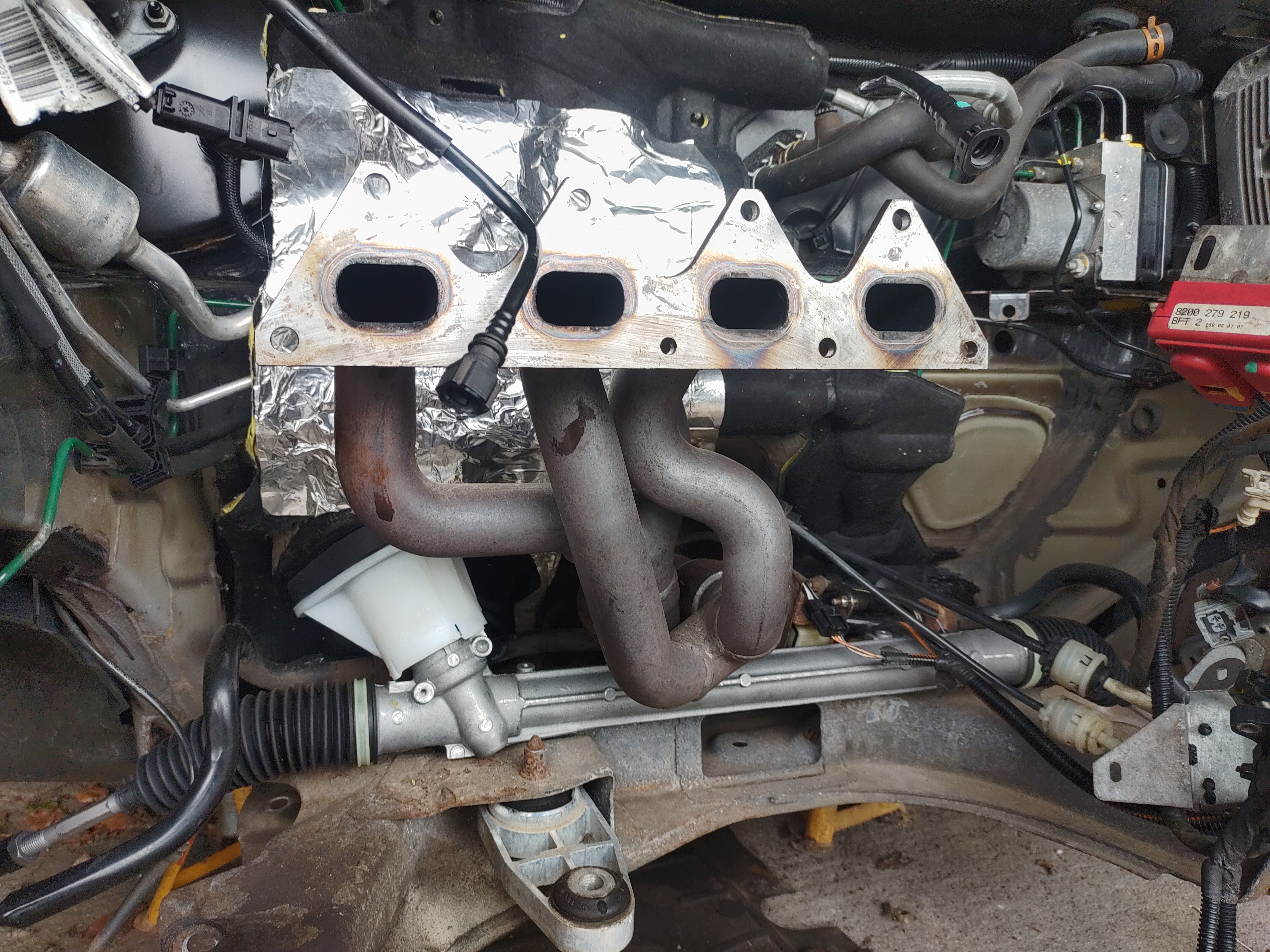

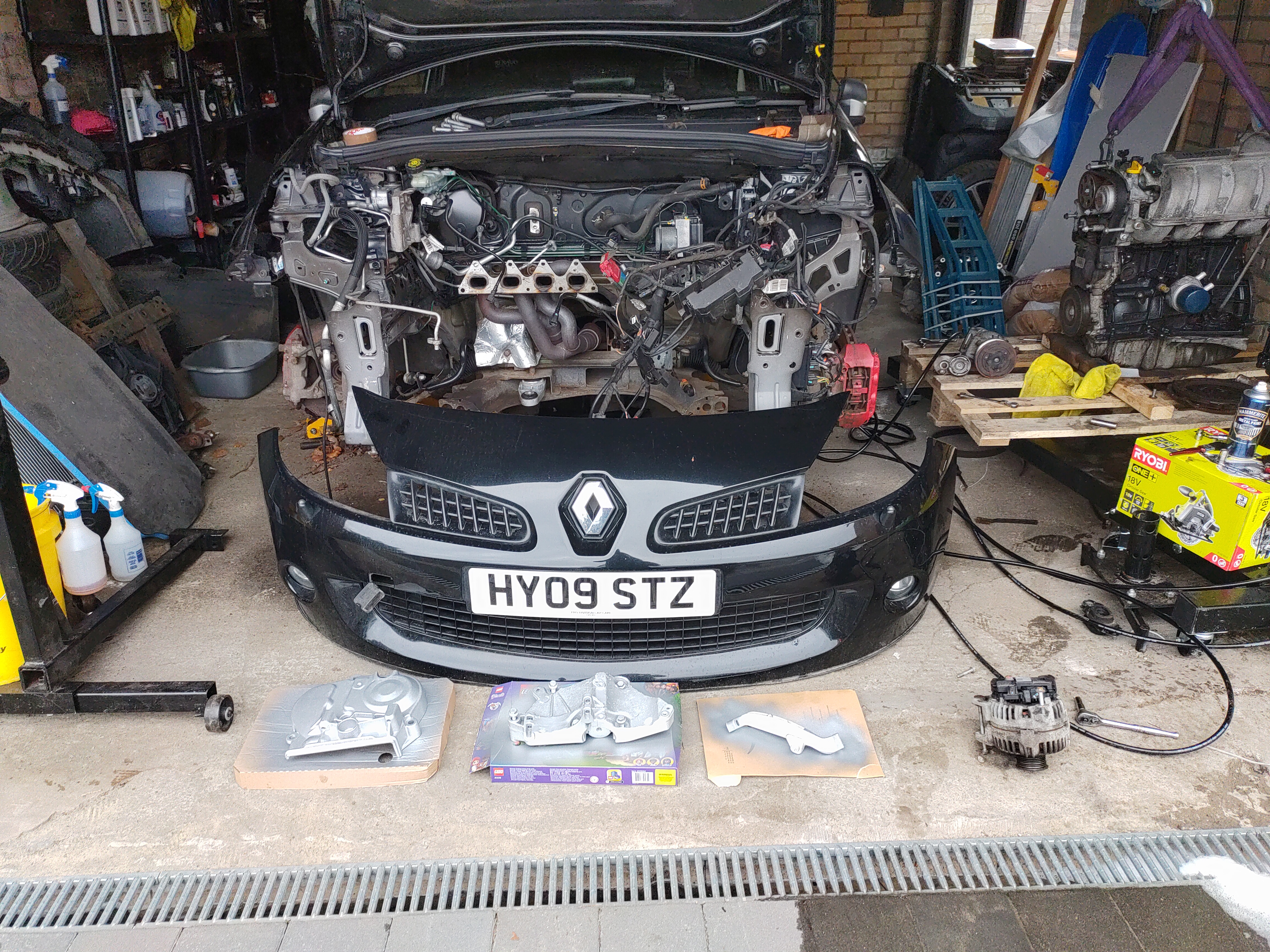

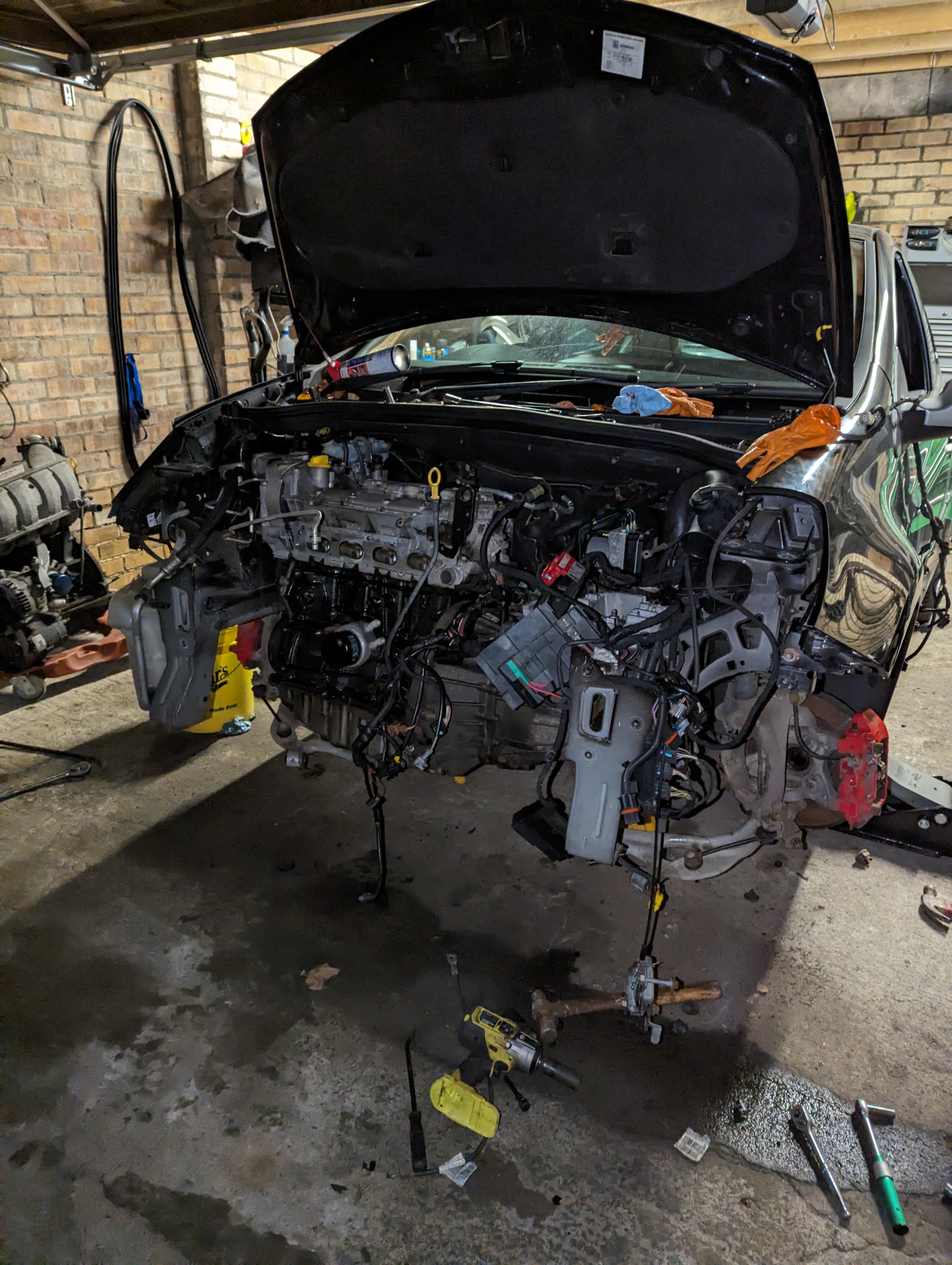

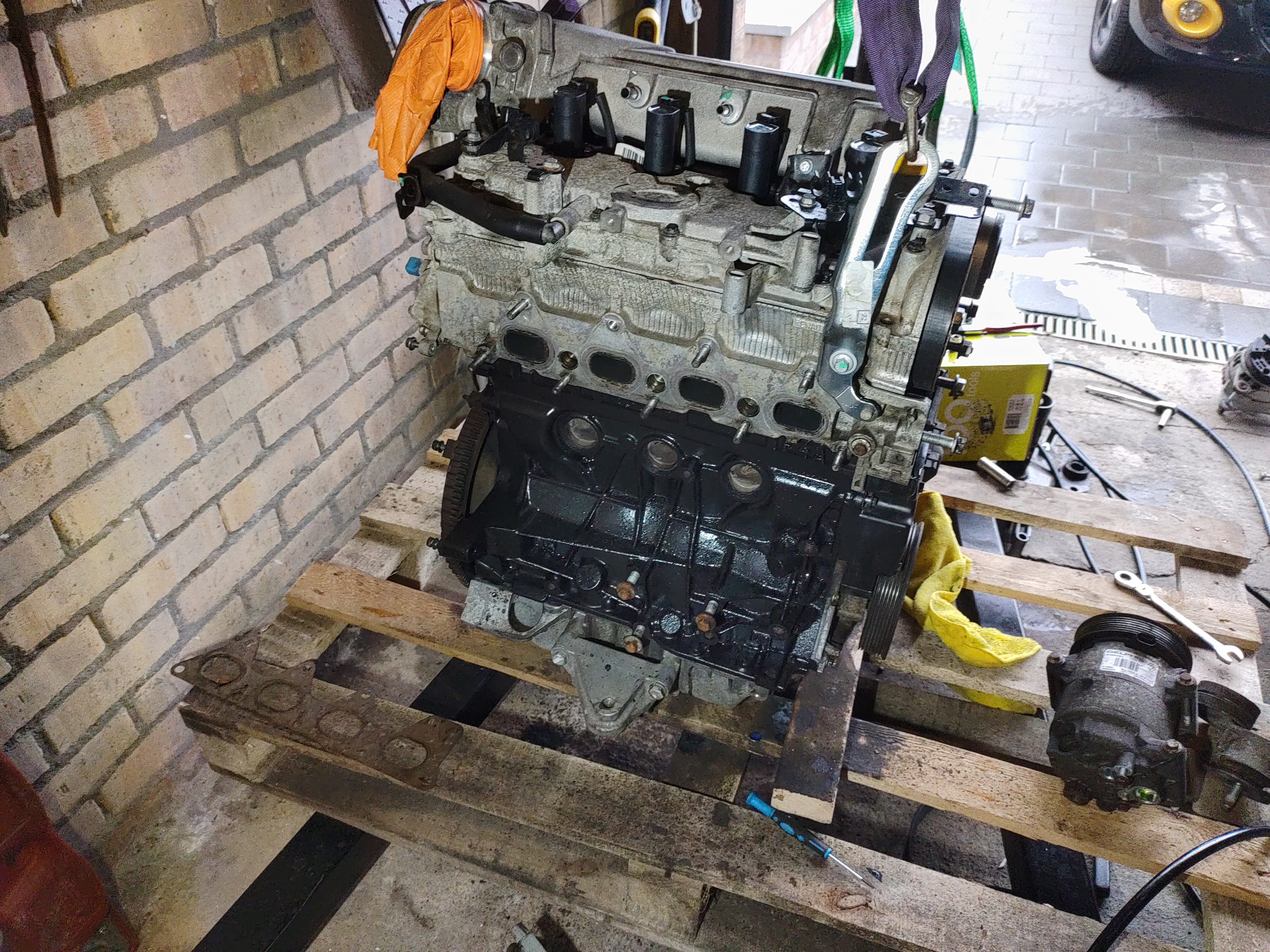

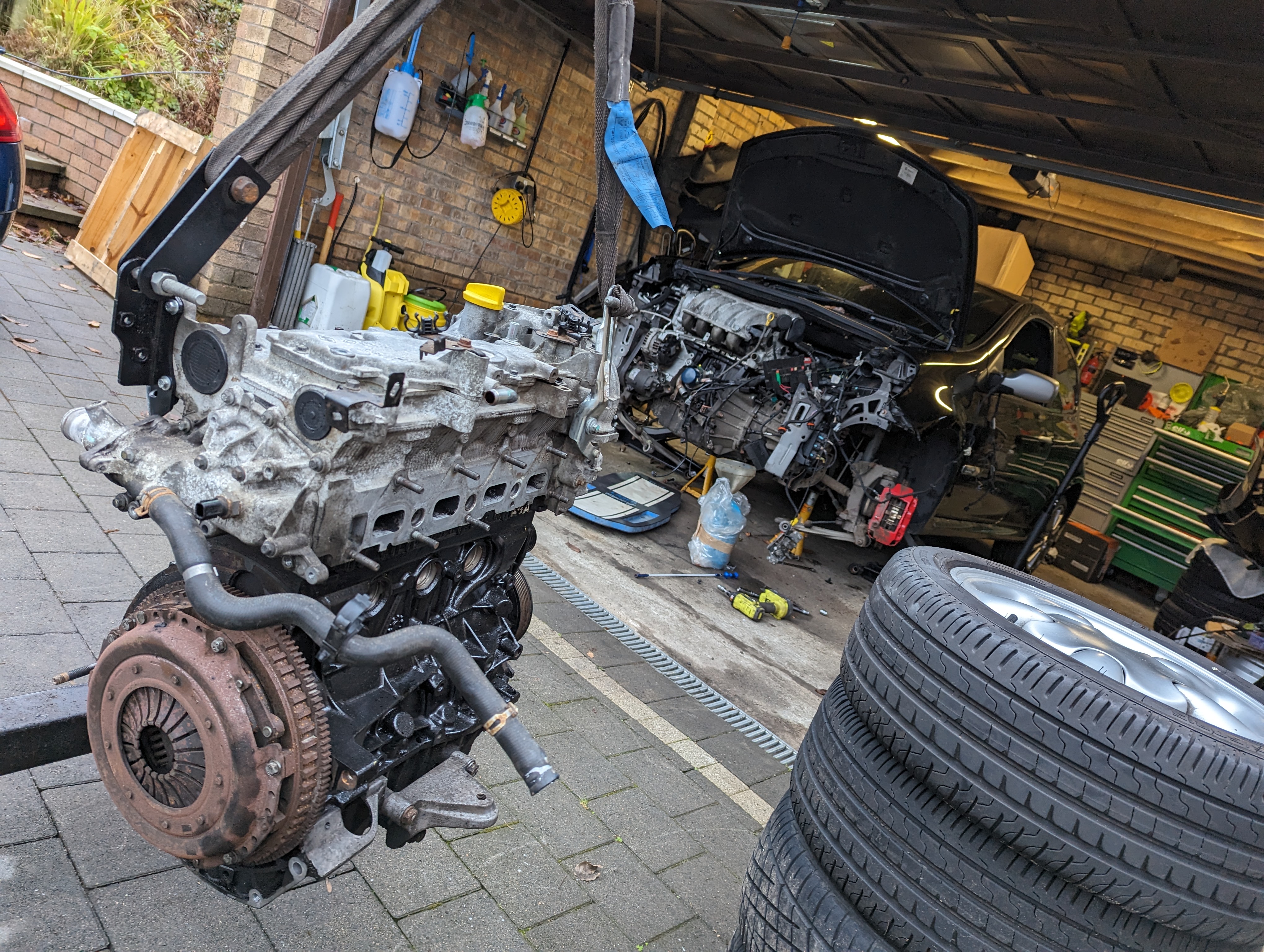

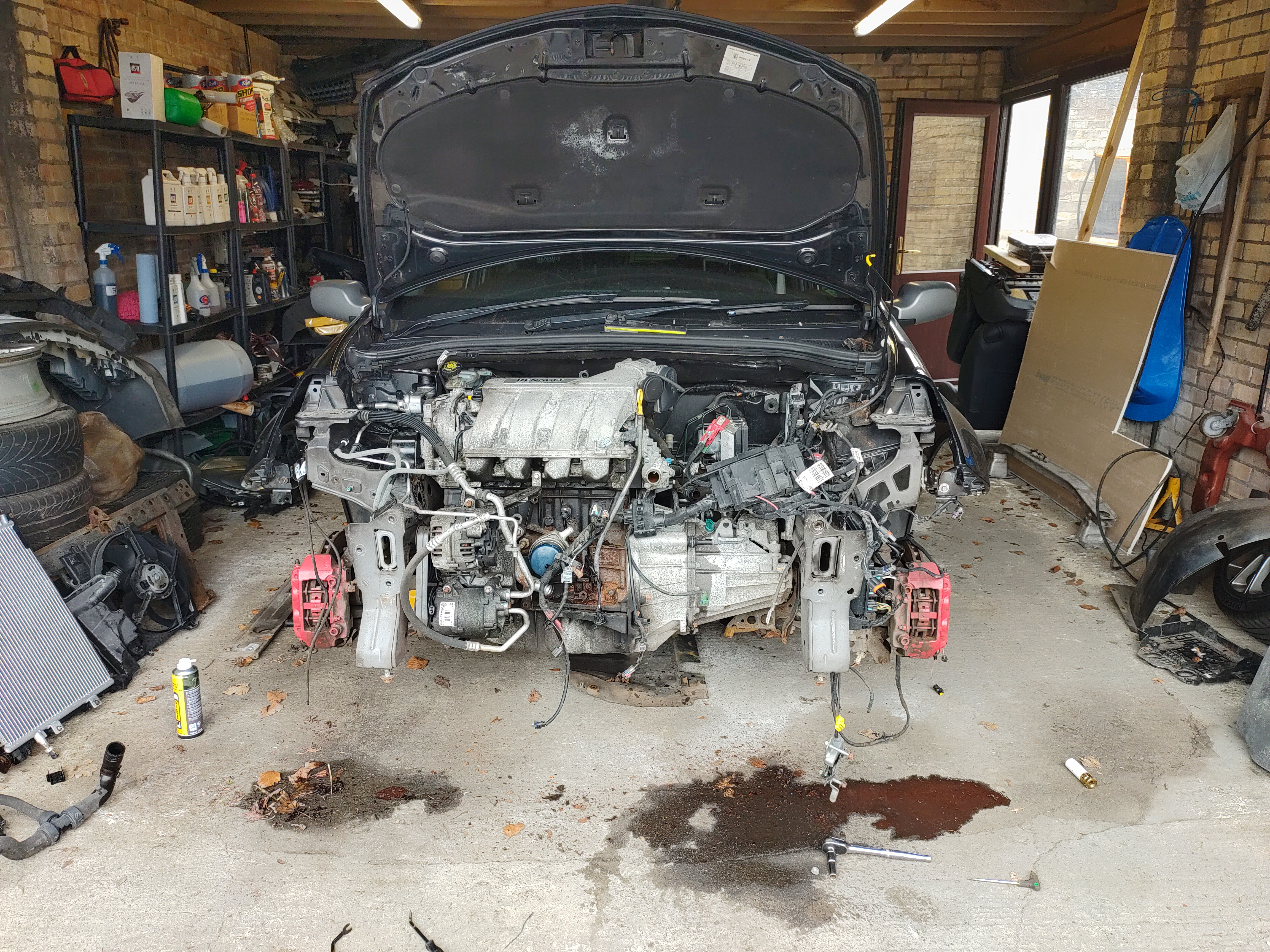

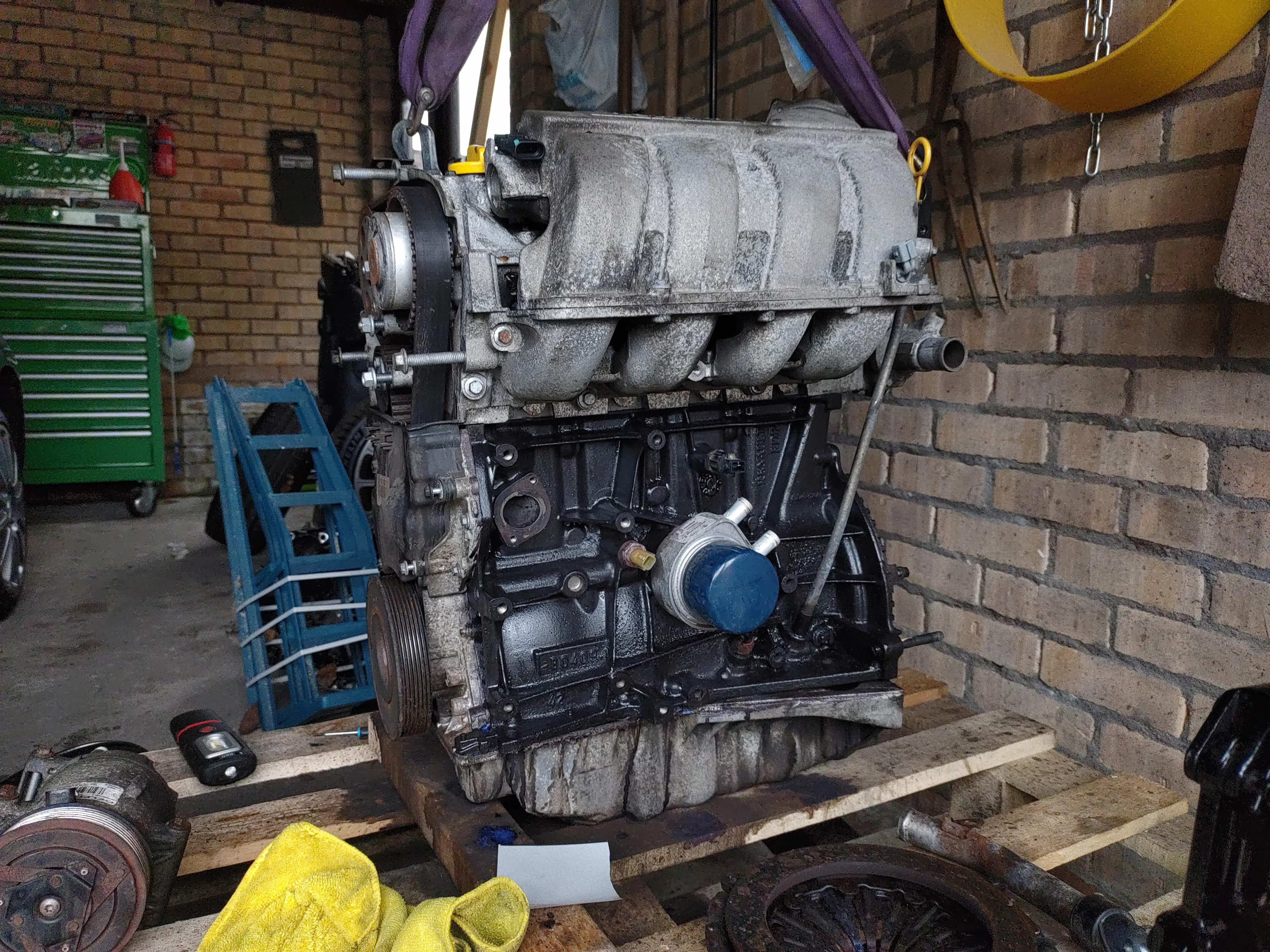

Been ticking away at this when I get time between other jobs!
5hrs from starting to having the engine and box out I was quite happy with!
Slave cylinder was leaking which was the cause of the loss of clutch pedal as expected, looks like its never had a clutch in its 80k miles and wasnt far away from needing done anyway!

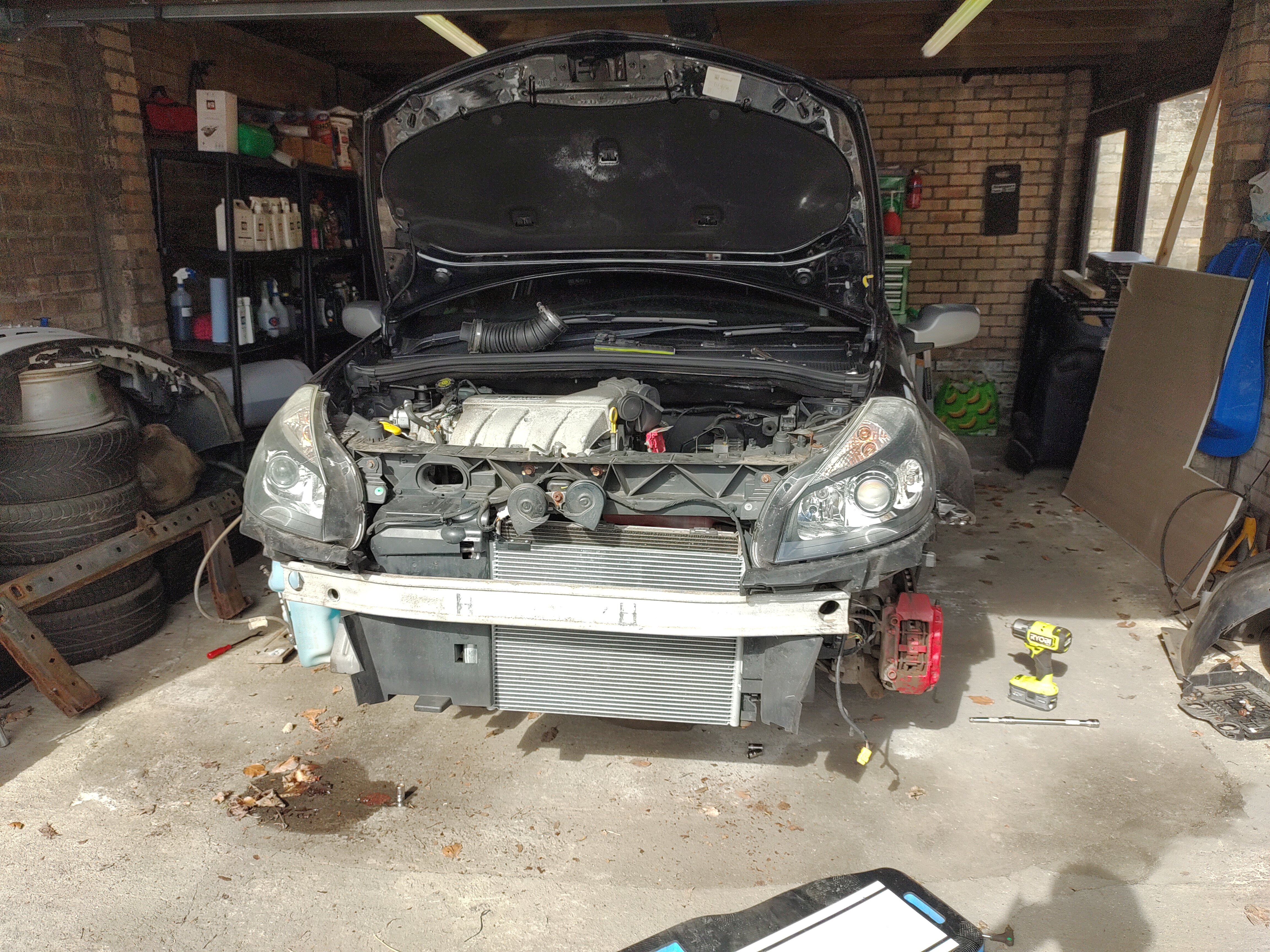

Cleaned up the bay, I'm on the hunt for a new or good condition sound deadening for the rear of the bay as it was disintegrating . Also painted the alternator brackets, mounts and timing cover to give it a fresh look when its back together!
Gave the engine block a paint too while i was at it, Ill pull the inlets off and clean everything else up once its back in the bay.
Going to do the belts, and clutch this week. @aldo_87 shouldn't be far away with the gearbox and it can go back in!

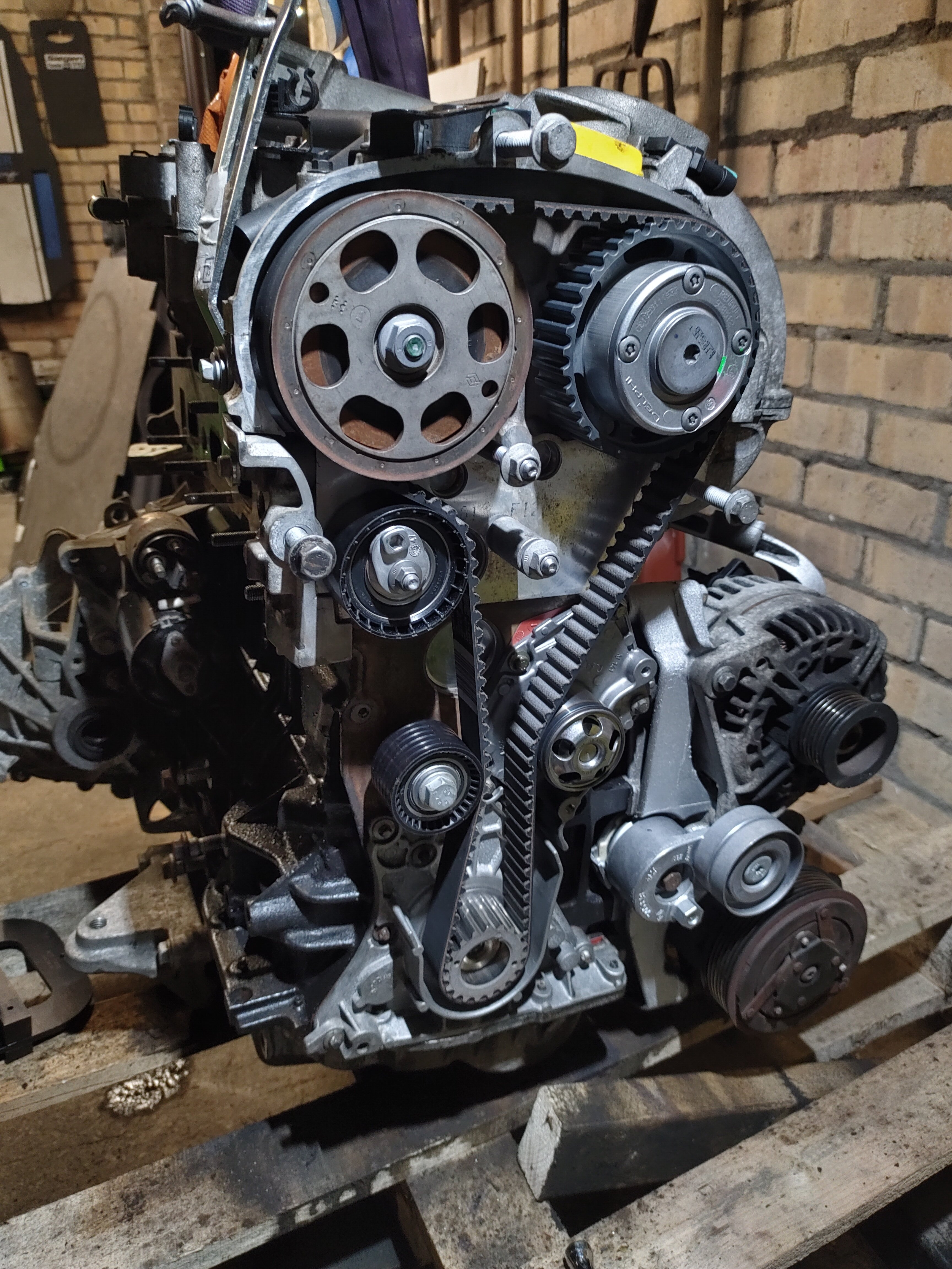

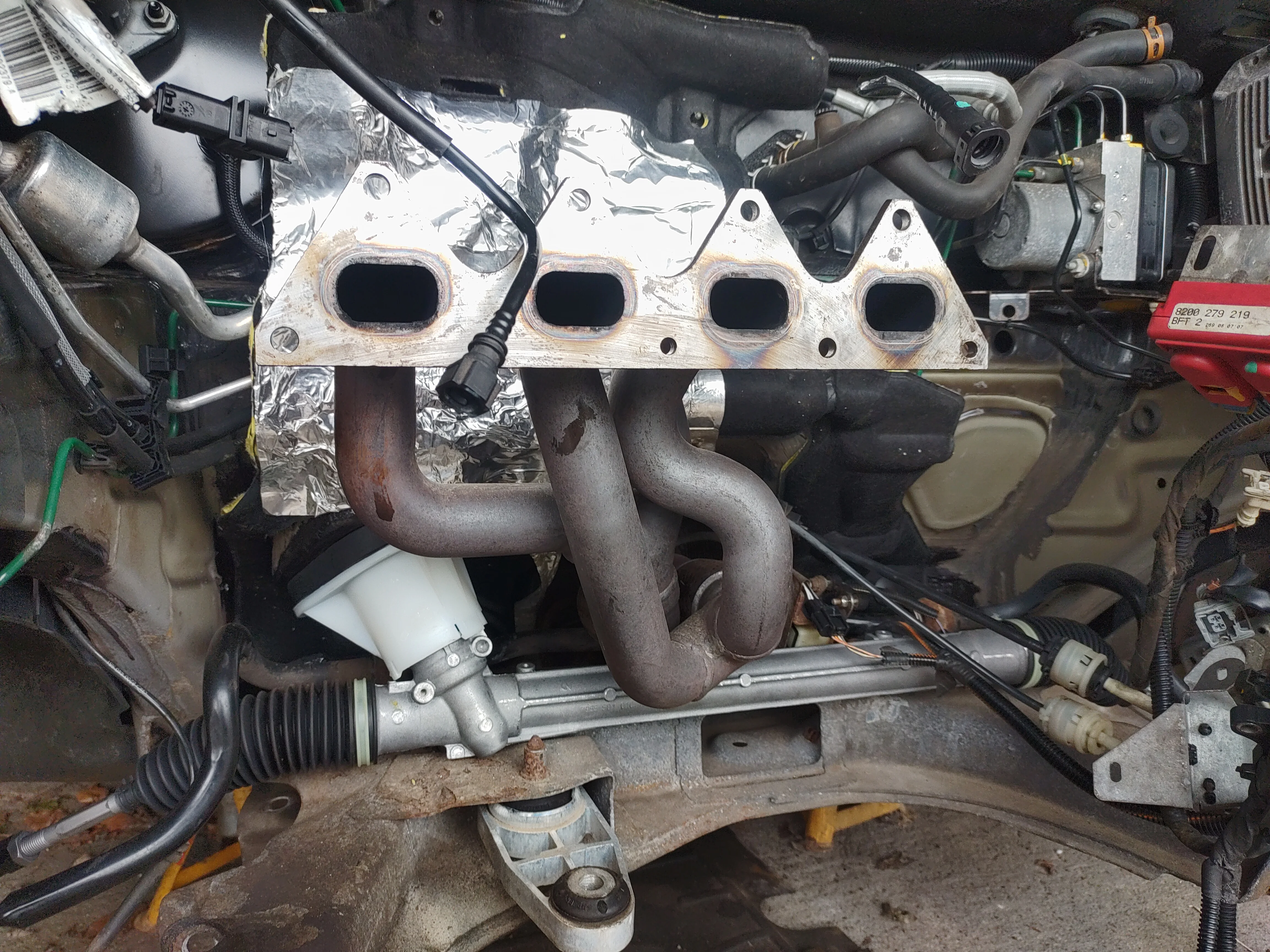

Finally back together, I hadn't ordered the camshaft seals, but the exhaust one was weeping slightly so I changed them, so that was a delay.
I couldn't get the crank sprocket off (if I knew it was keyed I wouldn't have bothered taking it off!!!) so had to use a bit of heat so wanted to change the crankshaft seal so that was another delay.
I managed to put a little crack in the ring round the crank sprocket when removing, so that was ANOTHER delay!
But finally everything arrived so that was tonight's job, All timed up and back together. This was the first time I've ever done an F4R belt so was much easier getting my head around it out of the car!, took me 3 attempts to get it spot on where the horseshoe would slide in perfectly.
so all together the car has had:
  • Cambelt kit
  • Waterpump
  • aux belt kit
  • dephaser
  • camshaft oil seal kit
  • crankshaft oil seal
  • crank sprocket
  • crankshaft damper pulley
  • exhaust manifold gasket
  • 3rd and 4th gear synchros
  • input shaft oil seal and driveshaft oil seals
  • a few gearbox bearings

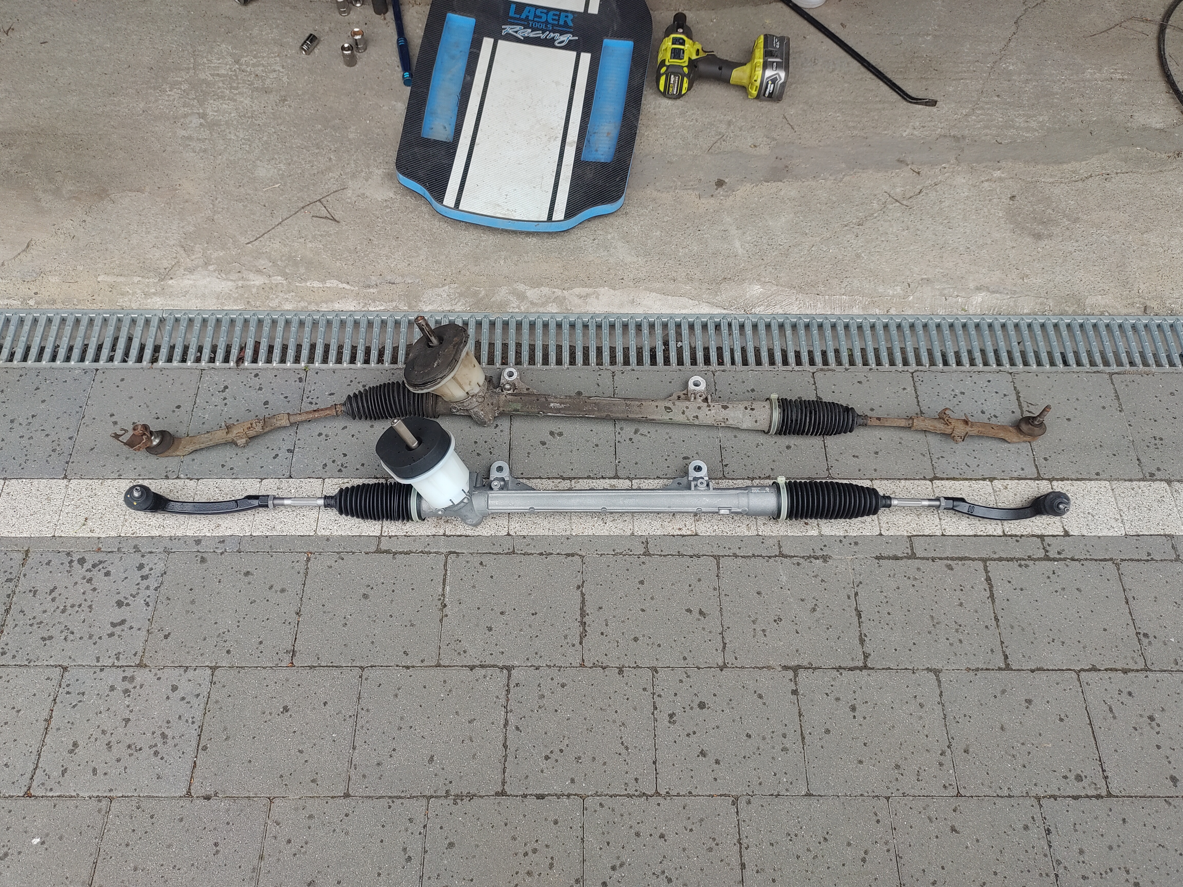

I'm waiting on a new 200 cup steering rack coming since the car has full 200 cup suspension, along with, now, a 200 cup gearbox with shorter 1st, 2nd and 3rd gear ratios so I may as well complete the full package!, Also i got new sound deadening material for the rear of the engine bay as the old stuff was falling apart and the steering column goes through it so I may as well remove the rack to swap it all over properly without cutting it!
Lets hope she doesn't go bang when I turn the key ;)..........

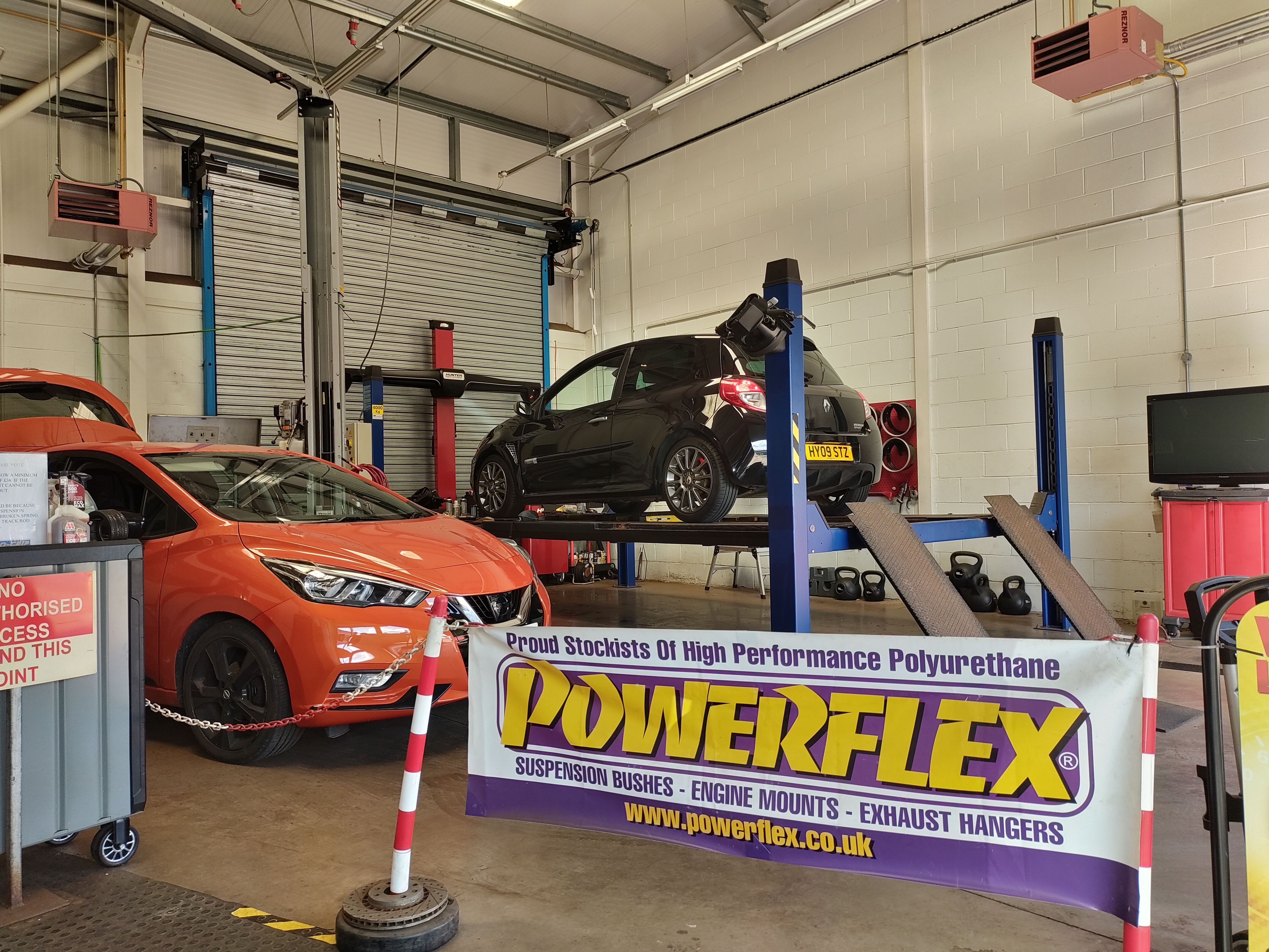

Martin_172

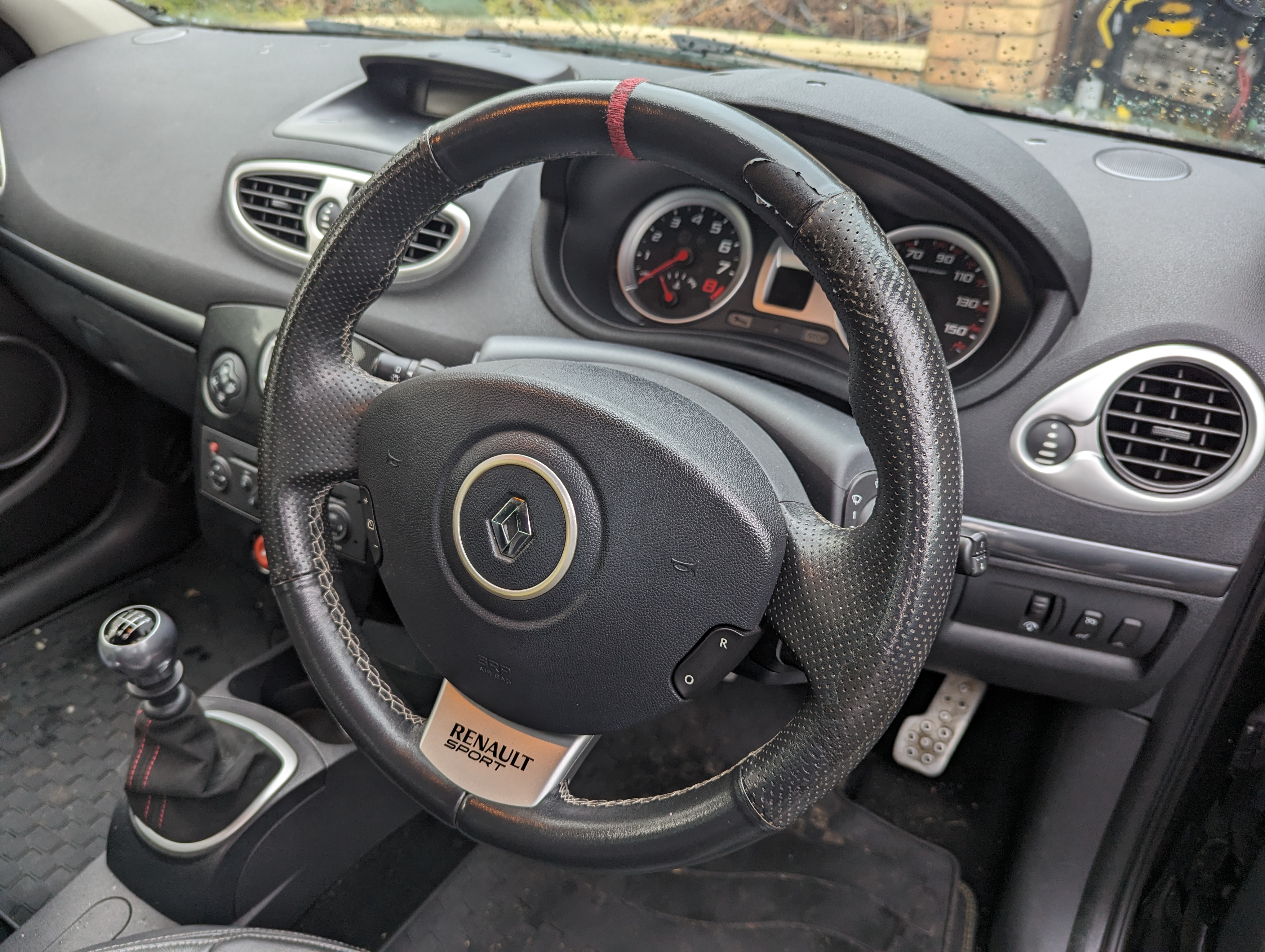

I don't know how I managed to set my camera to some mad Instagram like mode with blurring backgrounds that the kids all use today but here we go! SHE RUNS! and runs well! its like a new car, the engine is super quiet (I had loads of rotational noise from the noisy water pump, worn damper pulley and worn aux tensioner)

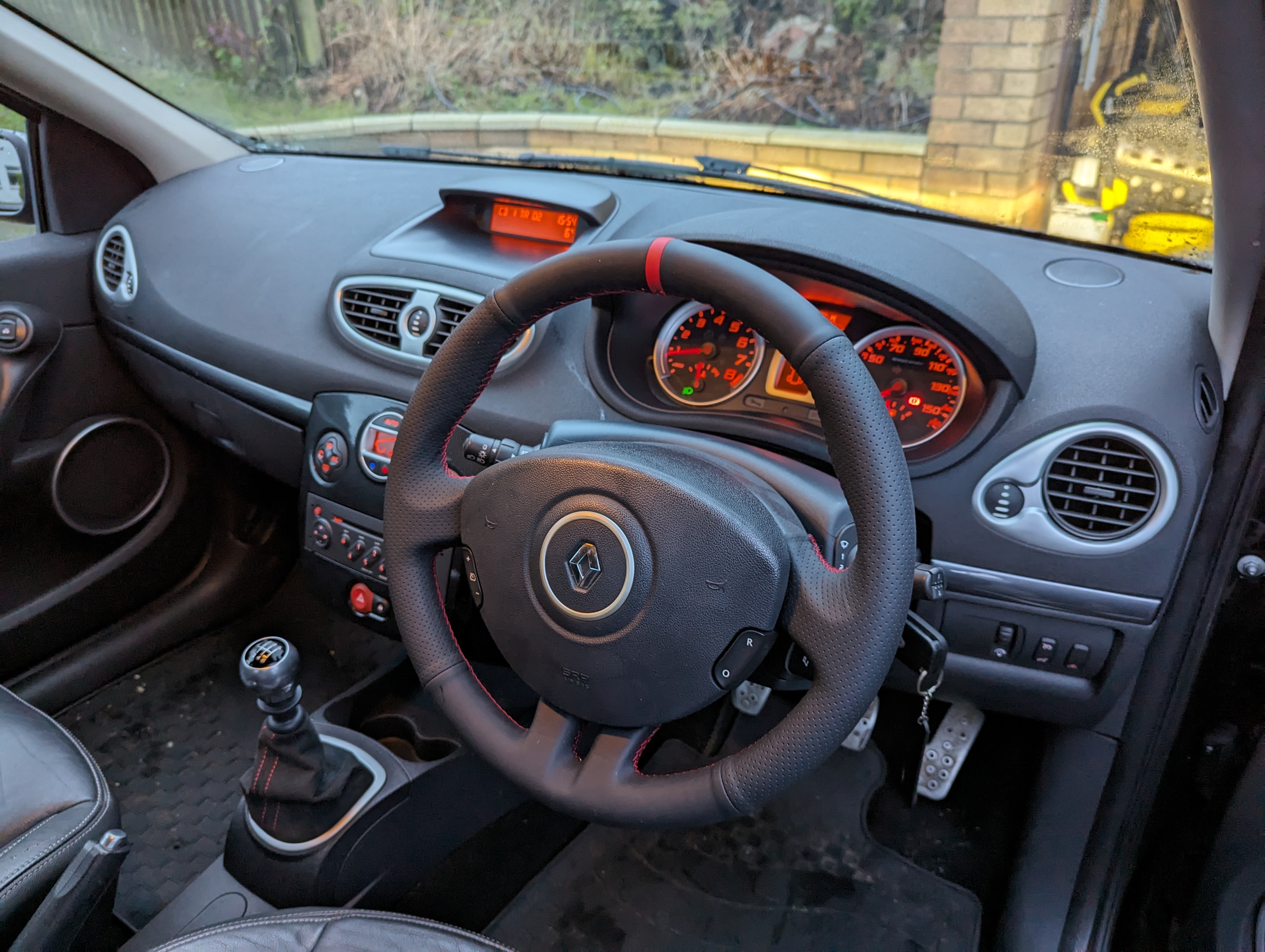

Steering feels lovely with the fresh rack, alignment is slightly out as I done it by eye, but its booked into ProGrip a week today to get setup, then a fresh MOT!
Martin_172

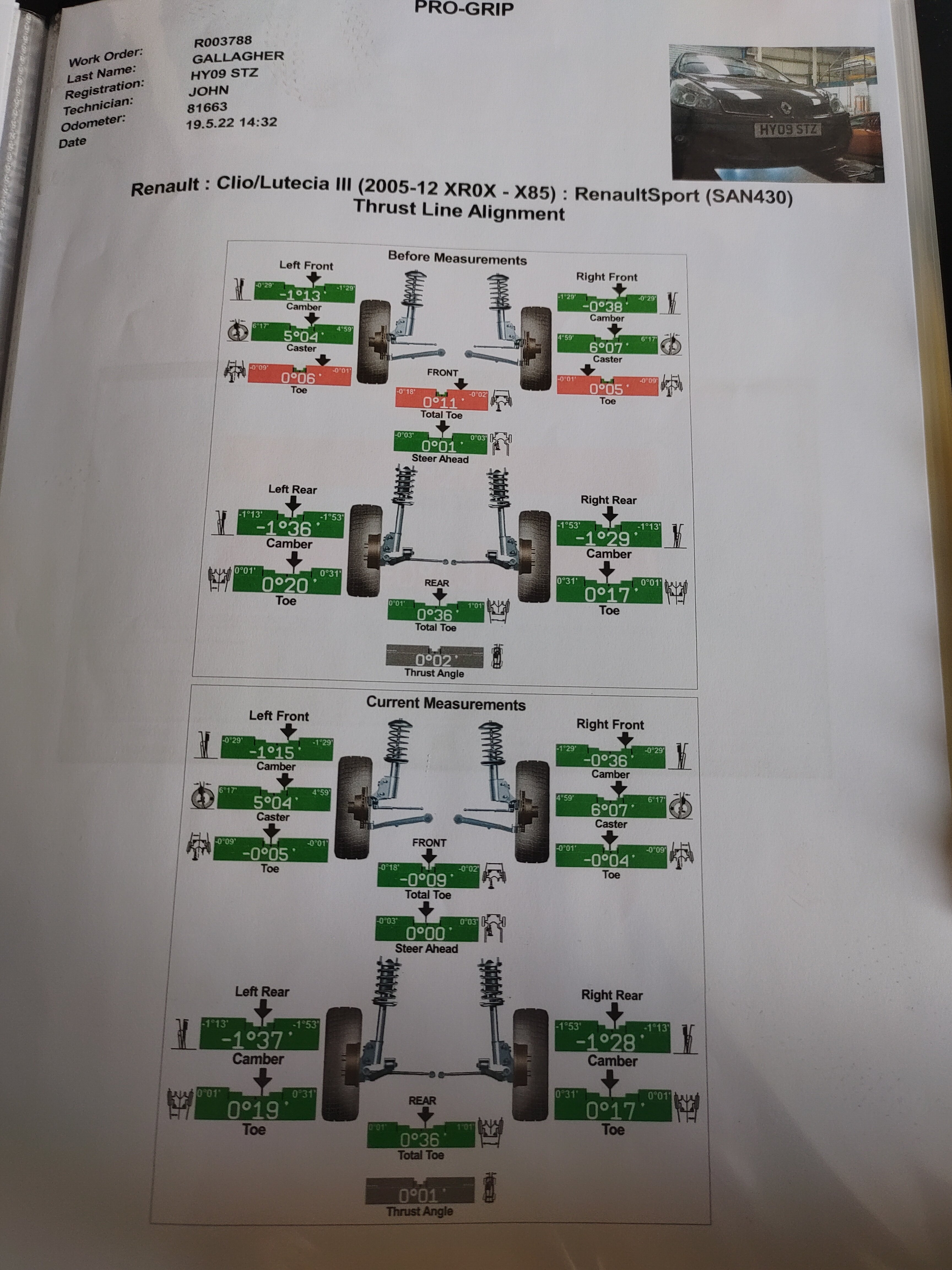

In today at Pro-Grip to have the alignment done after everything has been off and the rack replaced, I done it by eye and didn't get too far away haha
Then took it for an MOT and it sailed through with a clean pass once i refitted the standard rear lights with fog light (i no longer work at a testing centre! :ROFLMAO: )
What a difference it now drives like a new car, the steering is lovely, the shorter rack making it feel a bit more keen on turn in! and the shorter 1st 2nd and 3rd gear ratios make it feel a bit nicer around town, hides its weight a little better!

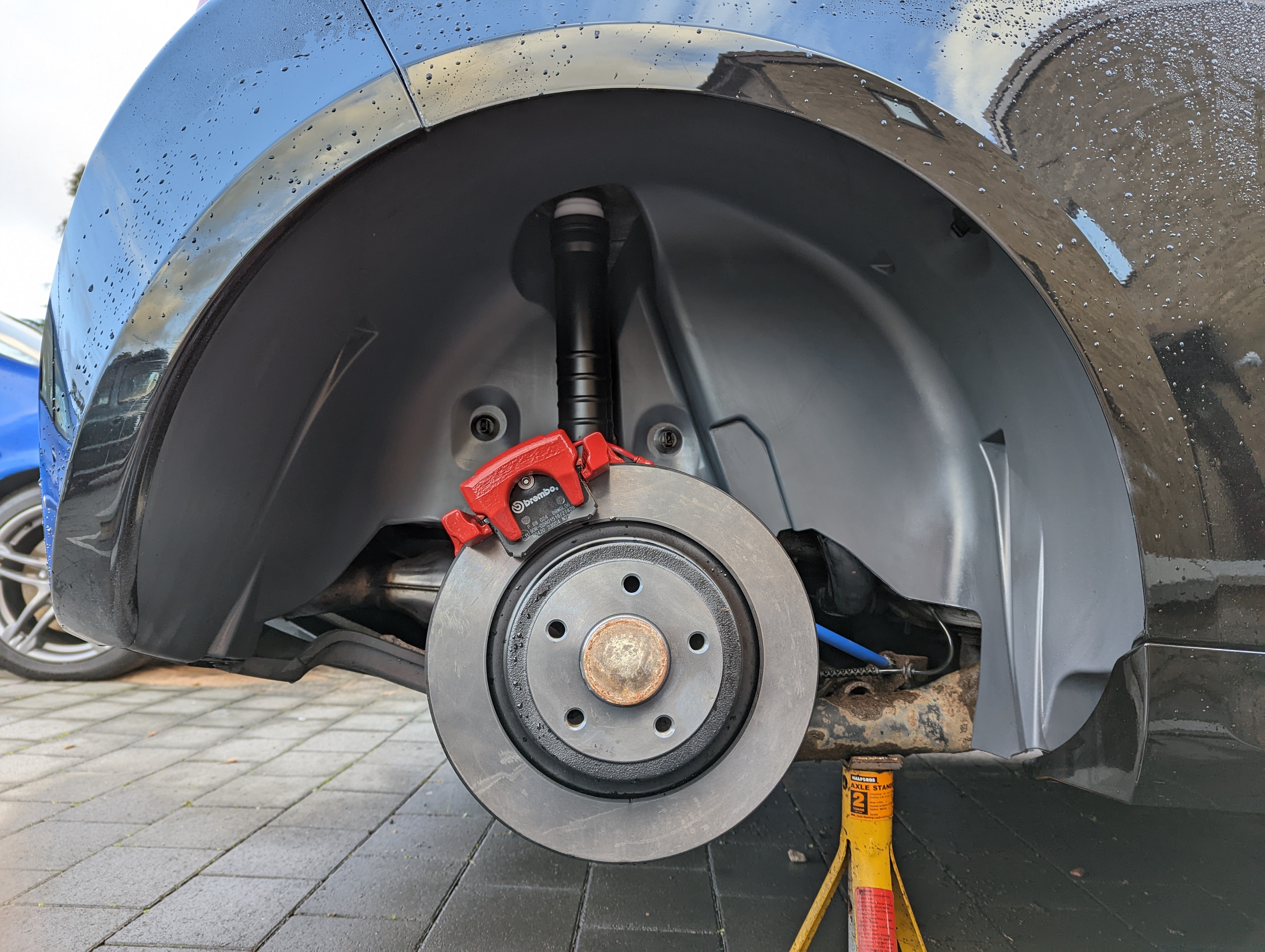

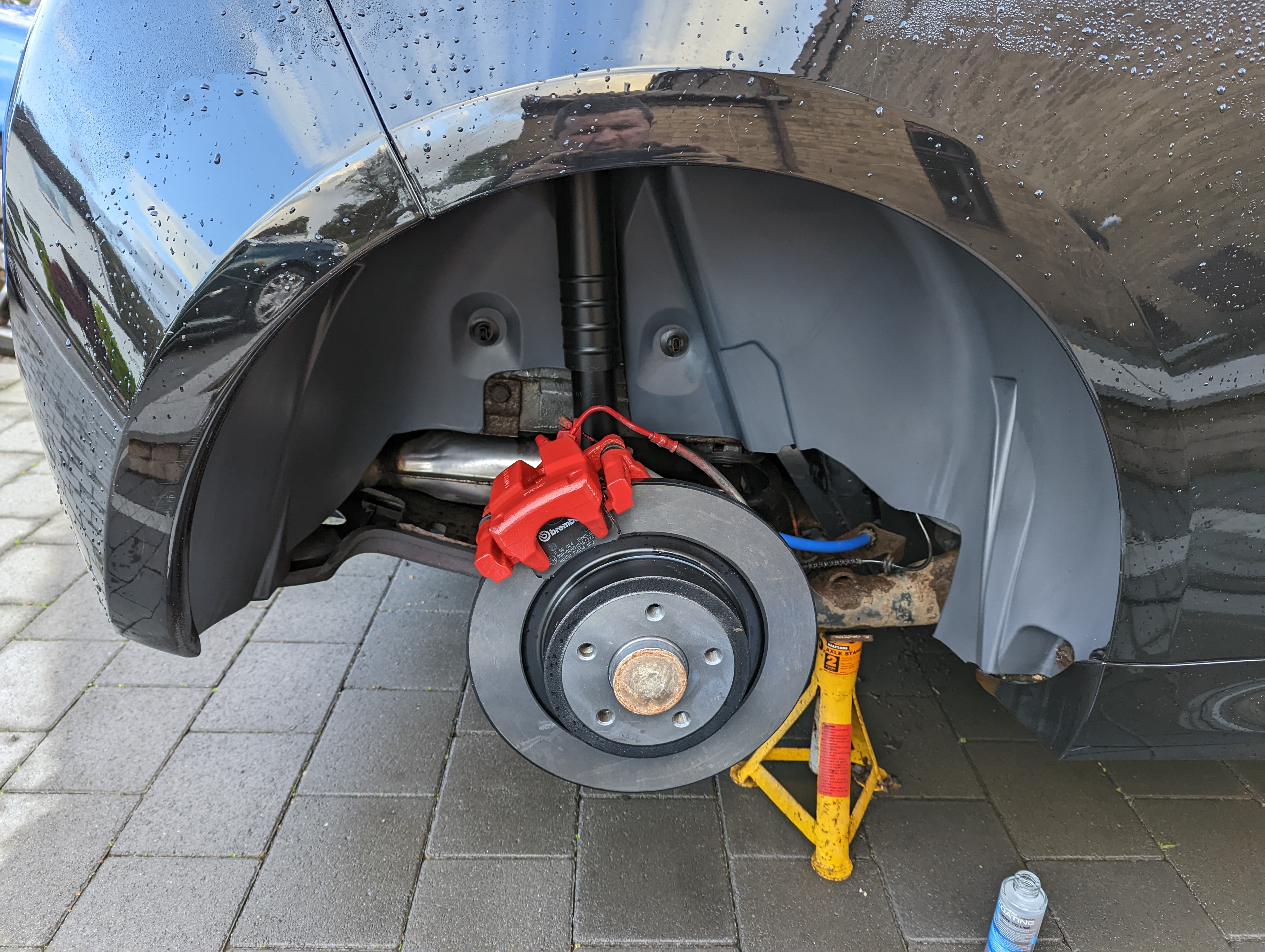

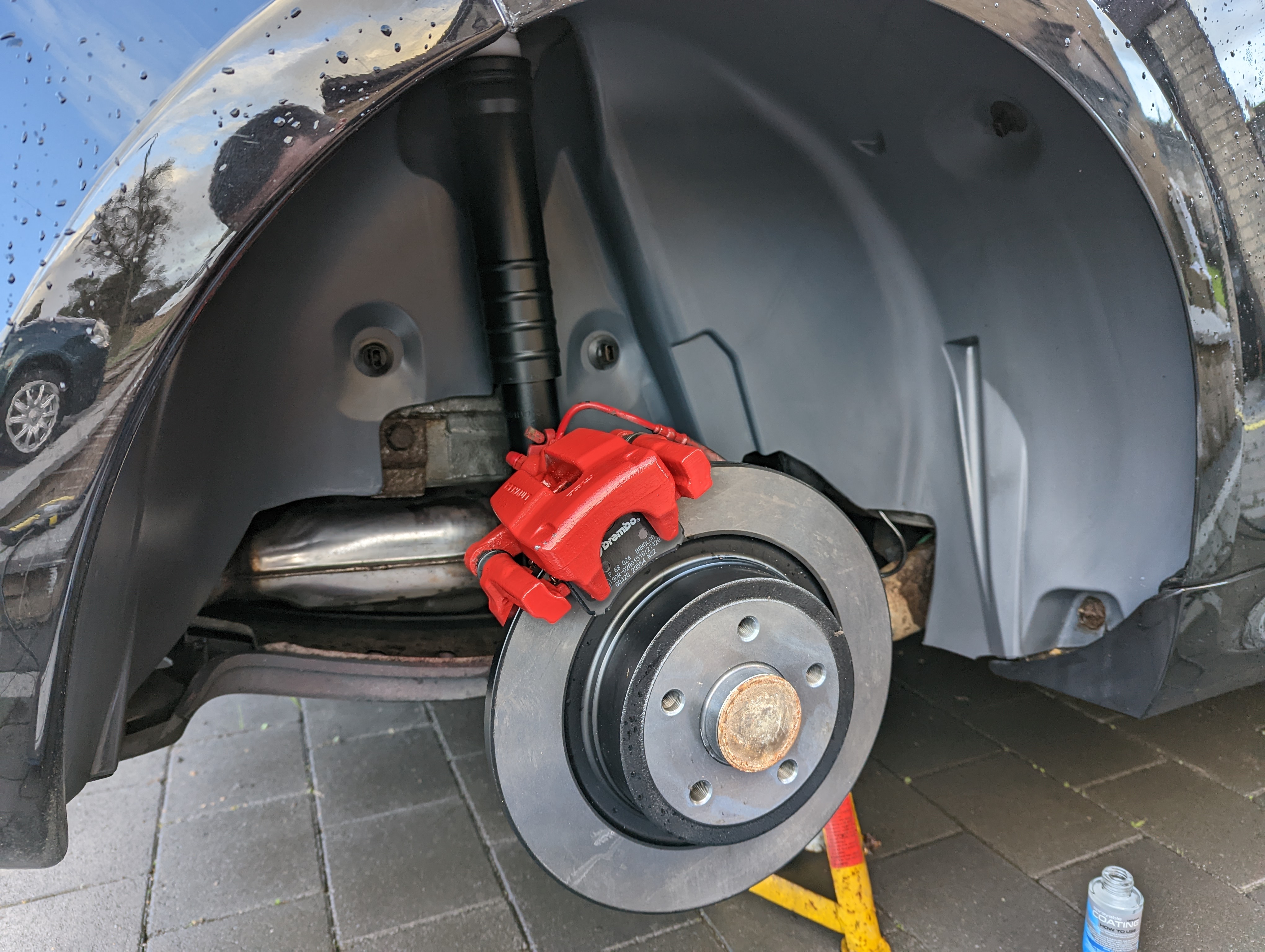

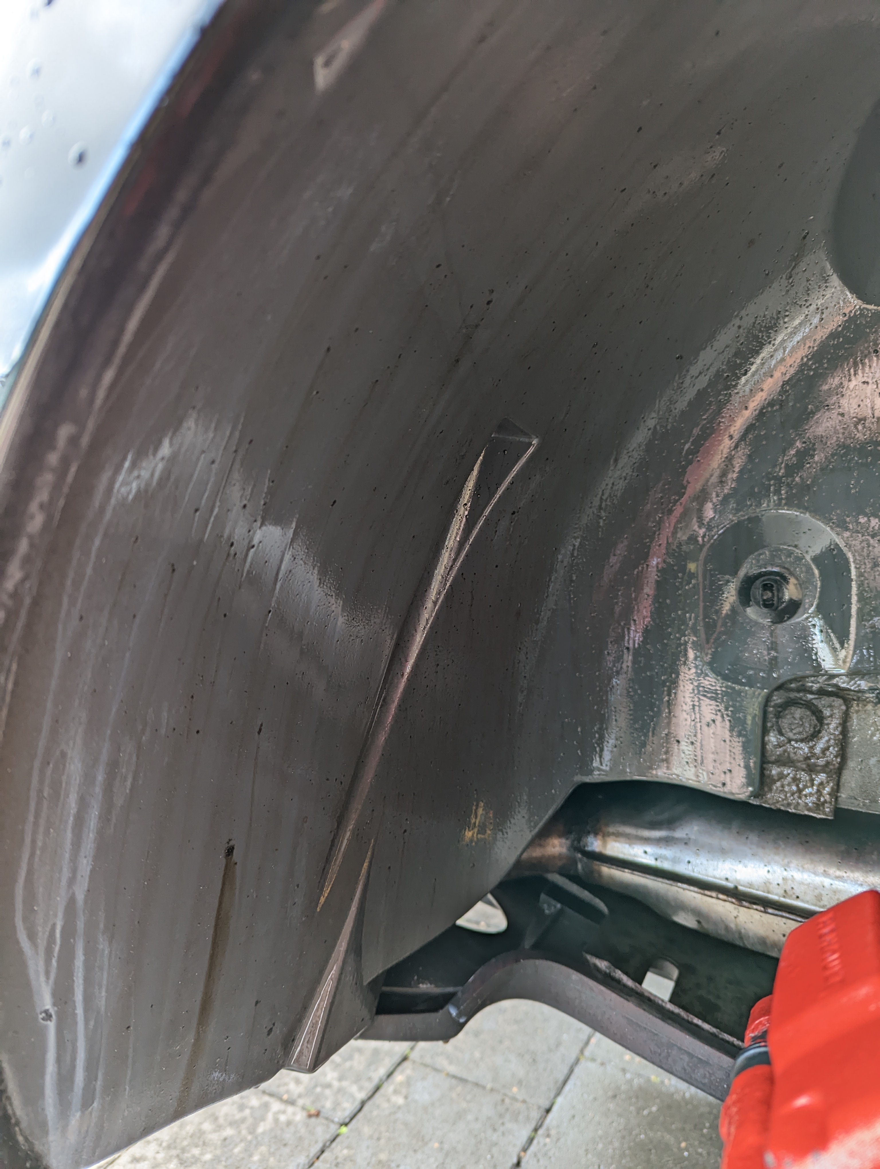

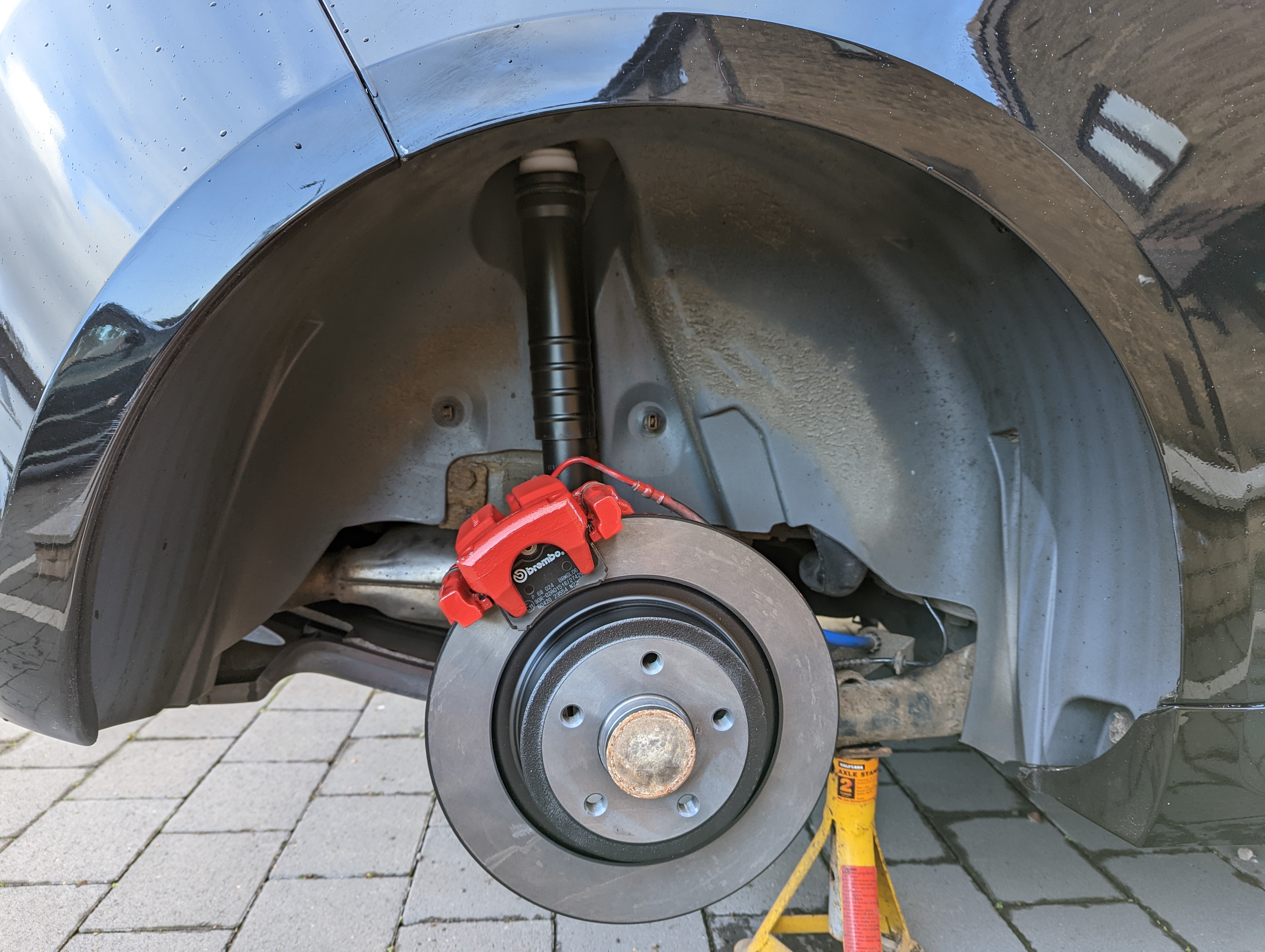

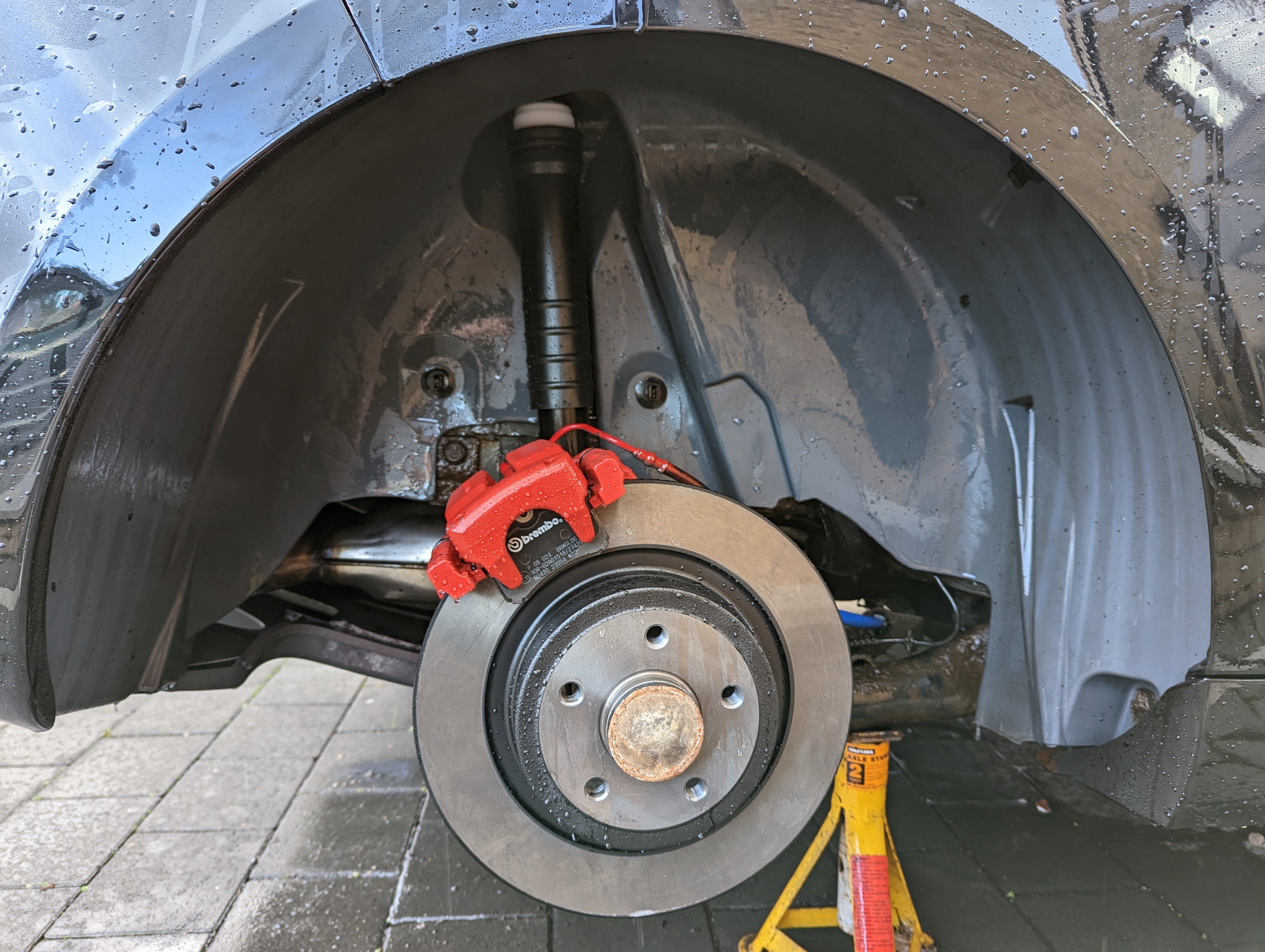

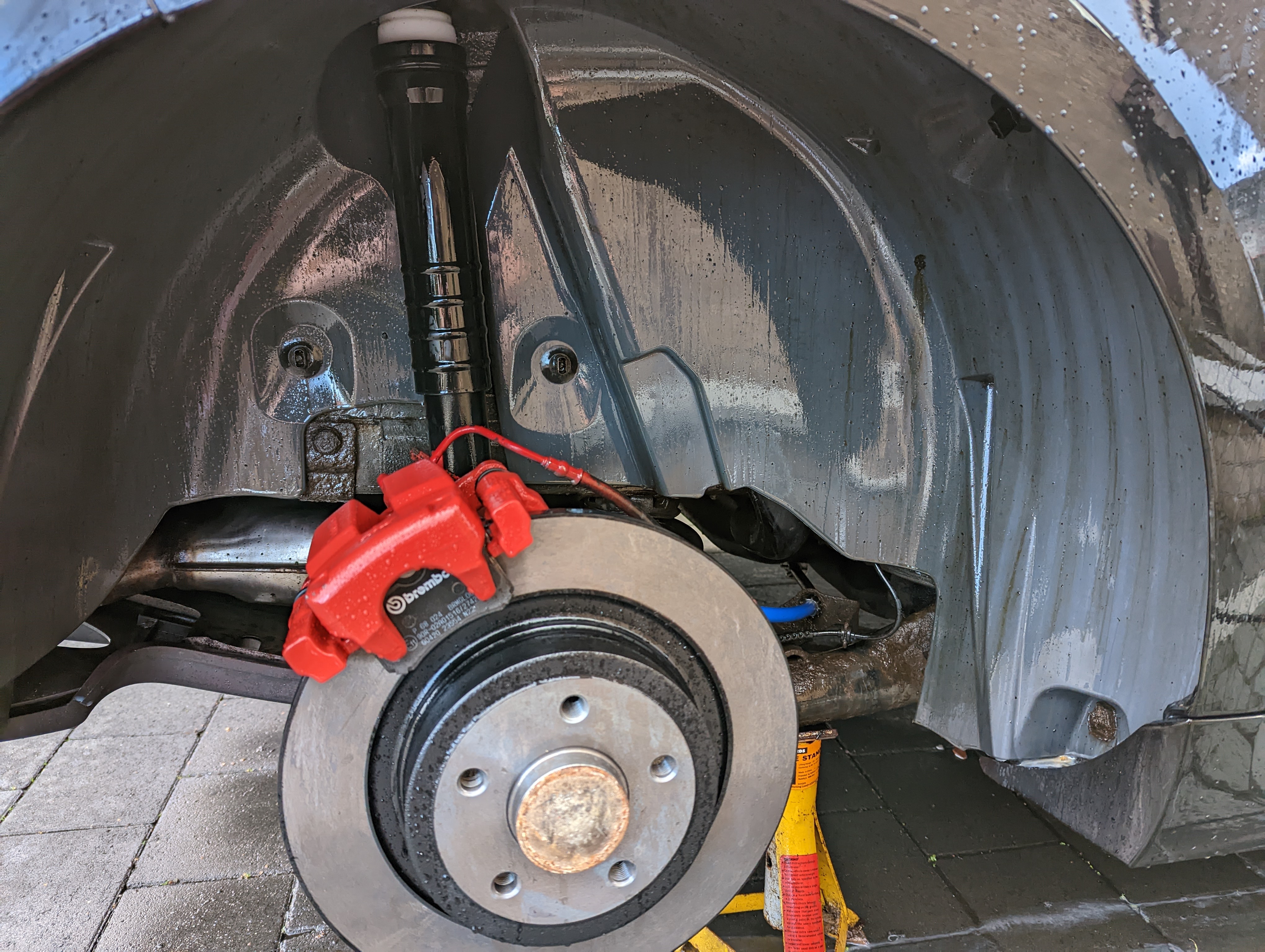

Not much to report on this lately! The ABS and ESP light came on with a warning for the rear ABS sensor so assumed it would be the brackets that hold the ABS sensor in as its fairly common for them to corrode to nothing....
While i was there i done rear discs and pads on it since the discs were due anyway, and decided to give the arch liners a tidy up! (Excuse the red brake line not my doing!!!! replacements on route as one has been cut and joined.)
Martin_172

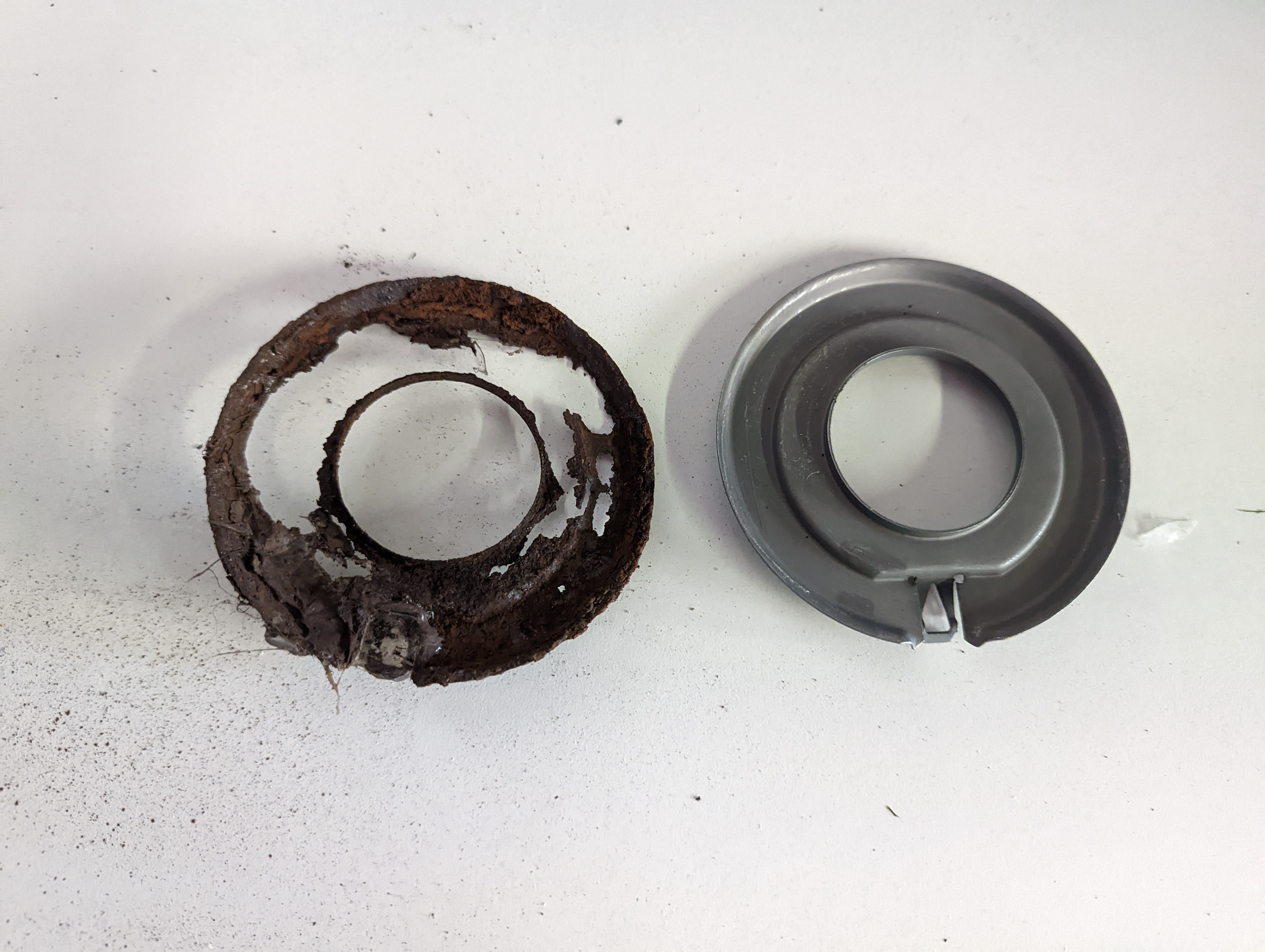

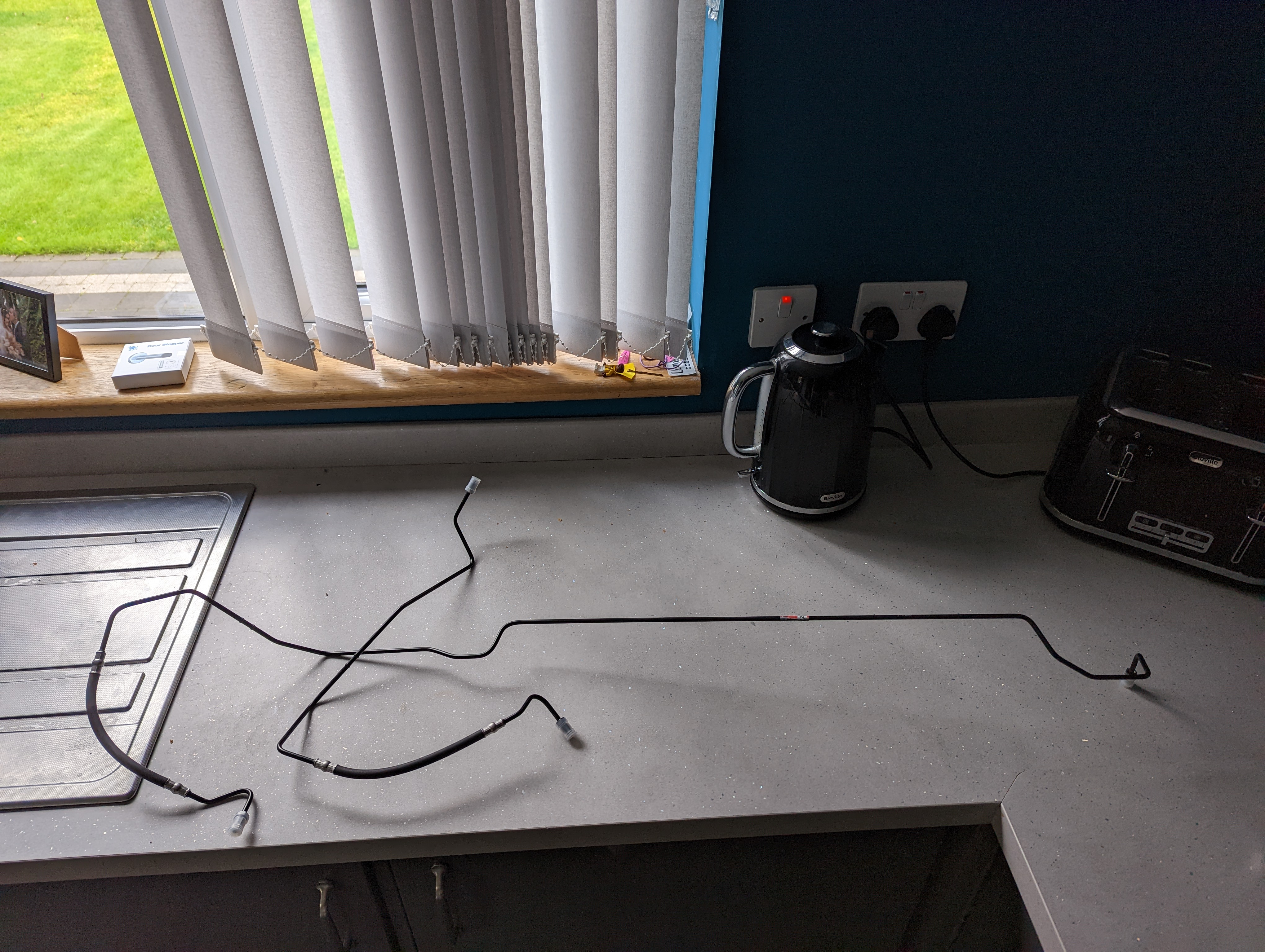

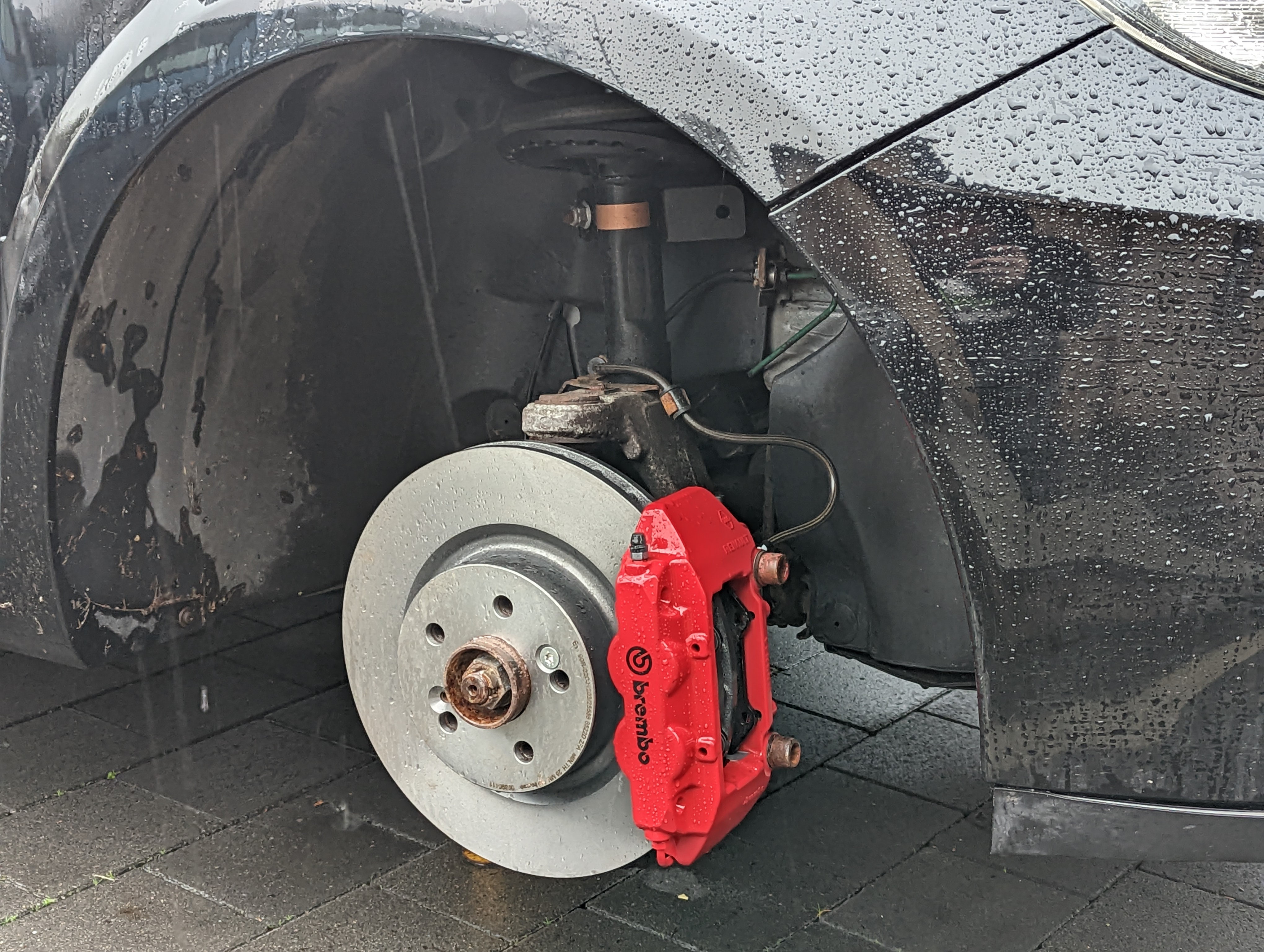

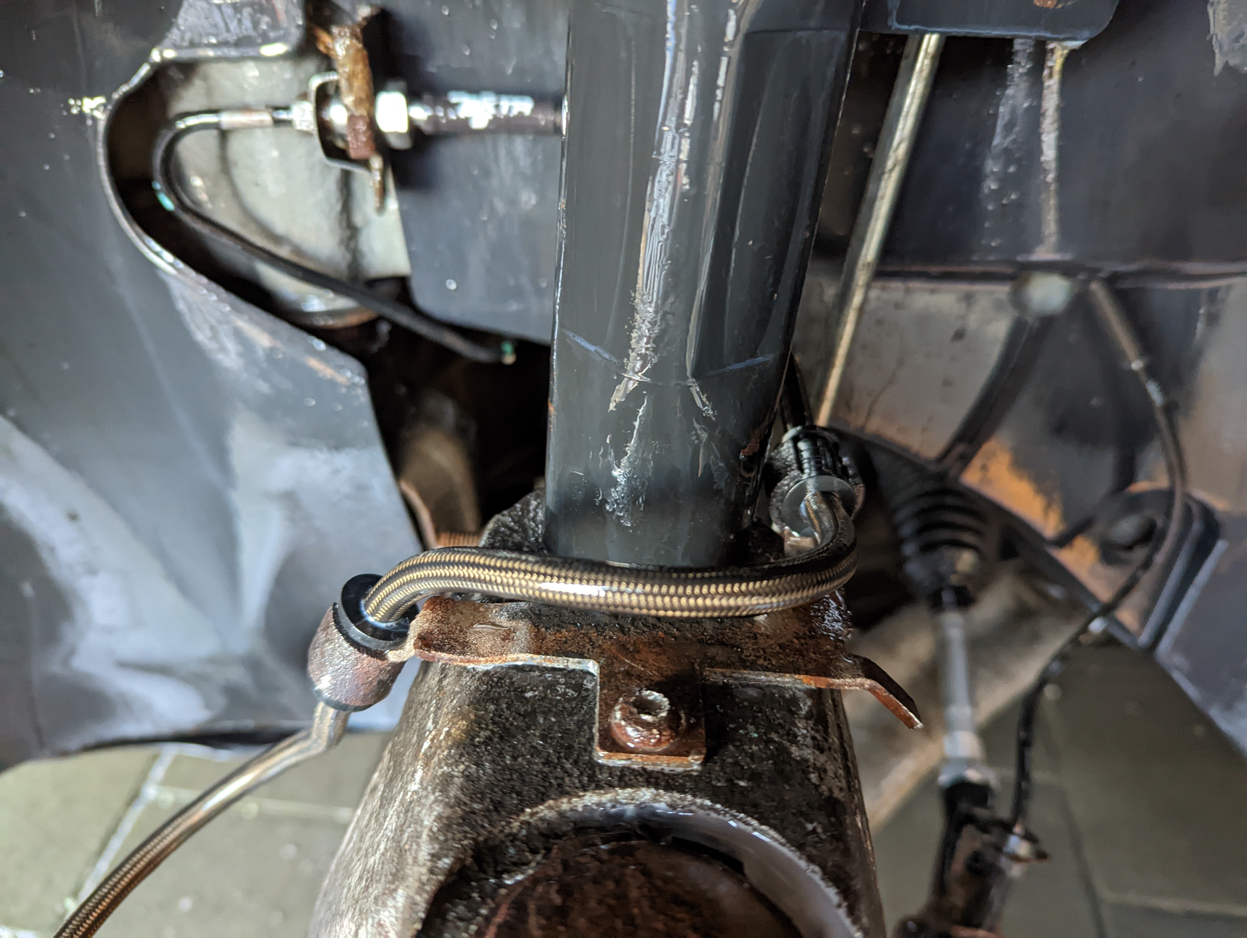

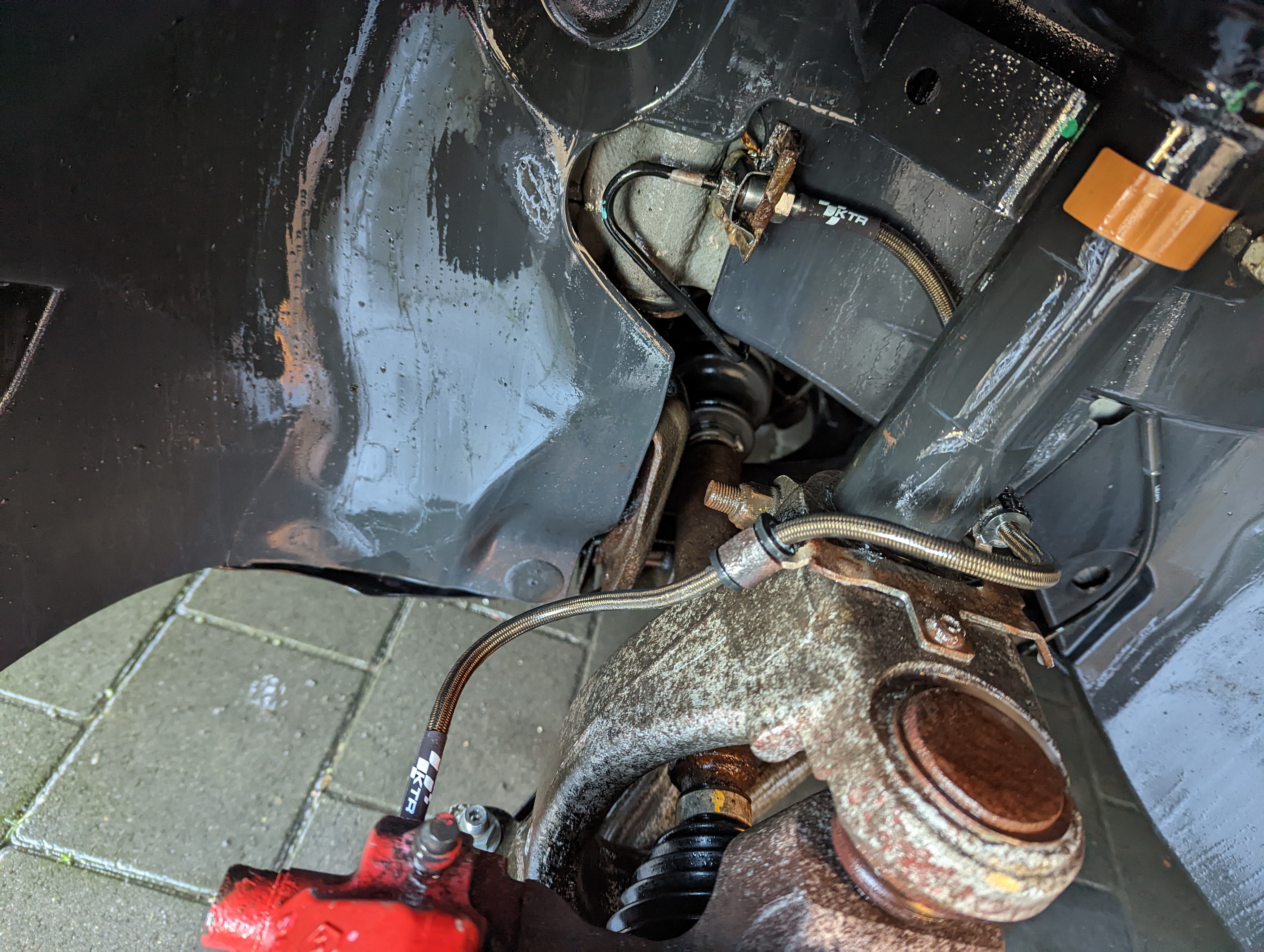

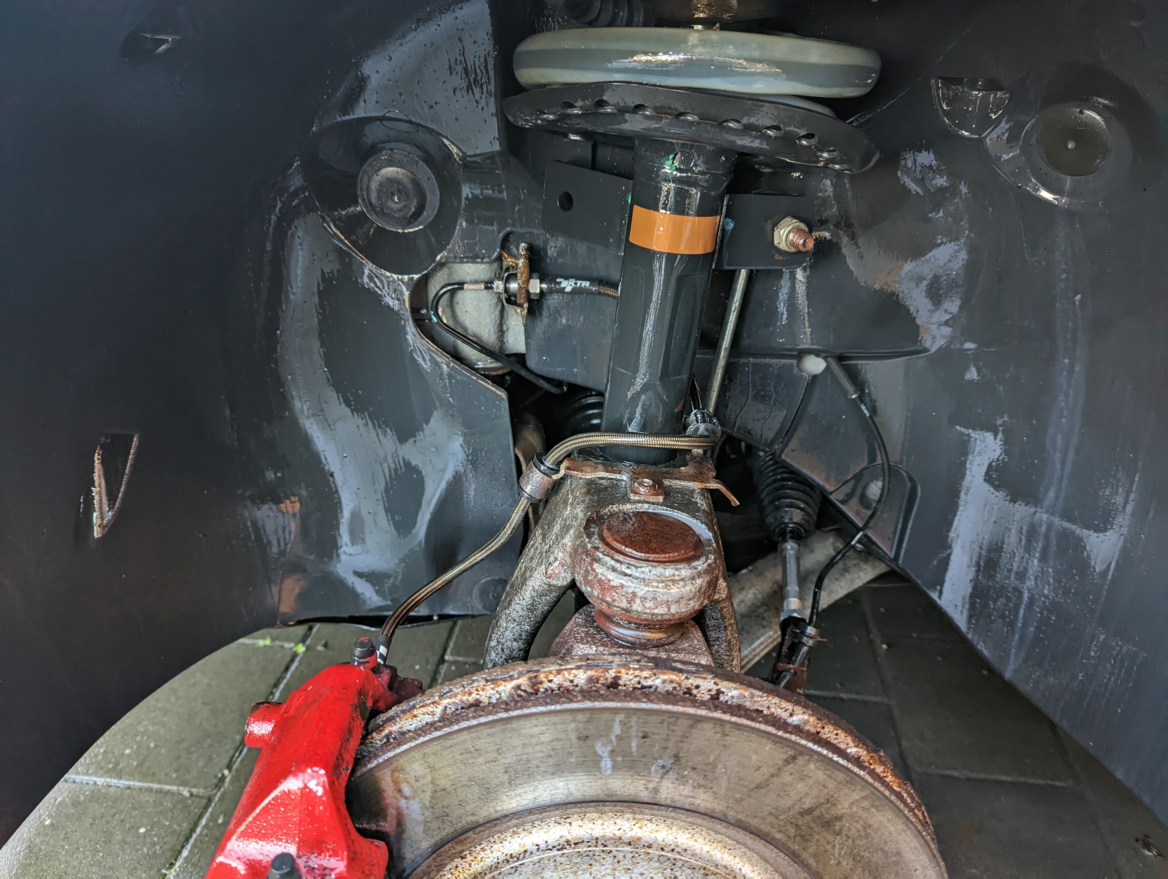

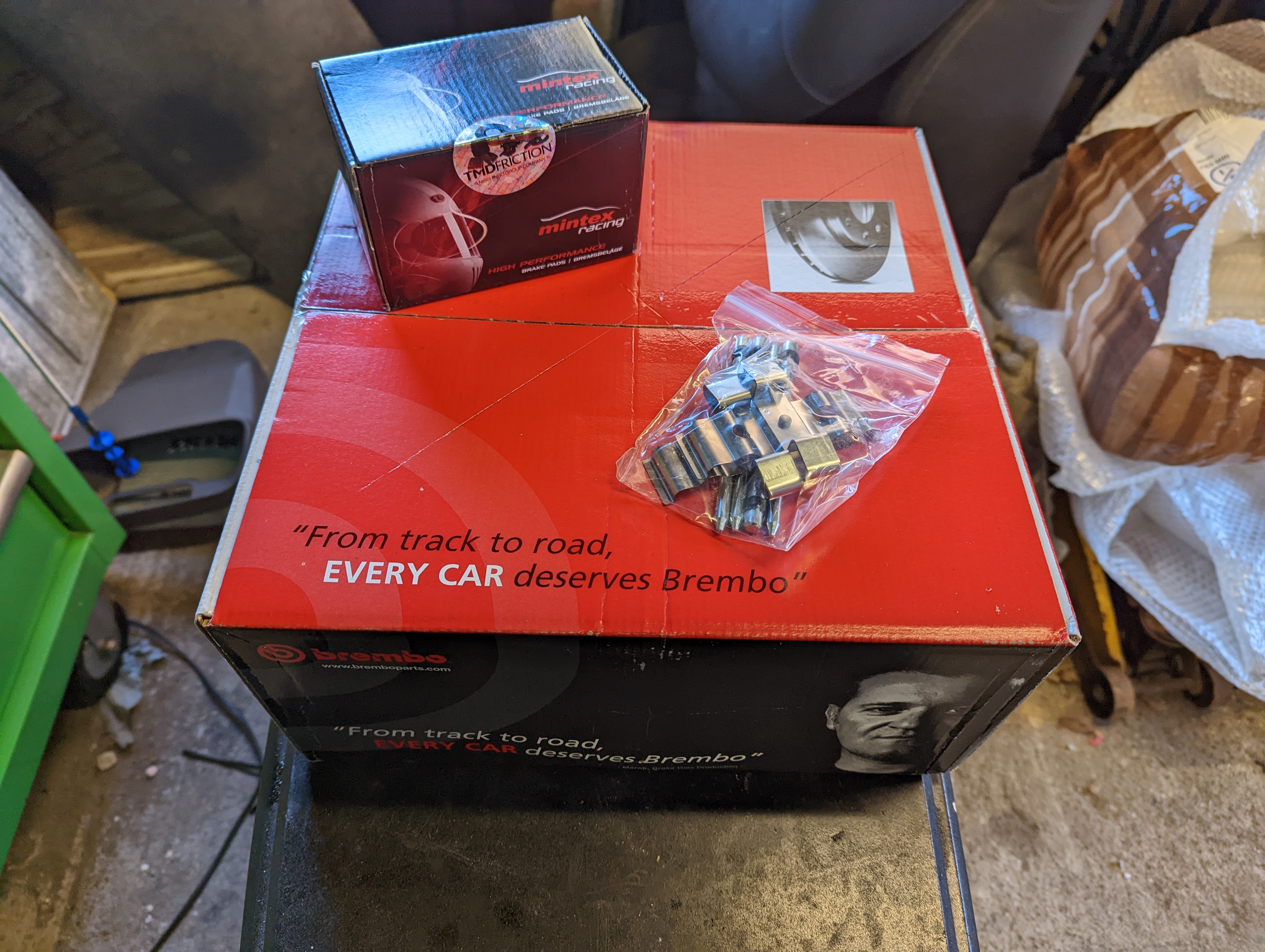

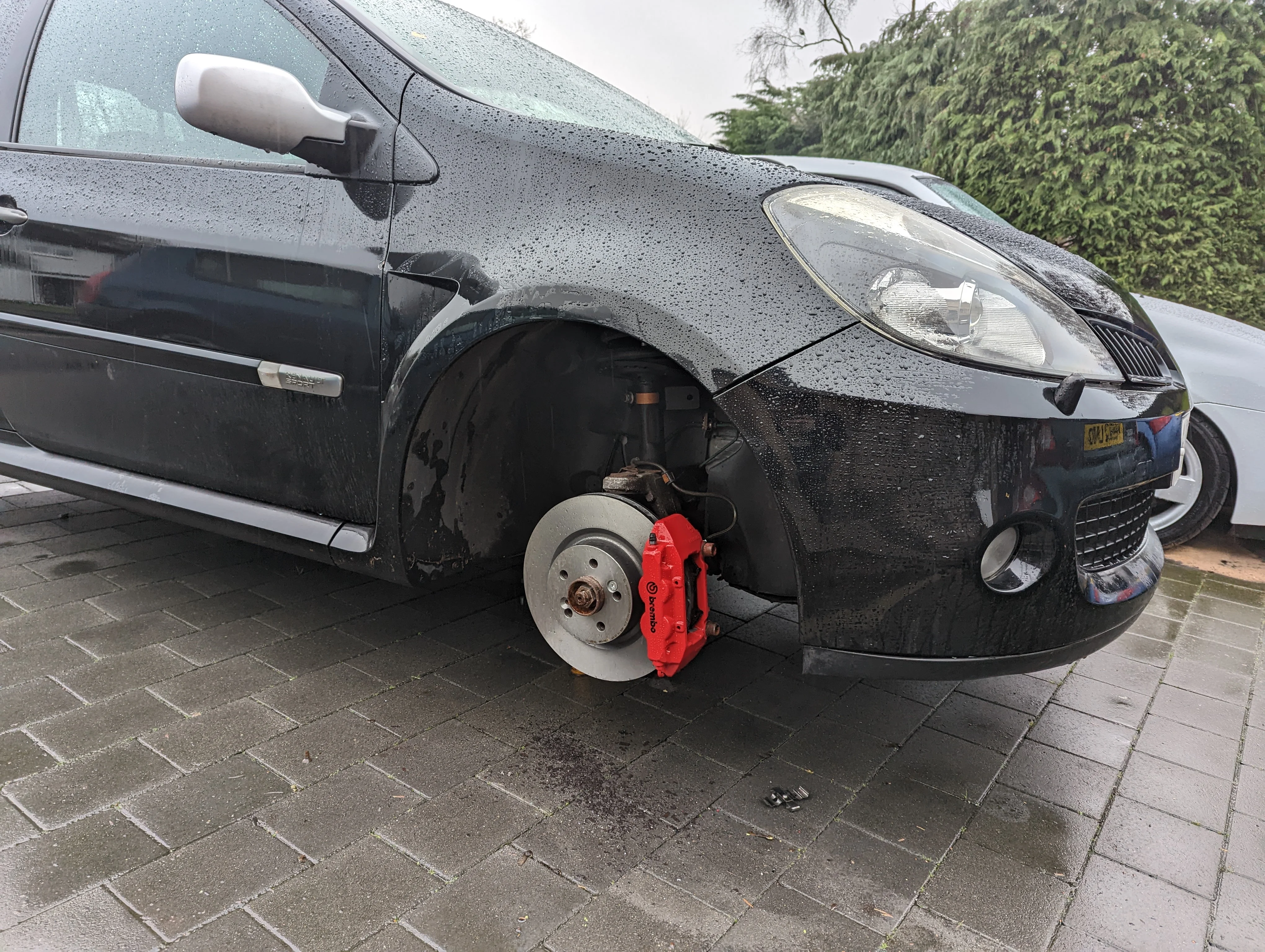

I just keep getting deeper and deeper on this thing!! - When I done the rear brakes I found that the rear brake pipes on the beam had been cut and joined at some point, assume due to an MOT failure which is odd as the rest of the pipes are like new! - Luckily they are still available from Renault so ordered a pair
no fitted pics as its a shite job to do, outside in the cold, and you cant see much for the diffuser! - I took the chance to stick a set of KTR braided brake hoses on while i was at it, when fitting the fronts it remembered me how s**t the front calipers looked, and how poor the motor factor special front brakes were!

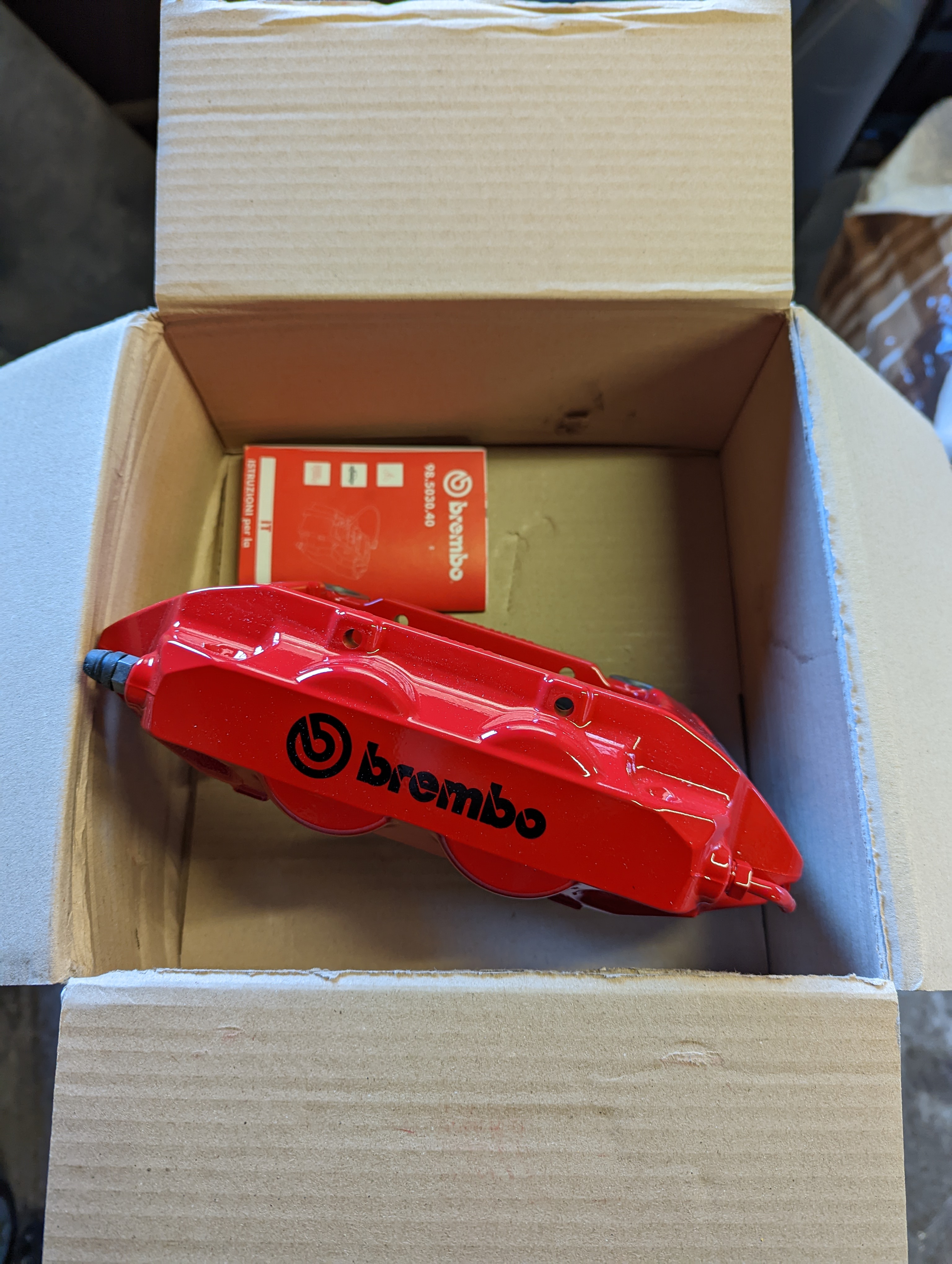

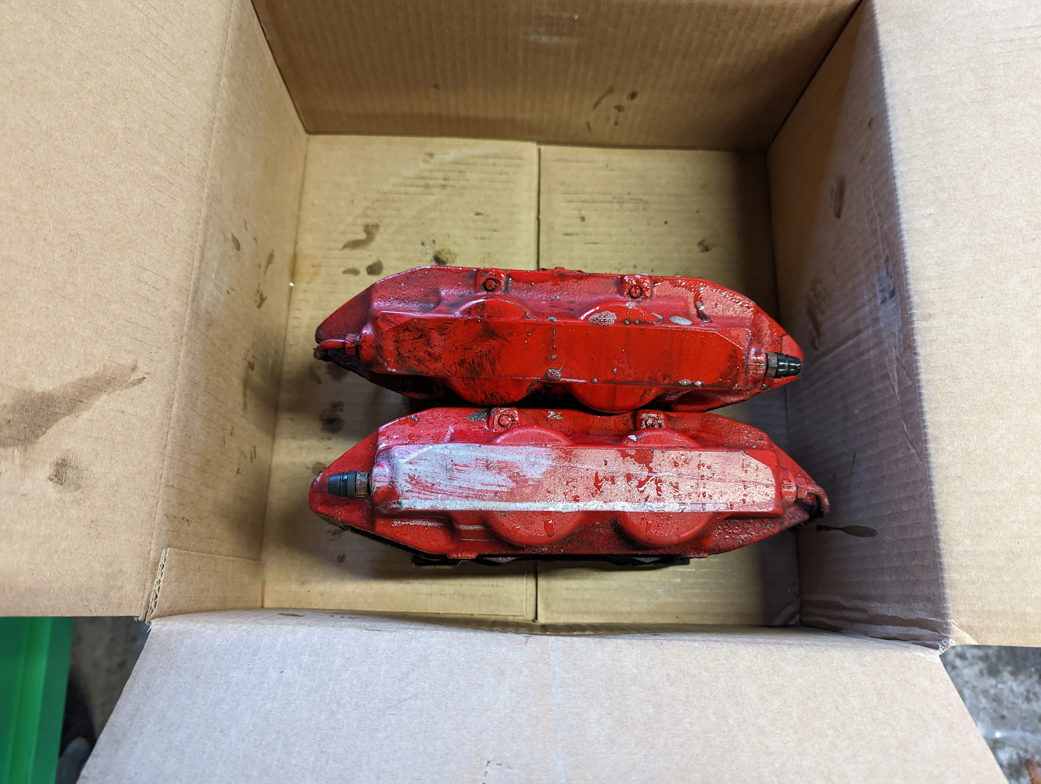

Big order from Kam Racing, both front calipers, set of brembo HC discs and Mintex M1144 pads
I did order a new fitting kit too but, tbh, i dont like them and have instead ordered the better pins with the R clips that dont seize in the calipers! - So waiting on them coming so thats where im up to!...

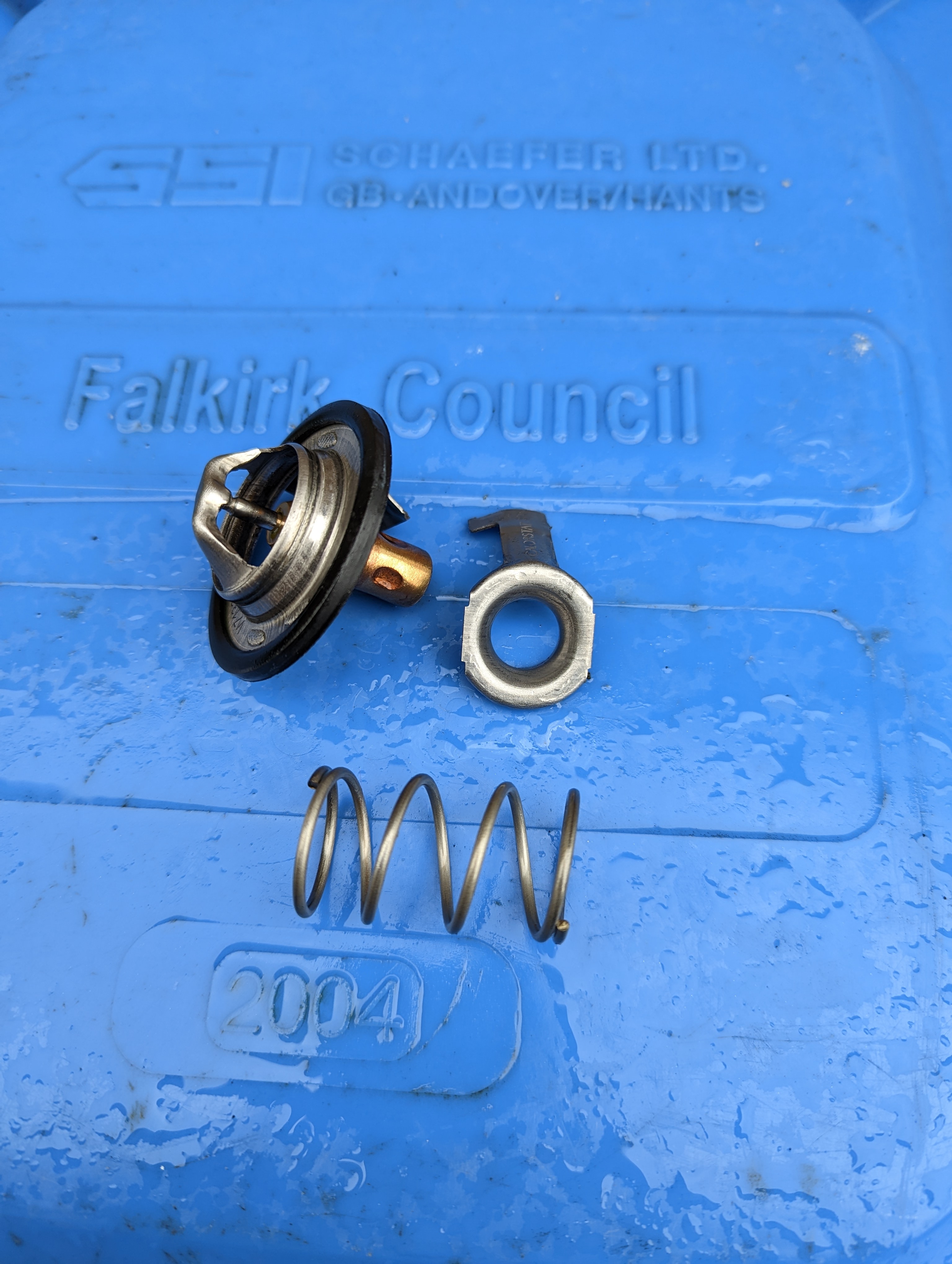

The gates thermostat that i fitted last year appeared to be sticking open causing it to struggle to get upto temp, that will be why...
In the bin it went and a genuine one now in its place!

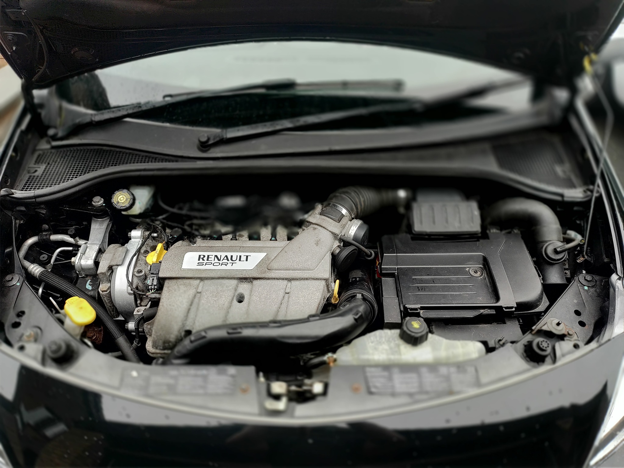

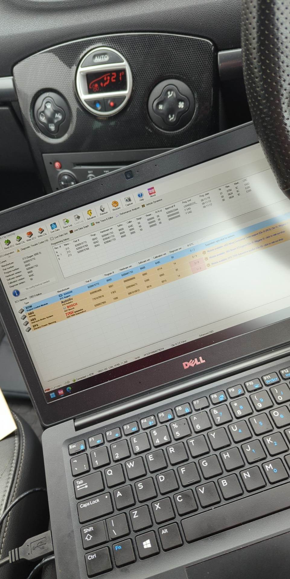

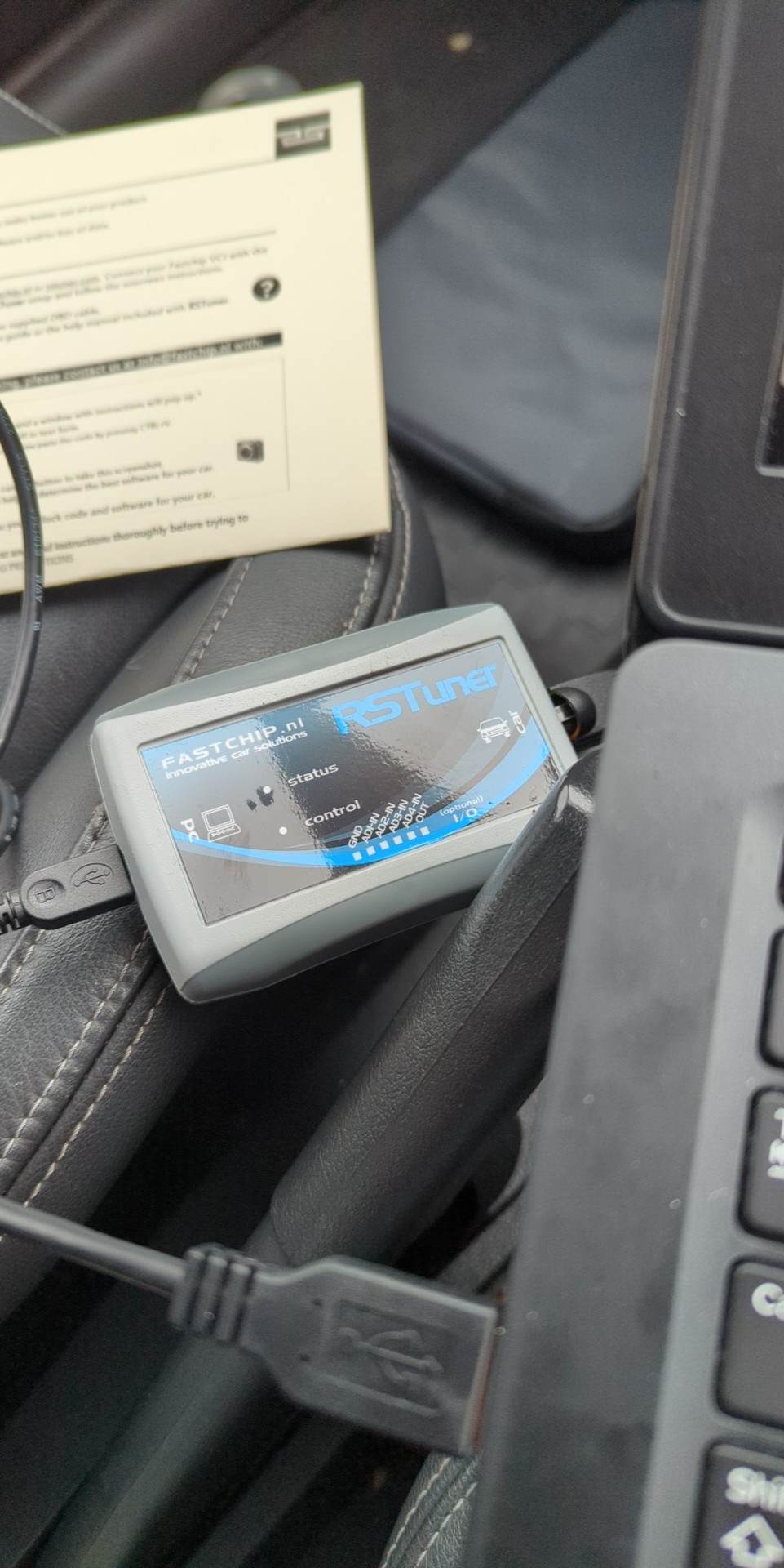

a delivery from Mr Henk @ Fastchip!
Usual quality of map from Fastchip, awesome, From cold start the car is transformed, it used to kangaroo and be borderline dangerous joining the motorway 30 seconds from my work when it was cold.
Car has also gained a little mid range where it needs it most but most surprisingly the last 2000rpm in the rev range is where I've noticed the biggest difference much keener - Money well spent!
Surprisingly the average MPG risen 1MPG and climbing too!

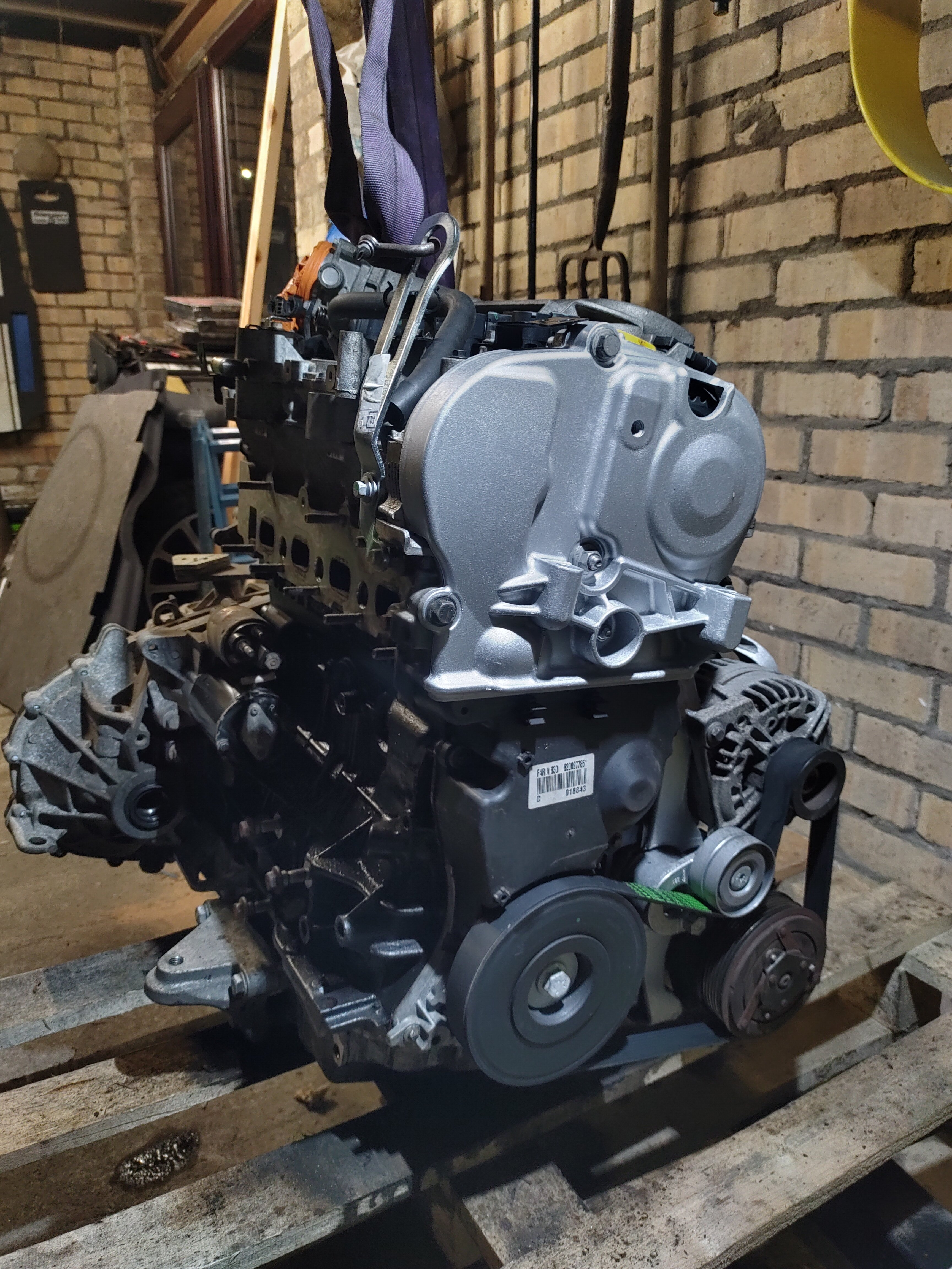

Ahhh good old MK3 ownership! - it had been using a bit of oil which was unusual for an F4R in my experience as none of mine have ever used any, not an issue as I do about 1000 miles a year in it, except with my new job I've been banging it back and forward to Glasgow and hadn't given it too much thought....... anyway, it says oil OK every time I start it.......
Cue coming flat out into a roundabout one day chasing @SSN11 in his 200 cup being followed by BEEP BEEP BEEP and oil pressure failure on the screen. Took almost 4 litres to get it back onto the dipstick!
thought I had got off lucky until the following day i heard a slight knock on throttle, balls!
Stu @ Renomotive sorted me out with a 200 engine with 65k on the clock, so yesterday i got tore in!
My clutch is just over 12 months old and my box was rebuilt at the same time so it was a straight swap over for those, new engine has just had genuine belts, dephaser, waterpump etc recently so i quickly pulled off the end caps to check the timing, spot on, so in it went!
Changed over in a shift, todays job is finishing the rest and getting it out for a road test!
