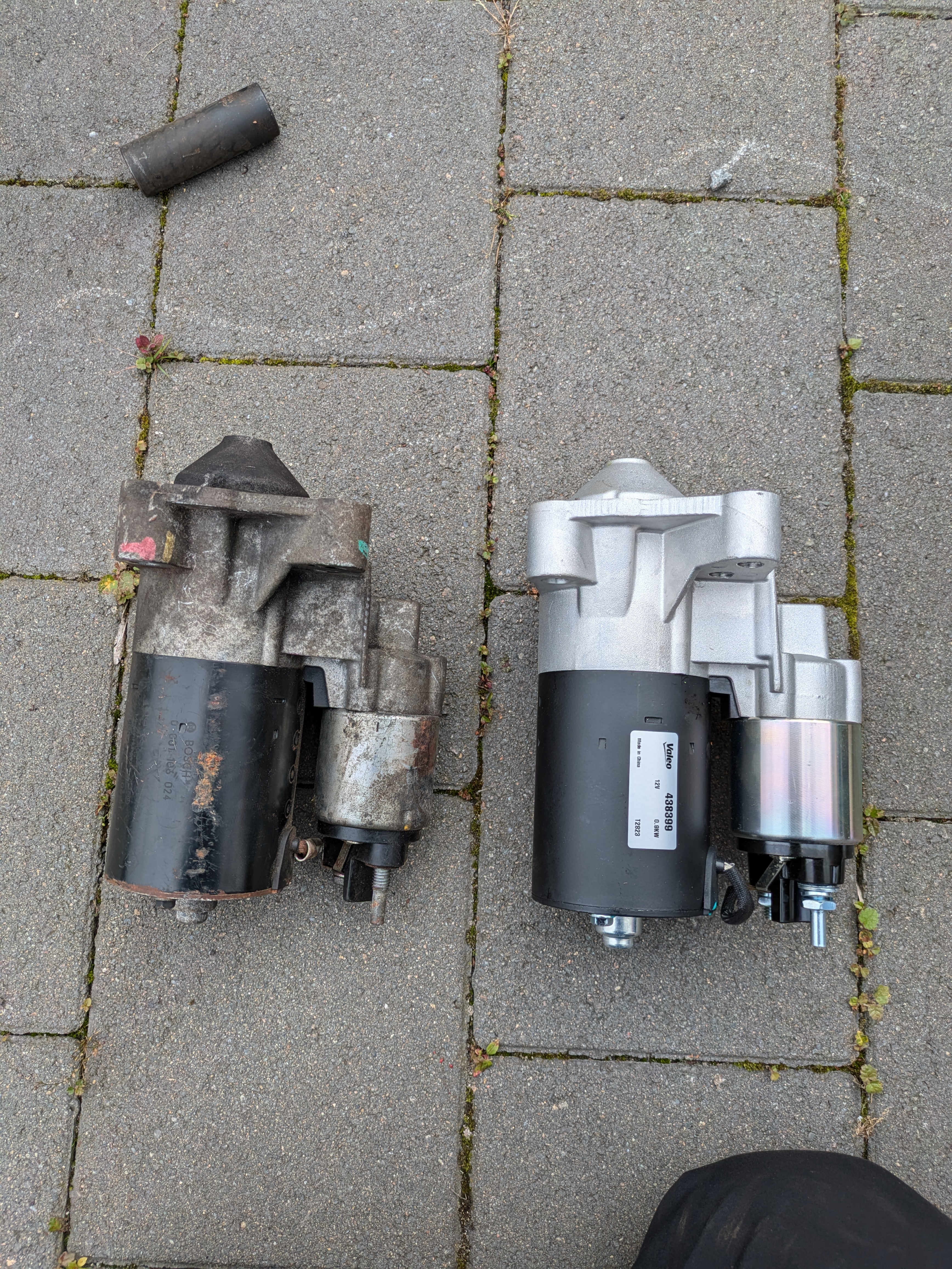

New Valeo starter Fitted - Now I was in a rage fitting this, as weeks previous when the engine was out I thought about ordering one since it doesn't look a fun job to do when the engines in, I priced it up and decided against it due to the fact I've never had a failed starter before! - Proper s**t job, from both underneath and the drivers wheel well, exhaust manifold off etc
Turned the key, now instead of CLICK I was getting CLICK CLICK CLICK - Back to the same routine...

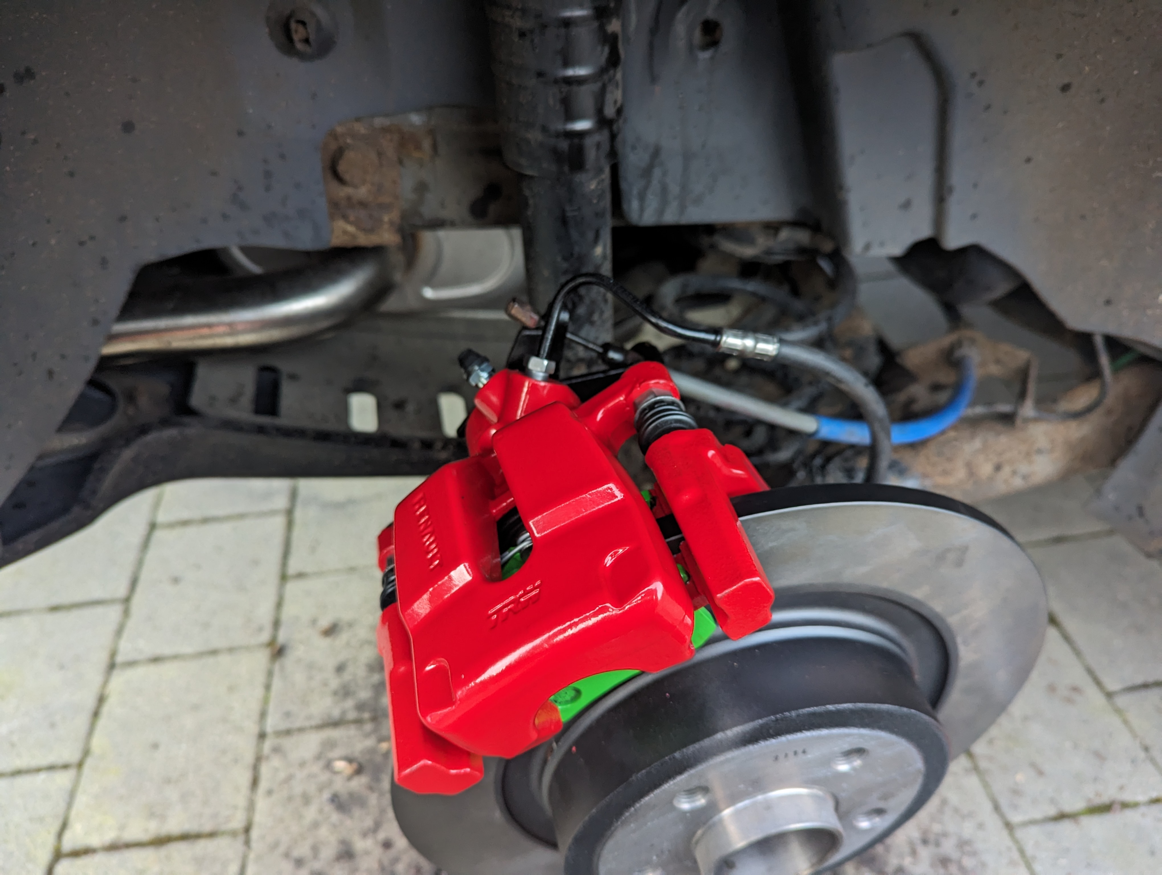

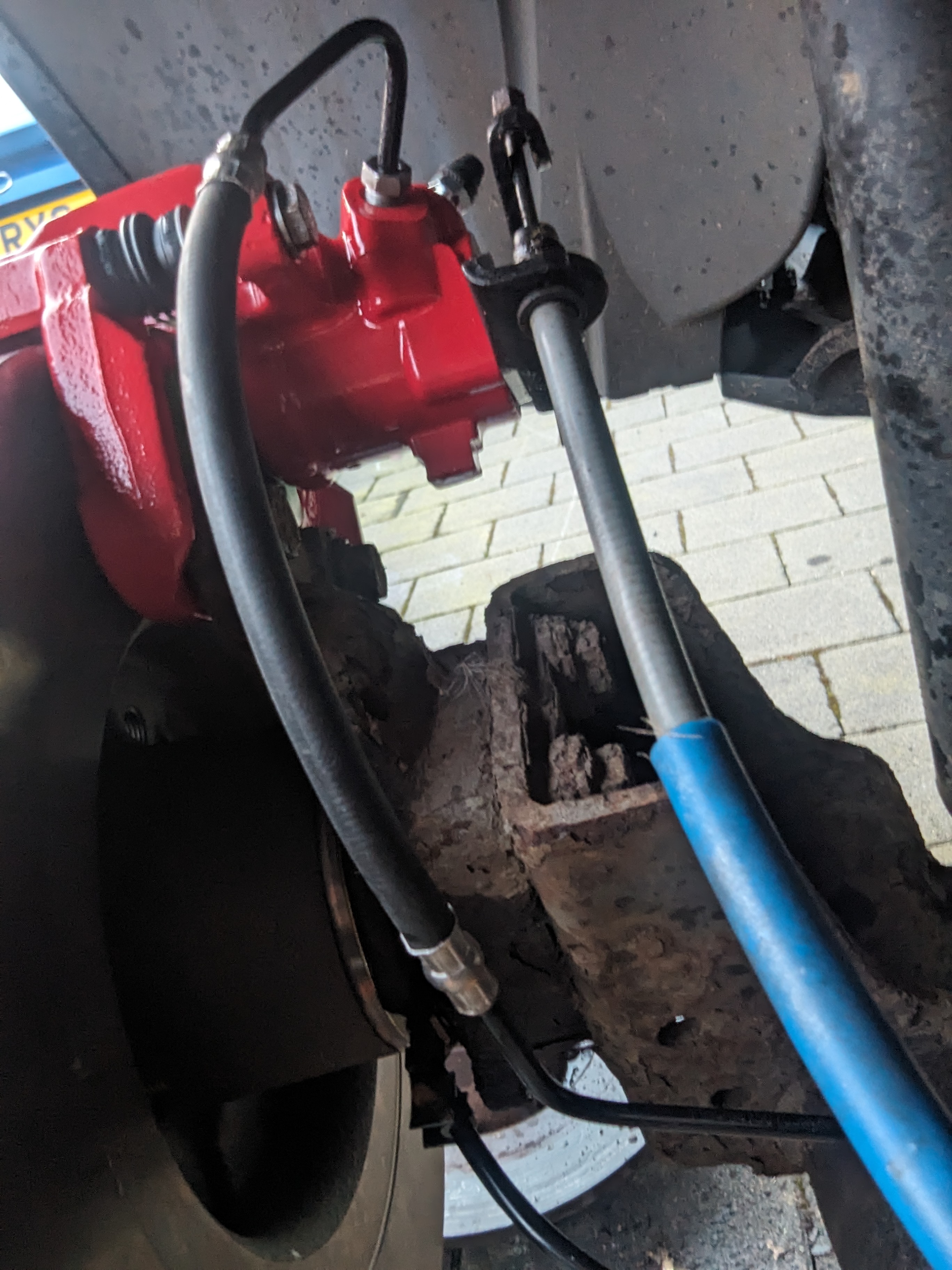

So today the real CSF prep could start - the pedal feel hasn't been great since I overhauled all the brakes - I had planned to re visit so today I got it up off the deck, all wheels off and carried out a full brake fluid change and ABS bleed - Pedal is now mint and the brakes are MEGA!
