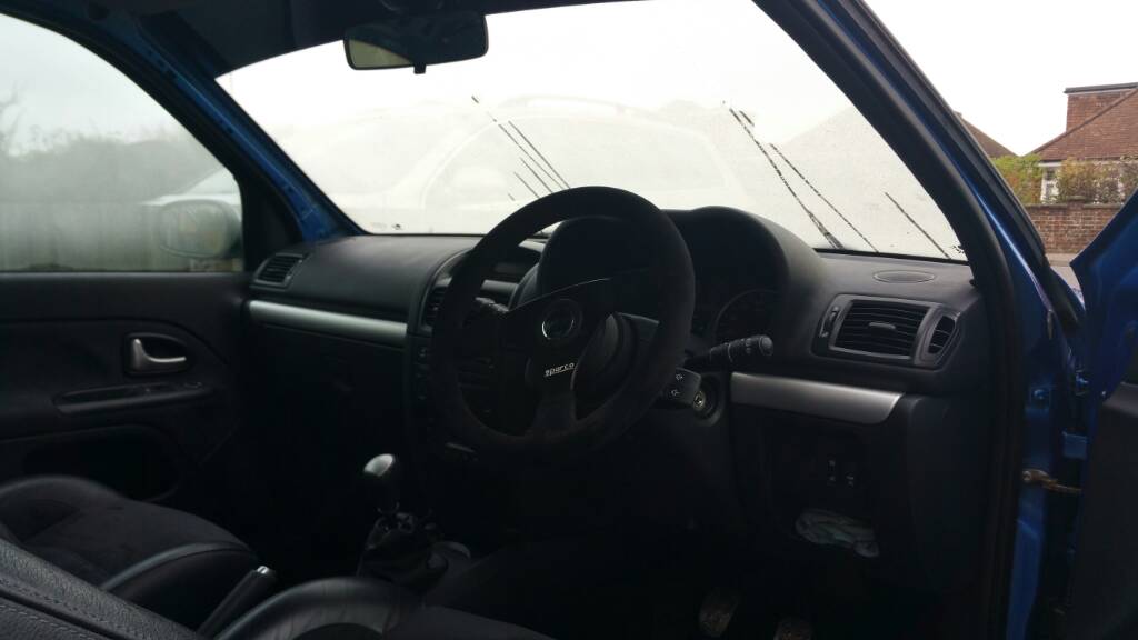

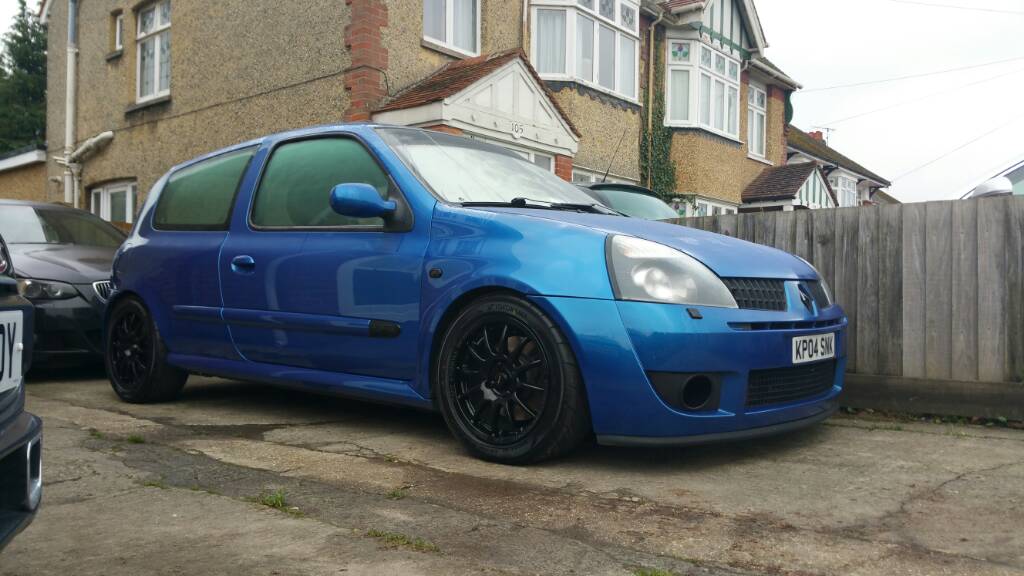

So 3 weeks ago I bought an Artic Blue 182 as a run about while I store my M3 for winter. This is now my 4th clio after owning a 172 and 2 other 182's.

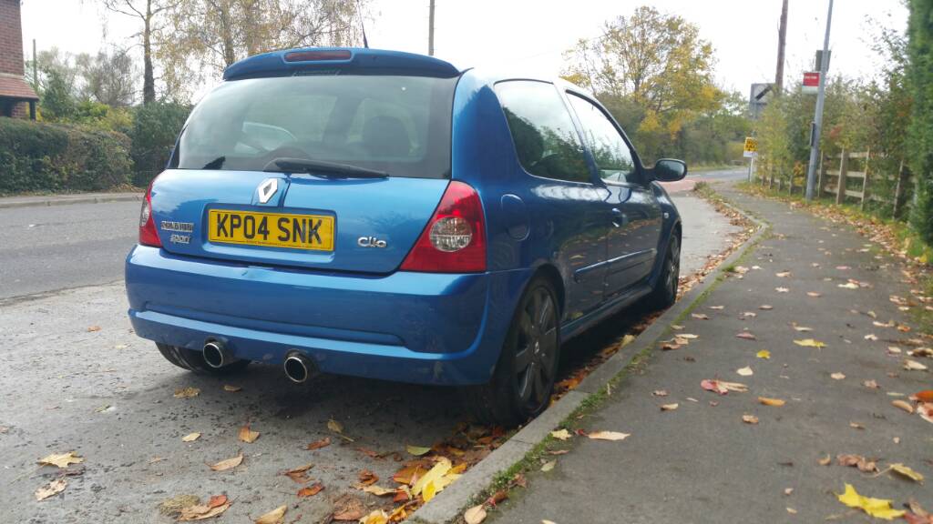

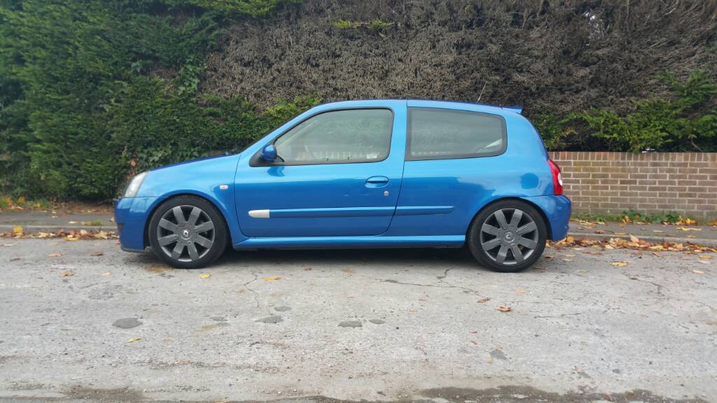

The clio was previously owned by a friend, therefore I know it's been looked after. On 65k and only mods consisting of a miltek, bilstien B14's. A couple of pictures from the day I bought it.
Since then I've done a couple of mods, changes and general tidying, but haven't been brilliant at picturing all (sorry!). The plan is to keep it as sensble as possible for the road, but do some trackdays next year.

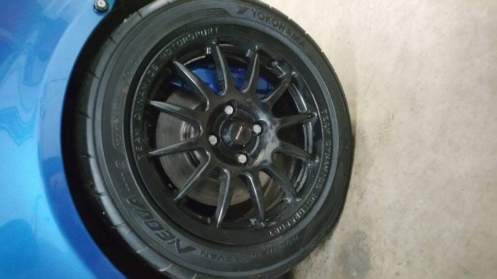

- New 15" TD pro race 1.2 with AD08R'S.

So how the car currently looks

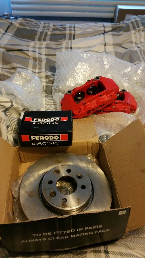

I've also just purchased some 4-pot 280mm brembos with DS2500 pads and new discs, they are currently red, but will be painted artic blue.

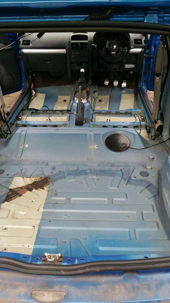

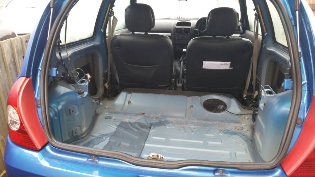

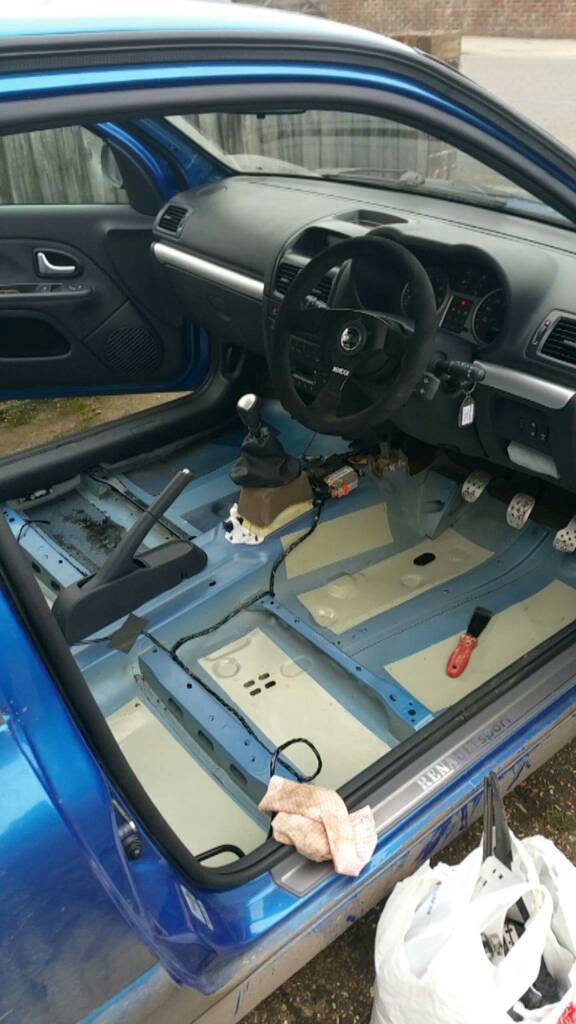

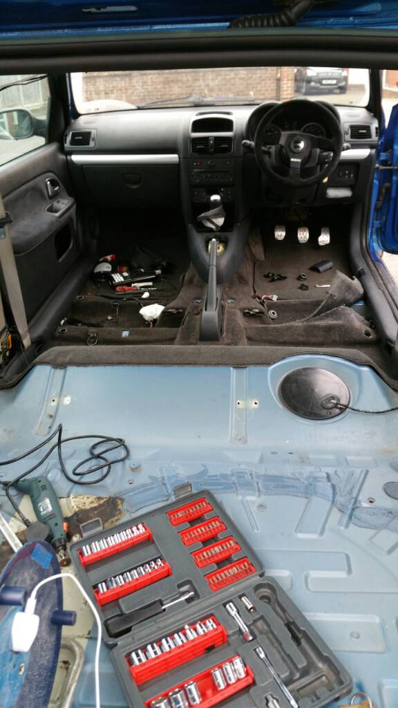

Removed all the interior, including carpets, took out the foam and sound deadening, decided to stick the carpet back in for now until the interior is painted.
Half way through the front
Finished

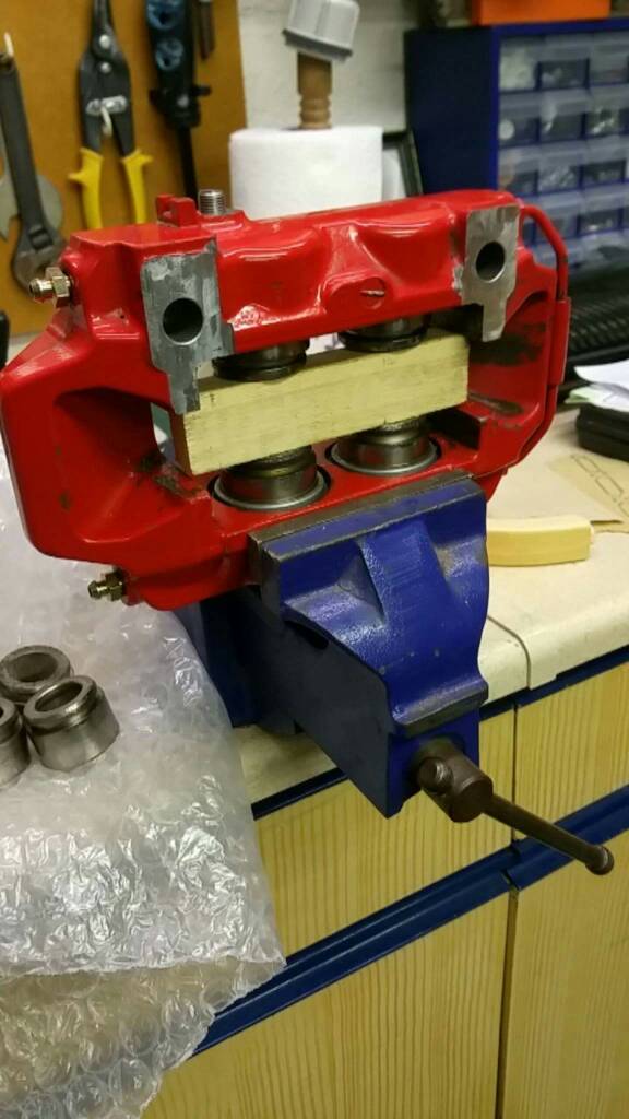

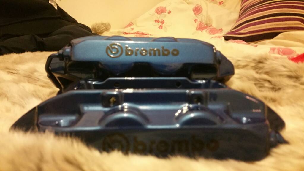

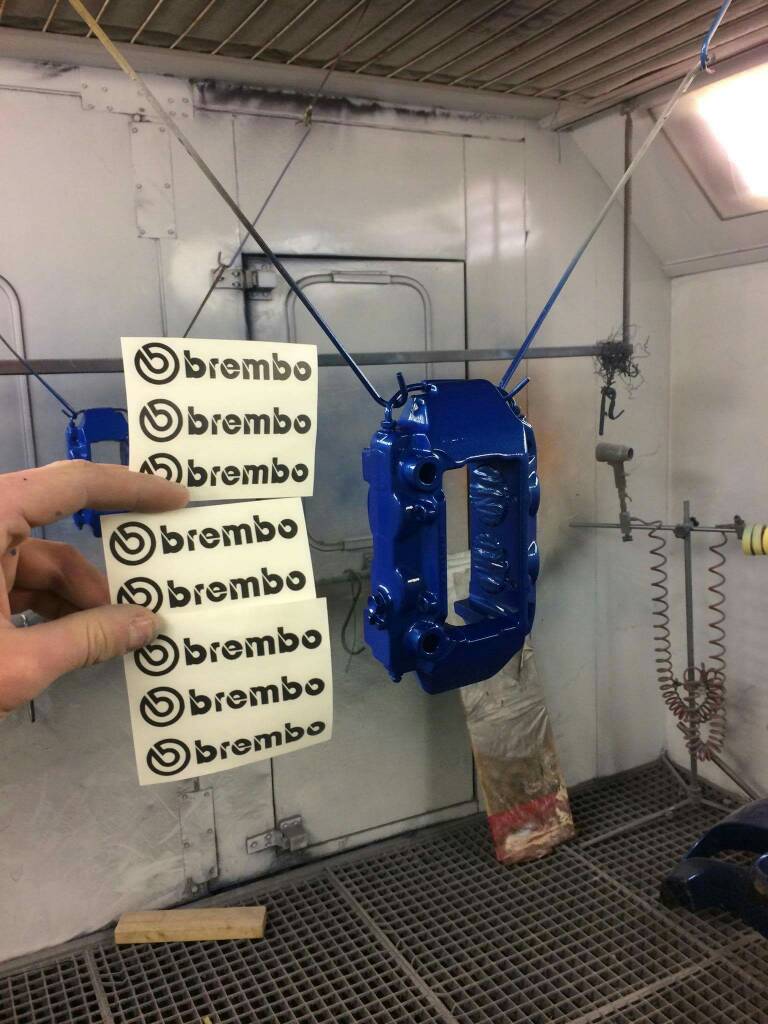

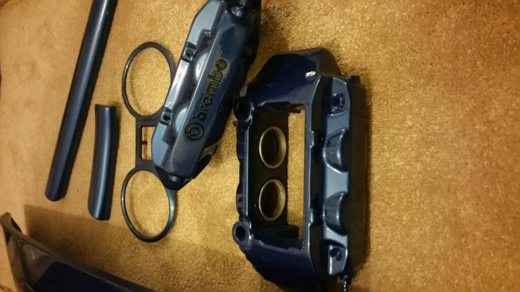

Also stripped down the brembos, including the pots. Managed to get a block of wood between them and encourage them out with a compressor.

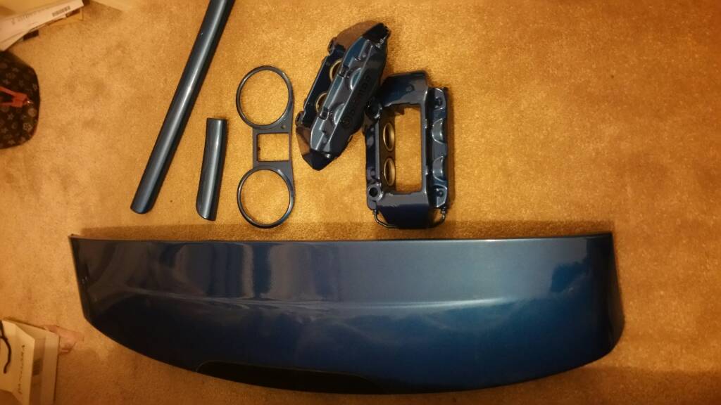

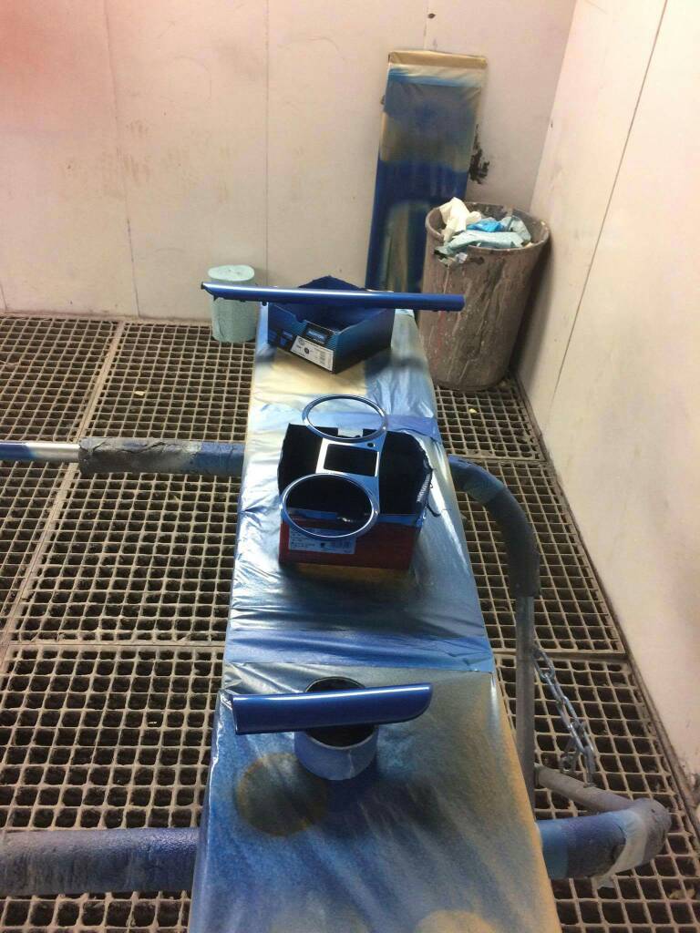

These are off to the paint shop tomorrow along with some interior trims. Decided to colour match the car (artic blue).

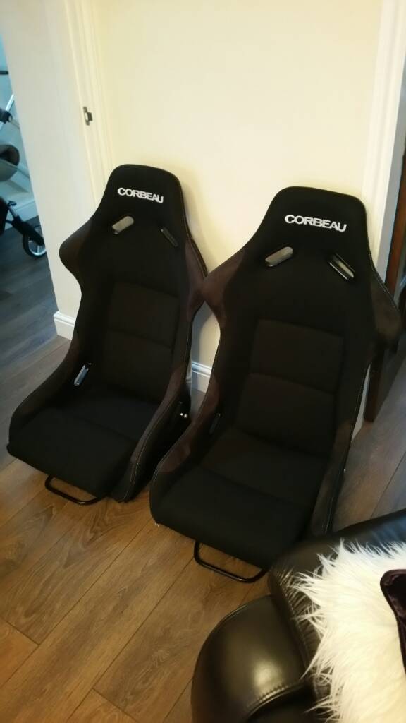

Corbeau bucket seats have arrived (new). I'm a 32" waist but went for the larger seat, because my dad will also be using the car on track. I'm glad I didn't, they're tight enough, but still have enough room.

Looks like a great car, what method did you use to get the sound deadening out of the car?
Cheers mate. Got it really hot with a heatgun and used a standard scraper to remove it. The whole car will take a good few hours though.

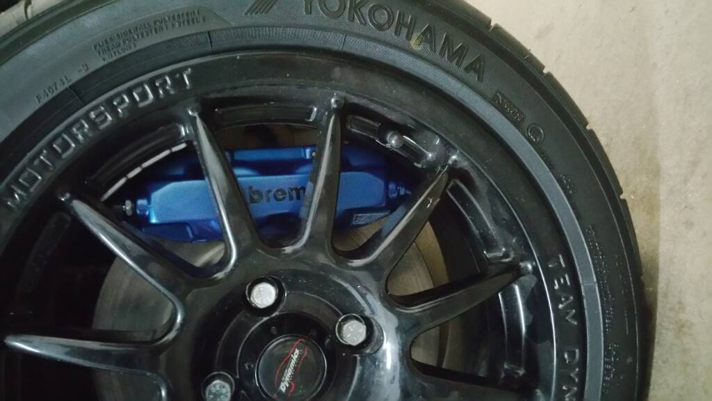

Another update to keep pictures etc in here.

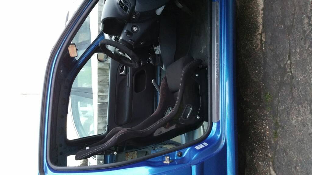

Subframes arrive and have fitted one seat (drivers). Yet to fit the passengers due to hopefully getting the interior sprayed black soon. I'm on x-low frames with corbeau clubsports (including runners), I'm 5'11 and really happy with the seating position.

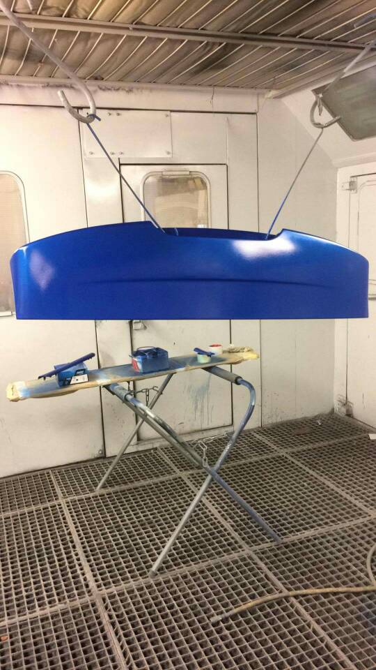

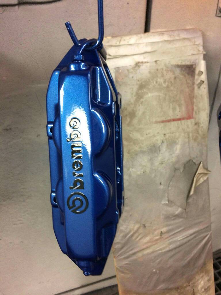

Genuine trophy spoiler arrived, good condition, wrong colour so was sent to the paint shop, along with some interior parts and the brembos. Couple of pictures to follow (light doesn't show the true colour in the pictures).
My mate was also taking the p**s as I sent him 8 brembos decals haha!
Finished article
And about 10 mins ago when they were delivered home.

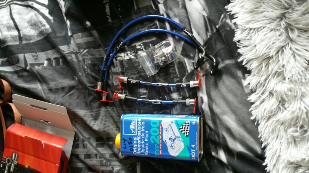

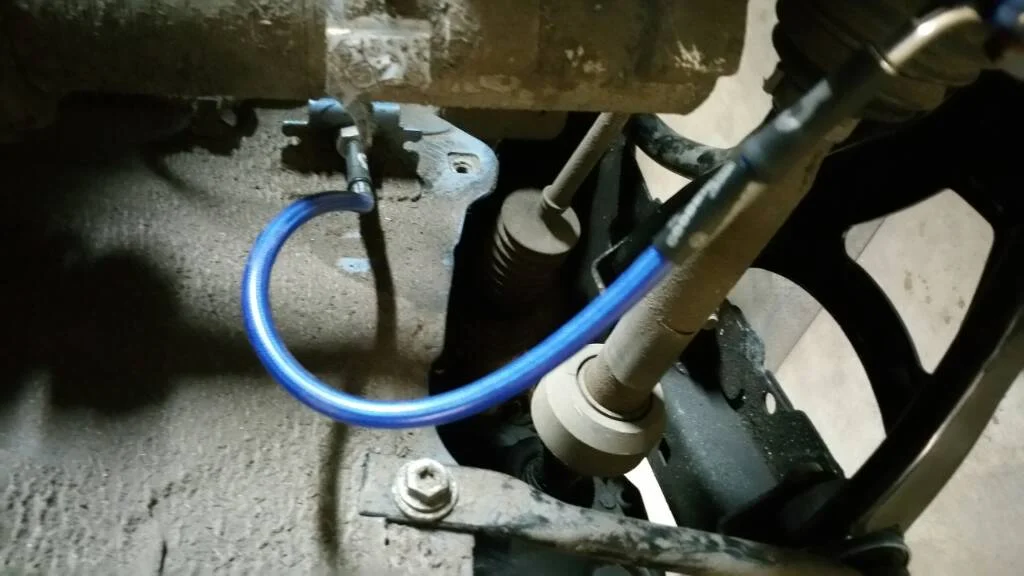

The blue braided lines and fluid has also arrived.
Decided to replace the rear discs and pads (genuine) at the same time, so they have been ordered. Hopefully all to be fitted in the week.

Very nice. What did you pay for the spoiler if you dont mind me asking ;-).
Love the matching brembos!
Cheers mate. Paid £300 + paint for the spoiler, also came with genuine shorter struts, found it browsing ebay and could resist!

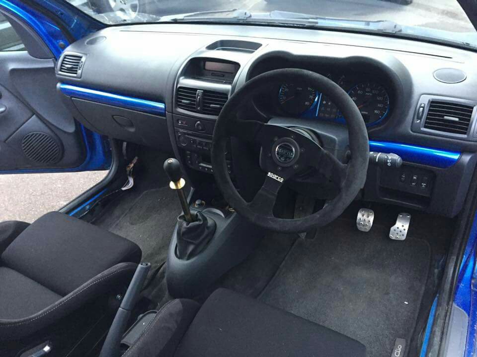

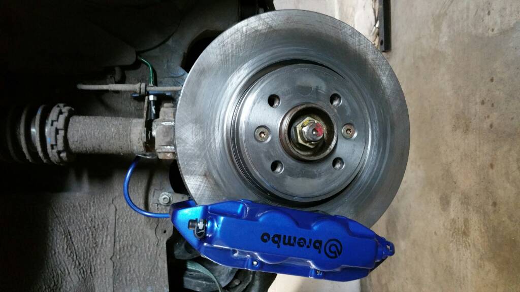

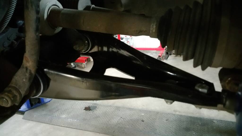

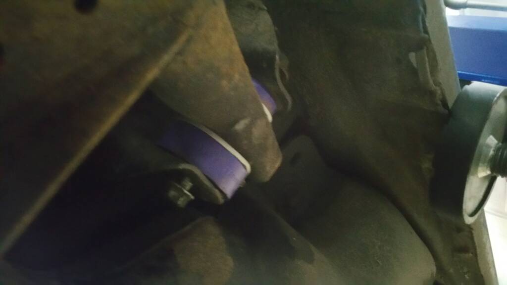

Bit of an update.
Managed to get the front calipers on, with new discs and DS2500 pads... then I got carried away! Also fitted:
- new wishbones and ball joints
- poly bushed rear trailing arm bushes

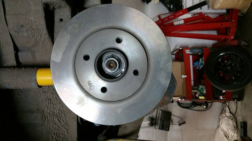

- new genuine rear discs and pads

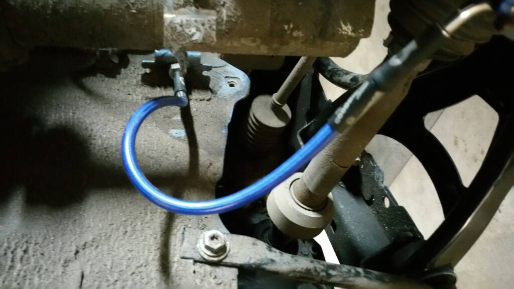

- front and rear braided lines
Pictures aren't brilliant, but feels so good to drive now it's all fresh.
This weekend I need to clean out the coil over threads as they're very grotty. Fit the trophy spoiler and interior trims.
Sent from my SM-N910F using Tapatalk

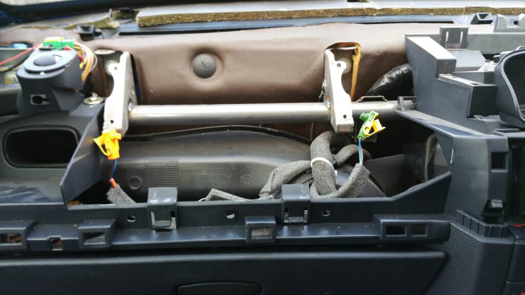

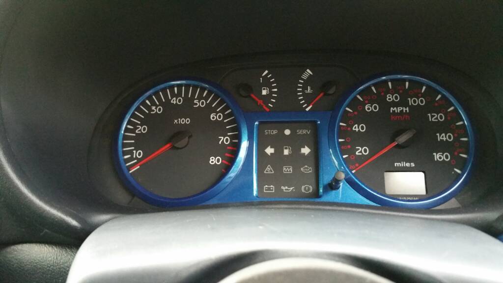

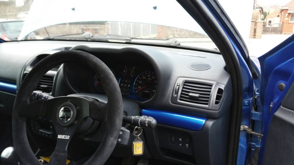

Cheers for all the kind words guys.. early finish from work on a Friday meant I got a chance to fit some more bits today.
Started off removing the dash and taking out the passenger airbag

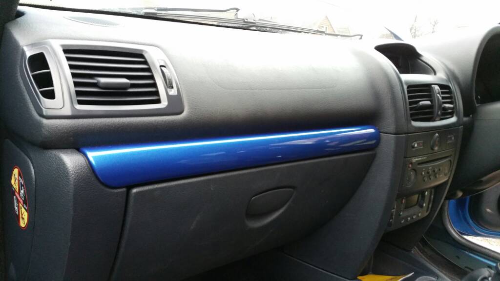

Removed the clocks and fitted the colour coded bezzle
Refitted the dash and added the new colour coded trims

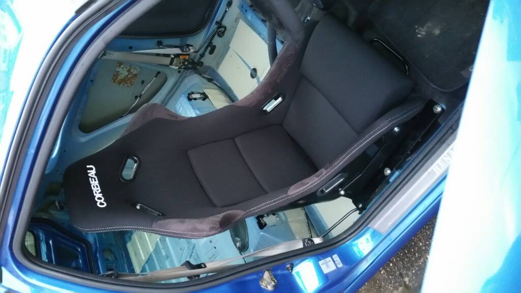

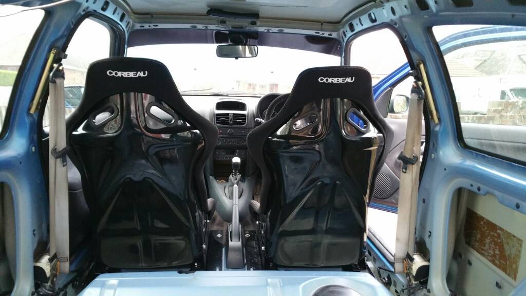

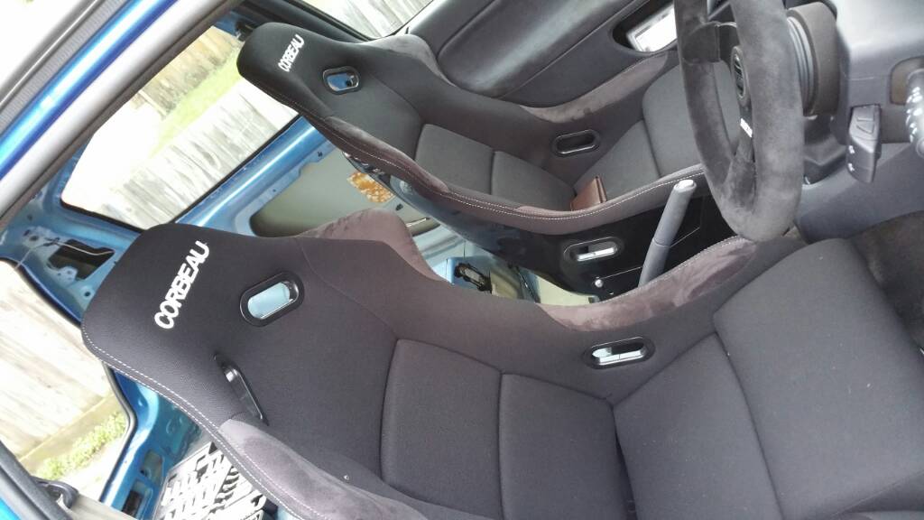

Although I need to paint the interior, I fitted the new bucket, as a second seat is useful..! Corbeaus on Jon foz X-Low mounts with runners, I'm 5'11 and they are perfect height.

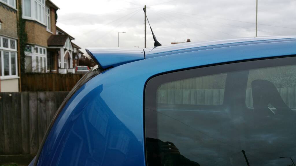

Last but certainly not least, the genuine trophy spoiler. Not further words needed..!

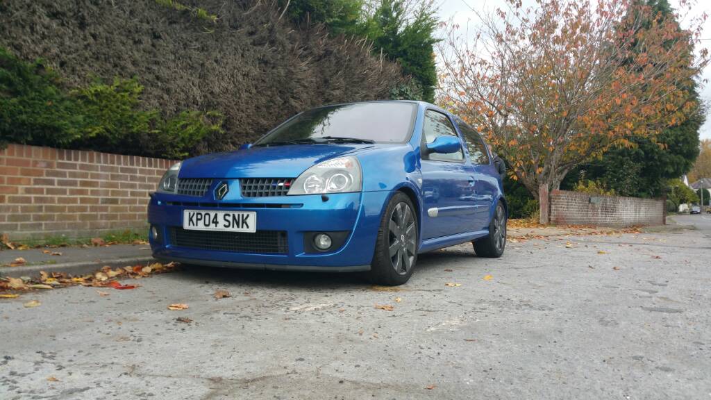

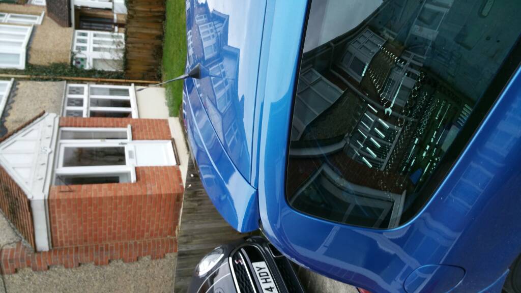

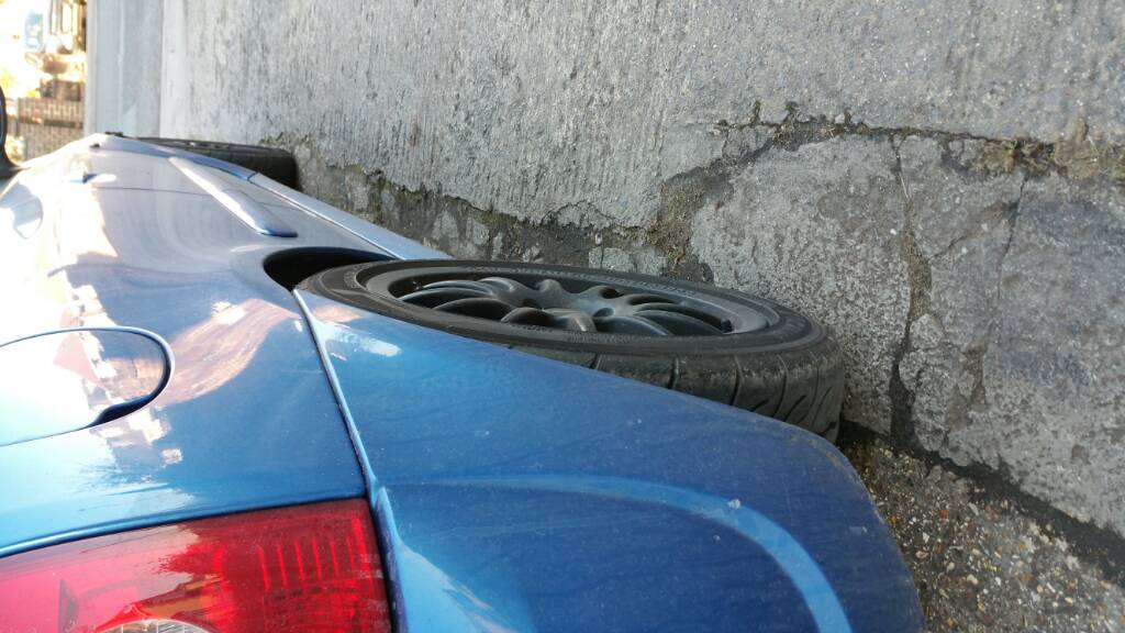

Another weekend, another update!

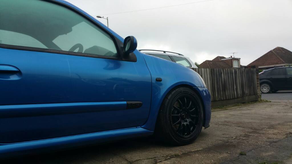

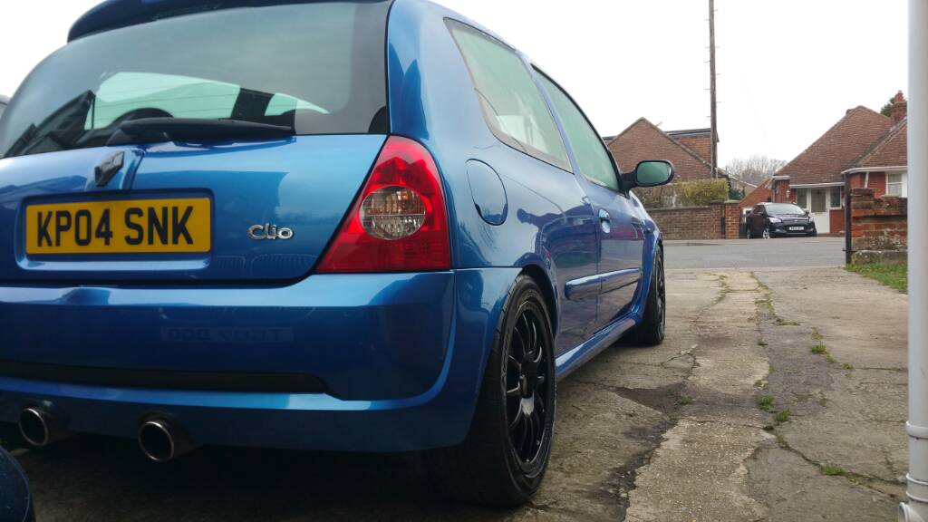

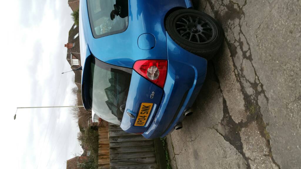

Got some 5mm spacers for the rear, definitely makes it look slightly more aggressive, which I like
Before
After

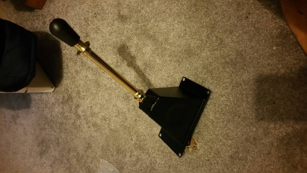

Also bought a new pms shifter. When arrived:
And fitted:
The shifts feel so much better and precise and the higher position is really nice.

I really rate it, but it's still early days. It does take a little setting up to get it right, if your local to me, your willing to take the car for a spin to help you make up you mind! :)
I really rate it, but it's still early days. It does take a little setting up to get it right, if your local to me, your willing to take the car for a spin to help you make up you mind! :smile:
I'm way over in Norfolk mate but that's a kind offer anyway, thanks :up: what was it like to fit? Do you notice much more noise and/or vibrations coming through the car?
BlackGoldMatt
  Tesla Model Y Perf
No worries. I lucky had a ramp in a workshop, so it wasn't too bad, it's just the messing around setting it up to ensure you can select all the gears. Not noticed any more noise/vibrations, but it's early days and the cars stripped out anyway.
