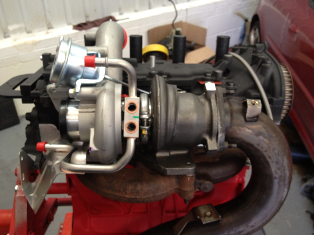

whats the plan for this? hunting for big power?

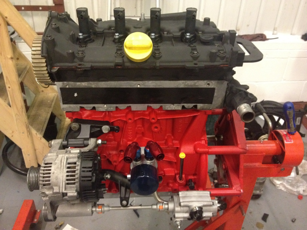

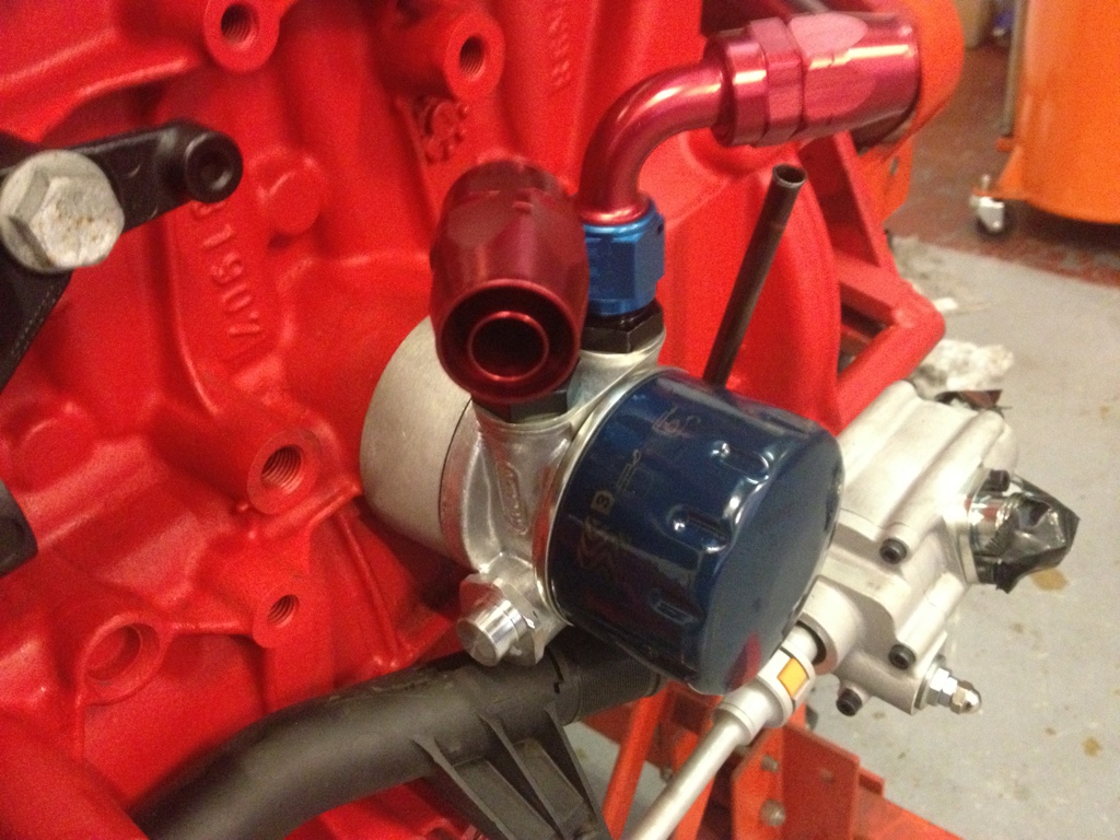

How easy is it to get the dry sump system to work? Costs involved? (if you don't mind me asking)
aim is a totally flat 190ftlbs from 2000RPM to 7200RPM which will give approx 260bhp but with absolute reliability for several 10's of thousands of KMs. Dry sump not only helps ensure oiling on long corners like Gerrards but also allows 12L oil capacity so plenty more thermal mass etc.

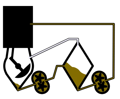

Can someone please explain to me a dry sump?!
A bit like a swirl pot in a fuel system, I guess.

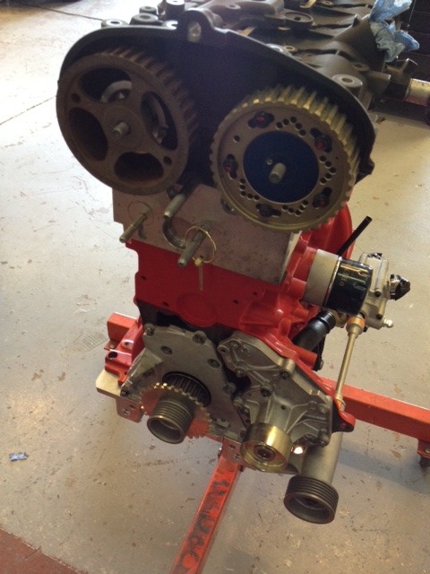

We do them circa £2.5K fitted with all lines, tanks etc.
Mods required include gearbox adaptor, machining the block to remove the lower boss, plugging original feed galley, modifying new stock waterpump to FR spec, Alternator mount, Oil cooler take off etc. etc. Quite a lot of work! We do the Sump kit on it's own at £900 +VAT should you want to DIY.

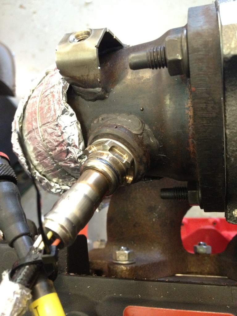

FYI that lambda sensor is about £1500 LOL!
HOW MUCH!!!! why is it so much more than a normal one
