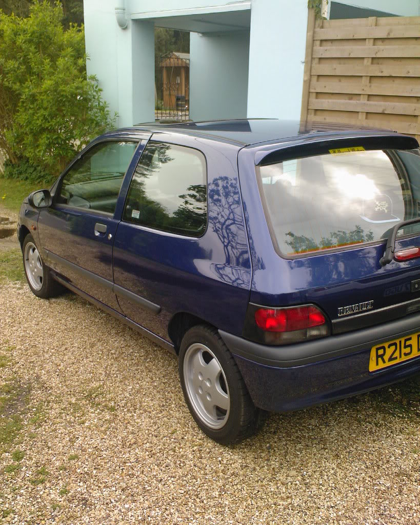

ive got same car, i had it 35mm, still looked WAY too high, so dropped it 60mm all round, kept the back slightly higher so it dont handle s**t! go 60 will look loads better similar to............................
or refurb the rsi wheels and lower it 60 will look ace!!
no rubbing at all had 5 up the other day on the motor way had no rubbing at all even on the back roads, must have 195/45s if ya running 15's tho!
i had trouble gettting performance shocks what fit as the front struts were 58mm bolt gap ya need to check this mine were from koni and took a month to get!!!!
